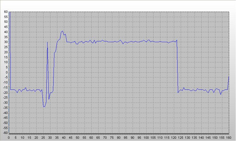

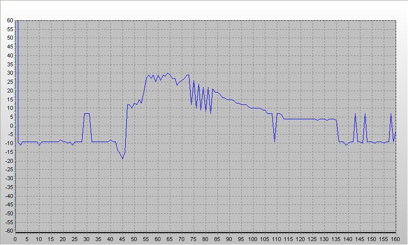

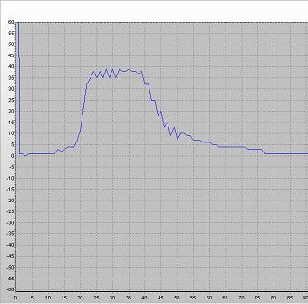

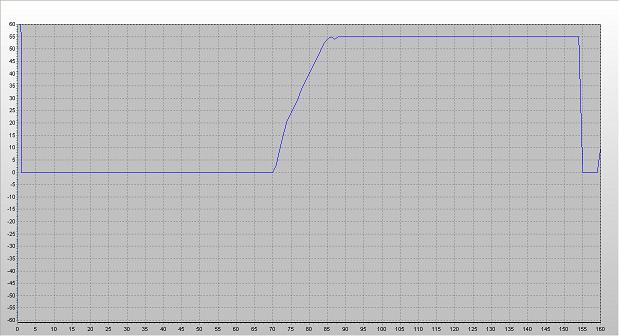

                        Here are some scope snapshots when ysus/zsus are not connected and when they are. boards connected it will not start if has been started recently. Can this 150-200ms difference in VS line risetime cause the shutdown or is the reason somewhere else than SMPS diagnostics..??
                        I guess I have to scope this tomorrow or late this evening with the boards on and when it starts to make a comparison for starting with out boards scope readings.
                        If it ain't the SMPS diagnostics that shut down the VS/Va lines what diagnostics there are coming from teh y-zsus boards to the main board??
                        The voltage drop is almost the same when switched off from the TV on/off switch when the set is on. It's quite fast now with the resistor connected.
                        Also the blackened component near VS-ON input to mainboard was a resistor and checked ok value. It was included in Clock circuit of the U702. It has ceramic oscillator and it showed to be oscillating to U702 ok..well the U702 control IC would not work if the oscillator would be dead..
                        Oscillator is saw wave formed so the voltage level is quite low and the signal level dies quickly if measured with scope etc. and causes the micro to reset
                        I only have 1-channel scope so can't do any timed checks for 2-channels...maybe I have to start looking for one. I would need 2-channels farely often on other projects also.
                        PS: I don't know exactly the grid readings here..first time I used the USB downloading feature on my scope and it does not allow me to change the grid. measuring range was 50v 200ms. 10 units on horizontal is 200ms.

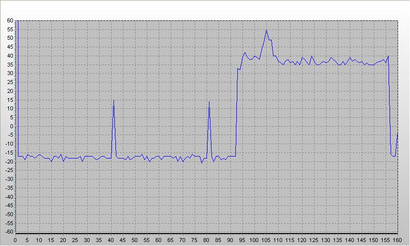

                            here is a recent pic (2min ago) from Vs line voltage rise. Now both boards were connected and the set powered up OK. Maybe I have to scope the 60.v line also.
                            Maybe the caps don't affect this output voltage line? I might as well try to find the feedback line circuit from SMPS voltage line(Vs Va??)to U702 pin and see if that has some explanation to this syndrome..
                            Can't see any real difference on voltage level or rise time between boards connected - not powering up and -powering up other than a really small dip on the corner there..probably just pure luck it looked like that.

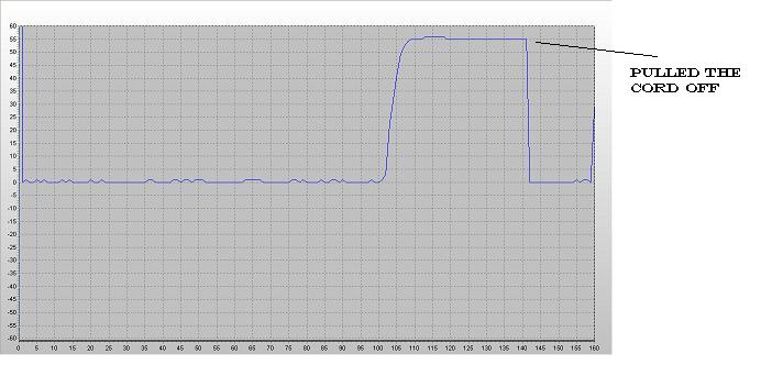

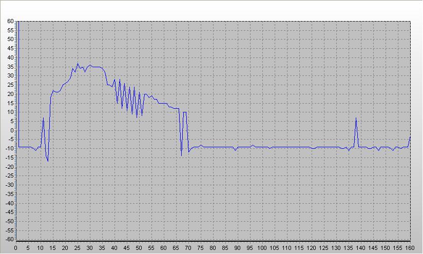

                              Might have to eat my words...this is the next measurement when the set is not powering up..dip is there again. Have to believe it now and buy those caps. Small difference if this makes it tick or not.
                              EDIT: Added not powering signal from 60v VA line and other when y+zboards are disconnected+powering up..that might explain it more if the U702 snifs this line..looks pretty ugly axels were 20v_200ms

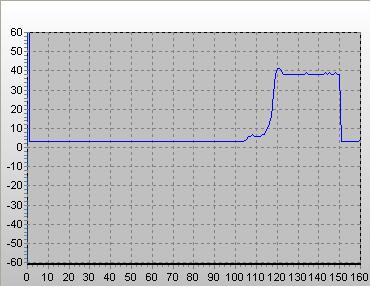

                                OK, here are voltage readings from SMPS U702 control IC feedback pins that I found.
                                power up succesfull =ON pics without y-z,board connected
                                not successfull starts with boards on = OFF pics.
                                Pin27 on U702 comes from 60.v VA line thru 3 resistors, PIN28 has extra resistor/capacitor pack(filter?) but same route to IC otherwise.
                                PIN21 comes from 186V VS line thru the mysterious N-mosfet..I guess the mosfet is ok . This is the line that comes thru the ones burned 10ohm thermall fuse/resistor+2x10ohm extra ceramic resistors and 2 diodes.(one from each line VS and VA).
                                When this PIN 21 signal was missing the tv started sometimes also, but signal behaviour was pretty nasty. ones started VS/VA was ok.
                                I guess this explains a bit of the emergency/fault shut down?
                                I also firgured out the scope screen grids and the .jpg picture grids..screen has 8x8 grid that corresponds the 60- -60 and 0-160 picture readings.
                                all pics are 200ms time interval (divide 160pic/8screen=20units = 200ms)
                                these U702 pics are 2v grid so 60/4 => 15units is 2.v
                                other pics 50v/scope grid unit---> 15units is 50.v
                                any toughts about oscillation?

                                Also measured VA line with only the zsus board attached, cleaner, but no start. Has to see if I will check the ysus board 60.v line for problems if the new psu caps won't help.
