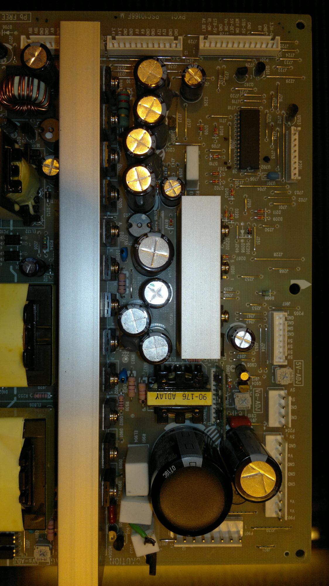

                        #31
                        Re: LG 42PC3RA SMPS power_ysus problems on/off/on click and fixes
                        Originally posted by slappala
                        I bypassed the AC detect and hooked it to a constant standby 5.v line. It works now, but the set starts twice quickly. Second time it stays on.
                        I would need a 5.v clean constant signal from some point. Where did you take it?
                        Also the line I used is really messy on my scope. not a clean 5.v I would say..and has a 0.5v spike that could cause the second start attempt/reset.
                        I think the PSU control chip might take the AC detect line down in case of the voltages don't rise enough quick. Is it coming from PSU control chip?
                        EDIT: I was right..the AC detect line comes from teh PSU control chip. Just measured it.
                        Now, where to take a clean 5.v signal or should I filter the standby signal with some caps to get a cleaner signal...I will measure the constant 5.v feed line if it is on all the time before the VA and VS lines are taken up.
                        Then I will call it "fixed" until it burns some fuses...like I said teh PSU is working A ok when teh set is on..only the voltage rise times are having trouble. see the pics on earlyer pages. and we are not talking seconds here
                        Post a picture of your board - the fix actually involves disabling the AC detect optocouplers with a bit of solder. I didn't try to pull to 5V on my board.
                        The signal goes through the PSU controller (a microcontroller of some kind which sequences the outputs and runs some checks.) The actual AC detect signal is lost on the primary side somehow; I'm not sure why or how it gets lost.
                        The disadvantage of disabling the AC detect on some TVs is you will hear a loud popping sound from the speakers if power is lost while it is running. However, it does not damage anything. Mine lasts 1 second with no power because of the lack of AC detect. And it doesn't happen when switched to standby.

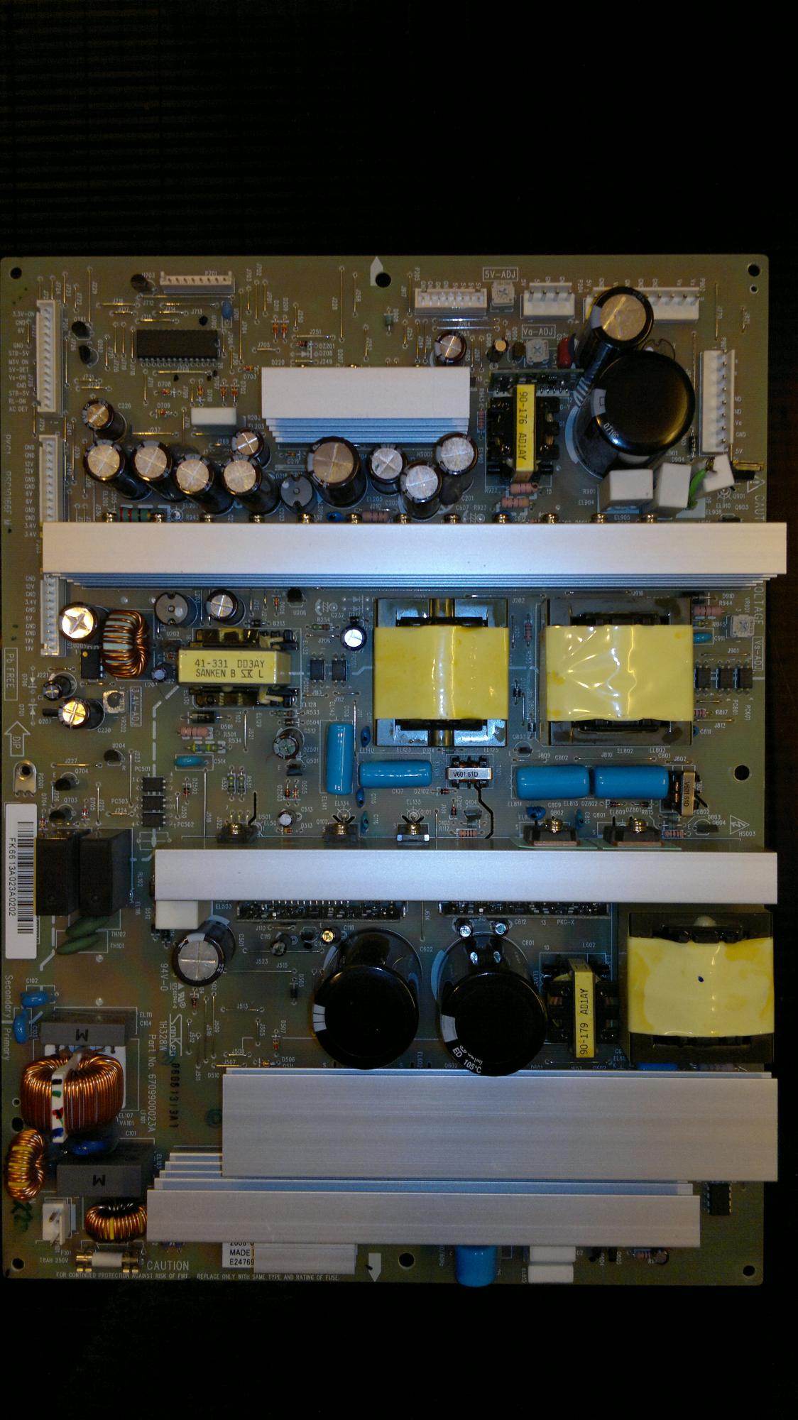

                            #33
                            http://*************/g/9/201203081821.jpg/
                            There they are in imageshack, let me know if you can see the pics or not.
                                  PC502,PC503 are probably the suspect devices - near the relays, bottom left. Post a part # for them.
                                  Also please don't post inline - I've got crap internet service and it takes forever to load pages like this.

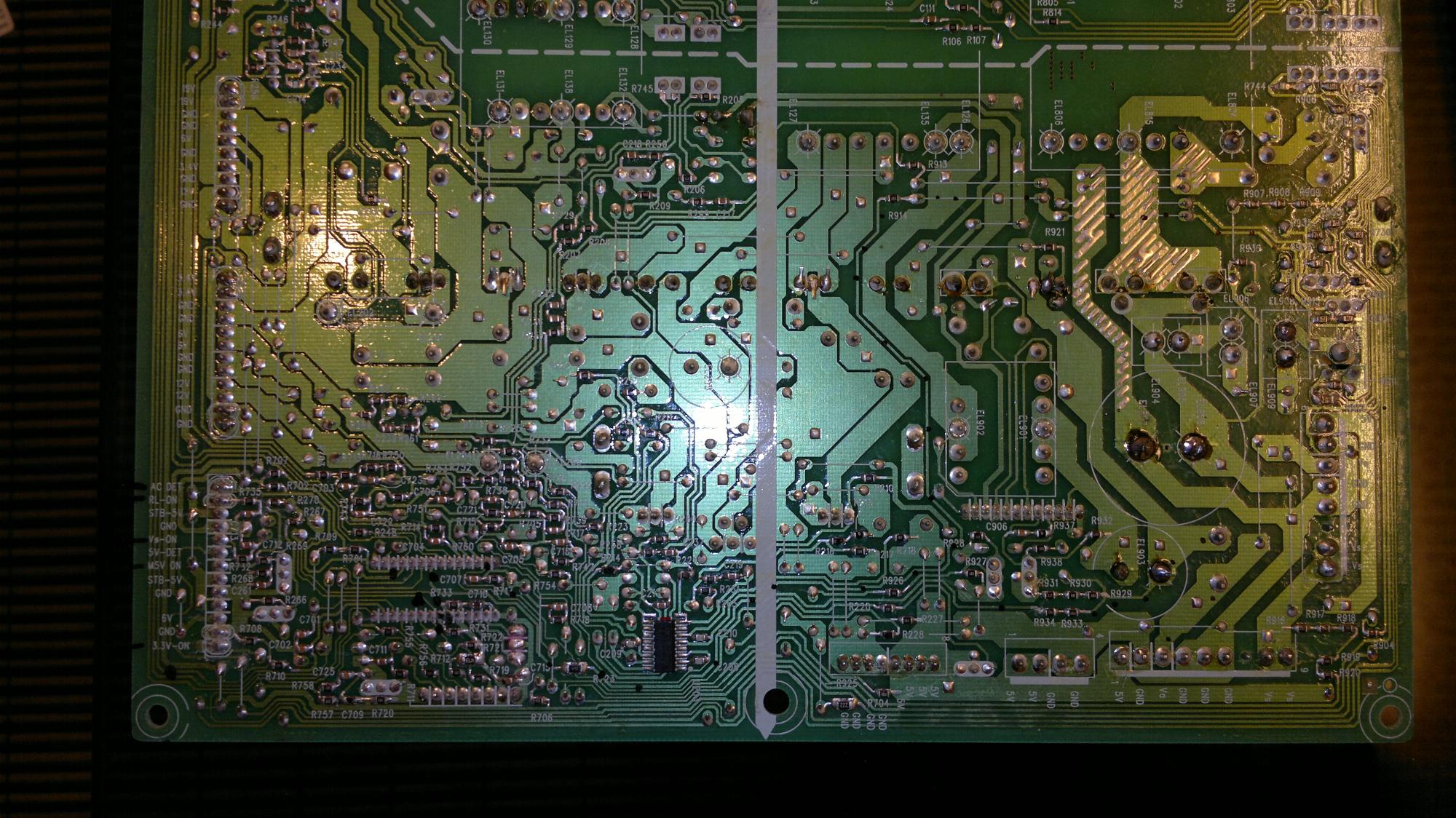

                                    #37
                                    sorry about that, I will change the pics to attachments. I tought it was best to sent these as links.
                                    parts are NEC 2571 / SJ605, not included in the repairmanual BOM.
                                    Might take 1h or so to delete the files from imageshack(Said when deleting the links.)
                                      #38
                                      Okay, pin 4 on the optocouplers is on the phototransistor side.
                                      They're the only signals coming FROM the primary to the secondary, normally the signals go to the primary side from the secondary.
                                      Need a closer pic of under these devices.
                                      You will probably need to place a solder bridge between pins 4-3 on both optocouplers. That's how I fixed mine.

                                        #39
                                        I checked the datasheet again and tried it out. shorting these 3-4 pins on those 2 optocouplers help and gets the tv going when it's clicking.
                                        phew..
                                        I just don't know what could cause this..and frankly don't care .
                                        I measured the signals on both sides of the opto transistor and voltage's drop out for some reason when clicking..
                                        The scope waveform to the opto led side changes when this happens (dirtyer, but peak to peak just a hint)
                                        AC voltages don't drop out too much..
                                        might be voltage/current spike during PSU secondary startup phase that causes the primary side waveform to change and optos to collapse.
                                        This could be caused by a million things...old panel drawing some amps to get the PSU going etc. endless different reasons..
                                        I'm just wondering would new optocouplers help..the enviroment is violent and this PSU's voltages are not the cleanest ones I've seen on this earth..probably not since both act the same way.
                                        For now I just bridge the pins and start watching a movie..(and play around with some setting in the hidden menu maybe ..)
