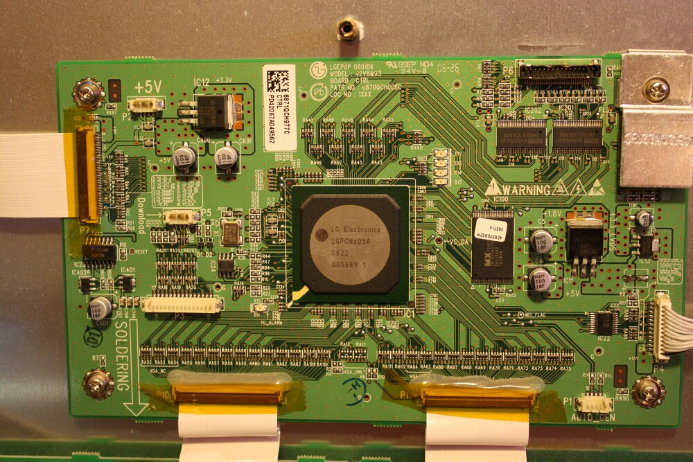

      I have a full set of boards available for an LG 42PC3D-UD. Plasma display is bad. LG tech just verified all the boards are good. Right now I have a complete set. Make me an offer on any board you need. Just hoping to help pay for my new television not expecting to pay for it all. :-)

          http://136.166.4.200/contents/Displa...om-upgrade.htm The Jig is now available p/n RAD31752601 (04/21/2010)
          The Mal-Discharge Correction Presentation will assist the Service technician in the repair of a Plasma television that is exhibiting the symptom of mal-discharge.
          See example of Mal-Discharge.

                                      Sweet the programmer came today. I will do some viewing of the cd online, then adjust the voltages and see if this removes the sparkles.

                                        Unfreaking believeable, I took off the one panel to get down to the logic board and when I removed it, I see a small cap on the logic board with one leg sticking up. I tried to solder it with out success. I will attach a picture of the cap and the board. [any info on the cap will be greatly appreciated. The leg was broke off the cap so it looks like replacement time if someone can give me some information on it.
                                        Thanks..... Just when I thought I was going to get to use my new toy.
                                        • muskin
                                          • Nov 2011
                                          • 64
                                          #40
                                          Re: Lg 42" plasma model p2pc3d-ud
                                          The cap is missing from the right middle near the edge. One cap is still there.
