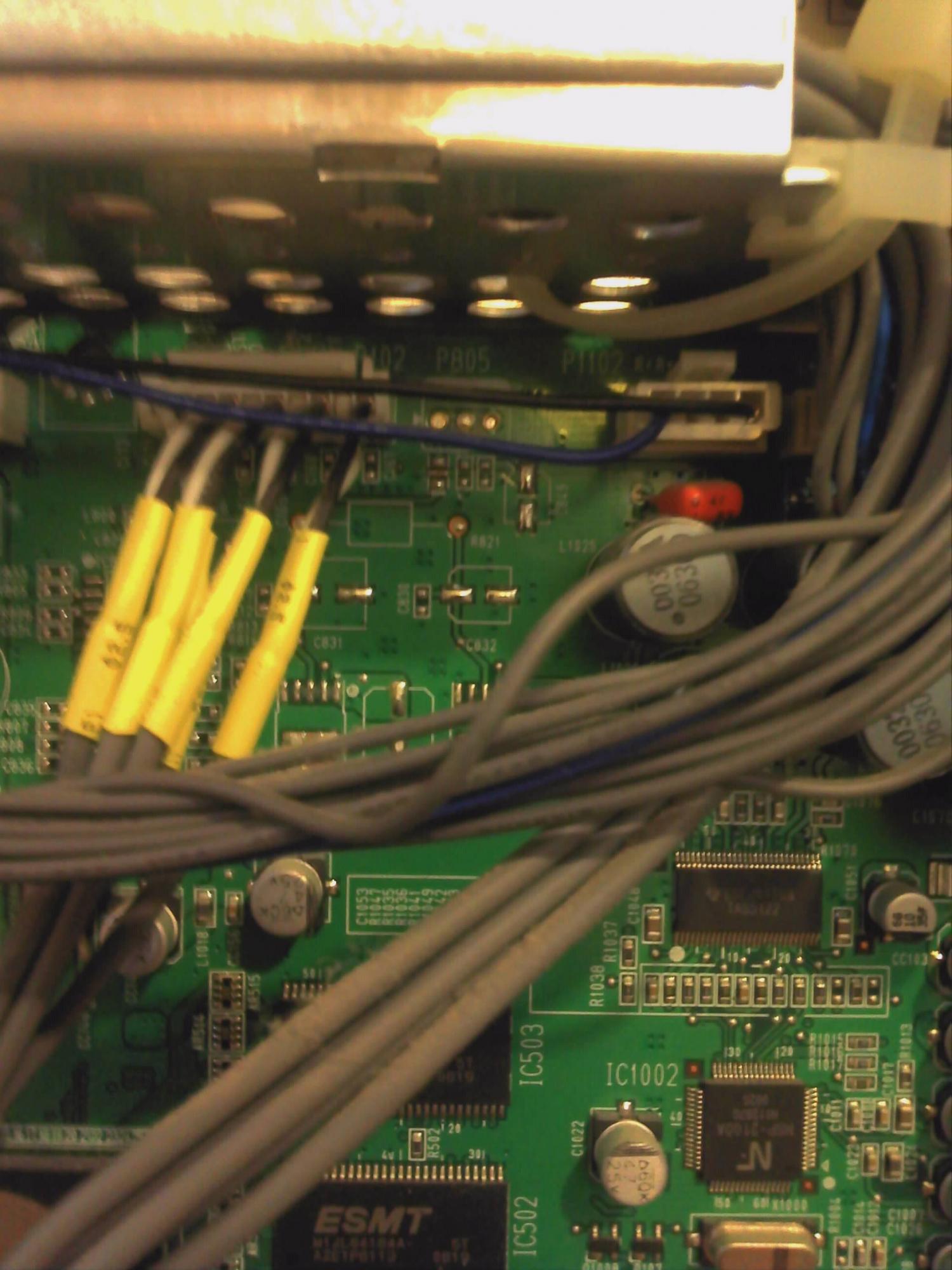

                        Re: Lg 42" plasma model p2pc3d-ud
                        Just connect the multimeter between Gnd- and VS+ for higher voltage, adjustment from vs pot and Gnd + Va for the lower voltage. Adjustment from Va pot.
                        In my TV the right adjustment values for the plasma panel were on sticker back side of the panel, upper left corner.
                        My PCB:s have all markings silk screened/marked beside the connectors.
                        Nice that you got it going! I'm still trying to avoid bying new boards and repair what I can on old ones..we'll see.. :/
                        Also on my powersupply shares the Va and Vs traces right after the connectors so it's just the same wich connector you use for measurement. Be carefull..connect the voltage meter leads ready before main power cord is connected and use isolated screwdriver for pots just in case you slip it
                        that Vs line for sure will kill you or give your heart some extra beats if accidently touch it..
                        PS: The power supply should have voltage pots for 5.v Vs Vs lines. 3.4.v line pot has some glue on it. But since you have new board I guess that is a little late. Have not seen pots for 19.v, 12.v or 6.v on my board.

                          Ok I found the P805 and it is on the mainboard. Is this the correct P805? I have attached another picture of the mainboard with P805 on it. I suspect the far right is the ground and the other two are va and vs.
                          Barry
                          Sorry for all the noob questions but I hope to get it right the first time without frying it after fixing it.
