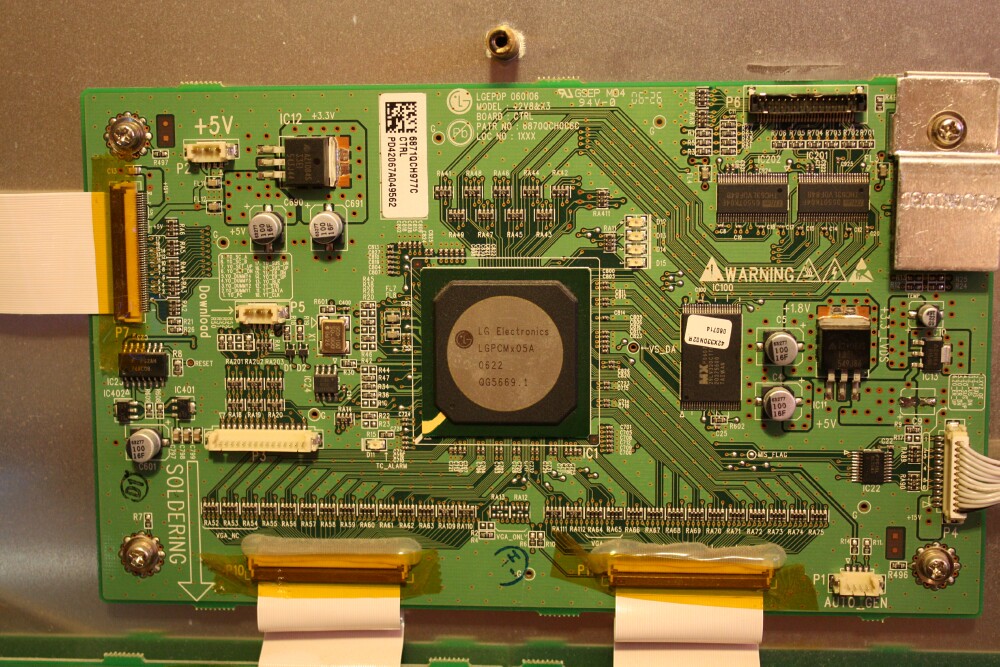

      Hum dumb question but from the picture below, can I hook up 5v to the 5v on the board somehow to program the board? The 5v in the top corner has four pins in it.
      I was thinking of hooking up 4 AAA batteries [1.56=6.24] or 3 AAA batteries [4.68v] and apply it to the 5v plug. Only problem I am having is how to tell which is the + and - in the plug. [I know noob question.]
      I have already installed the software for the jig, I just am waiting on the capacitor for the board.
      • muskin
        • Nov 2011
        • 64
        #43
        Re: Lg 42" plasma model p2pc3d-ud
        I tried to program the board with the capacitor still missing, it seemed to program it. I got the 3 light with the 4 AAA batteries connected to it. [5.16V]
        Only thing unusual was model of the board is two models.
        Below is the version of the board
        Model version 42V8&X3
        New version 42X3_3DCS4 I installed this one..wonder if this is ok? Did not show an error, but wonder if I should have tried to load a 42V8 file?
        42V8_4CS01 I can try this one later.
        I will not know if this worked until I get the capacitor installed.
        Any comments will be welcomed.

          42V8 and 42X3 are two different LG plasma panels. The 42PC3D series of TVs use the 43X3 panel.
          I glanced at the instructions for the programming jig, it specifically mentioned that 5V had to be hooked to the board. Because of the design, you probably can get by with using three batteries in series; I have a bench supply that I would have used, In the absence of a bench supply, the red (+5V) and black (Gnd) leads of the drive connectors on any PC, AT, mini-tower or ATX power supply make a good 5 volt supply.

                Bill I am going by the model number, just a little confused why the logic board has different information. The attachment is what the plasma mal discharge pdf says to go by.
                I attached also a picture of my board. I guess the board can be programmed for either panels. Since mine is a 42x3 I will be using it.

                  Exactly the conclusion I came to. For what it's worth, I've got an LG quick reference handbook. It shows the V series of panel was up to 42V7, while the 42X3 was the latest in the X series. I wouldn't be surprised to discover a later version of the handbook would show the 42V8 panel.
