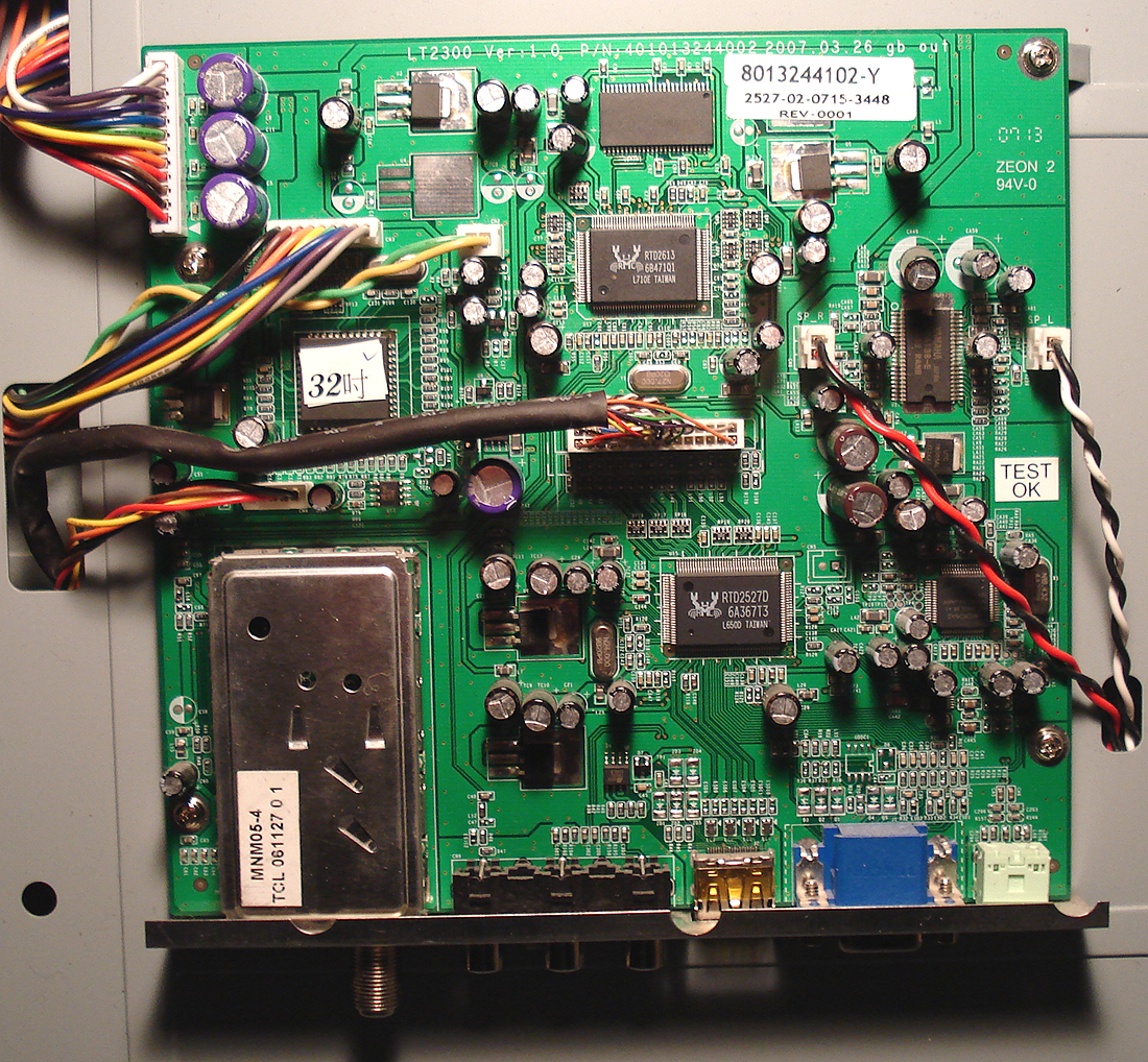

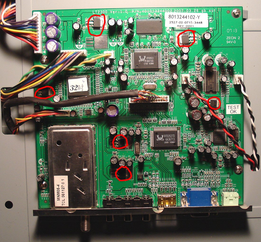

    Have you tested the LDOs?
    Are those caps on the main board Panasonic? Seems surprising for such a cheap brand.

      What are LDOs?
      The biggest caps are purple Hermeis, the two mid sized ( center right) are brown Hermeis, the rest are black Hermeis.
        Re: SOYO (mt-prtpt3208nb) lcd tv garbled screen
        Originally posted by raymond
        What are LDOs?
        Ah yeah, so using the same vent, but a crap brand..
        Anyway, an LDO is a voltage regulator. Basically: Voltage comes in, less voltage goes out. It drops the voltage to a specific value e.g. 1.8V, 2.5V, 3.3V.
        I've highlighted some LDOs on the board. (Check the bottom too - there may be more.)
        With the TV powered on. Turn your multimeter to the 20V setting. Test each pin of each circled regulator, and note the voltages. Also note down the part number written on the device if you can make it out. Post your results.
        Then we can go from there and see if any regulators are bad. If they are, they can be replaced.

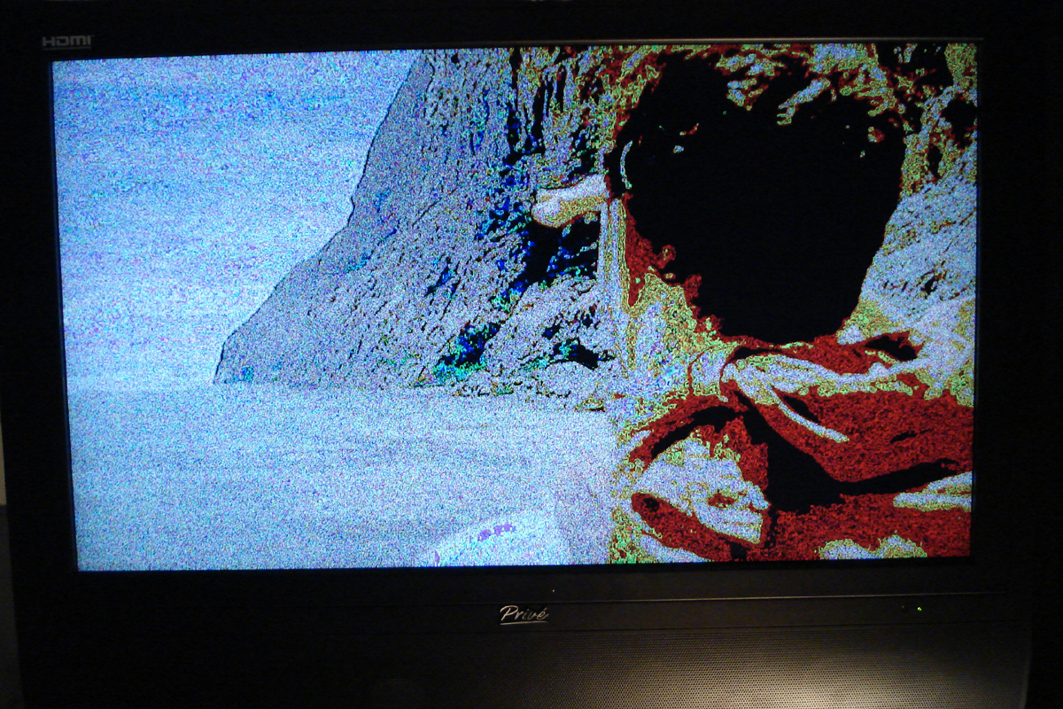

            Here's a view of the screen. As mentioned in previous post it takes a few tries to start from a cold state but once it's been on it restarts as it should.
              LDOs on main board
              Start top left ....moving clockwize
              1117-3.3sj ( 0, 3.28, 5.15 )
              1117-1.8sj ( 0, 1.78, 5.15 )
              78do5al eetka1 ( 12.36, 0, 4.96 )
              1117-3.3sj ( 0, 3.28, 5.14 )
              1117-1.8sj ( 0, 1.78, 5.14 )
              78do5al eetka1 ( 12.37, 0, 4.99 )
                LDOs on main board
                All of those look good.

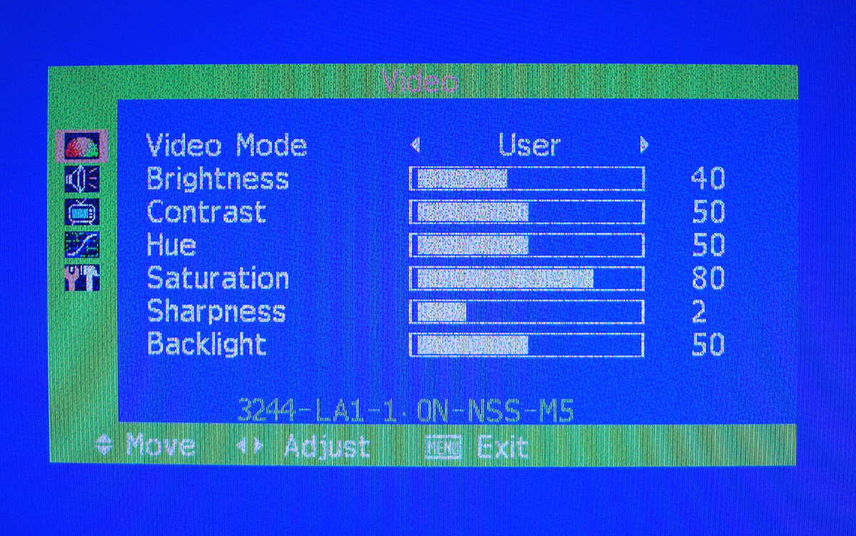

                Did you say the OSD/menus look the same?
                  No, the menus look much better but not as crisp or solid as they should look.

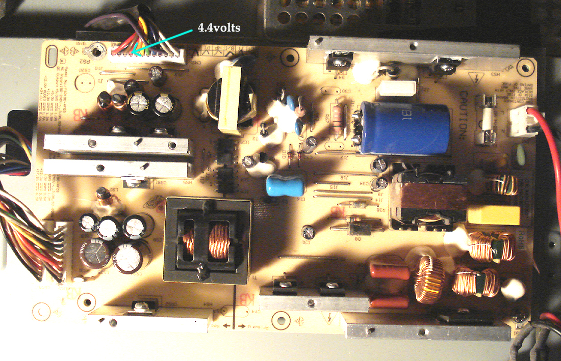

                      Thanks for the info tom66 (your input is greatly appreciated)
                      The slow to start thing ... I can hear a slight whine from the PS when it's trying to start.
                      I wondering if it could be a bad cap without noticeable bulging.

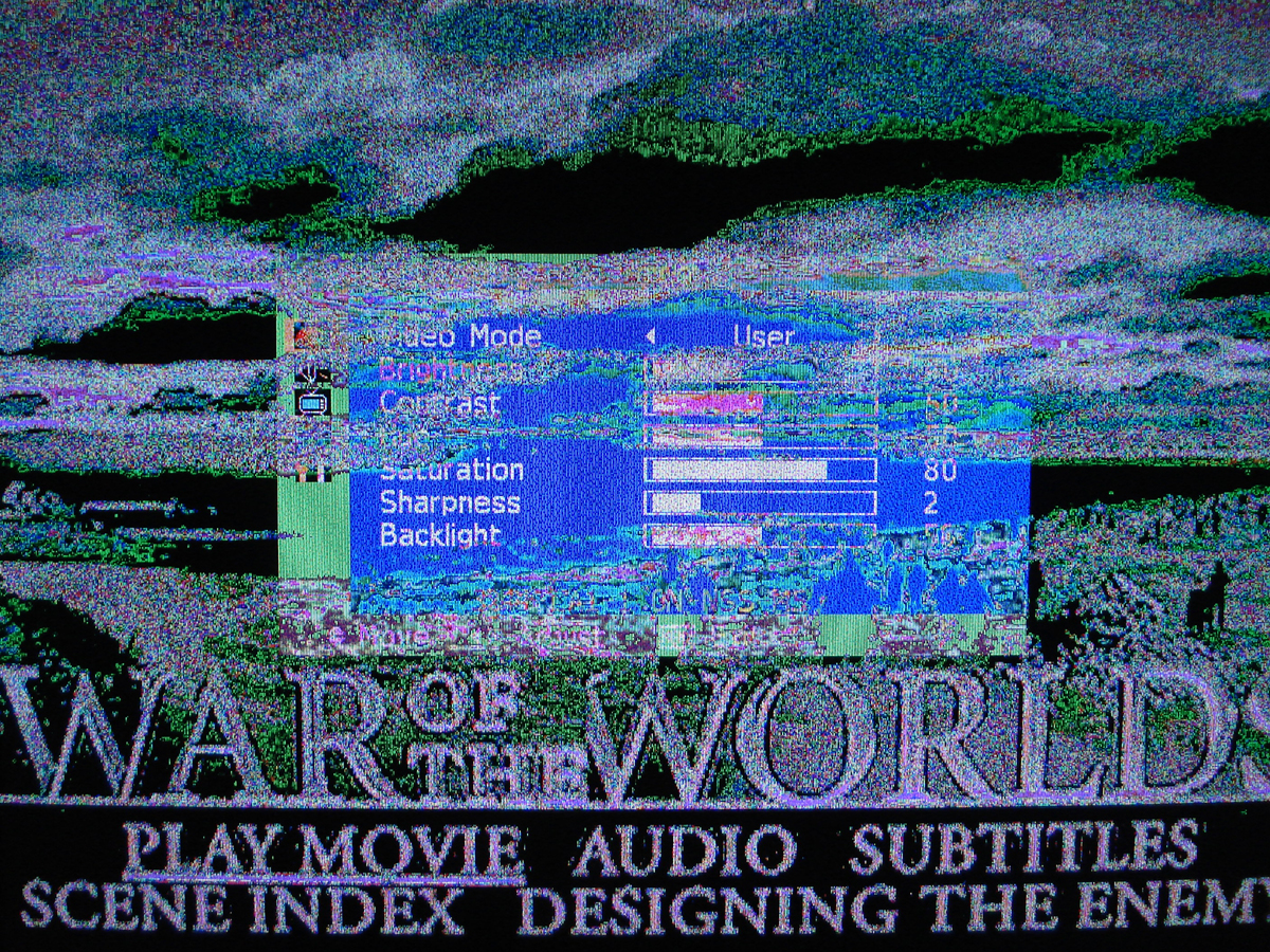

                                Can you show a pic of the "almost clear" OSD?
                                Also, does the effect appear on black/dark scenes, and if so is the OSD affected?
                                  The effect is constant in all light conditions. Here's 2 pics of the menu with and without a background image. The menu appears to get partially absorbed into the background.
                                    I'm trying to think - maybe the menu has a "transparency of OSD" option and that is what is causing the effects on the menu?

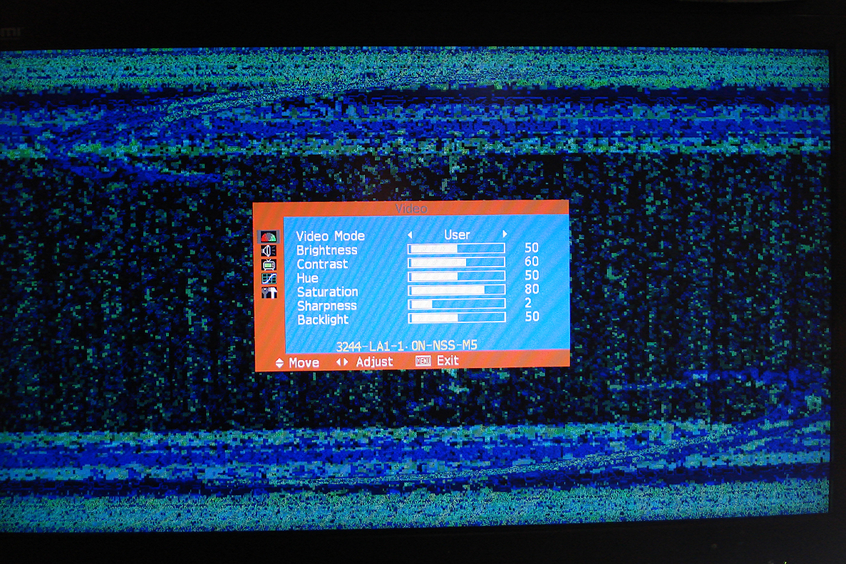

                                        Thank you tom66, you were right, it was set on halftone. The menu is now crisp and on top, nice to see. The screen image is still rough (as seen in this new pic), it has large pixel like squares flickering all over the screen. Would it be a good idea to replace those larger Hermei caps on both boards?
