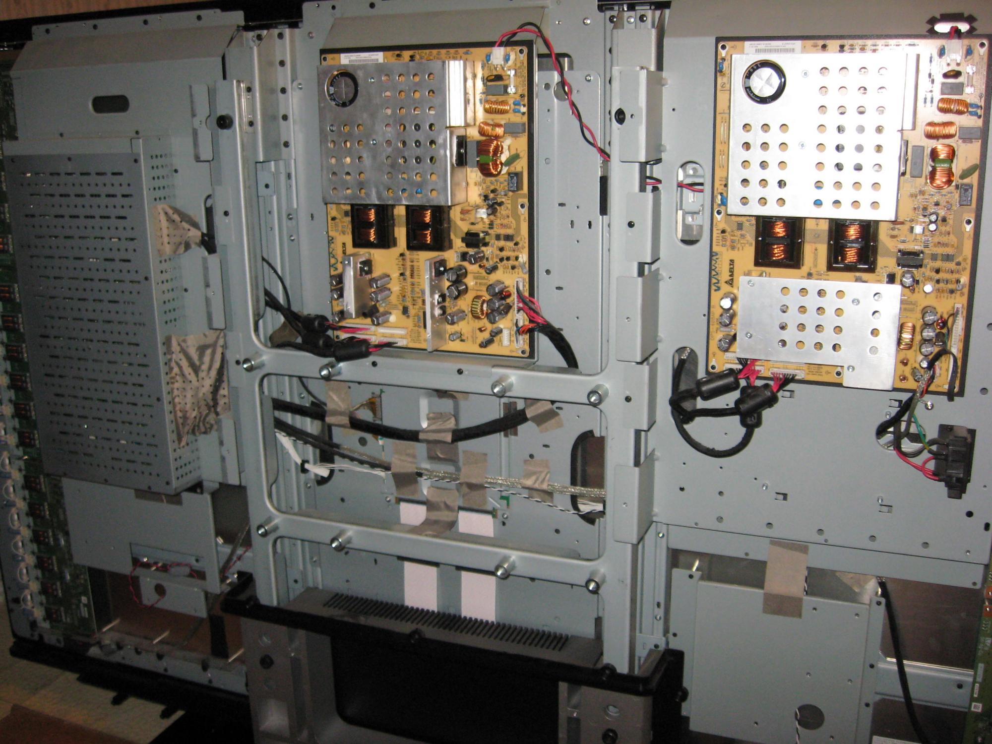

    It's not surprising that you got little help from the regular TV service shops. For economic reasons most of them are little better than board swappers. Your problem is often referred to as 'two seconds to black'.
    Many manufacturers used different subassemblies in their TVs. The first thing I need is a picture of the back of your TV (with the back removed). If you can also provide a picture of the inverter, that will help.

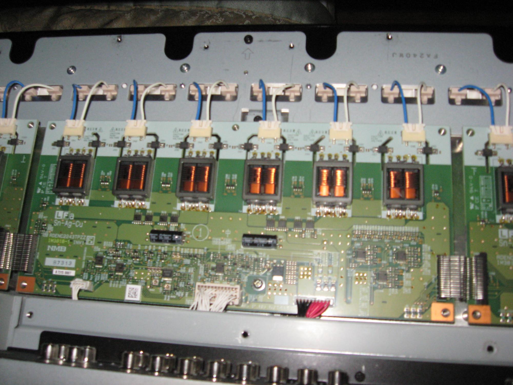

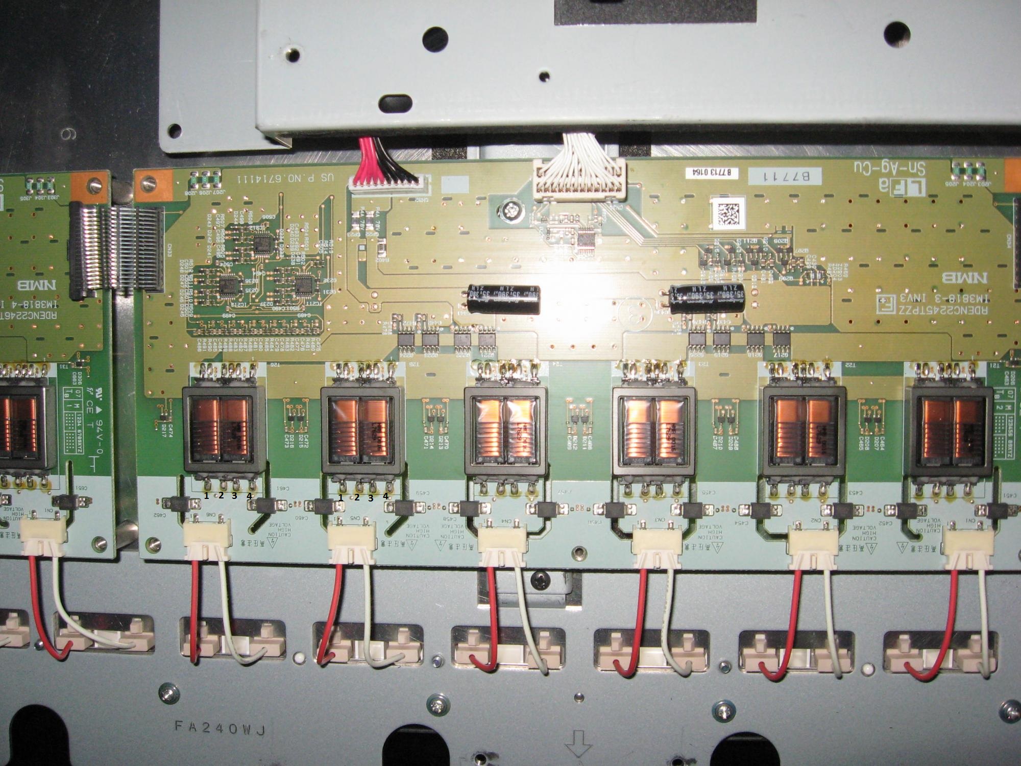

        I attached the pictures of the back of the LCD and from what I can tell are the master and slave inverter boards. Each of these has an inverter board directly above and below.
        Is the 2 seconds to black a typical easy fix? What am I looking at?
        Thanks.

          Two seconds to black has several possible causes, including bad caps, bad transformer, bad CCFL, bad component in the protection circuit. The Cliffs Notes version - the inverter controller monitors the condition of the inverters. If any CCFL is drawing too much or too little current, it is shut down.
          On the lower end of the transformers are four pins. These are PROBABLY the ends of the secondaries. Since I don't see any numbers, I will arbitrarily number them 1 thru 4 from left to right. Set your DMM to the 2K range and measure the resistance between pin 1 and pin 2, then between pin 3 and pin 4. Record the numbers, and repeat for the other 17 transformers. The readings should match to within 3%. If any reads open, or too low or too high, you have a bad transformer

                Sorry for my lack of clarity. I failed to notice the two pictures were inverted with respect to one another.
                I've marked up the picture I was referring to, numbering the pins 1-4. Set your DMM to the 2000 (2K) ohms scale. Measure the resistance between pins 1 and 2 and also between pins 3 and 4 on every transformer (not just the two I marked), then report the readings. I note the transformers have identifying numbers (T21, T22, etc). Use the identifier when you report the resistances.
                If by some chance the meter reads open on 1-2 and 3-4, try reading 1-4, then 2-3. If that is also open on both transformers, report and I'll give further instructions.
