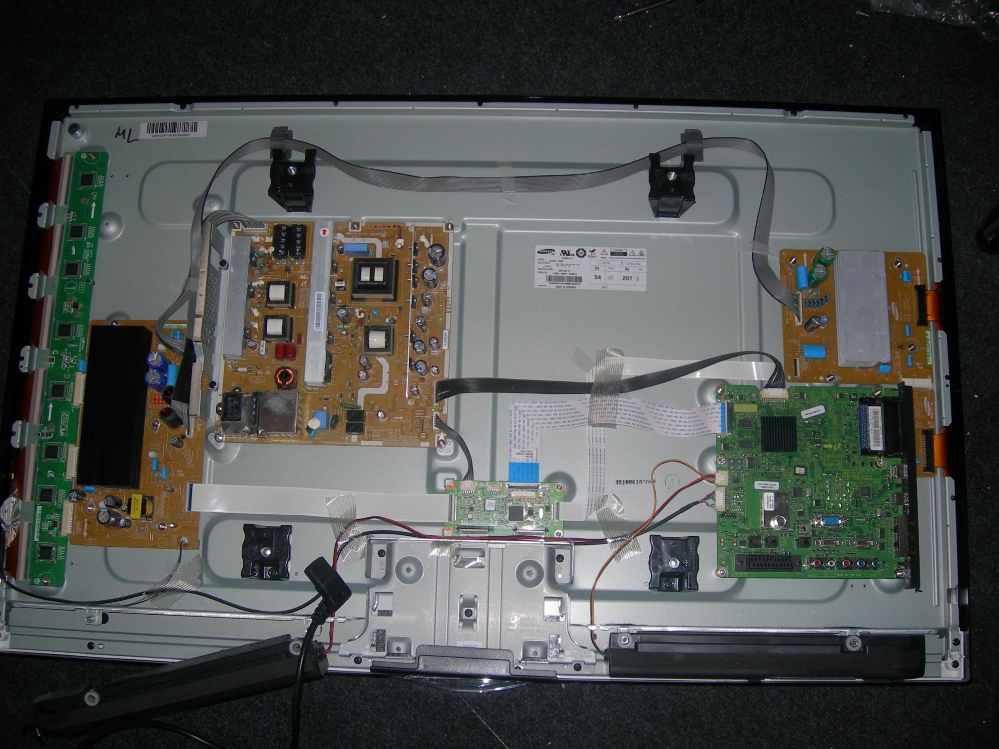

    Okay, so I got this Samsung Plasma TV model ps42c450b1wxxu off someone hoping to repair it and maybe resell it. It's about 6-12 months old - Samsung still sell this same TV! Anyway, when powered on you can hear the Samsung chime (or melody, whatever it is) but the picture is completely dark.
    That is, until you turn the lights out. Then you can see a faint glow in certain areas, and various red/green pixels flickering. There is no buzzing, apart from the faint SMPS buzz. After a few minutes, sometimes half a "no signal" display flickers on the screen, but that too is very dim (just about visible with the lights on.) The TV is fully responsive during this e.g. you can navigate menus (and the faint display will flicker slightly) and you can turn it off.
    I've heard of this problem before, so I suspect the Z-sustain (I think Samsung call it the XM board, but I'm not sure.) Am I right in suspecting this? Are these boards repairable, or are they just "black boxes" to replace?
    I found this replacement board: http://www.ebay.co.uk/itm/5288-SAMSU...item4cf84e7654
    That will cost around £40, which is pretty reasonable for this TV (retail £360), but I want to be certain it is the board that is faulty.

    The symptoms match those of a bad Z-Sustain - the board on the right side as you stand behind the TV. The board looks like it would be repairable, the problem is determining which component is bad.

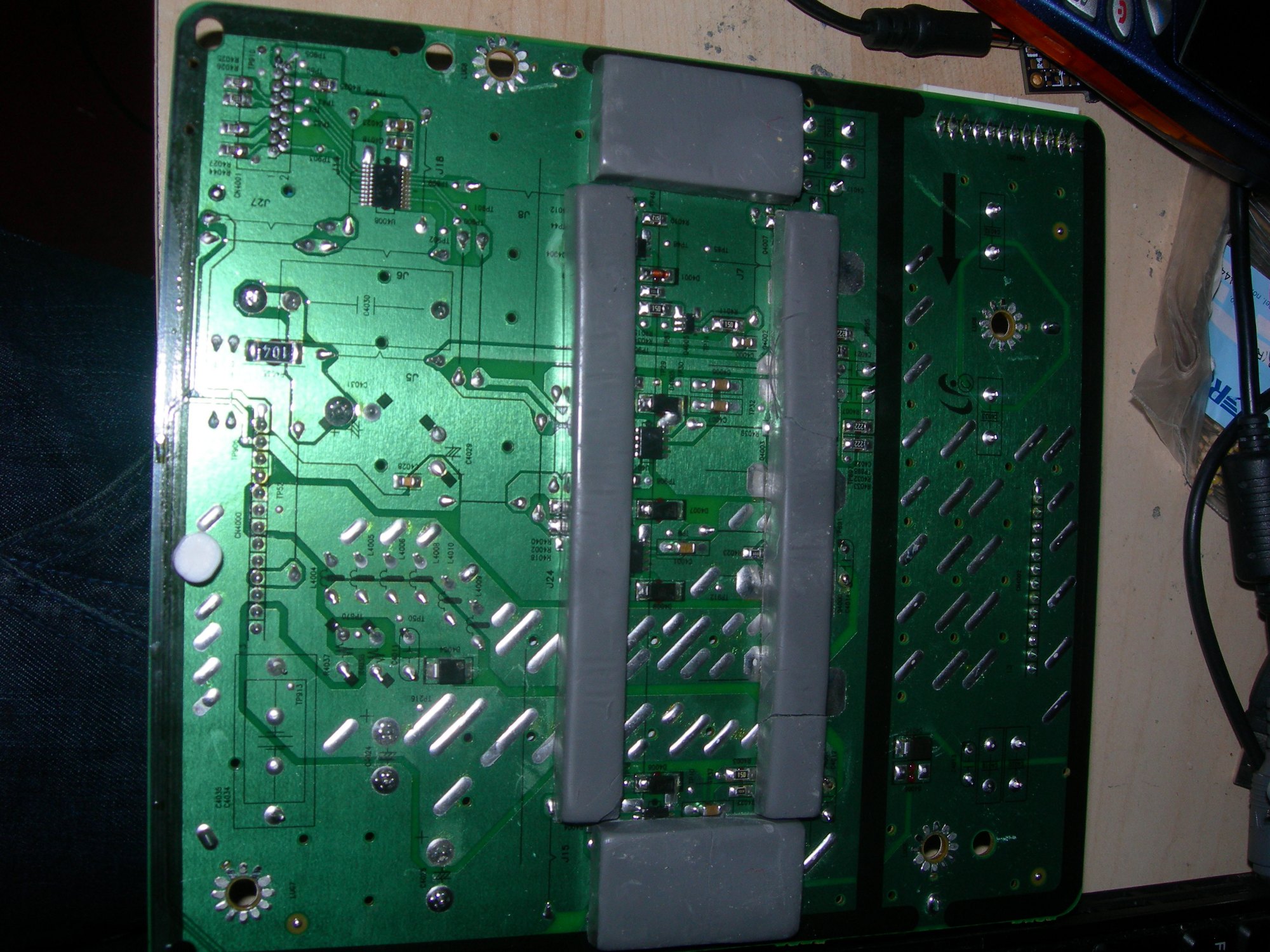

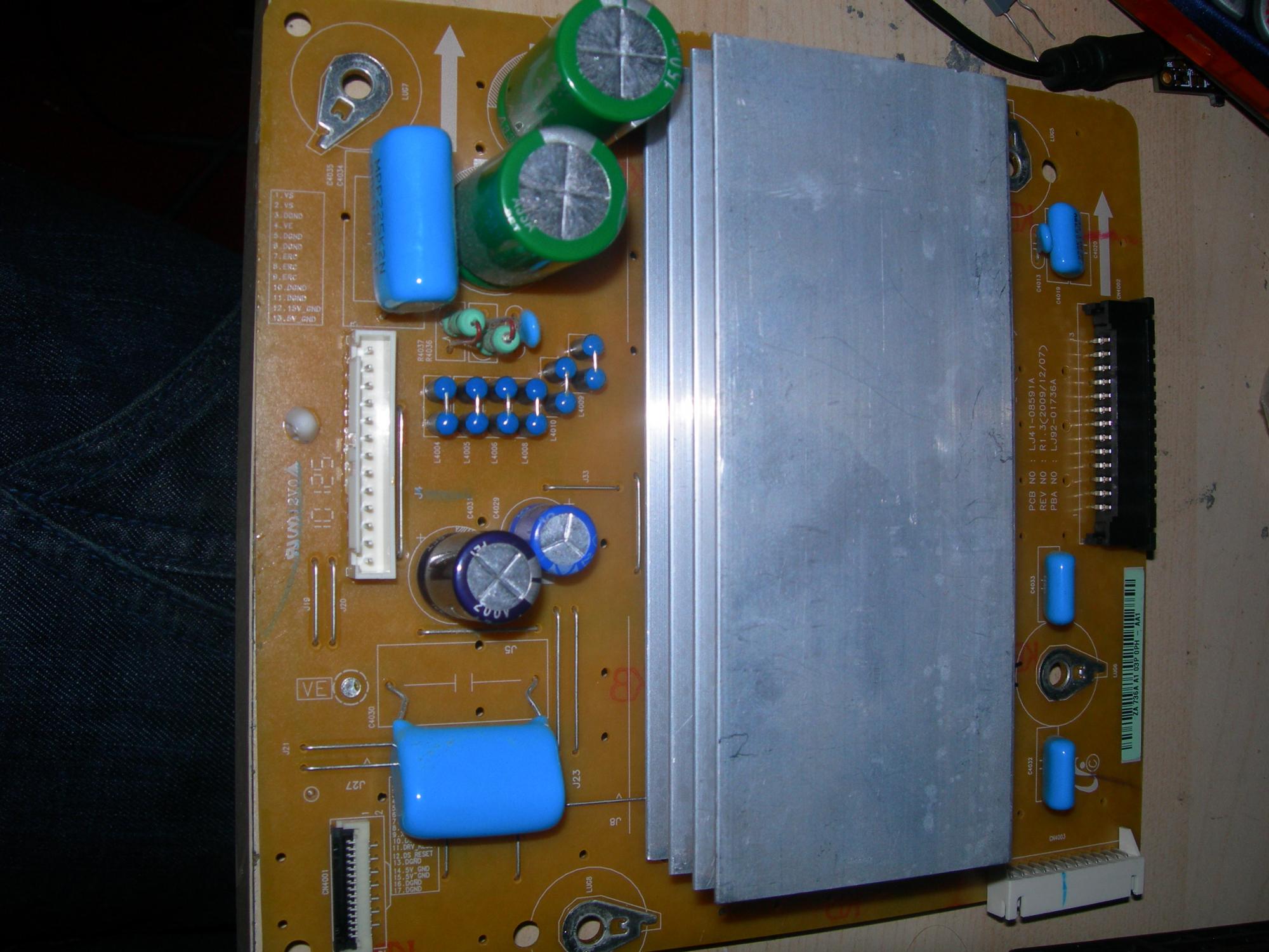

      Are there a set of tests I can do on the Zsus to determine if it is faulty?
      This was the right hand side board and it is smaller than what I think is the Ysus. I'll get an overall layout picture later.

                  Anyway, I just noticed a silly mistake of mine. I forgot to connect the ribbon from the PDP controller board to the Zsus. If you look at the overall pic you will see my mistake (I was tired last night !) Now when I plug that back in, I get the original symptoms: faint glow, random firing of red and green pixels (and sometimes white - all three subpixels at once), varying dark and light patches across the whole display and after a few minutes a faint no signal display appears. It's best viewed in the dark, although the sun hasn't set yet so I can't show that on a picture.
                  I tested the panel voltages. Vs=209.5V (rating: 207V), Vsc=-198.6V (rating -197V), Va=52.4V (rating: 54V). So those seem good.
                  Faint buzzing sound from the sole yellow transformer on the Ysus, generates the Vscon voltage.

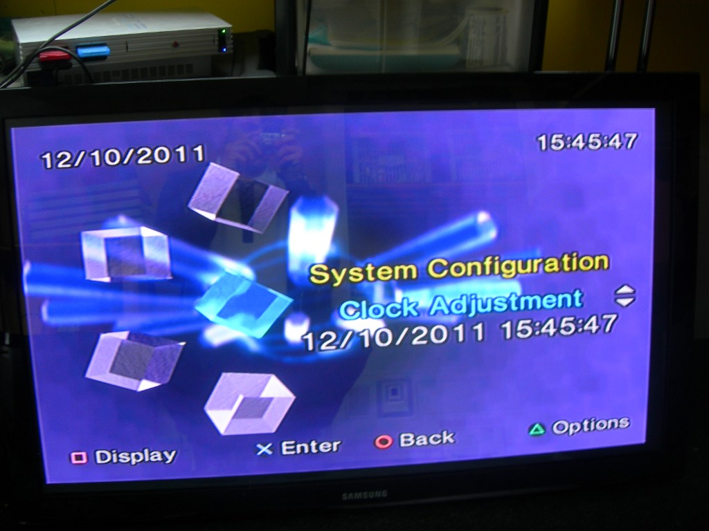

                    Anyway, before this happened, I plugged it into a PS2 for a video source, and the picture works - but it's extremely blocky. Hard to describe, but large areas of the picture freeze, and flickering lines run across the display. It's almost like a bad main board or PDP controller...

                      Okay so I removed the failed Zsus and find Q4007 is shorted, all pins have continuity to each other. It's a RJH30E2.
                      I can't find much info on this MOSFET; any ideas on an equivalent part?
                      A simple fix would be a new Zsus. I'll order that if I have no luck sourcing the right FET.

                            That seems to be a common failure point on these boards. The only place I have found that MOSFET is Electronica. The web address is www.electronica-usa.com. I purchased a few a couple days ago and they were $6.95 each. Not sure if shipping will be prohibitive or not but its worth a try.

                              I've gone ahead and ordered a new Zsus because I found a low price for one. So I will see if that fixes the problem.

                                Re: Samsung 42" Plasma ps42c450b1wxxu very weak picture
                                Great!
                                A "new" Z-sustain fixed the problem
                                TV now powers up and gives a good picture. Z-sustain only cost £14.80 (must be a used one at that price), and the TV was £50 so I'm quite pleased, a <12 month old 42" plasma TV for ~£65.
                                However, when powered on cold, the display has quite a few sparklies (red and green pixels, randomly firing.) Also, some of the pixels are "stuck", for about 10 seconds. When it was faulty, it had the sparklies too, so I'm wondering if it's a sign that something needs to be adjusted? Maybe the Z-sustain needs some settings adjusted to work with a different panel? Do I need to adjust Vs, Va, -Vsc etc., or can the required adjustments be made from the service menu?
                                After warming up for a few minutes the problem is almost completely gone, picture perfect.

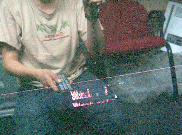

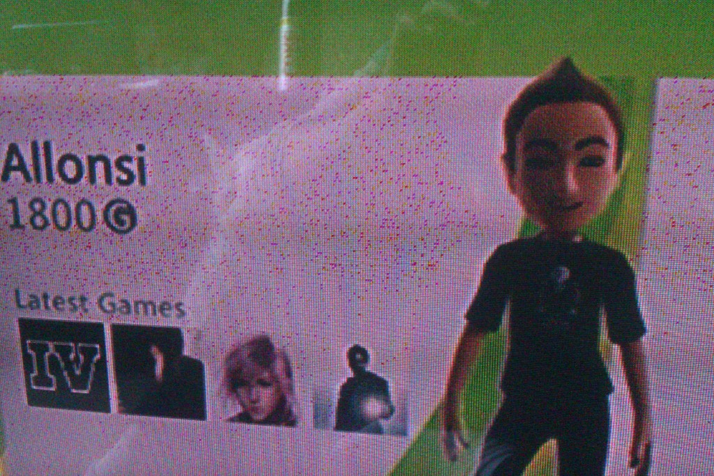

                                    Here's a picture of the stuck pixels.
                                    Odd thing: These stuck pixels appear when the picture is dim. But once it becomes brighter, the stuck pixels are erased, and they do not return until the TV is switched off for about 10-20 minutes.
                                    I'm thinking something to do with the erase control? I know the Z-sustain is involved in the erasing of the pixels, so... Is it a problem with the Z-sustain?

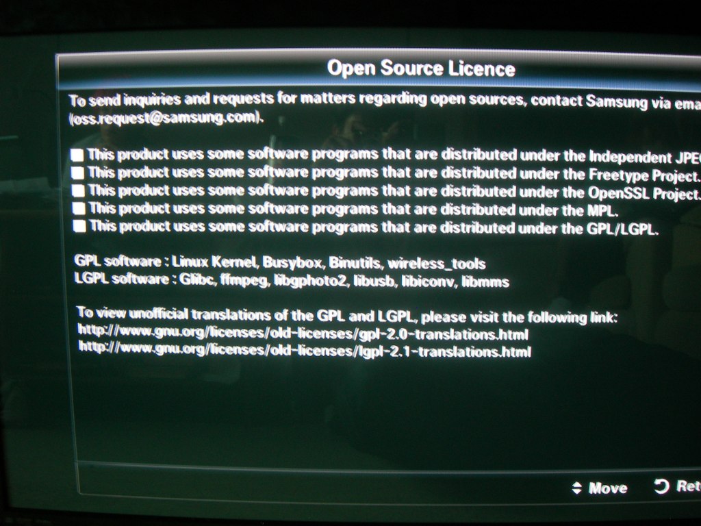

                                    Also, this TV runs Linux???
                                    That's just... overkill. I use Linux (Ubuntu) on my laptop, but I wouldn't have thought it would suit a TV much.
                                    That's interesting because a Smart TV sells for quite a bit extra. I'm wondering what the difference is between them, given this one seems to have a quite powerful processor. Although the #1 complaint I hear about smart TVs is they are sloooow...
                                    Uses a lot of open source libraries, too.
                                      Well, I see two controls, Yfr and Yrr, on the Y-sustain.
                                      I adjusted Yfr one way and the picture persistence got worse; I turned it the other way and it improved slightly. Could this be my issue? Bad timings?
                                      I could check the timings with my scope, just got to figure out the high voltage stuff. Don't want to blow it up.
                                        Left the set off all night, then turned it on this morning: No problems with persistence any more! So adjusting Yfr fixed the problem after the Zsus was replaced.
