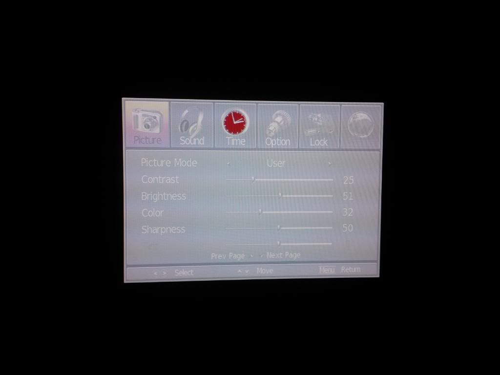

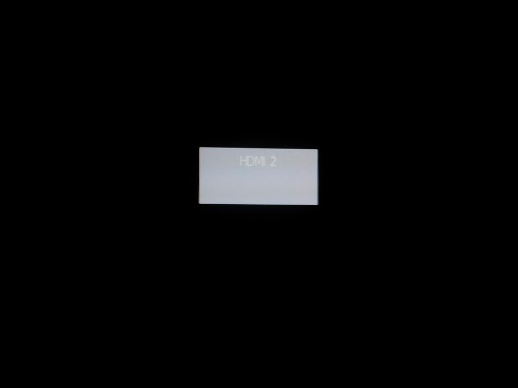

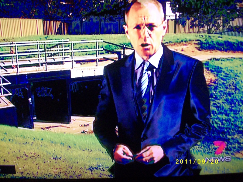

    ok, I have a SANYO LCD 37XR9DA Full HD TV. It's actually manufactured by Xoceco and from I've seen parts seem to match the DYNEX brand LCDs.
    The panel is an AUO (AU Optronics) panel and TCON board T370HW02 V7. BUILD Date of the TV is MAY 09.
    Starts and works normally except the entire display is like a colour photo negative.
    all inputs, same result.
    If I plug the AV out to a Tv then the output is correct on the external TV so I'm thinking the main board is ok.
    I've reseated and manipulated the LVDS cable at both the Main board & TCON board with no change.
    reseated flat ribbon cables to the panel and no change either.

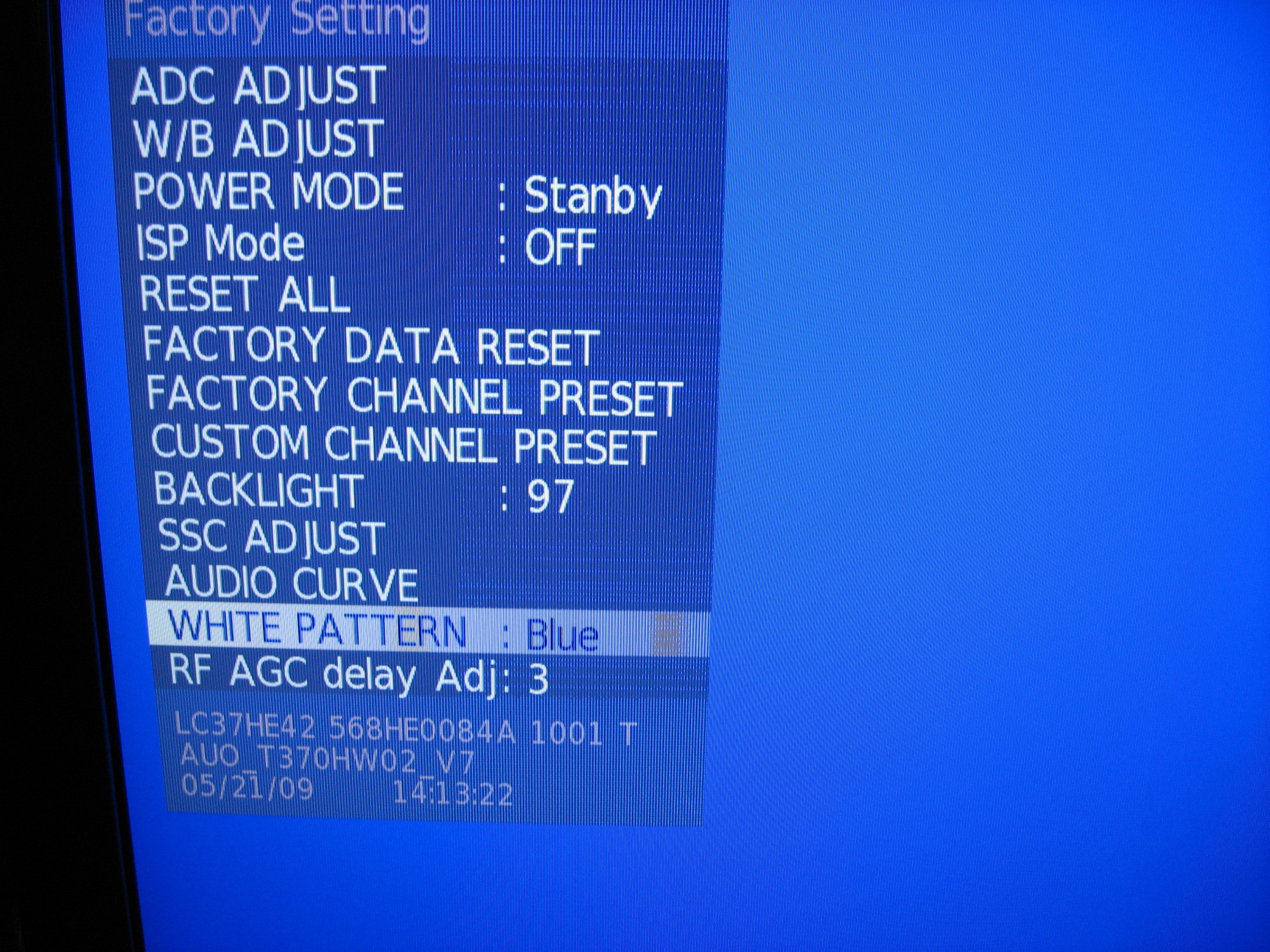

    In service mode, white, red,green,blue and black test patterns appear good.
    the pop-up menu appears ok and sharp enough although I think the colour is slightly wrong. Pure black or white displays ok.
    The AS15-F LCD driver chip is getting too hot to touch and the AUO-043 chip also gets pretty warm with signs of discolouration of the markings.
    Something else I notice is there are no heatpads attached to the chips. There's are V402 board I've seen which appears identical to the V7 which does have pads attached to all the major chips.
    I'm wondering if this may have caused this board to fail, assuming mine is faulty which I'm yet to prove.
    I'M THINKING IT'S THE TCON (AND HOPING)
    Anyone have some experience with this kind of problem?

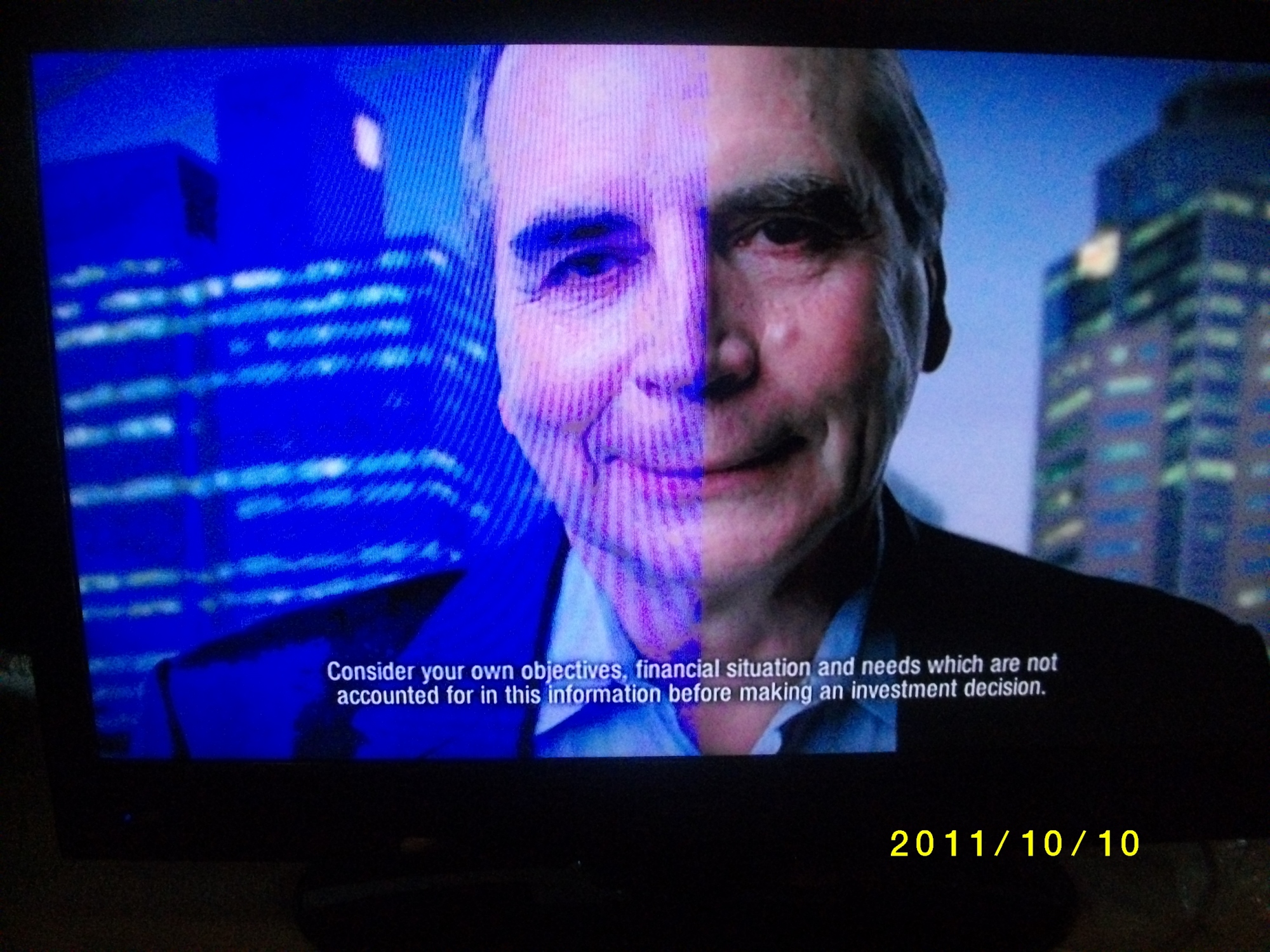

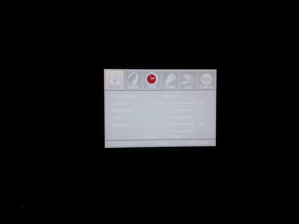

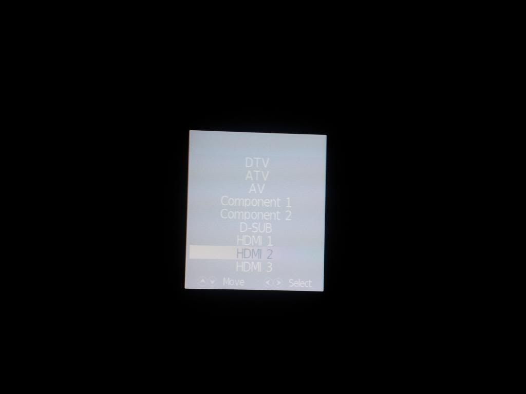

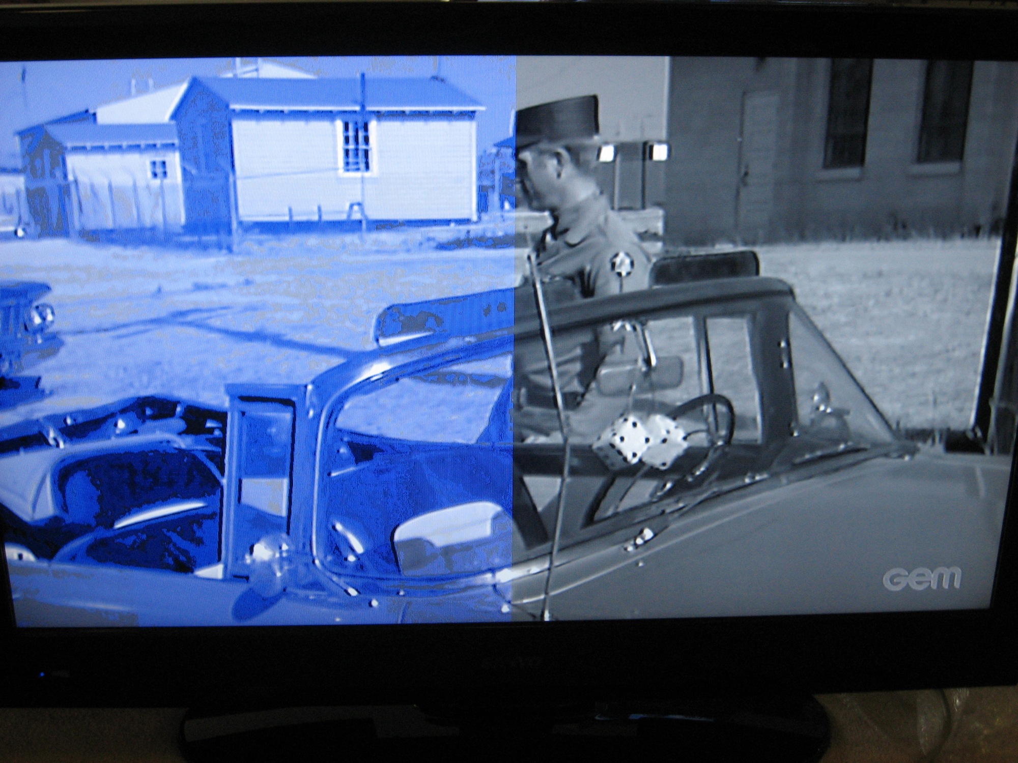

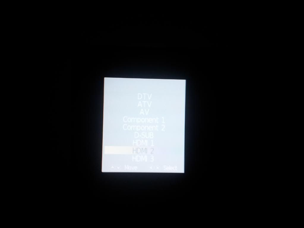

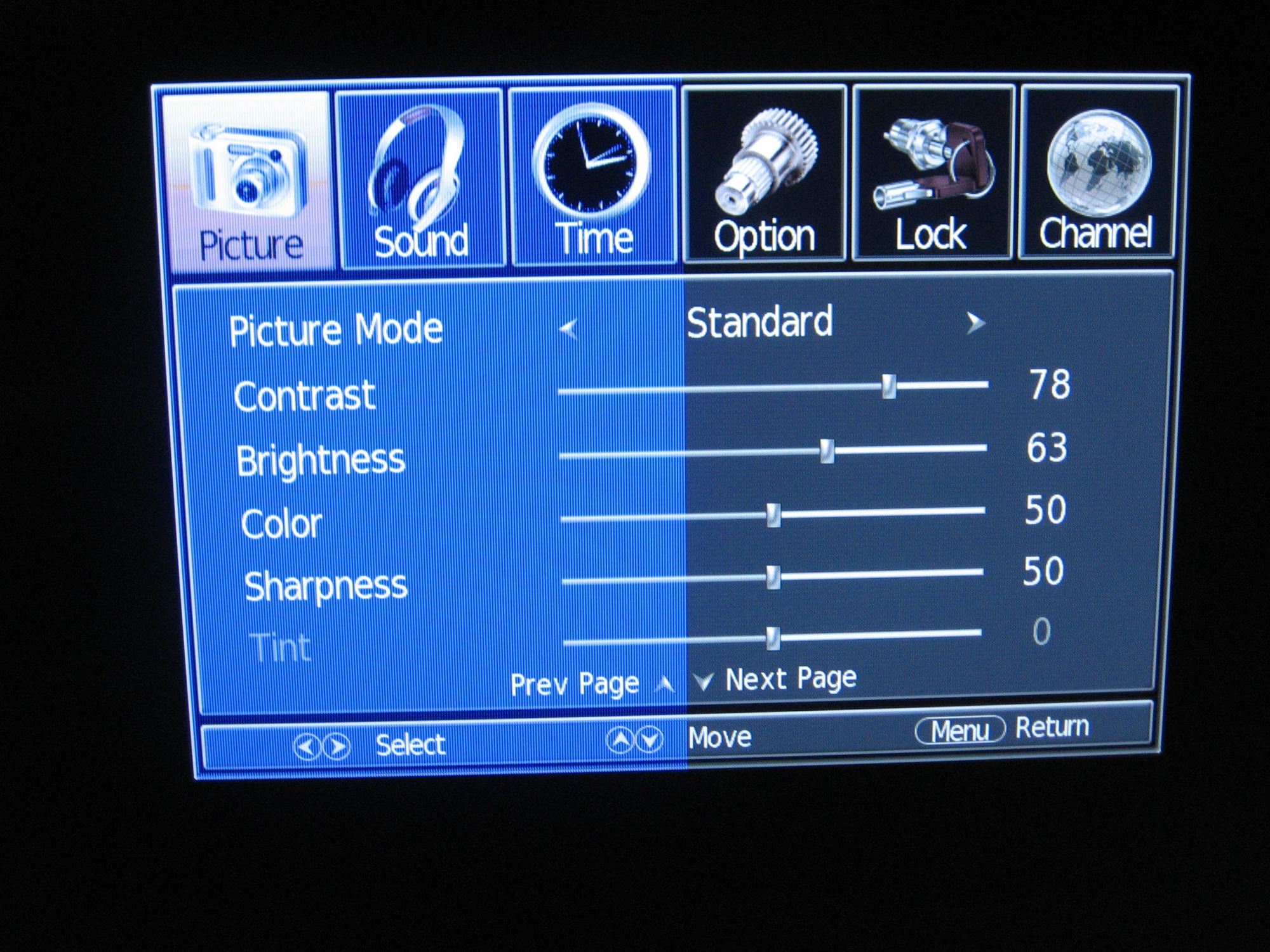

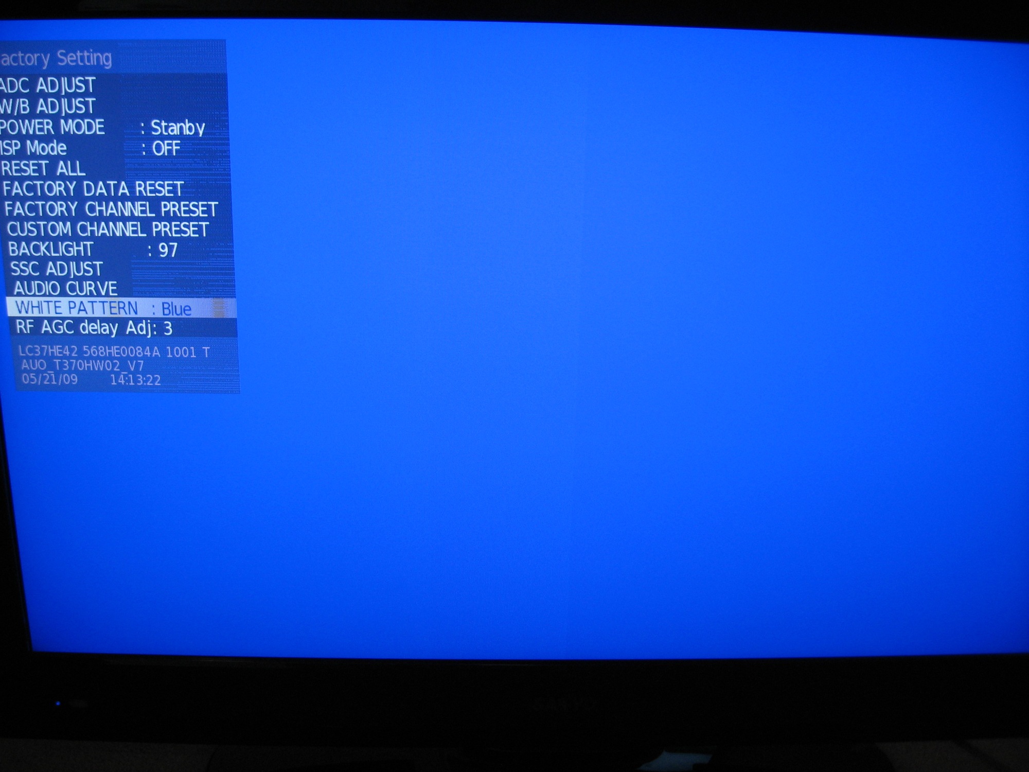

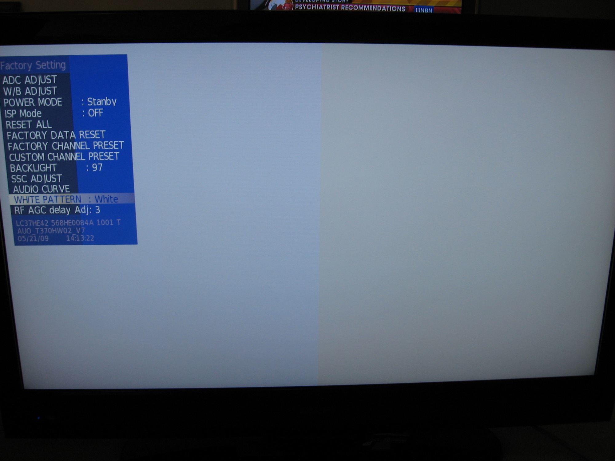

        Here's an update at where i am at with this TV. Managed to find a used TCON online. This is now the result I have. As far as i am concerned this confirms my original TCON was faulty and the cause.
        But now I have this result. There are 2 connectors, and I believe the output from J1 on the replacement TCON is also bad. i.e. the replacement TCON is a dud.
        Notice the menu/service OSD is now the wrong colour and the variation in the white screen on both sides. right seems a little off white?
        Can someone definitely confirm I am correct to say the panel is good and the TCON is still bad? It looks that way to me.

                        • PlainBill
                          • Feb 2009
                          • 7034
                          Re: Sanyo lcd-37xr9da picture negative, abnormal display
                          If replacing the tcon fixed half (one side?) of the screen, I'd say that confirms the problem is the TCON and not the panel.
                            PlainBill
                            Thanks. You're the first person to apply the same logic as myself and suggest TCON fault with the evidence to date.
                            Hope to post some good news here soon but I will not be surprised that I get another dud. If it does go well I think I'll heatpad all the chips to the metal cover as they appear to have done on the T370HW02 V402 TCON.

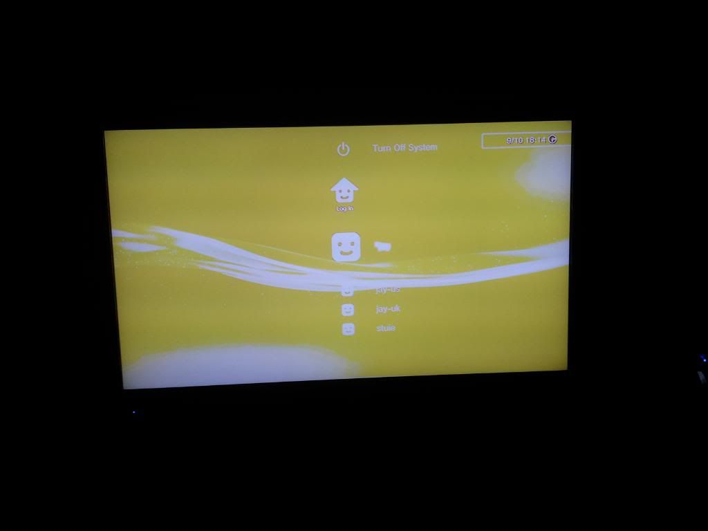

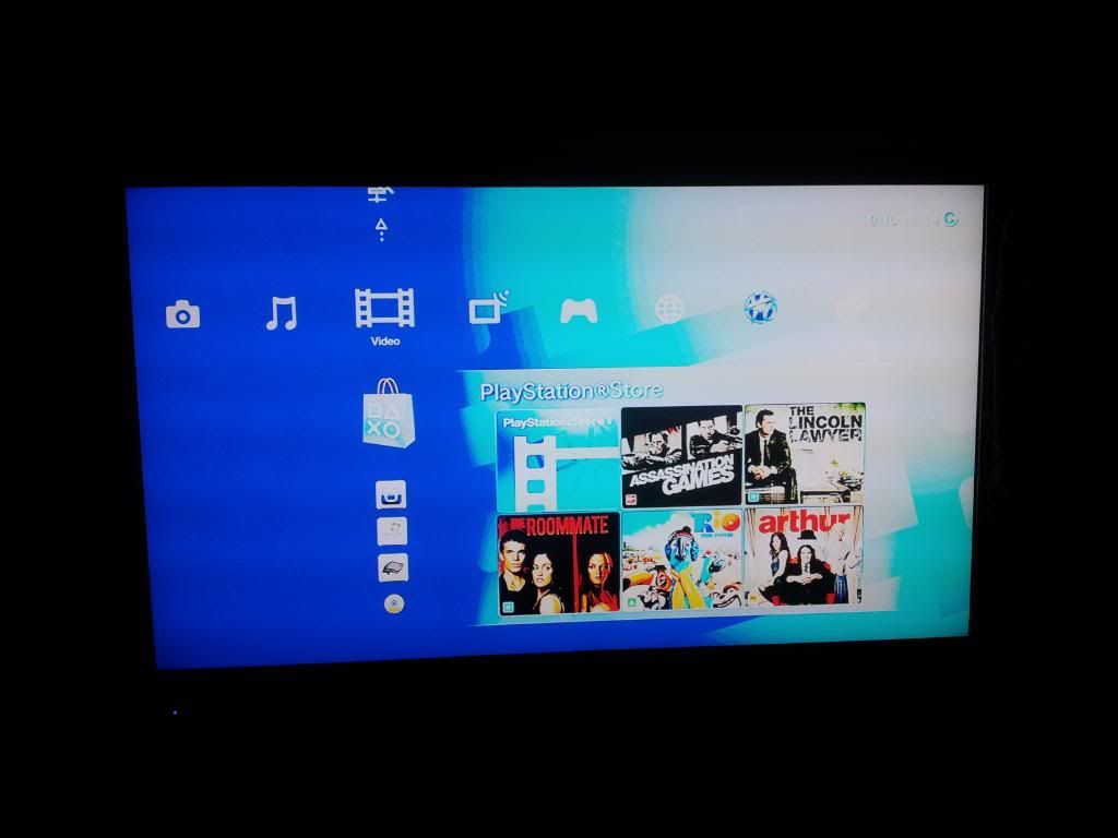

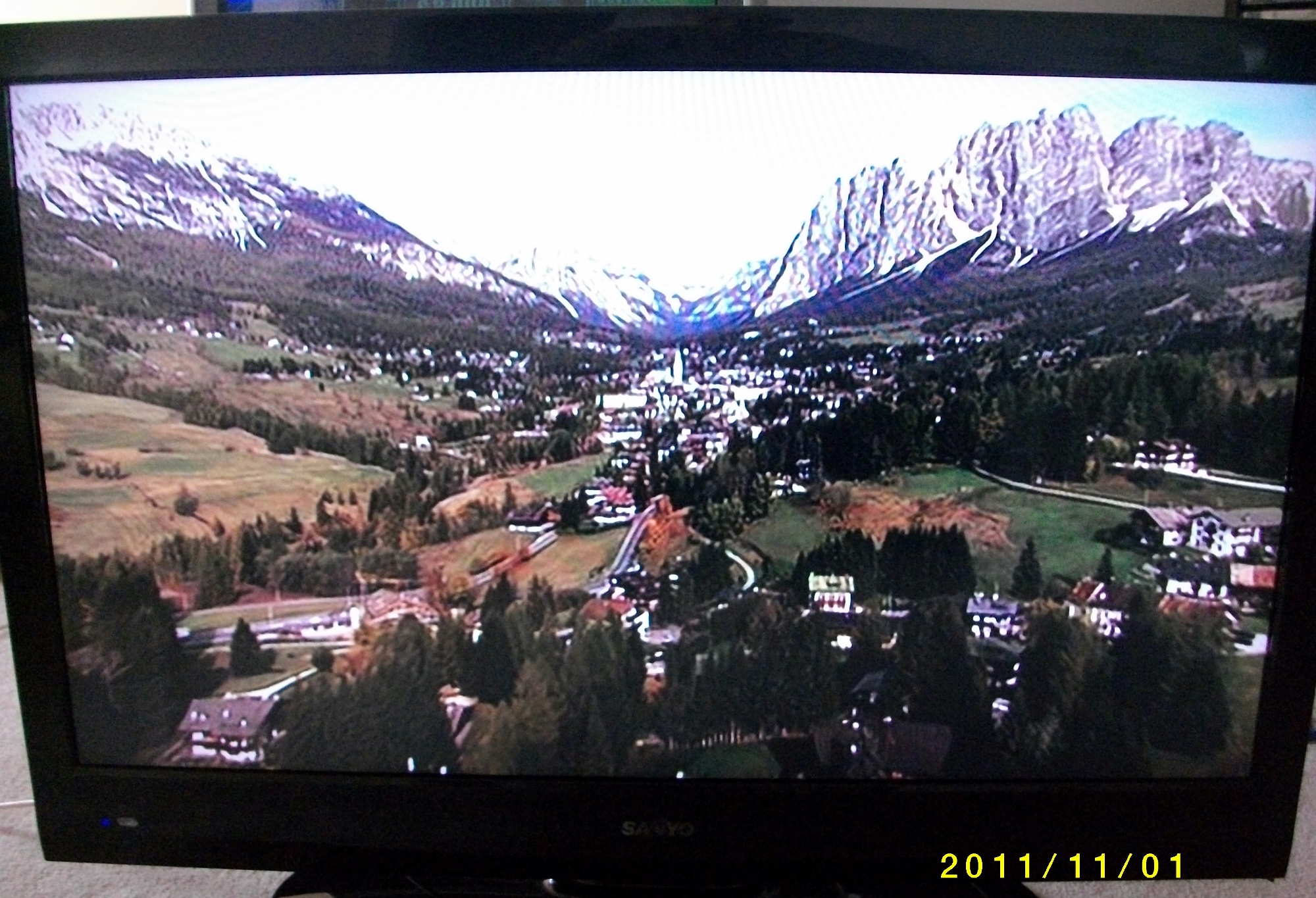

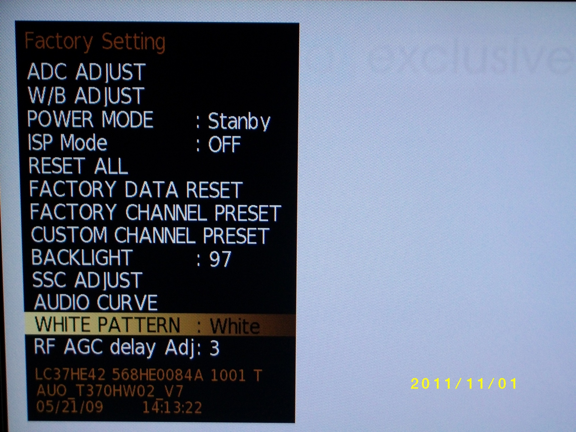

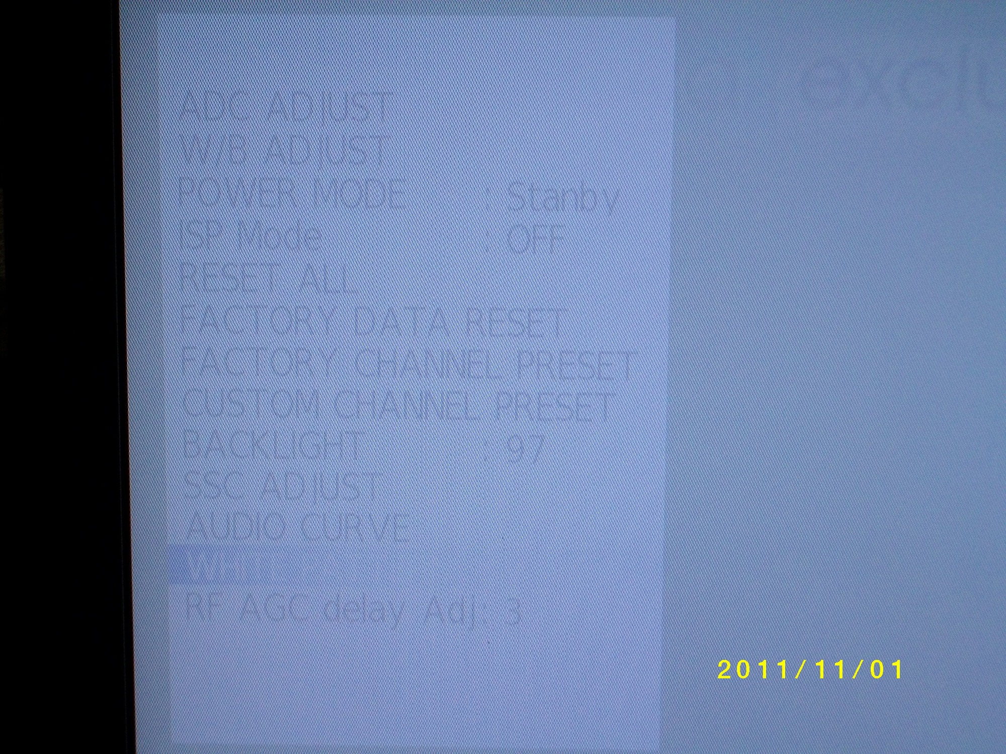

                              Ok, the good news / bad news with the latest TCON. The good is I now have a complete picture which is viewable. The bad is I have the brightness up pretty high to make it ok, plus for want of a better word "image burn?"
                              Basically I'm getting after images especially on anything that has been a still image similar to what can happen on the PLasma screens.
                              It does not happen for the first minute or two but once the set warms up (I suspect the TCON getting hot) it happens quite easily and does not clear.
                              Here's some shots.
ID:	1899307Original TCON, Click image for larger version
ID:	1899308 First replacement with half good/half bad.
ID:	1899311 complete picture which seems okClick image for larger version
ID:	1899309Service menu white screen. Note the after image word "exclusive" leftover.
ID:	1899310 after image from the service menu.
                              I'm going to pull this set apart again and put the second board with half screen ok and see if I can replicate the after image there as well.
                              Has anyone seen this before? I thought it was only plasmas which have this problem. It's as though there is some residual current left in the TCON circuit from the previous images?? Sounds crazy I know.
                              The funny thing is the picture is watchable as long as you don't get a still image on screen for too long.
                                Many LCDs have problems with temporary image retention. If a static image remains on the screen for long time, it "burns in". However, the burn in is temporary - a few flashes between white and black is usually enough to clear it.

                                  The still shot does not have to be on for too long for it to occur. Am I worrying about nothing or could a slightly sus tcon do this as well?

                                    How long is "not too long"? My LCD I repaired (42" 720p) starts showing retention after about 30 secs - 1 minute.

                                      About 30 secs would be on the money maybe a little shorter.
