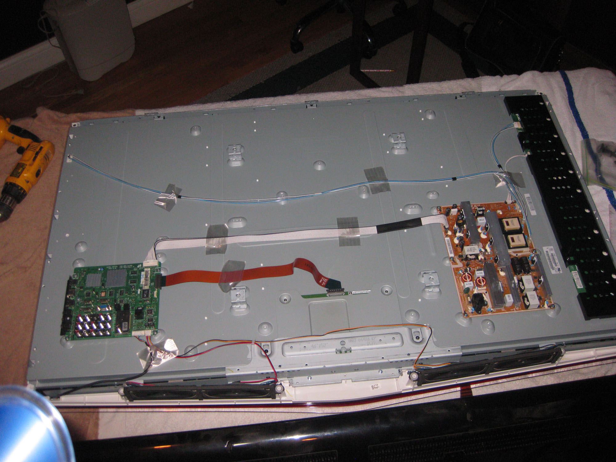

Samsung LN55B650, No power, standby LED on

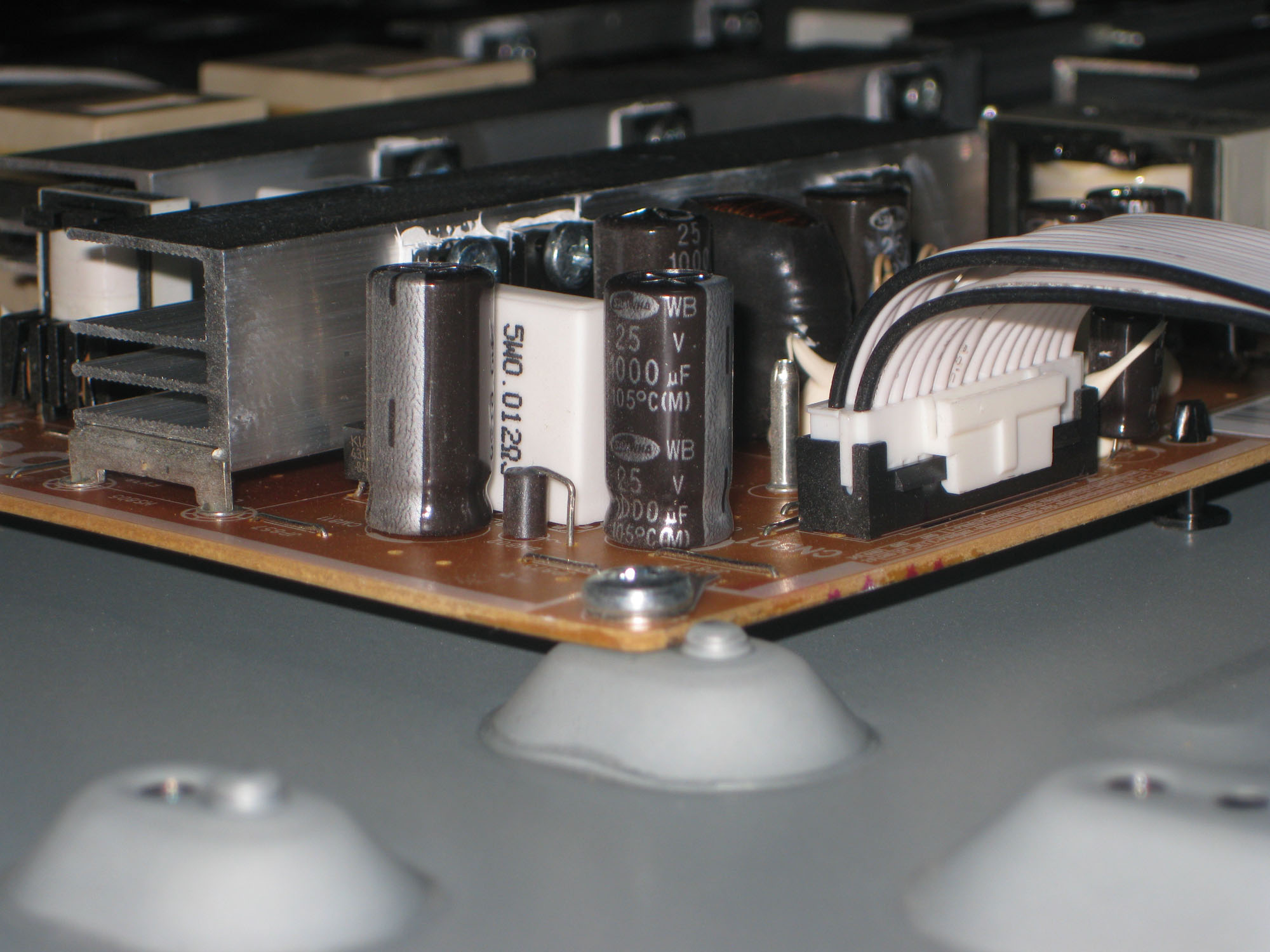

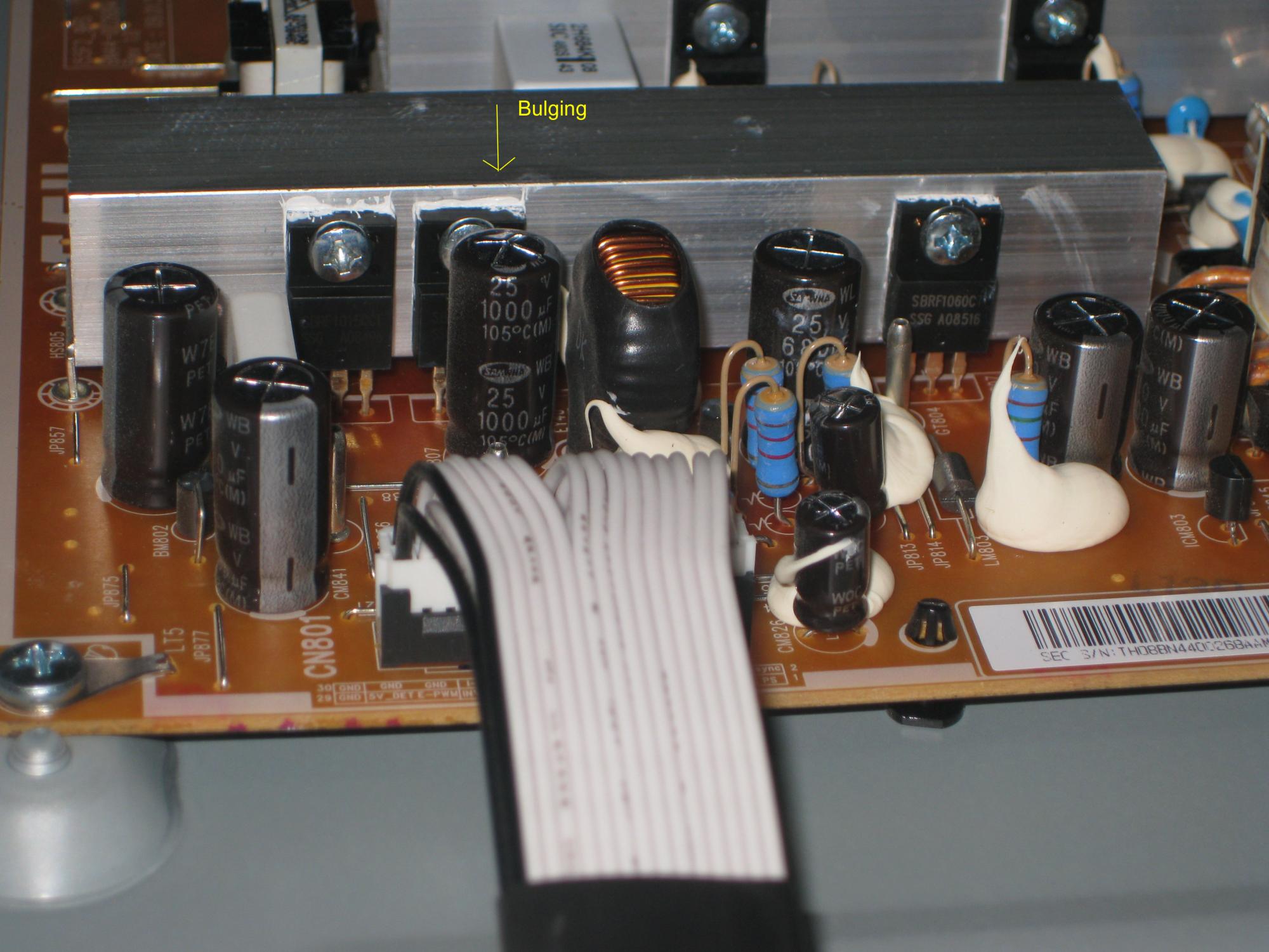

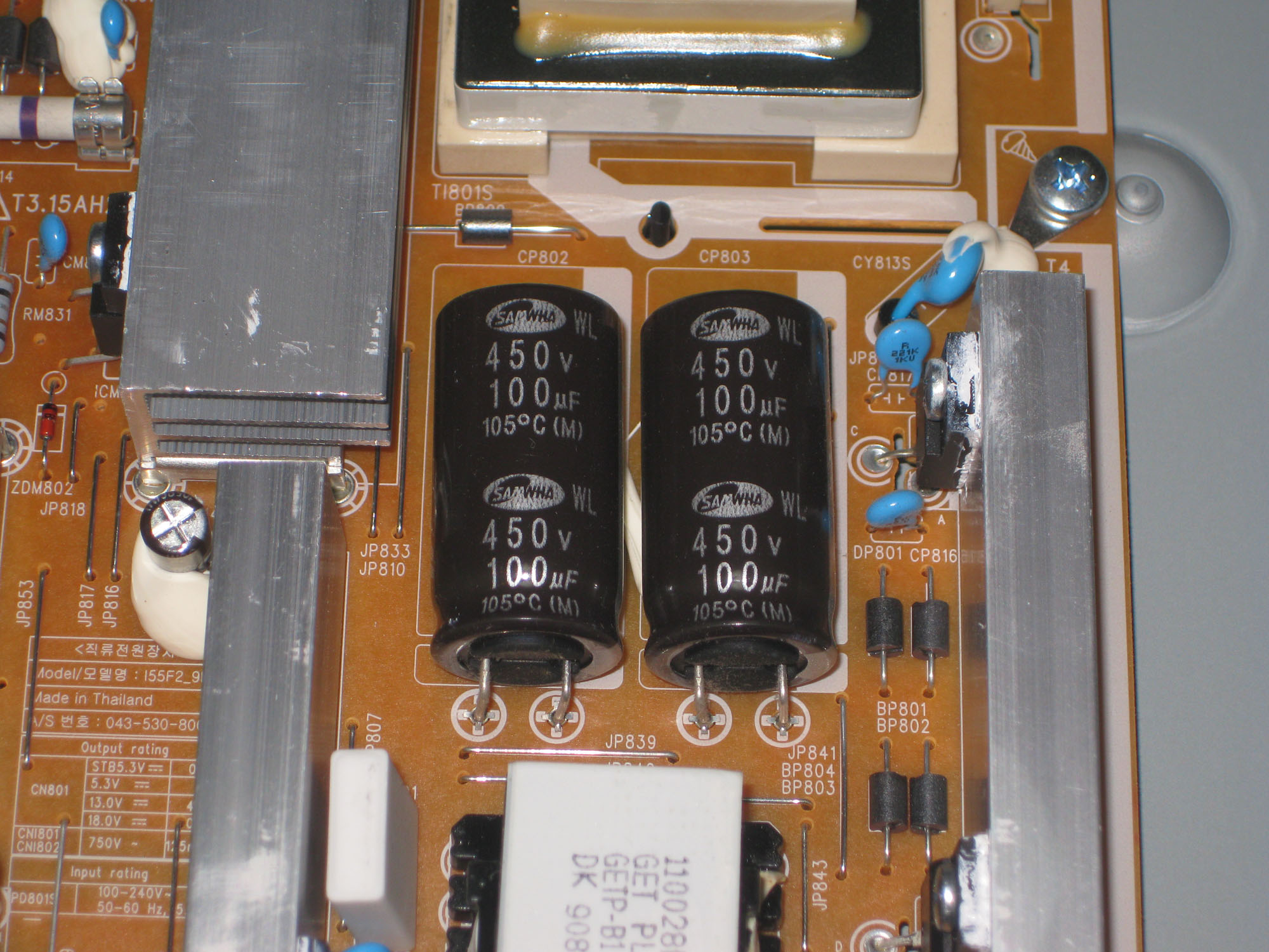

    I need some advice on troubleshooting this 15-month old Samsung LN55B650. Storms yesterday caused power surges and apparently caused this failure. One cap is bulging as seen in photo 6. When plugged in, there is a very low repeating buzzing sound coming out of the IP board which is on for two seconds then off for a couple seconds. My (dumb, newbie) three questions are:
    Do I have a blown fuse? Based on research here, it appears a main board replacement is necessary; How can I confirm this? Should I replace all the caps on the IP board regardless?

    I doubt a fuse has blown, its either capacitors on the psu or the main board has blown.
    if your handy with a multi meter, some of the guys here will run you through checking voltages on the psu.

      Thanks for the help. After a review of the IP board, all the caps are Samwha, Series WL and Series WB. There are (13) caps on the board. I'm planning to replace them as follows from biggest to smallest:
      1.
      2x WB, 450V, 100uF, 22 mm D x 35 mm H replaced with new
      2x Panasonic TS Series, 450V, 100uF, 22 mm D x 35 mm H, Digikey part #P7427-ND,
      2.
      3x WB, 25V, 1000uF, 12.5 mm D x 20 mm H replaced with new
      3x Panasonic FM Series, 25V, 1000uF, 12.5 mm D x 20 mm H Digikey part #P12379-ND,

        For the beginning, try with the bulged guy (1000uF/25V). Even better: put 35V instead 25V since there's a lot of space on the board. Don't forget that all caps should be 105°C, just in case

          I got the new replacement caps.

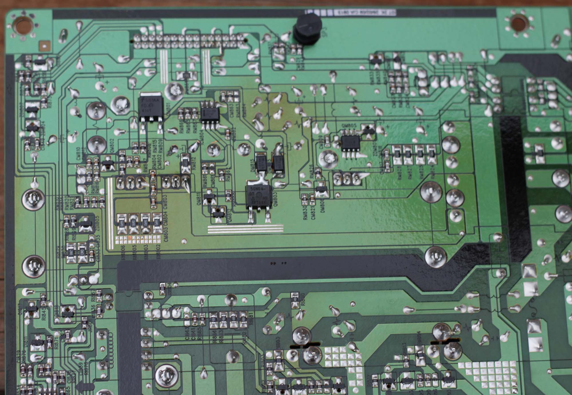

          On the bottom of the power board, there are a couple of areas about 1 cm square in size that are discolored. It looks like a heat issue. One is centered on a resistor on the other side. Is this indicating a problem?

            After a couple hours practice, the bulged cap got replaced to no aval. Next, checking the power; when I disconnect the connector from the power board to the main board, the TV backlight comes on and stays on. According to the troubleshooting manual (p.4-7), the next step is "Does proper Standy-by DC A5V appear at BD0229?"

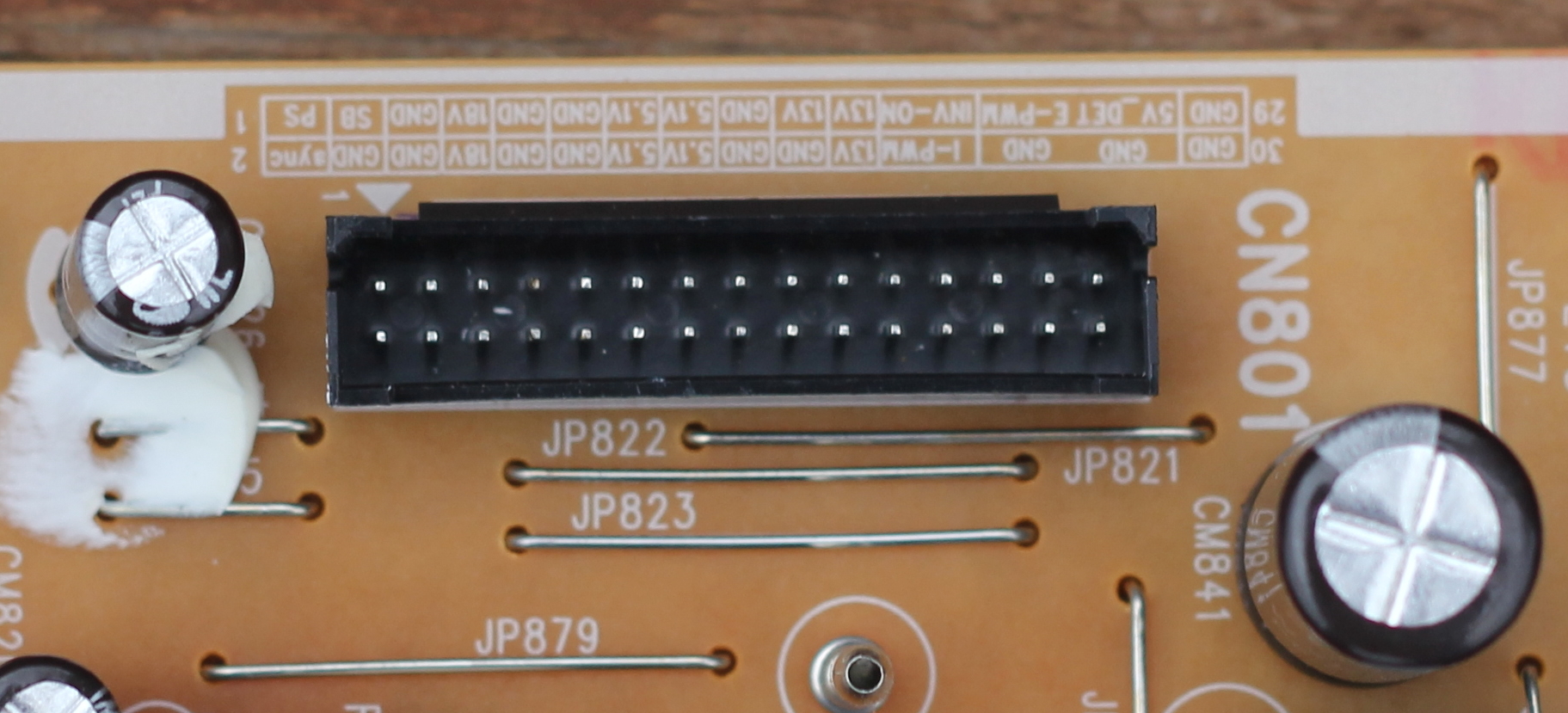

            Not knowning what this means; the voltage on the power board at the second pin labeled "SB" is 5.21V. It doesn't change when trying the power-on button or remote.
            I checked the other 29 pins and the voltages appear right except maybe for pin 1 labeled "PS" at 0.75V and pin 12 labeled "INV-ON" at 3.77V.
            Any help, specifically how to find and check voltage at BD0229 would be appreciated.

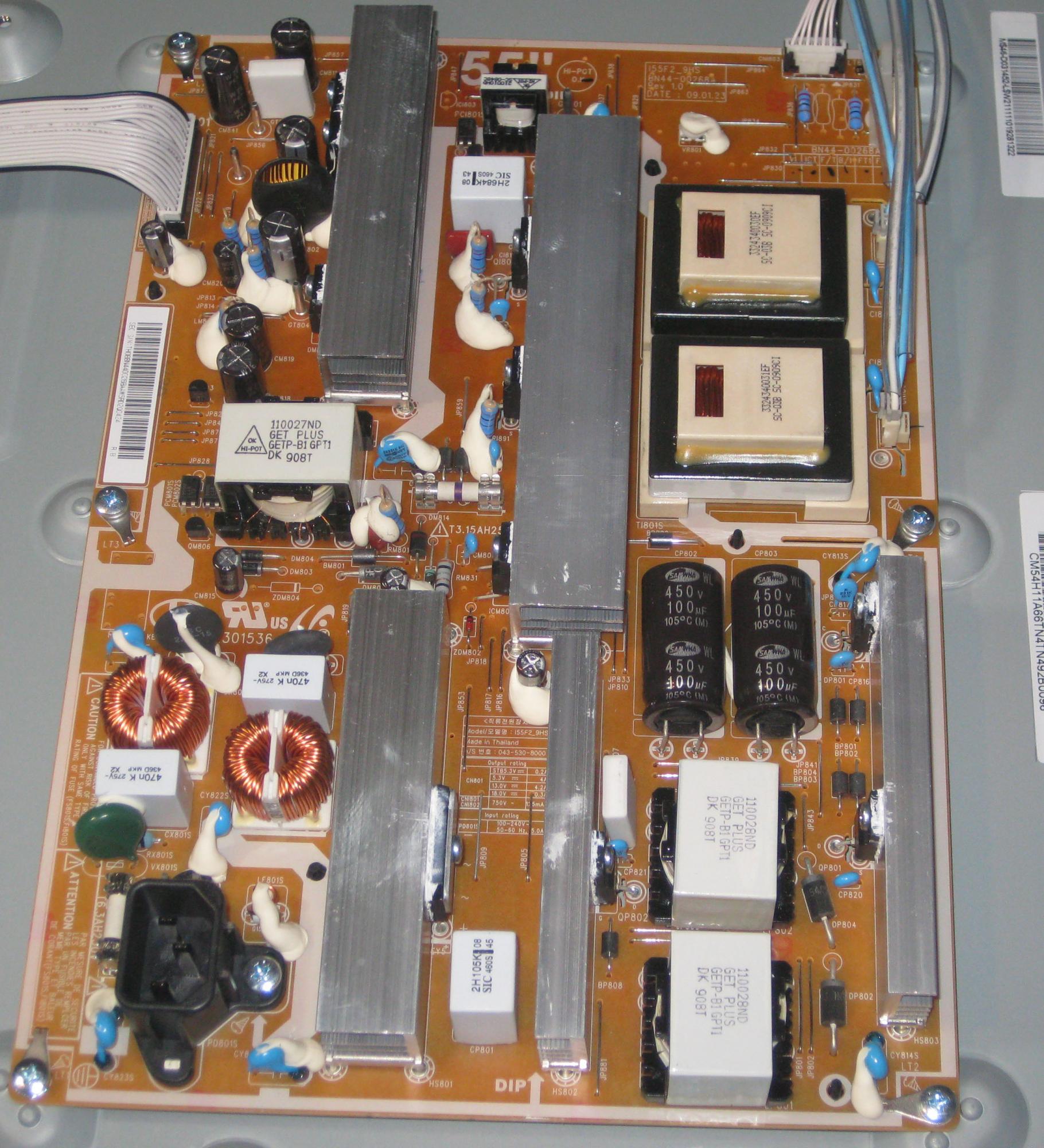

              Let's take things in order. Samwha caps aren't the best. They usually are pretty good, but some production runs are known to be bad. Did you replace all the caps on the board, or only the one bulging one? I would have suggested replacing the three 1000uF, 25V caps.
              The discoloration is not likely to be a problem, it depends on how severe it is. A slight discoloration is common, one area the shade of chocolate in an otherwise beige board would be of interest.

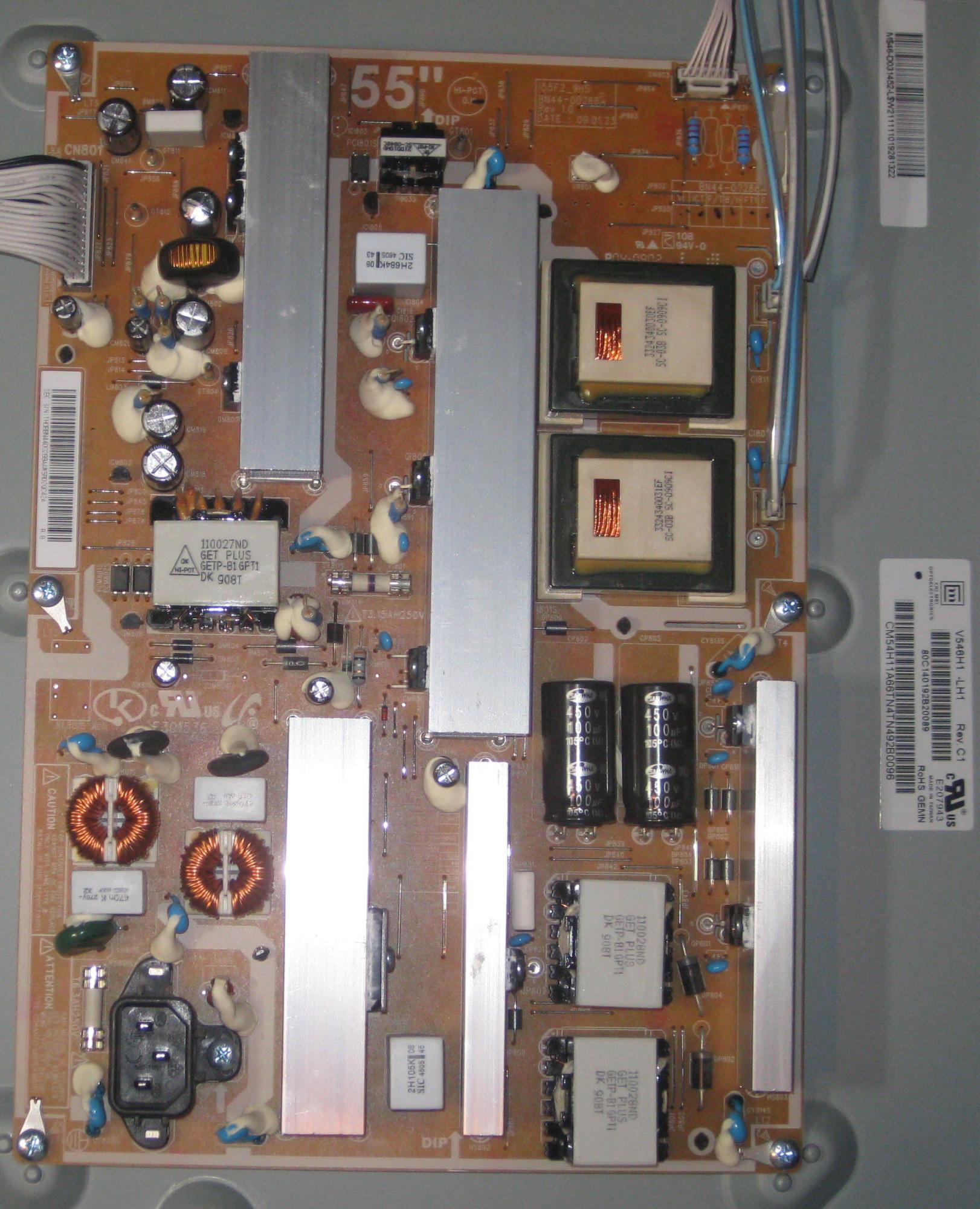

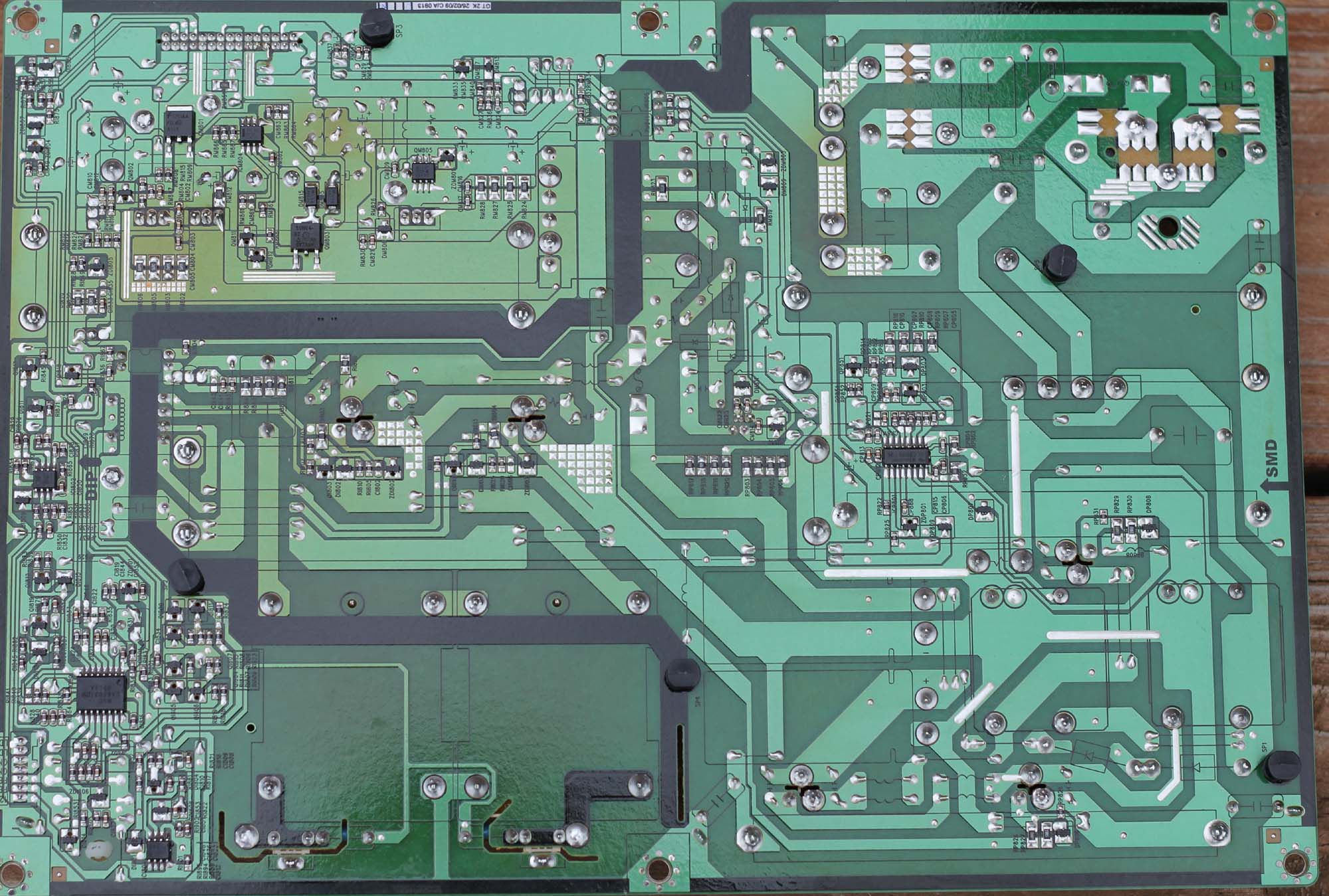

              You are correct, a new main board may be necessary. Depending on the nature of a power surge, you could spend a long time chasing problems. But let's get the power supply issues sorted out first.

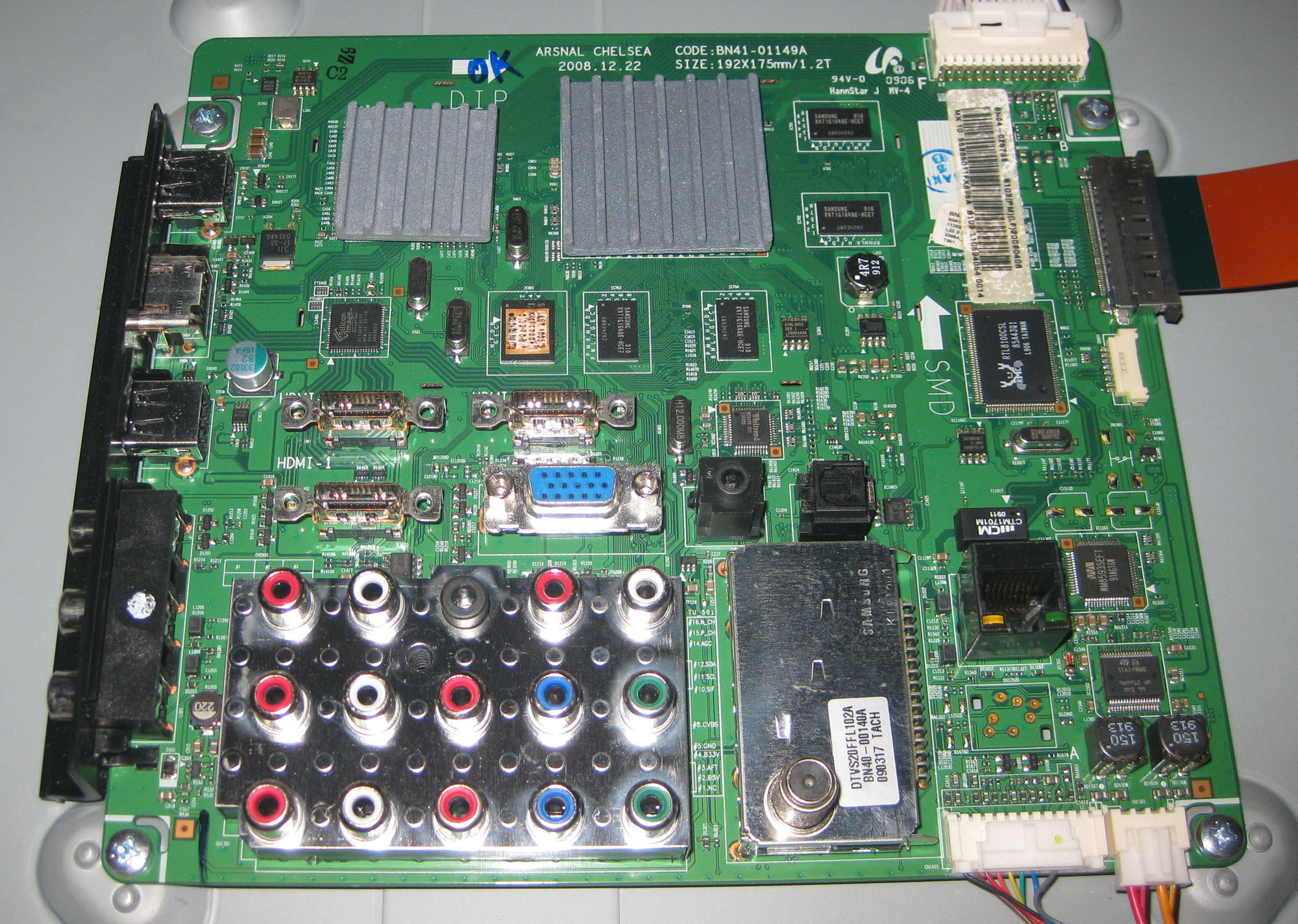

              And I would like a few additional pictures.
              1. The output connector of the power supply, with the labels visible.
              2. A picture of the bottom of the power supply.
              3. Pictures of the top and bottom of the main board.
              PlainBill
                Re: Samsung LN55B650, No power, standby LED on
                1. Yes, I believe the voltages checked with 5 percent but I will post all results tomorrow.
                2. Attached are the requested photos.
                3. One cap was replaced and the tv was tested to no aval. I have replaced two other 25V 100uF caps but have not tested the tv yet.
                4. One of the photos shows the discolored areas on the back of the power board.
                I appreciate the help.
                Rob
                  The discolouration shown in photo #4 is nothing abnormal. Many of the components, especially power resistors like current sense resistors runs hot. Without using the proper standoff during production, it's natural to generate a degree of pcb discolouration.

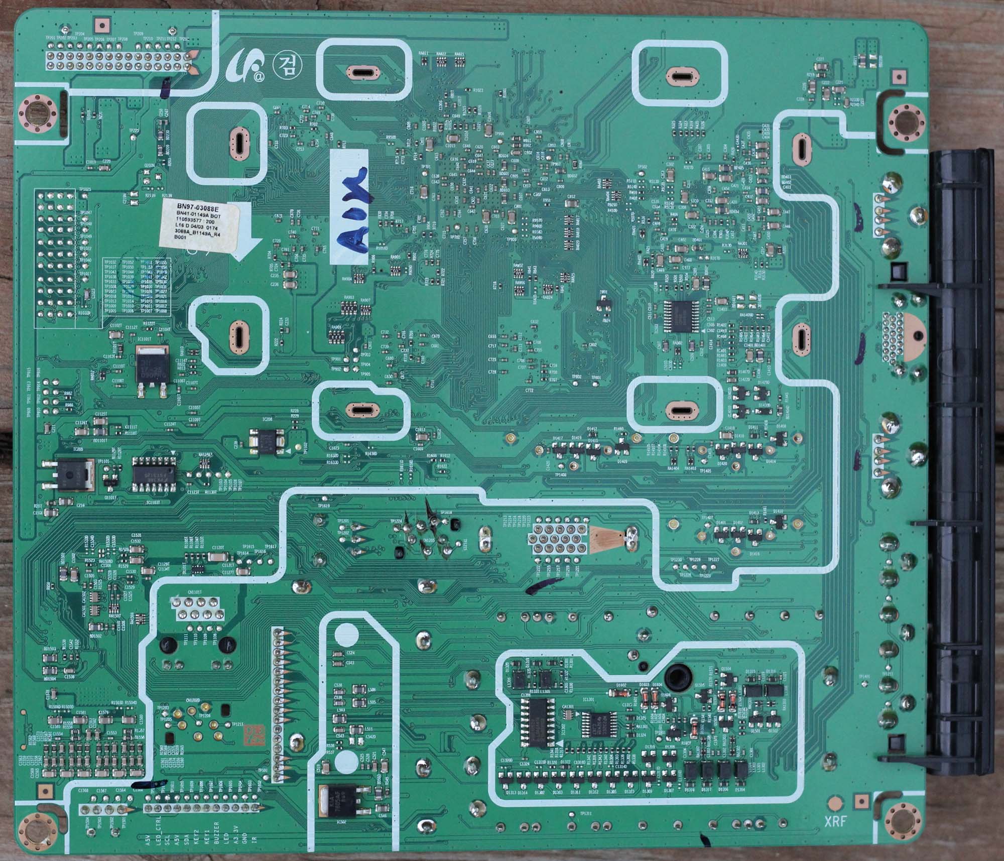

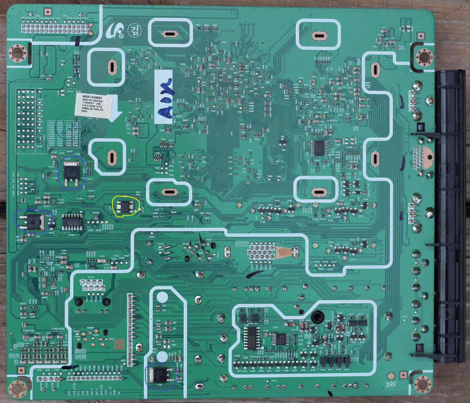

                    The power supply has an unusual number of connections, several of which I do not understand. The PS pin is the product of a voltage divider; that .75 volts is not obviously incorrect. If you haven't done so, check the fuse.

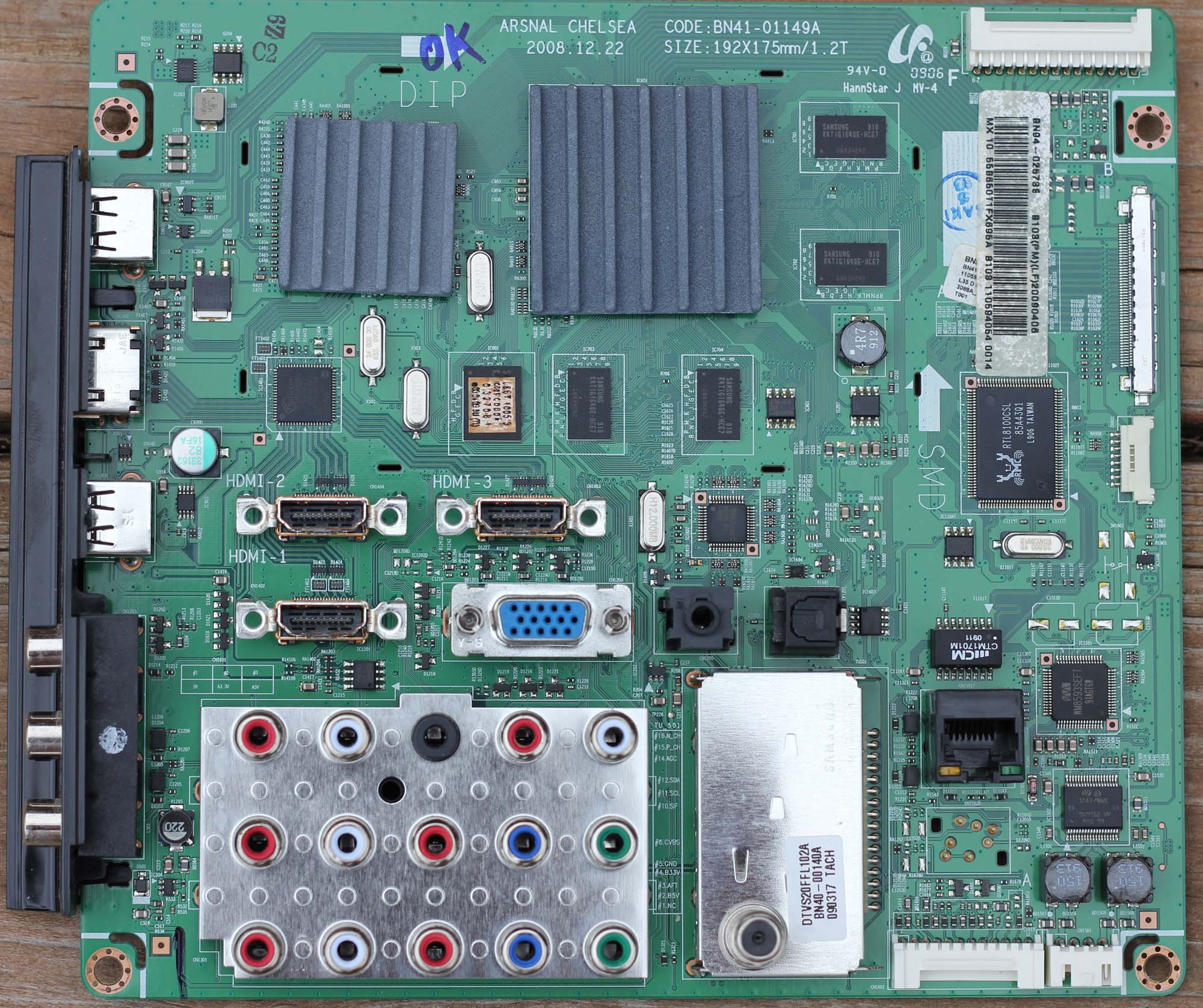

                    I've marked up the pictures of the main board. I've circled several voltage regulators in blue - one on the top, three on the bottom. I'd suggest checking the output from those; they represent the few parts that it is possible to troubleshoot.
                    I have also circled an unusual looking IC in yellow. What is it's part number?
                    One thing I find incredible is that while I can identify a few linear voltage regulators, several bucking regulators, and a large number ceramic caps, I can identify only one electrolytic cap on the main board.
                    PlainBill

                      The power supply output pins 1 through 30 tested as follows:
                      1 PS 0.75V
                      2 SYNC 0V
                      3 SB 5.21V
                      4 GND 0V
                      5 GND 0V
                      6 GND 0V
                      7 18V 18.00V
                      8 18V 18.00V
                      9 GND 0V
                      10 GND 0V
                      11 GND 0V
                      12 GND 0V
                      13 5.1V 5.21V
                      14 5.1V 5.21V
                      15 5.1V 5.21V
                      16 5.1V 5.21V
                      17 GND 0V
                      18 GND 0V
                      19 13V 12.59V
                      20 GND 0V
                      21 13V 12.59V
                      22 13V 12.59V
                      23 INV-ON 3.77V
                      24 1-PWM 0V
                      25 5V-DETE-PWM 5.09V
                      26 GND 0V
                      27 0V
                      28 GND 0V
                      29 GND 0V
                      30 GND 0V

                      To test output on the blue circled voltage regulators. I plan to connect all the cables including the power cord to the wall and I will measure the voltage across the two pins of each. Please confirm this procedure, if you don't mind.

                        The voltages look good - or perhaps I should say none of the voltages look unreasonable.
                        The IC circled in yellow appears to be a variation of the 1117 family of LDO regulators. It's obviously a 3.3V regulator.
                        To measure the output voltages of the regulators circled in blue, use the bare copper around the mounting holes as a ground point. As an example, IC1101T is on the back of the board at about the 10 O'clock position. Measure from ground to the pin on the lower left, from ground to the tab, and from ground to the pin on the lower right. IF this is the regulator I think it is, lower left is Ground, tab is output, lower right is input.
                        Of course, IC502 (bottom at about 6 O'clock) is a variant of the familiar 7800 series of regulators and should follow that pattern - input on the bottom pin, tab is Gnd, output on the upper pin (as viewed in the picture).
                        I think it bears repeating - the chances of success are slim, but let's go through the steps.
                        PlainBill
                          Four IC voltage outputs were checked; Each of the pins that indicated voltage would range from 0.00V to the voltage value listed below over a six seconds cycle. I hope this makes sense.
                          On the front of main board
                          IC204
                          Top left pin 1.84V
                          Top middle tab 0.00V
                          Top right pin 3.29V
                          On the back of the main board
                          IC1101T
                          Bottom left pin 2.60V
                          Bottom middle tab 0.00V
                          Bottom right pin 2.60V
                          IC205 (near left edge in photo)
                          Left top pin 12.9V
                          Left middle tab 0.00V
                          Left bottom pin 8.90V
                          IC502
                          Right top pin 4.90V
                          Right middle tab 0.00V
                          Right bottom pin 8.86V
                          Is this indicating a problem with these regulators?
                          Thanks,
                          Rob
                            IC204
                            Top left pin 1.84V
                            Top right pin 3.29V
                            IC1101T
                            Left top pin 12.9V
                            IC502
                            Right top pin 4.90V
                            Thanks,
                            Rob
                            Most of the voltages are easily identifiable.
                            IC204 appears to be a 1.8V LDO regulator.
                            IC1101T is either defective, or is not a regulator.
                            IC205 appears to drop the 12V input voltage to an intermediate value. No idea why.
                            IC502 takes the output of IC205 and drops it to 5V.
                            Obviously, the voltages are changing with the buzzing sound from the power supply.
                            I suspect the power surge did some major damage.
                            PlainBill

                                  With both the main board and IP board replaced, the TV is almost working perfectly. None of the HDMI inputs appear to receive a signal. Tried two HDMI cables, both cheapos, to no aval. But the original cheapo HDMI cable worked a month ago. The component input is working as a workaround for now.
                                  For the record, the main board was $150 off ebay and the IP board was $85 off amazon.
