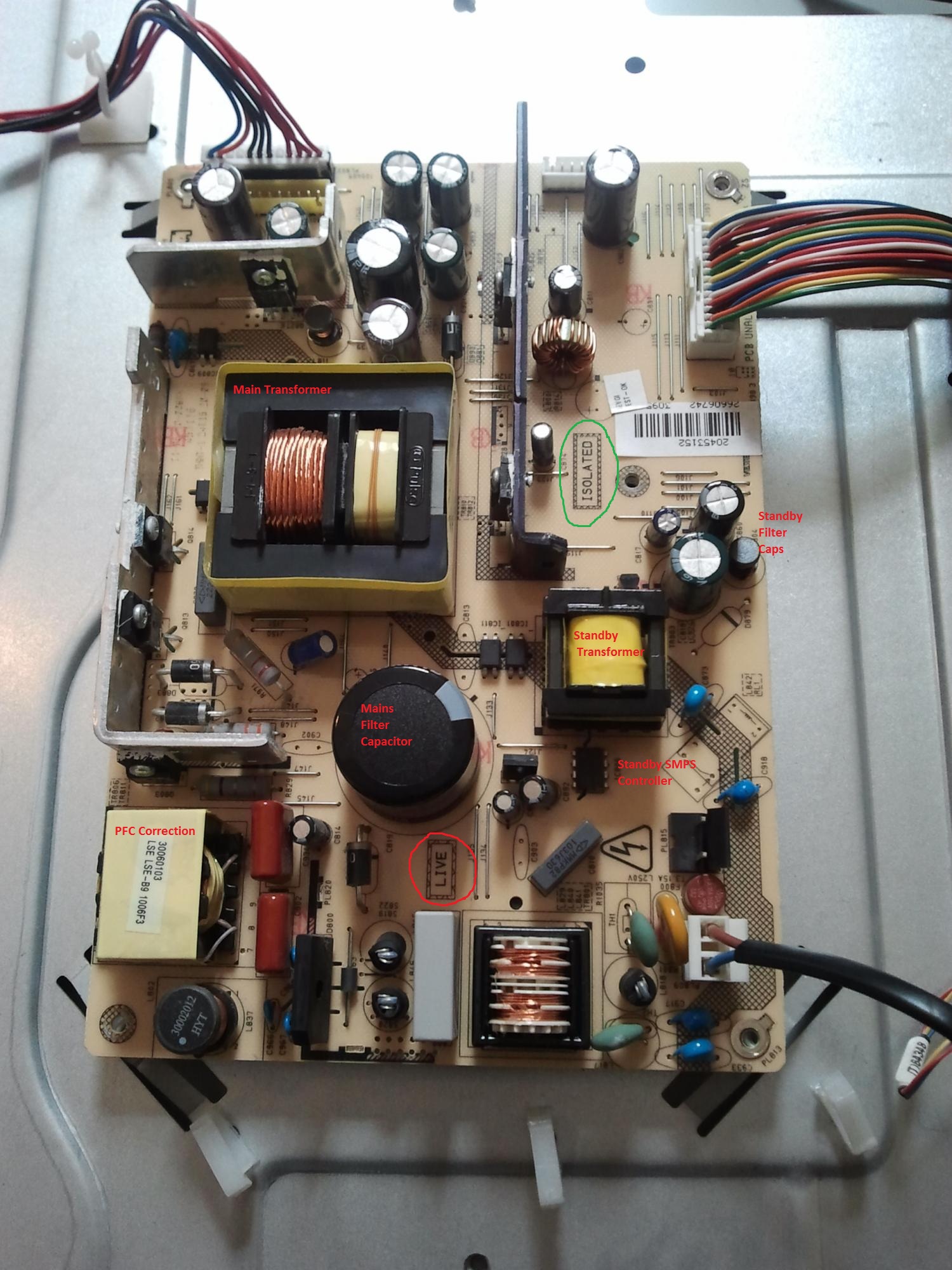

                      • PlainBill
                        • Feb 2009
                        • 7034
                        #51
                        Re: Sanyo CE37FD47 LCD No Power
                        I have labeled some parts of the power supply.
                        Since you appear to have voltage across the main filter cap, let's perform a leap and check voltages from the standby supply.
                        The only cable you need connected at this time is the AC input cable in the lower right corner. Turn the power supply upside down and measure the voltage across the three caps I have labeled 'Standby Filter Caps'. I would expect voltages in the 5V -15V range. If you get no voltage across any of those three caps, the standby supply is dead.
                        I have labeled an IC Standby SMPS Controller. What is the part number on that IC?
                        PlainBill
                        • Liam.25
                          • Feb 2011
                          • 107
                          • Uk
                          #52
                          Hi Bill, no voltage reading on all 3 of the standby filter caps.
                          the IC is labeled "DL321 VK08".
                          • PlainBill
                            • Feb 2009
                            • 7034
                            #53
                            Excellent!!! That IC is a Fairchild FSDL321L. It's a low power all in one SMPS controller and power FET. The datasheet link is here.
                            In the picture, pin 1 is in the upper left corner. With the power supply connected only to AC power, what are the voltages on pins 2, 3, 4, and 5? Do NOT attempt to measure the voltage on pins 6, 7, and 8; it could damage your meter.
                            PlainBill
                            • Liam.25
                              • Feb 2011
                              • 107
                              • Uk
                              #54
                              0 voltage on pins 2, 3, 4 and 5?
                              • PlainBill
                                • Feb 2009
                                • 7034
                                #55
                                Pins 6,7,8 are the drive for the SMPS transformer. Measure the voltage from pin 1 to pin 8 of the SMPS controller. This SHOULD be about 249 volts.
                                PlainBill
