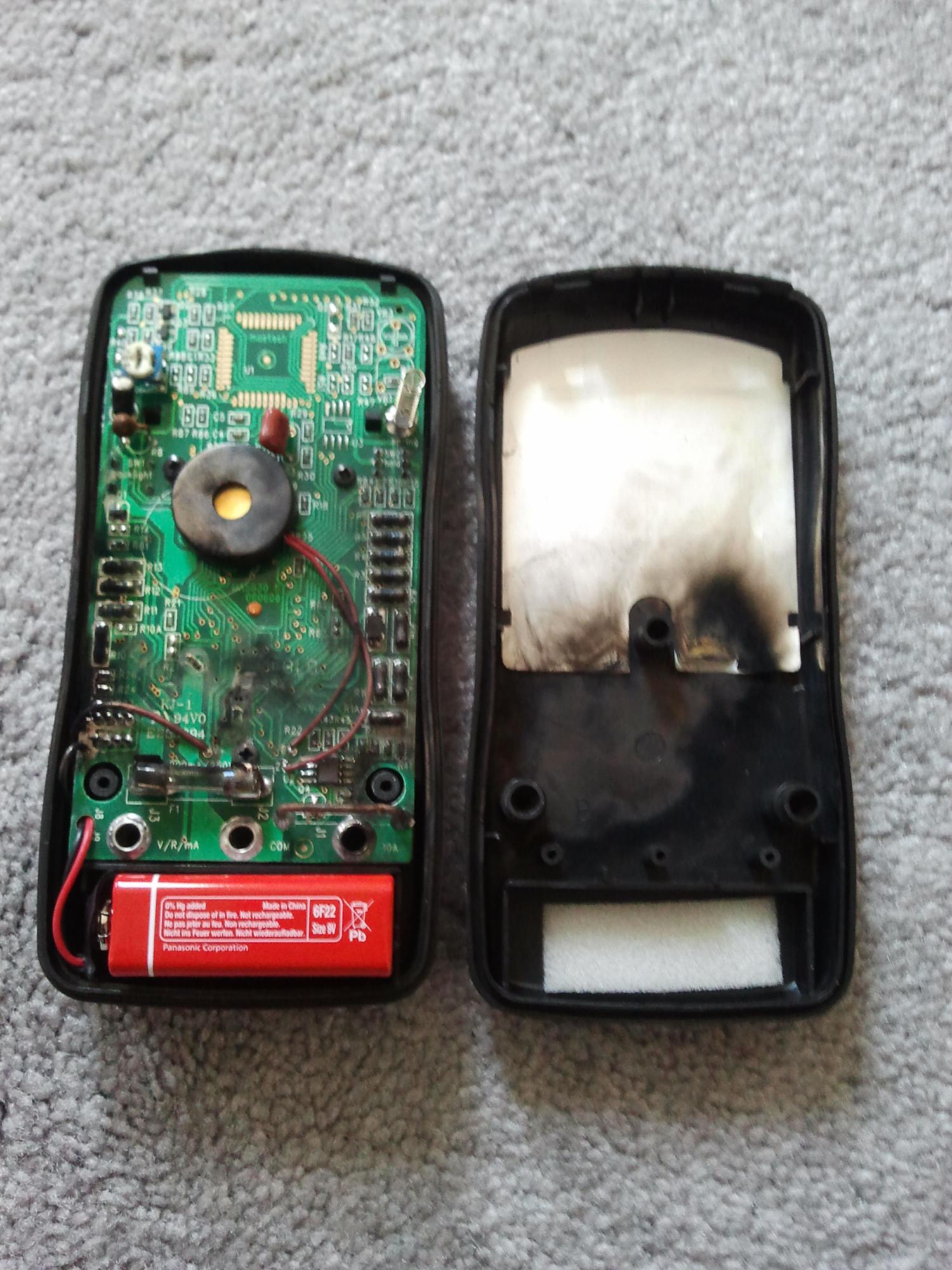

                  Re: Sanyo CE37FD47 LCD No Power
                  i placed red to brown and black to blue. probes were standing nicely on there own. i stepped back to watch the meter as i turned the mains on, the dmm went bang??
                  not good - but at least i was aware of the voltage, i was nowhere near.
                  why would it do that?

                    #29
                    it blown fuse in mains plug and blew the meter up??

                        • dumpystig
                          • Jul 2011
                          • 485
                          #32
                          WFF??? Ok what setting did you have your meter on? It should have been 600V ~, 1 o'clock position, with the black lead in centre common socket and red lead in right V/ohms/mA socket
                                  Your meter blowing up would suggest to me that it was either on the wrong range (resistance?) or the leads were connected incorrectly... or your meter was previously screwed prior to these tests (hence no voltages being detected on 3 boards...)

                                      • PlainBill
                                        • Feb 2009
                                        • 7034
                                        #39
                                        I think the pictures in posts 18 and 29 should be used in a 'How not to measure voltages' post in the 'Test Equipment Usage, Techniques, and Reviews' section.
