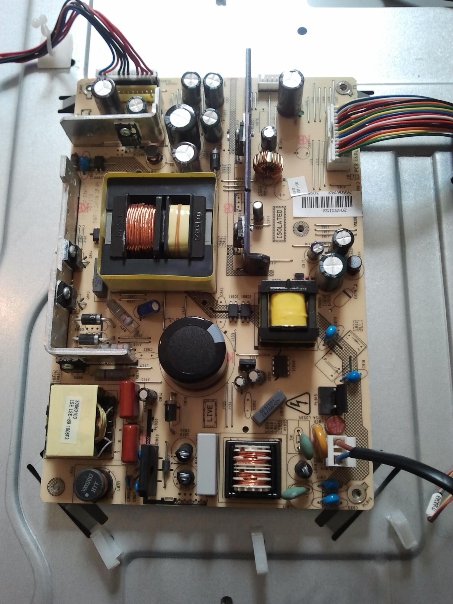

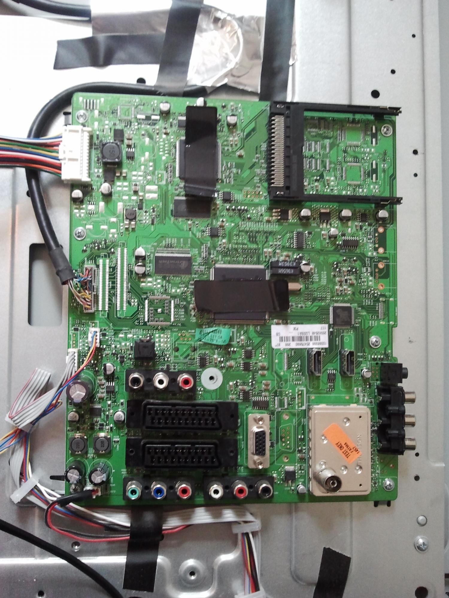

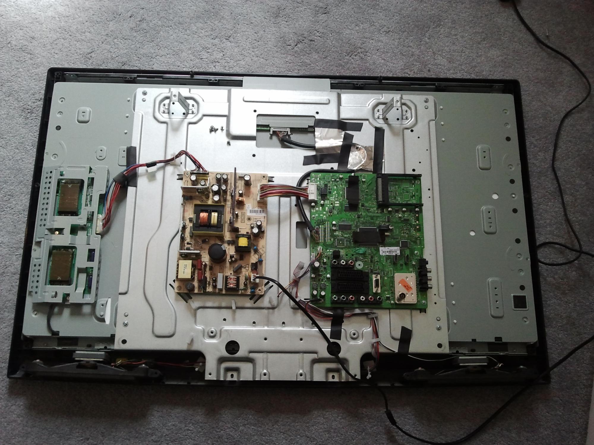

    Sanyo CE37FD47 LCD No Power
    I have the above tv, it has no power whatsoever, it has a vestel 17pw26-4 psu board, i have 3 of these boards - all give no power to tv.
    I have tried putting the the red point of multi meter on all pins going from psu to main board, hoping to find a 5v standby, all pins give no voltage.
    Am i testing correct? where does the black point from multimeter go?
    also i cant find a service maual.

    This is a dual section supply, so 5V standby should be present. I usually put the black probe on a mounting screw.
    The pictures gave me some information, a similar picture of the back side of the power supply would be helpful.

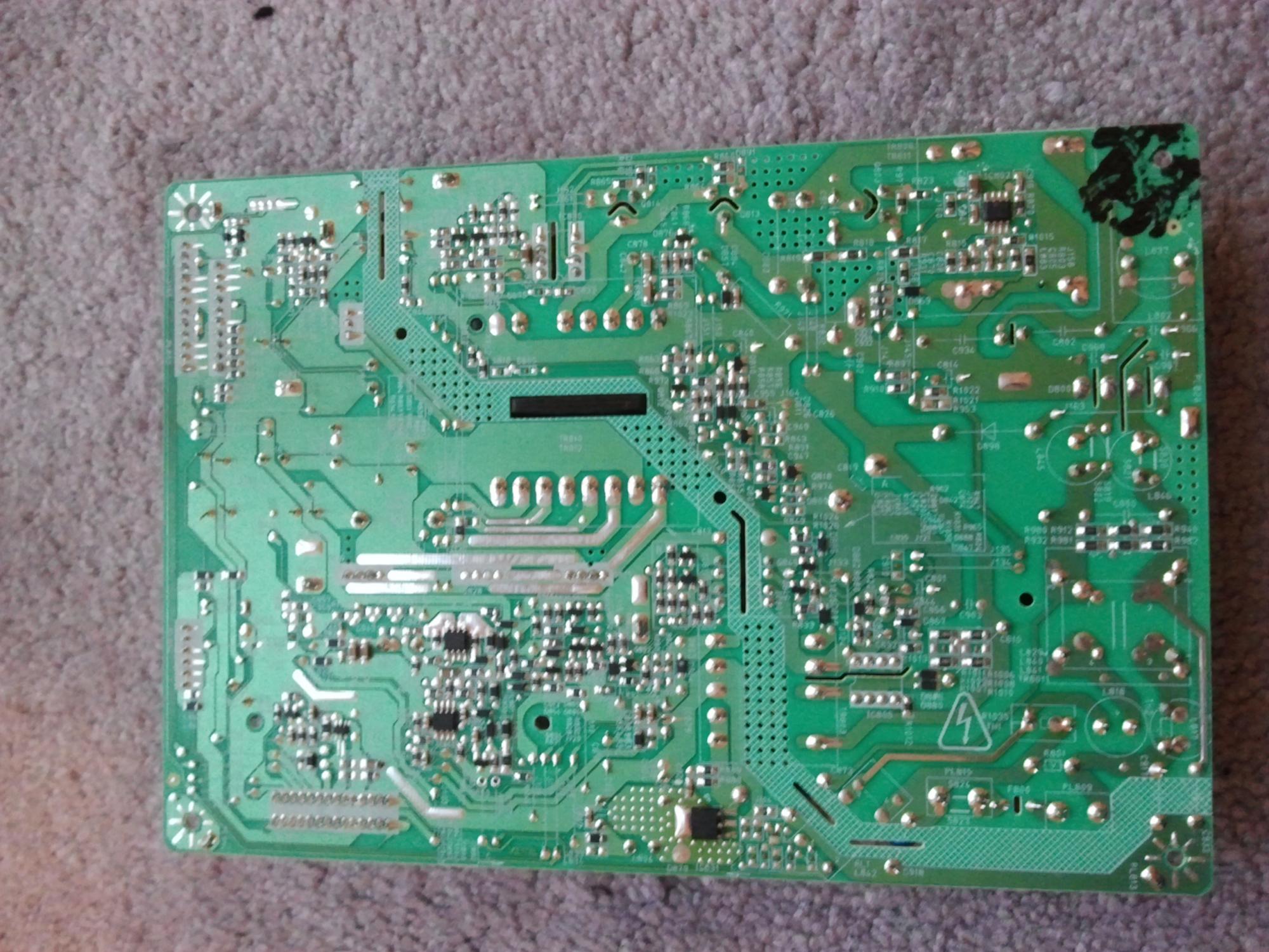

      im going to take another picture of the underside.

        Re: Sanyo CE37FD47 LCD No Power
        underside of psu

            It's been a LONG day, so I'm going to pass on marking up a picture. I have a few points to check.
            1. With power disconnected, check F800 - the reddish brown cylinder. It should read less than 1 ohm.
            2. If the fuse is good, with power connected check the voltage across C819, the large filter cap.
            3. Does anything connect to PL815, or is there a jumper across it?

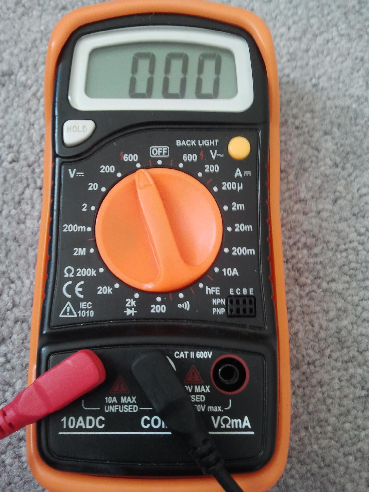

                                    thanks dumpystig, i looked looked closer and found the negative sign, i tested c819 and am getting no voltage with power connected.
                                    im new to testing componenets and im learning very fast.
                                    here is a pic of the setting i used to test c819, can you confirm its the correct setting?
                                    • dumpystig
                                      • Jul 2011
                                      • 485
                                      Nope mate, you got the red lead wrong. It goes in the V/ohms/mA socket. Black lead is correct in the Common socket. You have the correct range on the selector dial. test it now with the leads correctly connected.
                                      System: HP xw6600 Workstation, 650W PSU | 2x Intel Xeon Quad E5440 @2.83GHz | 8x 1GB FB-DDR2 @ 667MHz | Kingston/Intel X25-M 160GB SSD | 2x 1TB Spinpoint F3, RAID0 | 1x 1TB Spinpoint F3, backup | ATI FireGL V7700 512MB | Sony Optiarc DVD +/-RW | Win 7 Ultimate x64 | 2x Dell UltraSharp U2410f | Dell E248WFP
                                      • Liam.25
                                        • Feb 2011
                                        • 107
                                        • Uk
                                        thanks mate, tested - no voltage??
