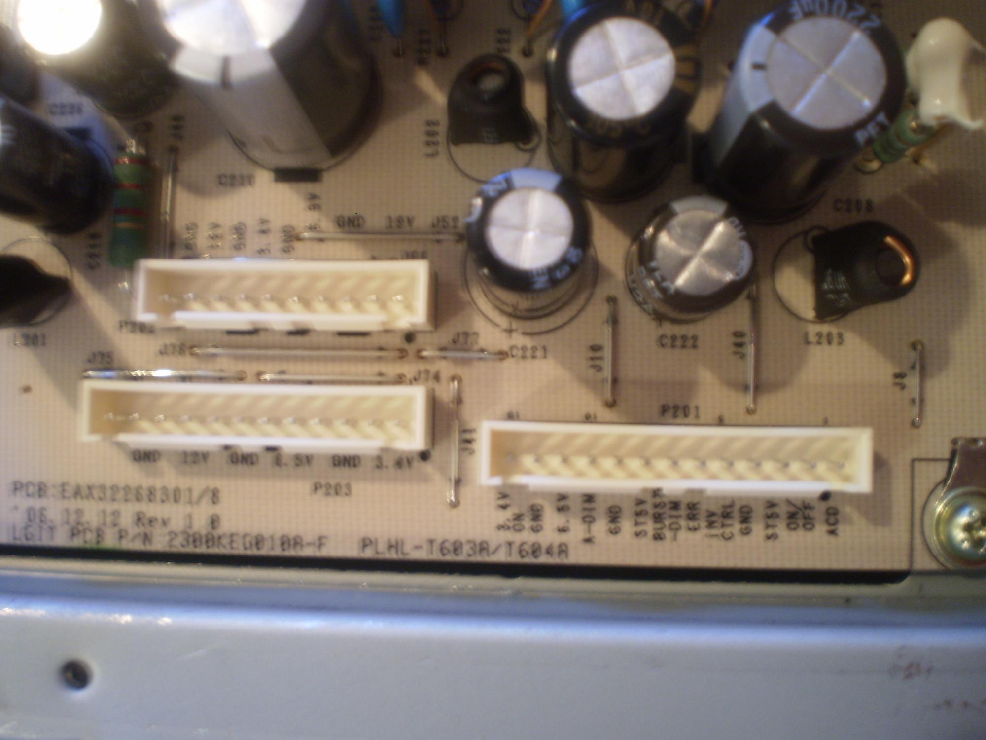

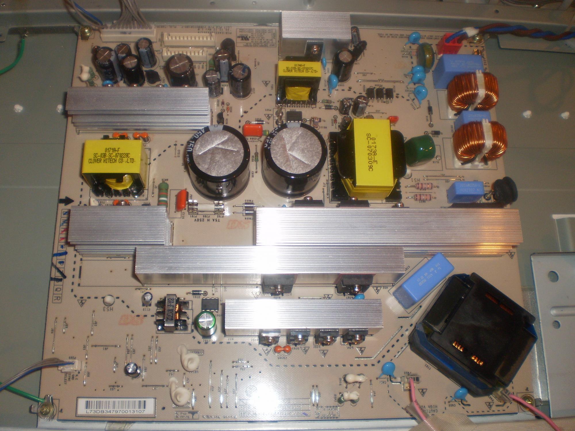

                      Standard suggestion at this point: Clear, high resolution (as close to 2000 x 2000 pixels as possible preferred) of top and bottom of the power supply. Use 'Manage Attachments' (below the text entry area) to attach them.

                        Re: LG 42LC7D-UB power problem.
                        Here are the pics
                        • PlainBill
                          • Feb 2009
                          • 7034
                          I'm going to need a couple more pictures. The first should cover the same area as the third picture you attached. On that one I am mainly interested in the labels on the output connectors - I want to be able to identify which pins carry the 3.4 volt output. The second should cover the under side of the board.

                            • dietzcj
                              • Mar 2011
                              • 114
                              This is about as good as I can get it.
                              Only the 2 lower sockets are used.
                              • PlainBill
                                • Feb 2009
                                • 7034
                                OK, that gives me the pinout. Now I need one of the reverse (back, bottom, circuit, green) side of the board.

                                  Can you give a P/N of that PSU, may be possible to find a schematic. I can't remember it since I fixed my TV, a few months ago.

                                    Here is a more detailed photo< I used MS paint to make it more clear.
