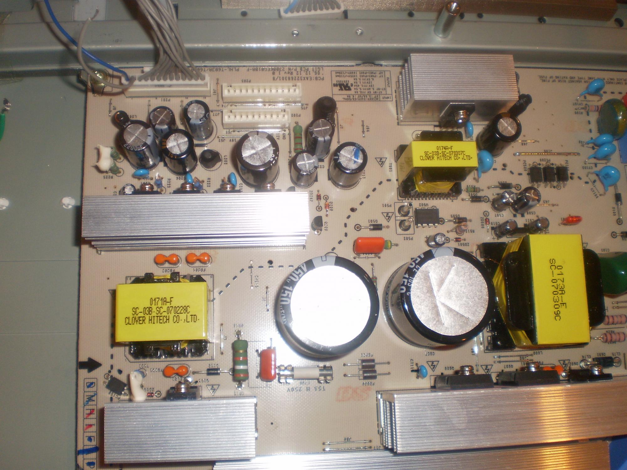

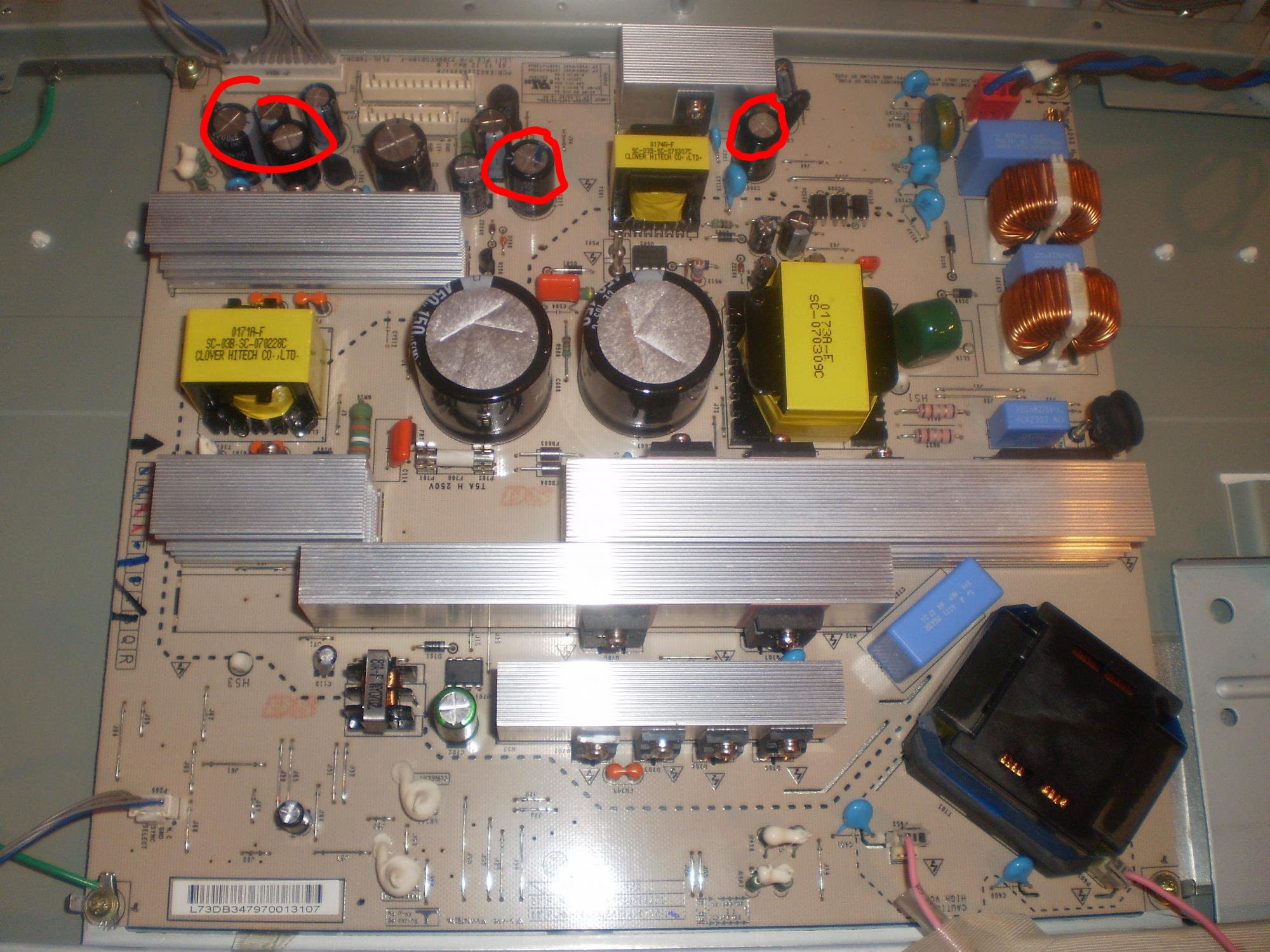

                      Standard suggestion at this point: Clear, high resolution (as close to 2000 x 2000 pixels as possible preferred) of top and bottom of the power supply. Use 'Manage Attachments' (below the text entry area) to attach them.
                      PlainBill
                      • dietzcj
                        • Mar 2011
                        • 114
                        Re: LG 42LC7D-UB power problem.
                        Here are the pics
                        • PlainBill
                          • Feb 2009
                          • 7034

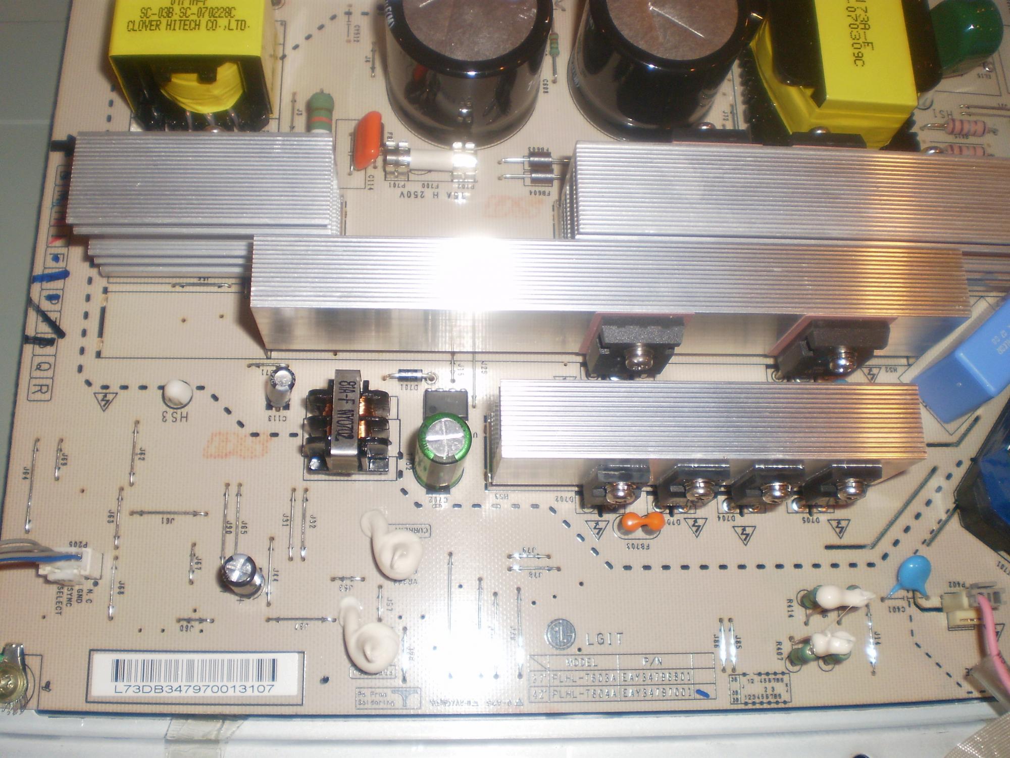

                          I'm going to need a couple more pictures. The first should cover the same area as the third picture you attached. On that one I am mainly interested in the labels on the output connectors - I want to be able to identify which pins carry the 3.4 volt output. The second should cover the under side of the board.
                            I fixed an IDENTICAL power supply in my LG 42LC46.
                            Replace the four 2200u 10V capacitors, two around the standby section, and two in the secondary side. I've highlighted them in red.
                            It brought this TV (dumpster find) back from the dead... (it wouldn't power on at all - but I wouldn't be surprised if it exhibited this problem before it was thrown in the trash.)
                            One of the caps filters the 3.4Vstby line which runs off the 5Vstby line (there's a buck converter on the other side of the board - note two SMD FETs and a buck controller IC.) If this is bad, the TV will reset as the CPU requires it. But it's probably best to replace all four of these because mine had them all bulging - they are going to fail at one time or another.
                            I bet they are the cheap Samwha caps that LG are so keen on using.

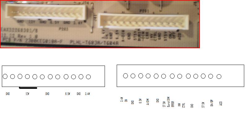

                              This is about as good as I can get it.
                              Only the 2 lower sockets are used.

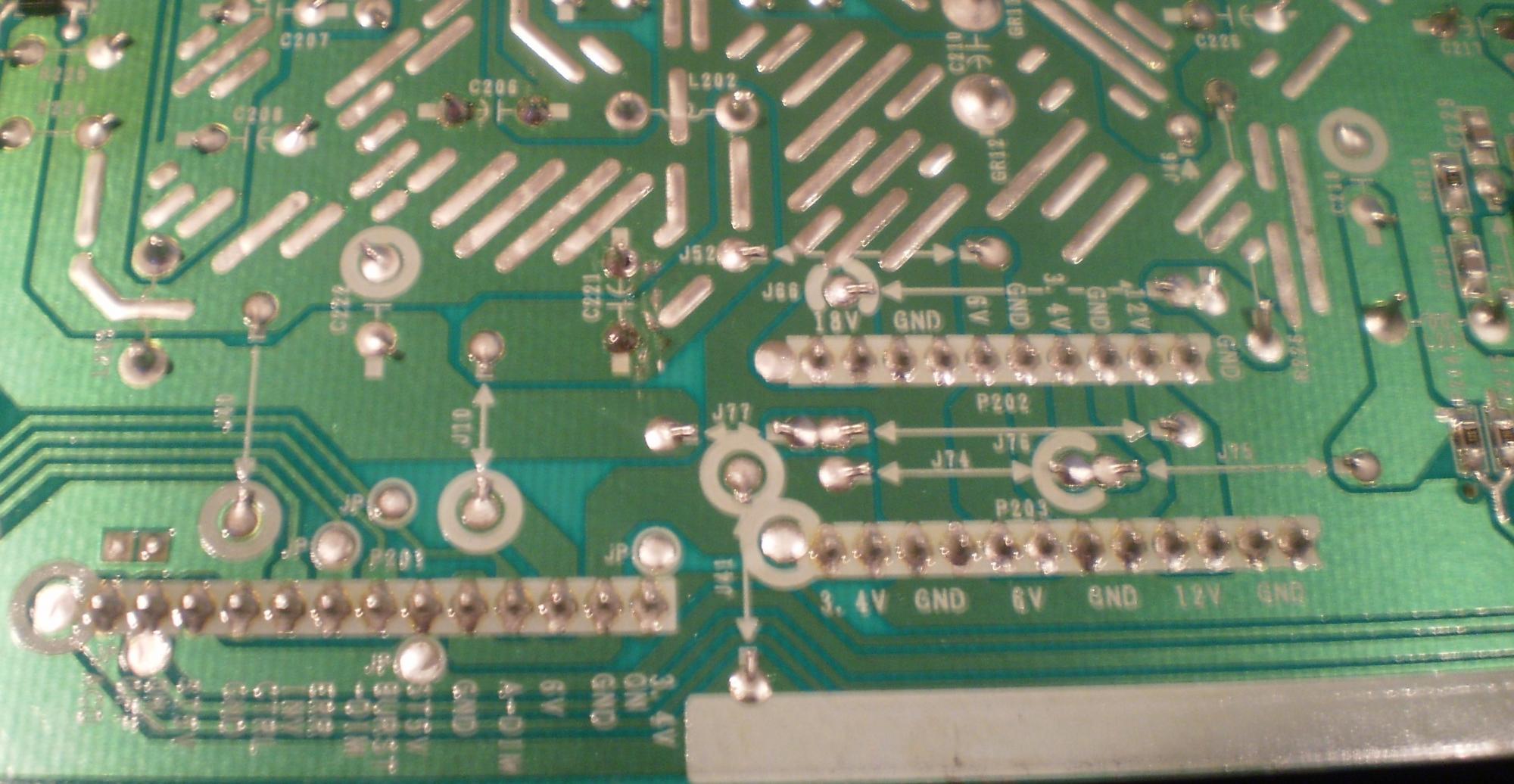

                                OK, that gives me the pinout. Now I need one of the reverse (back, bottom, circuit, green) side of the board.

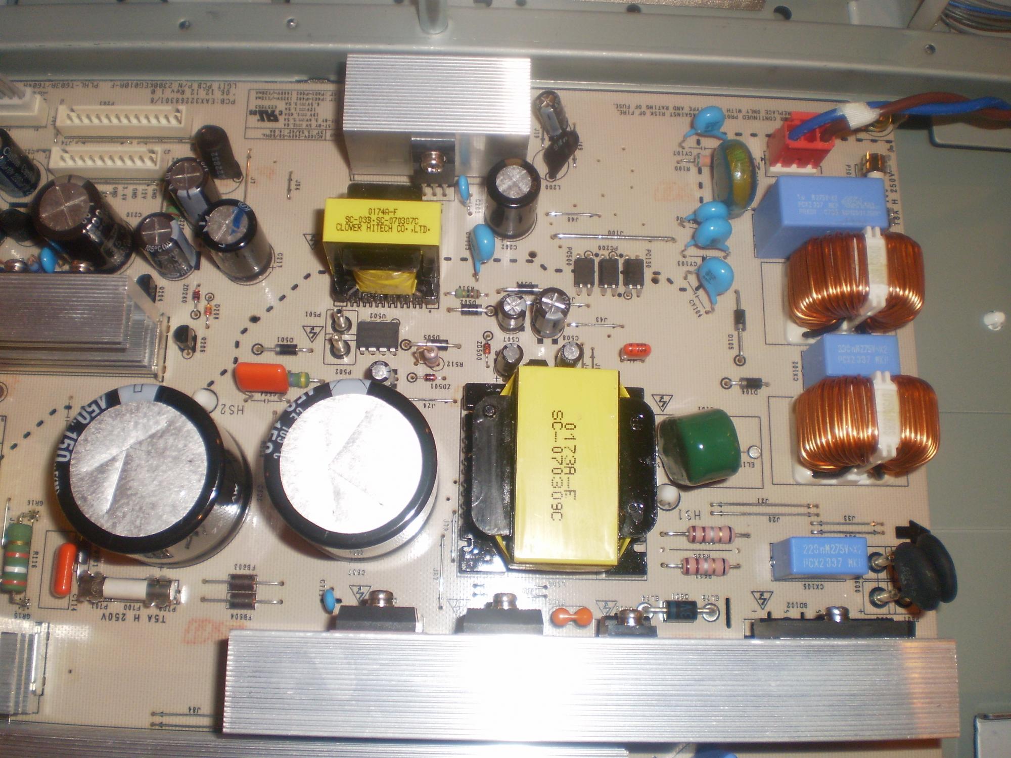

                                  Can you give a P/N of that PSU, may be possible to find a schematic. I can't remember it since I fixed my TV, a few months ago.

                                    Here is a more detailed photo< I used MS paint to make it more clear.
                                      EAX32268301/8
                                      That is the part number.,
                                      And I have replaced all of the 2200, 10 V capacitors as was suggested.
