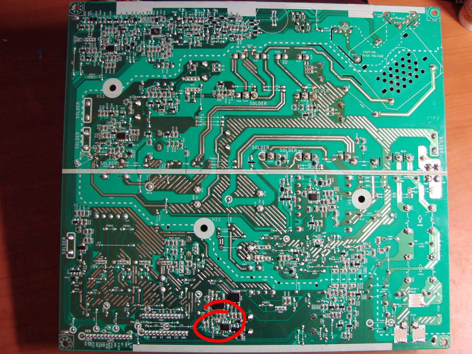

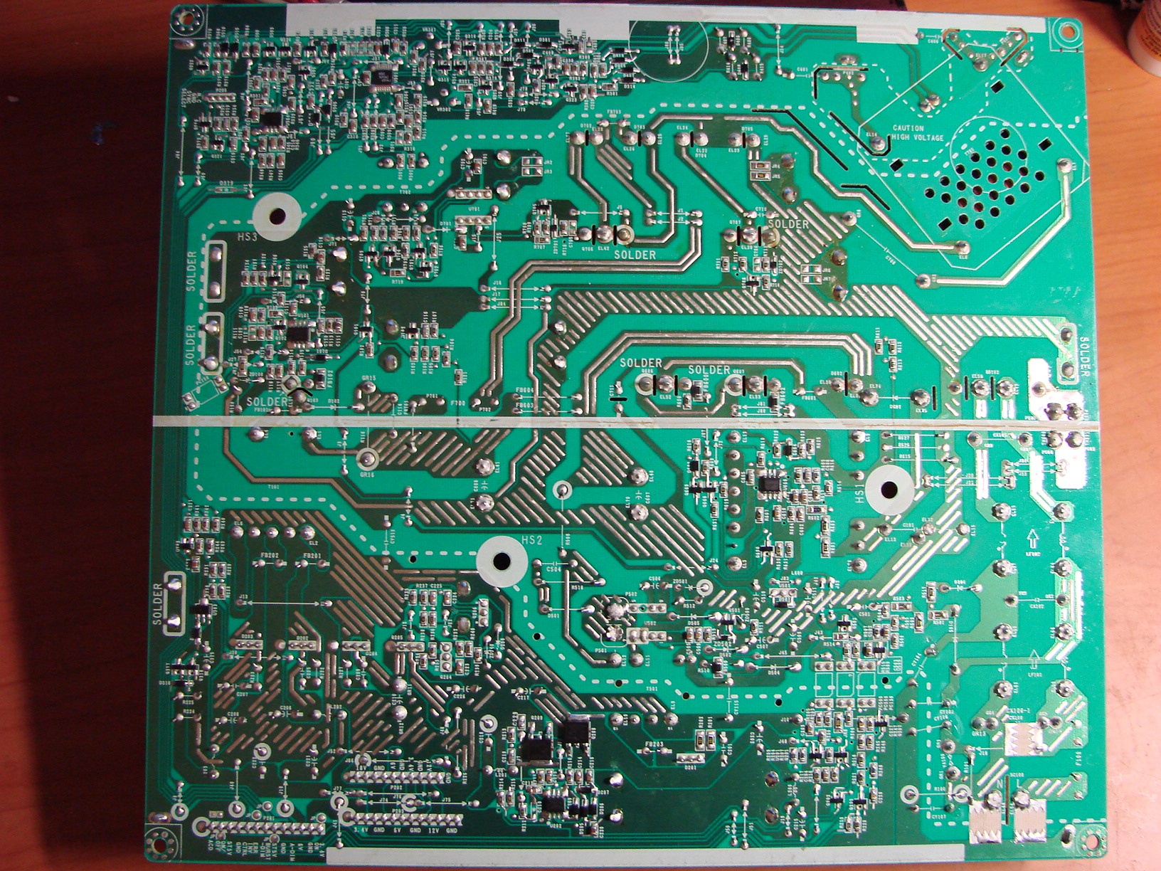

    Here is a blown up photo of the whole green side board

              Re: LG 42LC7D-UB power problem.
              Awww, crud!!! There are two separate control inputs on P201. There is the On/Off input which you have overridden, but the last pin on the other end of P201 is '3.4V ON'. Does that change state when the TV shuts down?

                        Correct. Did you check the other output voltages?
                        I see the circuit that is producing the 3.4 volts, but the #%T%@@%!!! picture doesn't show enough detail to even let me be sure of the numbers, but it looks like U202 is one of them.

                              #34
                              Originally posted by dietzcj
                              PlainBill,
                              Yes all other voltages are Okay, just the 3.4 is low or not even registering.
                              OK, the problem is probably in the area of the two transistors and the IC to the right of the output connector in the view of the green side of the board.

                                  #36
                                  Is it your reccomendation that I just replace the caps ?
                                  Also what transistors and IC do i need to replace ?
                                  Can you read the number on the IC. I believe, from when I was repairing my TV, that it is a synchronous buck converter. It takes 5V and outputs 3.3V (or 3.4V.)

                                    #37
                                    the D201 location ?
                                    • dietzcj
                                      • Mar 2011
                                      • 114
                                      #38
                                      D201 location
                                      N7B (or 8)
                                      ch20A20
                                      >|--|< 156
                                      • dietzcj
                                        • Mar 2011
                                        • 114
                                        #39
                                        fch20A20
                                          #40
                                          No, this one.
                                          Do you have an oscilloscope? I'm going to guess no... but I've been surprised before.
