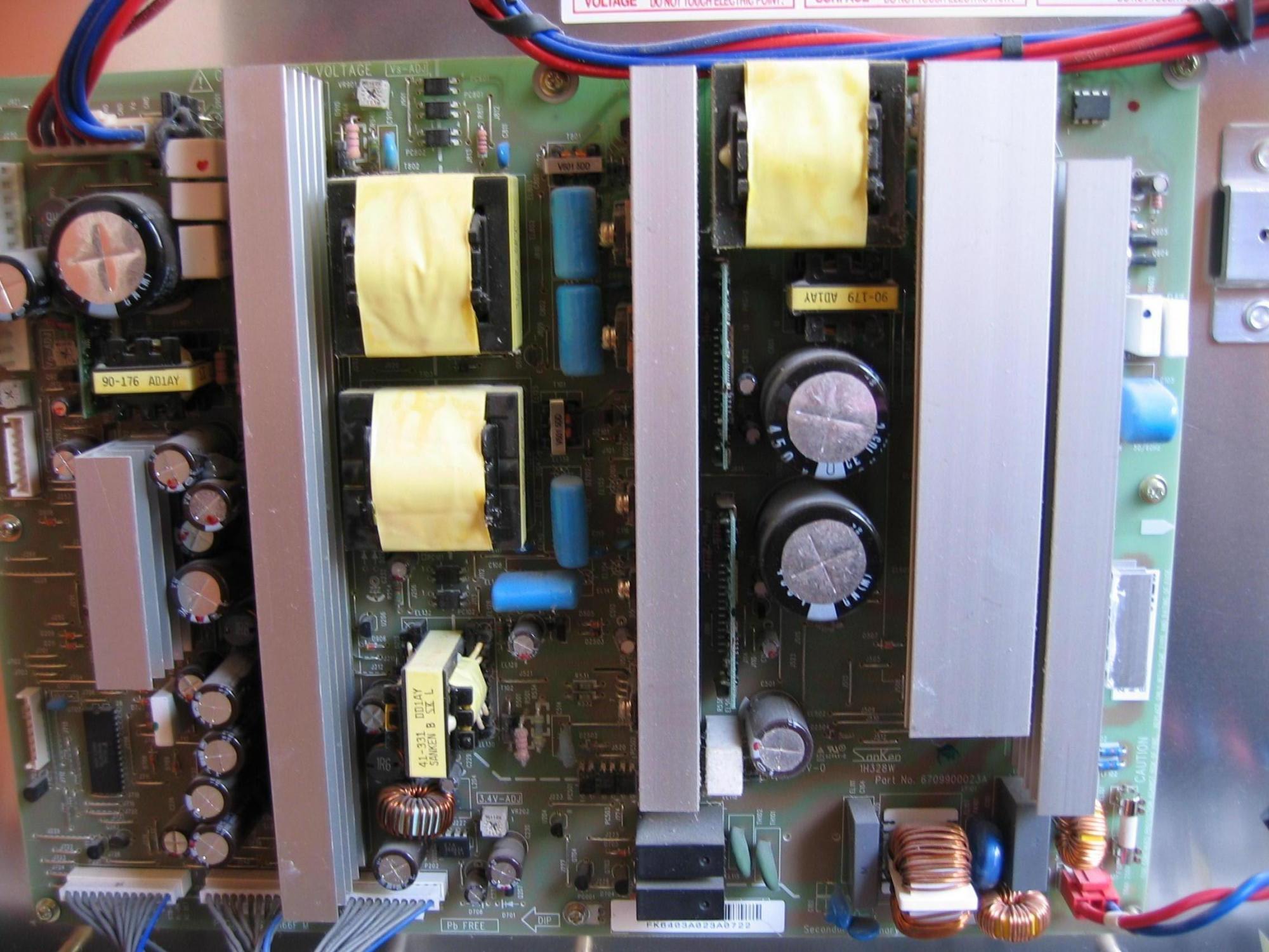

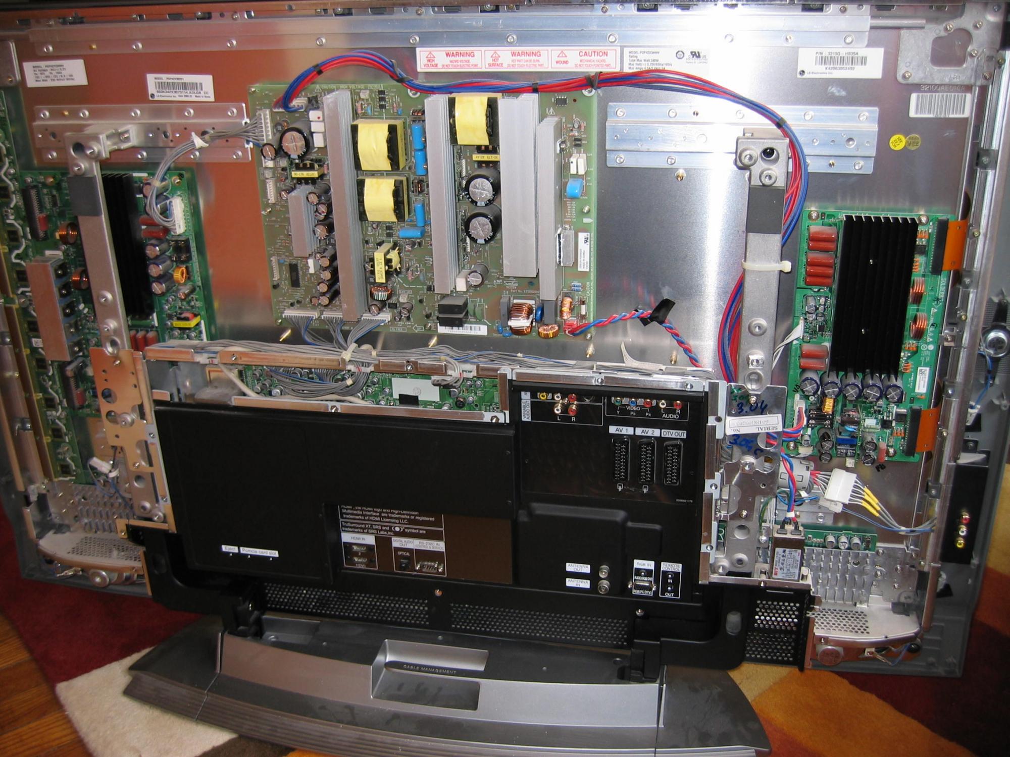

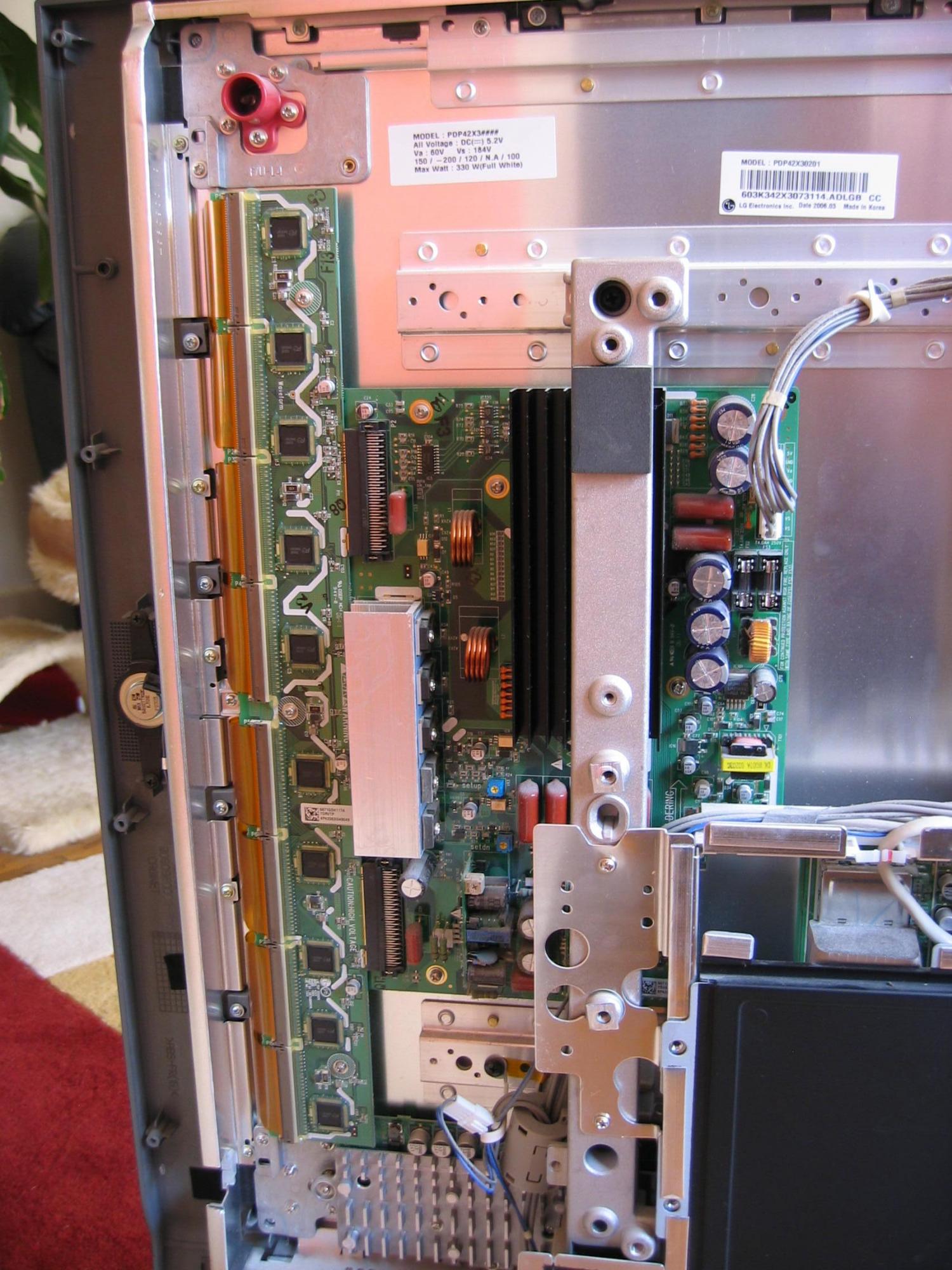

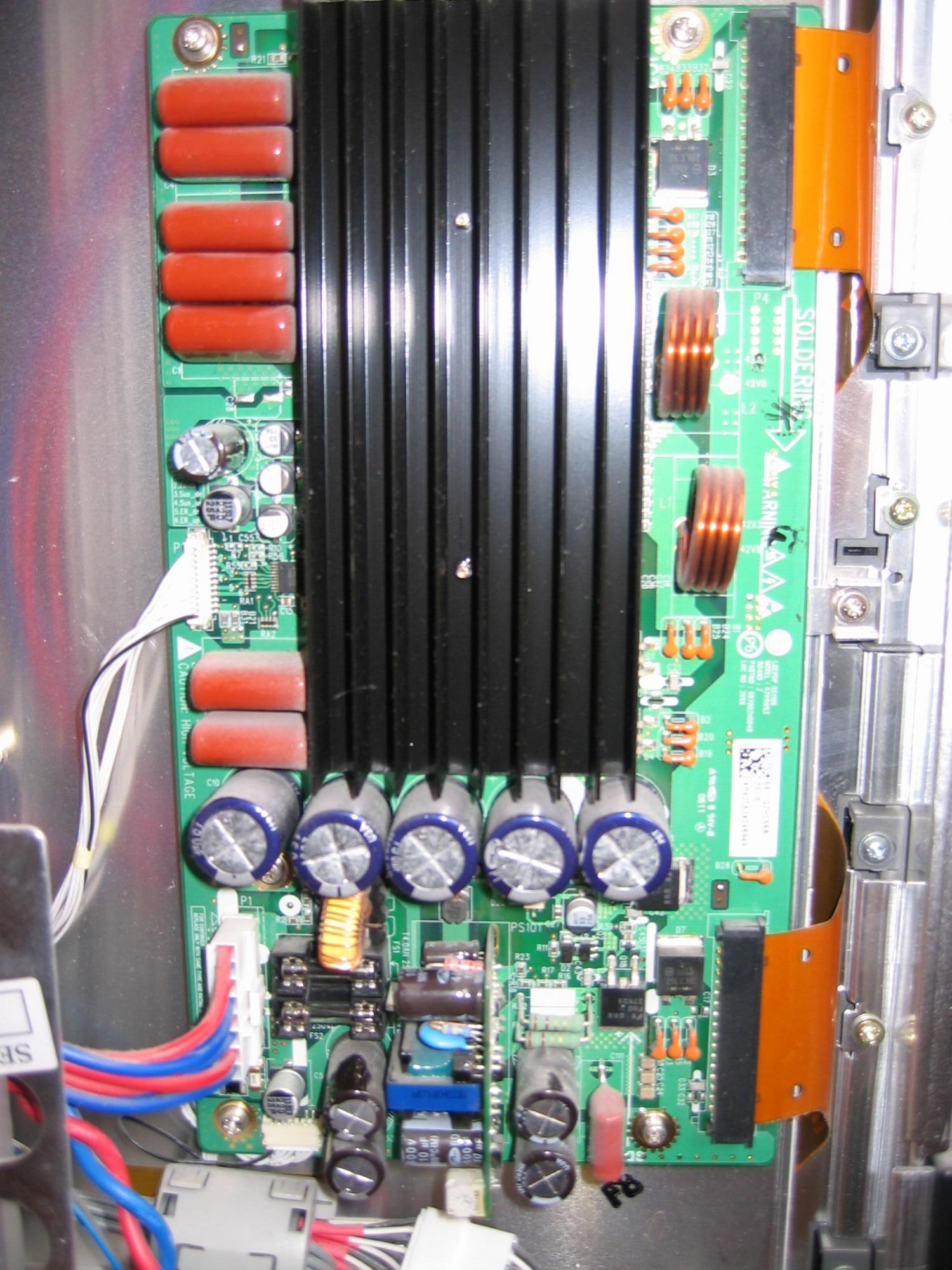

hi i have a plasma tv that will not turn on,it was ok one day then the screen turned red and the tv switched off,when i try to turn it on i can hear it clicking on green then back to red,i have uploaded some pics and realy could do with some help,the caps seem fine Thankyou in advance
LG 42PC1D plasma tv
Re: LG 42PC1D plasma tv
Facing the back of the TV, the Y-Sustain is on the left, the Z-sustain on the right. The usual process for identifying the cause of this problem is to unplug the large (power) cable to the Z-sustain and try to turn the TV on. If it now turns on, the Z-sustain is probably the problem. Turn it off, wait a few minutes, reconnect the cable, and disconnect the similar cable from the Y-Sustain. Again, try to turn it on. If it now turns on, the Y-Sustain is probably the problem. Again, turn it off, wait a few minutes, and disconnect the Z-sustain again. Now try to turn it on again.
If it turns on and stays on when the Y-sustain is disconnected, the Y-Sustain is probably the problem.
If it turns on and stays on when the Z-sustain is disconnected, the Z-Sustain is probably the problem.
If it turns on and stays on ONLY when both the Y-sustain and Z-sustain are disconnected, the power supply probably is the problem.
If it turns on and stays on when either the Y-sustain or Z-sustain is disconnected, but not when both are connected, the power supply almost certainly is the problem.
