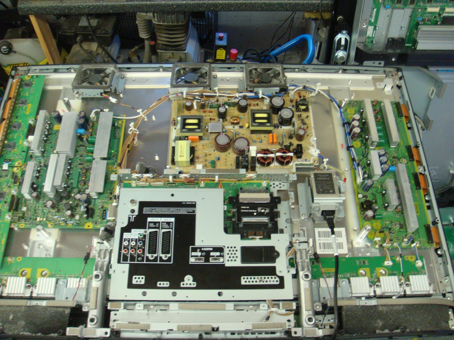

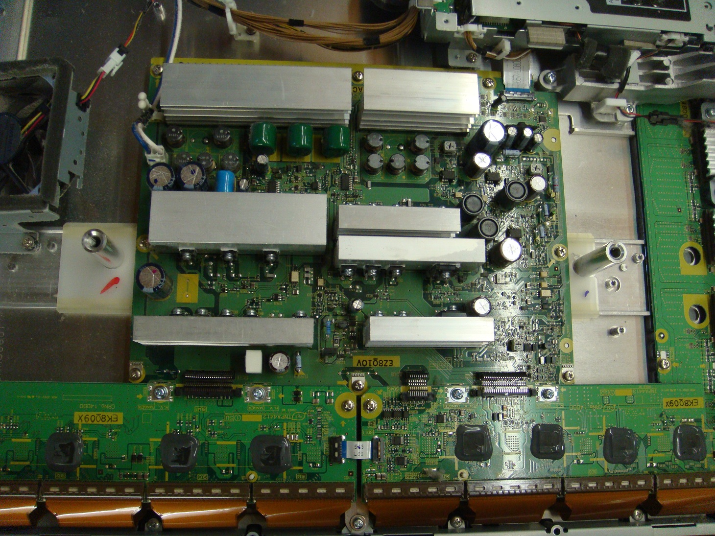

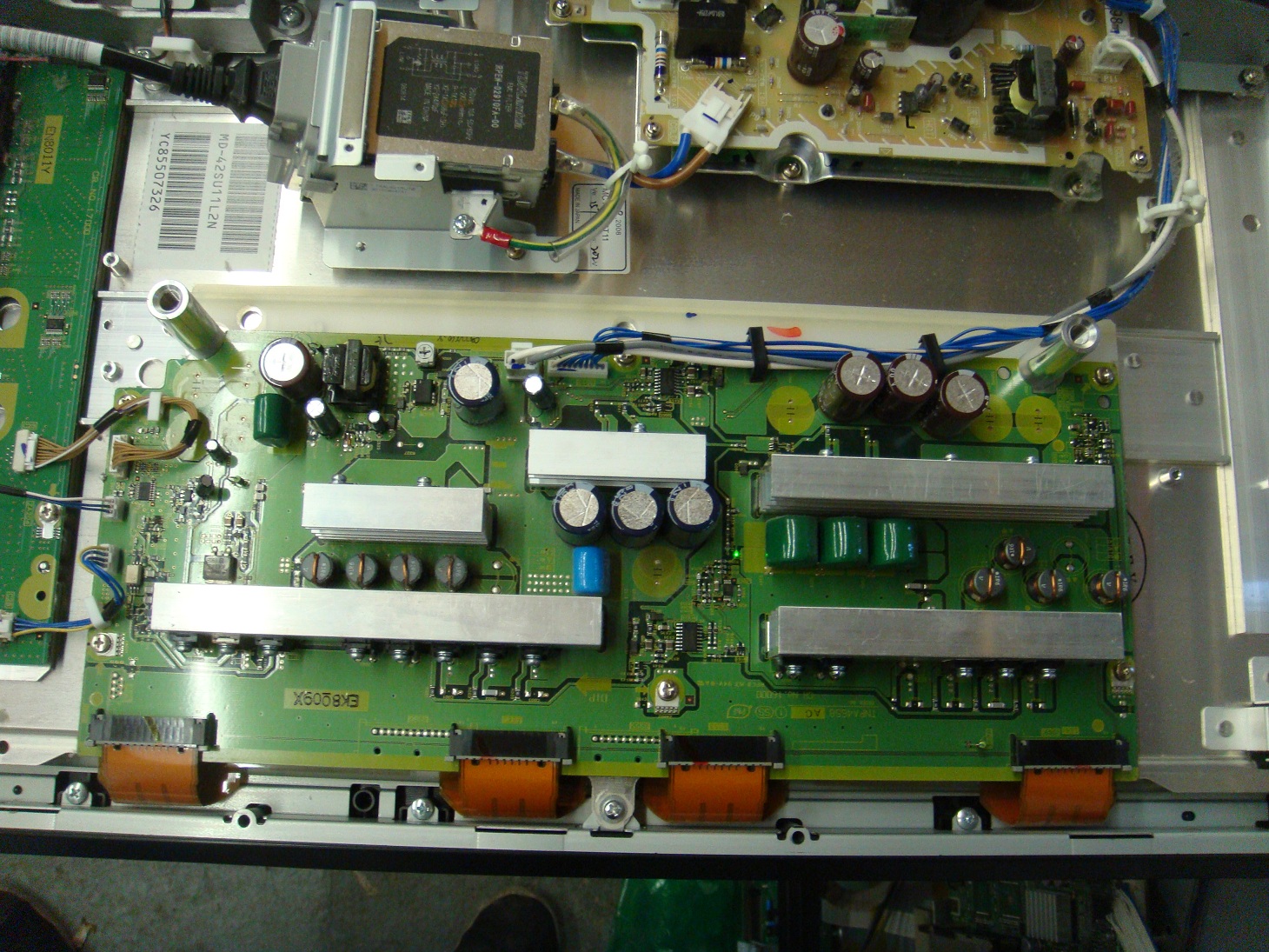

    Need some help with this one, first panasonic I have opened up! it powers on as it should to steady green light but screen is blank, have measured 203volts to both sus boards and checked the psu fuses I'm stuck now, not tried to connect video to see if sound present due to no dvd spare to try but will need to find one, any help welcome
    P.s green led lit on each y and z sus

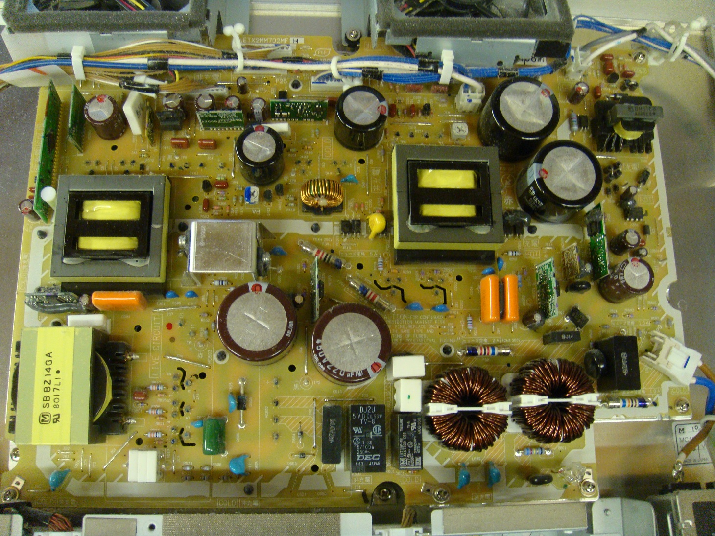

    Good quality pictures. A couple of things you might want to check: In the lower left corner, between the two transformers and to the left of the orange capacitor, it looks like a dead worm is wrapped around ??? Above the upper of the transformers, near the top of the board, the white rectangular ?resistor? looks like it might have been dislodged.
    PlainBill
    • netdent
      • May 2011
      • 208
      Re: Panasonic TH-42PZ8BA help!
      Hi Bill, yes the worm is actually a bead of silicone type stuff! I noticed the resistor too but it is securely soldered.
      thanks Ronnie

            This points to a problem with the D-board. The fact that the LEDs on the SC and SS boards are lit mean that they are most likely working properly.

                              That's a weird PSU, I've been trying to figure it out. I don't see any diodes for the secondary output, anywhere... and I see a lot of holes where diodes could go. Also, no PFC stuff but places for them. Has someone decided to remove all these components?
                              • rayrod81
                                • Oct 2010
                                • 205
                                Most of the components on these Panasonic PSUs are soldered in from underneath and attached to the large metal shield that also acts as a heat sink.
