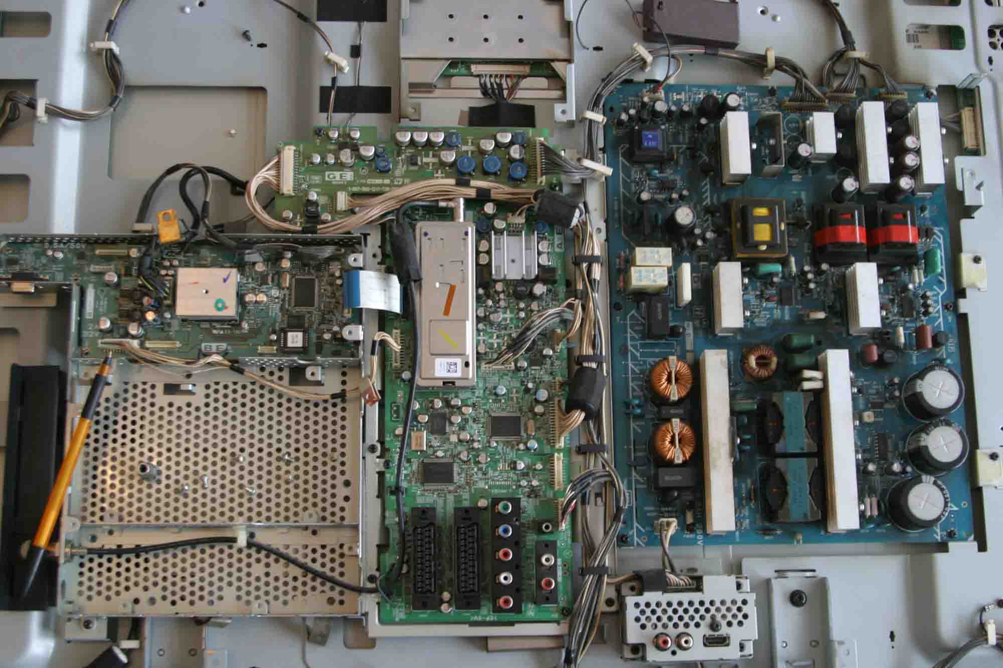

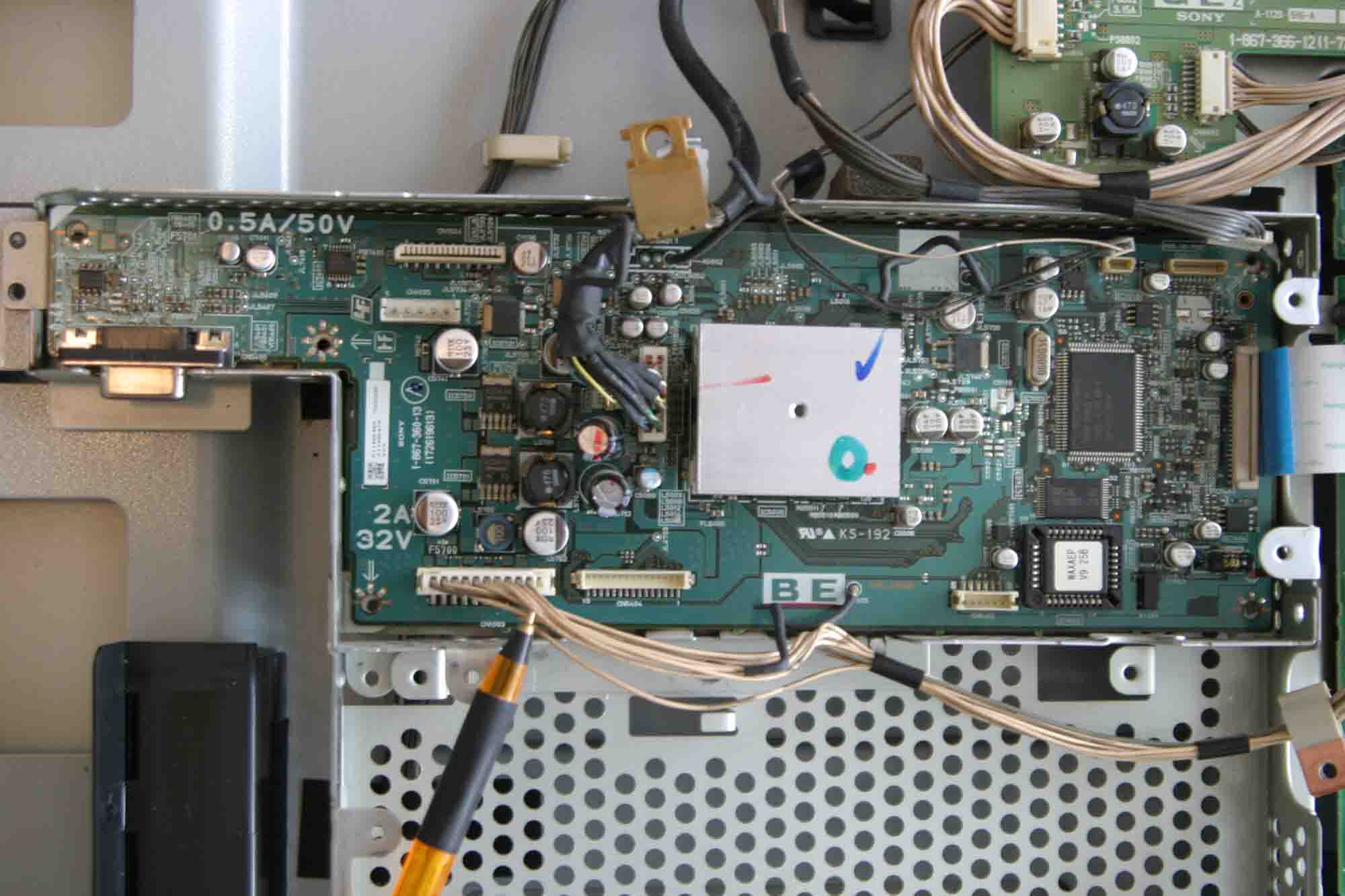

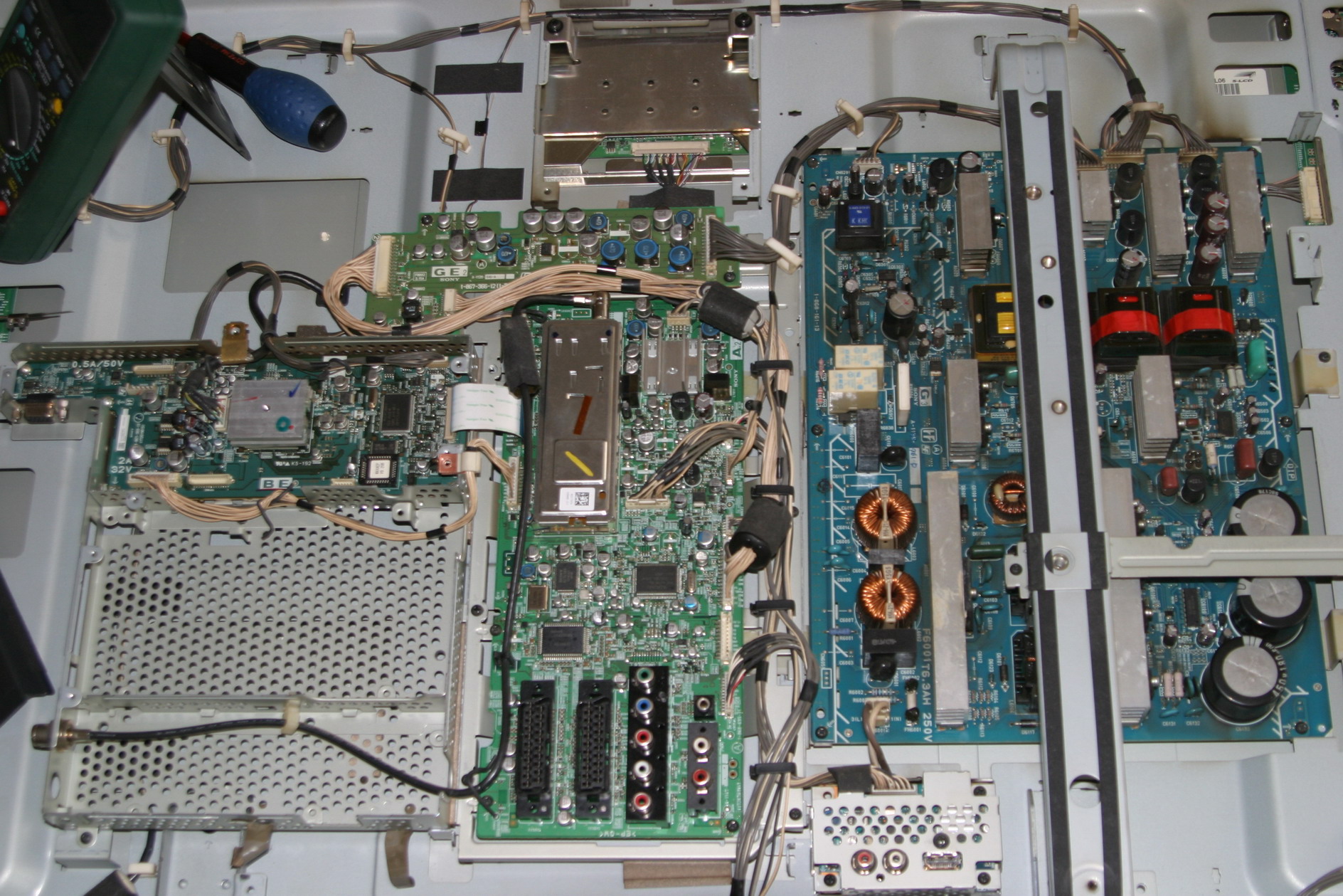

    Here is the picture of it insides.
    I will be thankful If you can give me any advise witch part should I change or check. Would like to narrower the problem, but I am beginner with electronics ☺

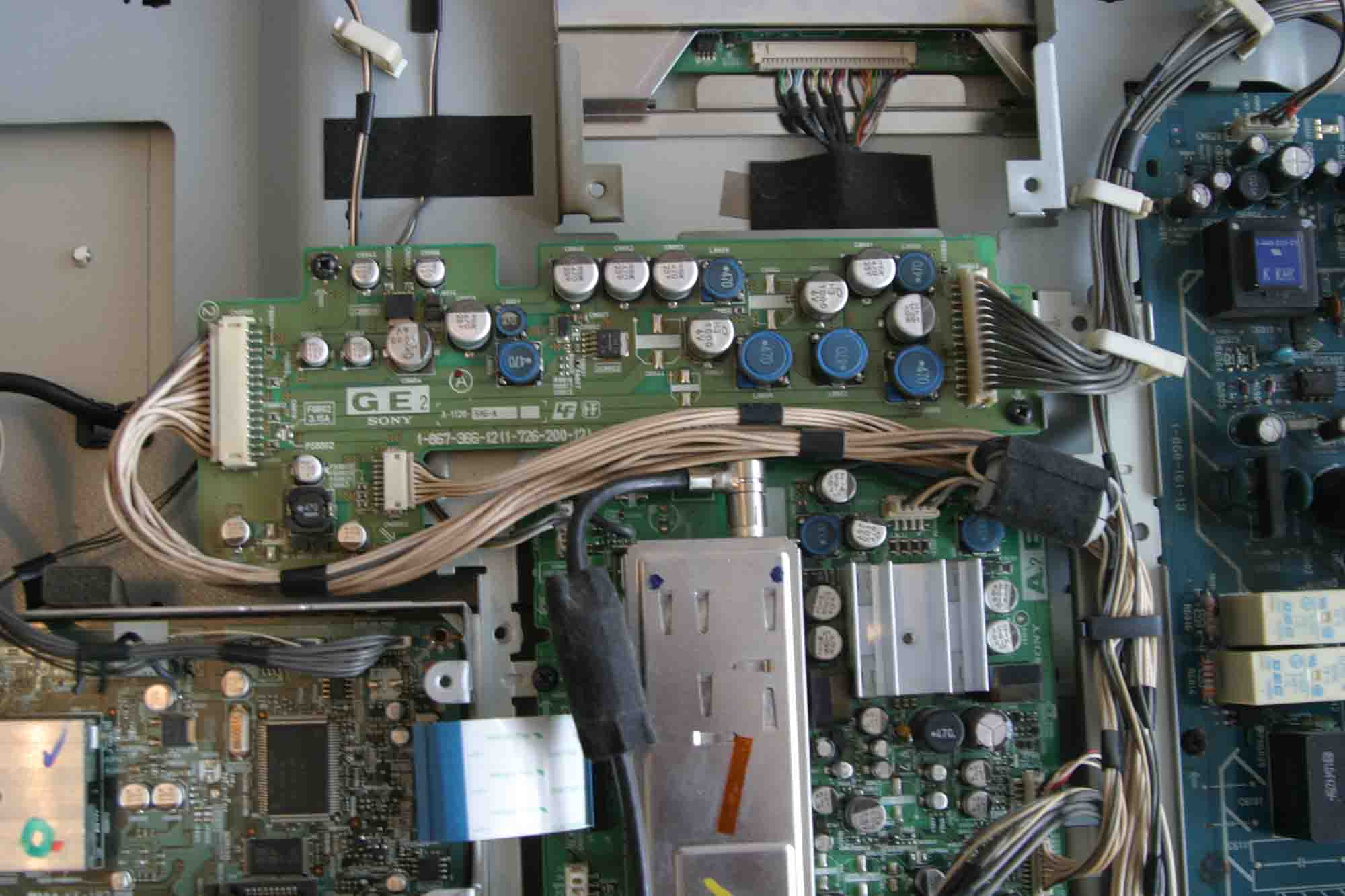

    If you can get in closer with your camera, I think I can see burn marks on a board. Please take closer pictures of the light blue board.
      Hi, is no burn really, warm air deposed dust with the time. I agree on the 1st picture it looks scary!

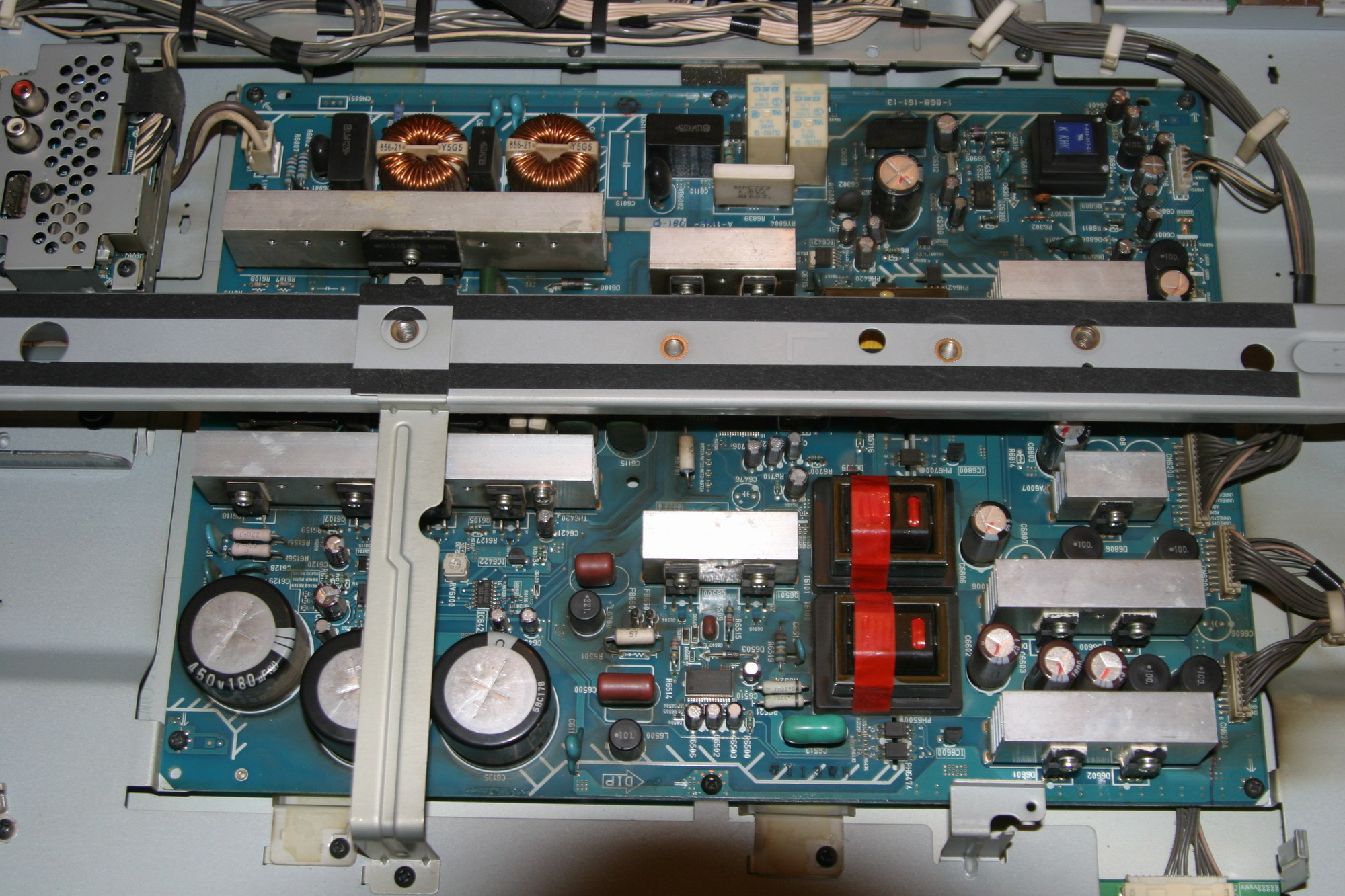

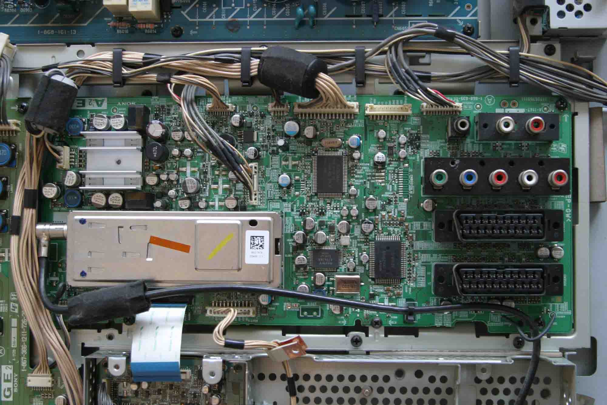

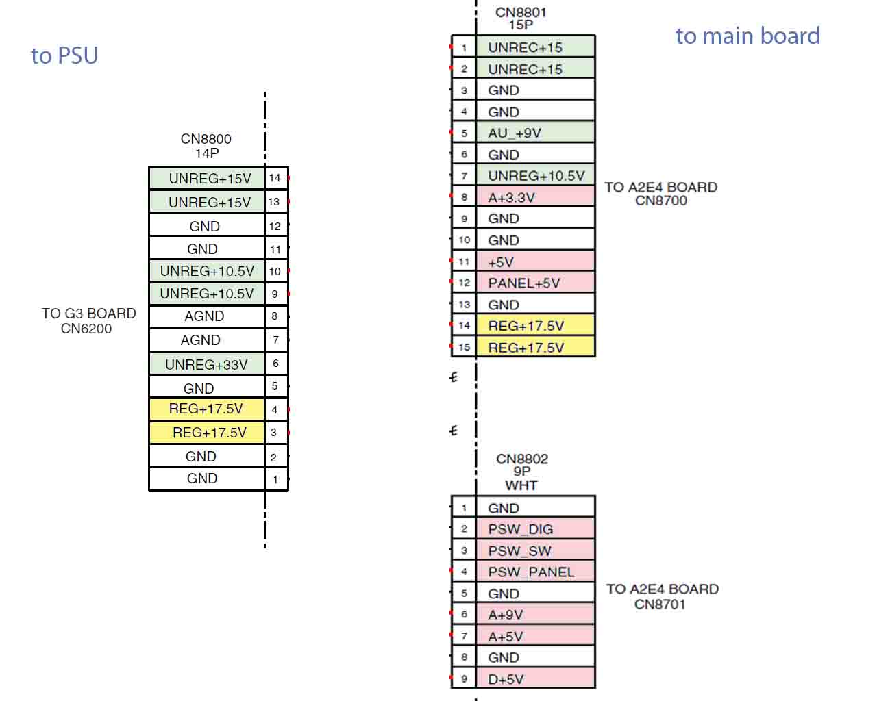

        When I press the power button on, there no signal send to the pin power-on.
        When I send +3V on this pin the power board wakes up, but no backlight
        There is 5V stby on main and video processor board.
        I was suspecting the board between the PSU and main board, the GE2 (power supply regulator) because voltages were missing, so I ordered a used one from e-bay but nothing changed.
        I marked with green the voltages I can read, with red those I do not have and yellow witch are not correct 19V instead of 17.5V
        Are those boards bad, can they be bad the same way?

          If you have the service manual, see if tells you which board is responsible for the logic control, then take a picture of that board and post it here.
          Alternatively, post pictures of each board. That way we can point out all of the voltage regulators that may need to be checked. The abnormality in voltages you got may be caused by an overload or an underload due to a bad regulator somewhere.

            Sorry the regulator boards are not bad the same way as I stated in my last post.
            On the “new one” from e-bay a +9V pin is a alive compared to the my old!
            The auction was saying “checked and taken from a working set”; shame for the TV!
            Now - Should I stay or should I go?
            With my little knowledge. But I'm fascinated looking at the schematics on the service manual, even thow is sounds like going
            on a Japanese forum and trying to read! Anyhow I tried to be logic.

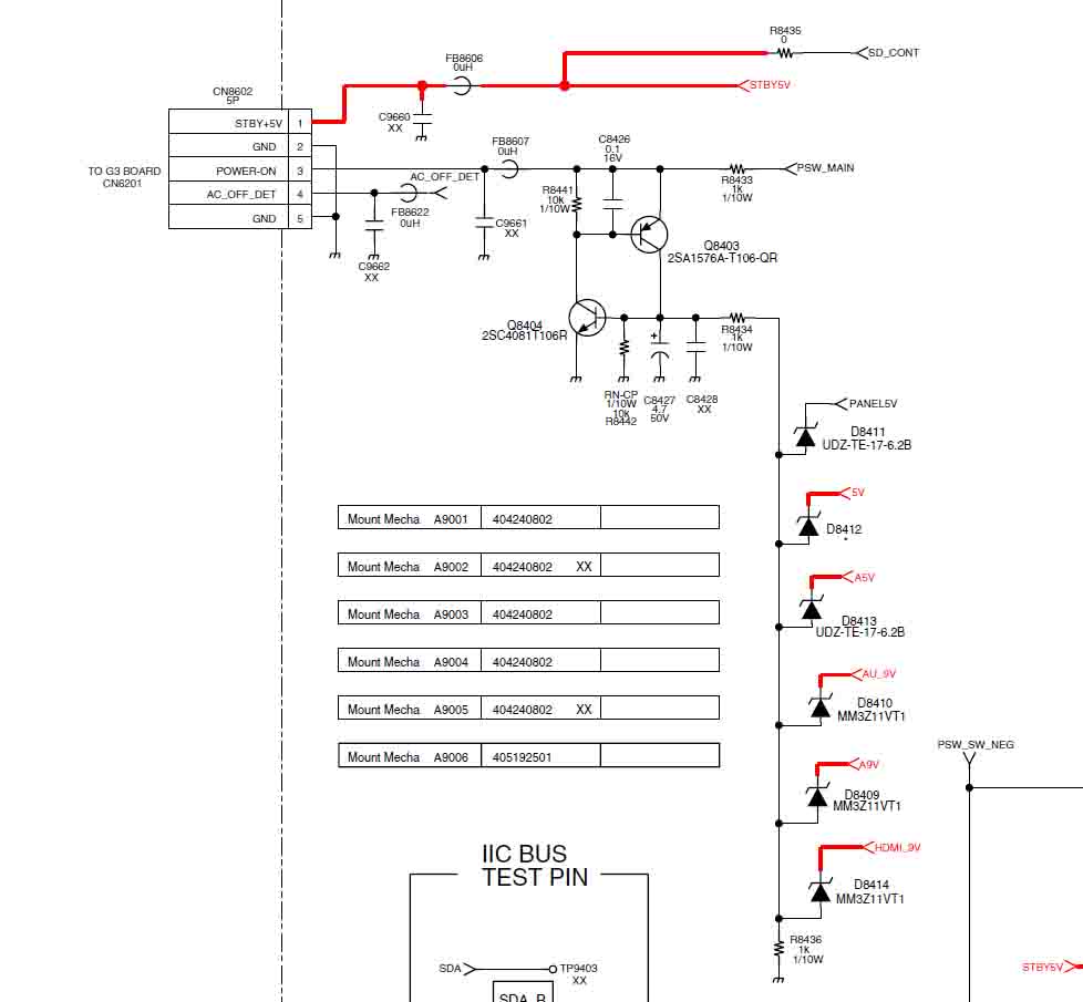

            Then I decided to fix me a start point witch was Who sends that wake UP signal?
            It certainly not the Power Supply Regulator and the thing is certainly not drawing a lot of amps.

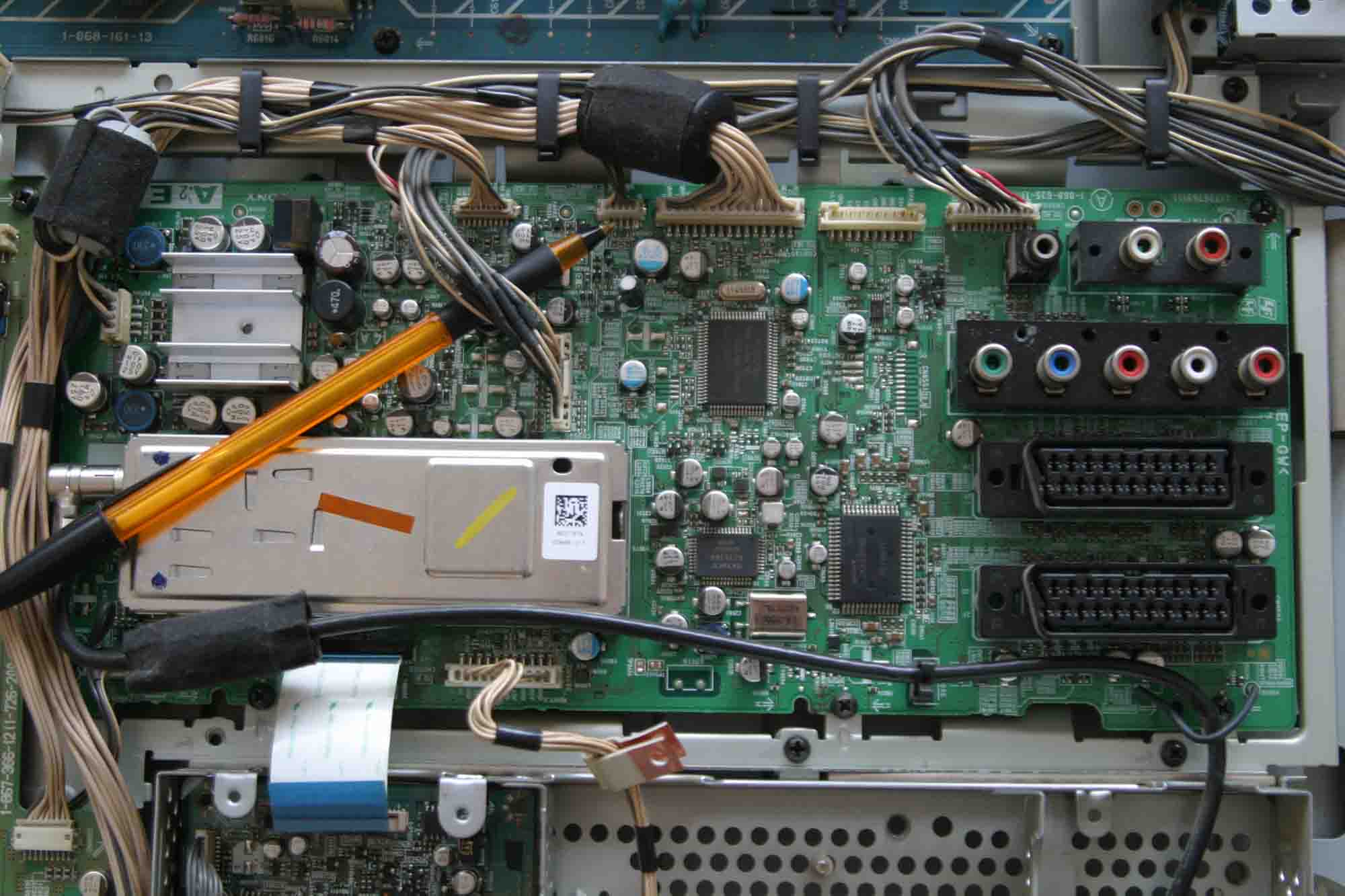

            On the A2E4 board there is a little circuit that I called “Start” in the attachments below. The pen shows where the circuit is.
            I thought that can be a start point for me.
            The black arrow PSW MAIN lead to the BE board were the Power button connects but there are empty places for resistors and the end is connected to nothing!
            How this PSU is waken up ?
            A2E4 (Analogue Tuner, Audio Amp, Chroma Decoder, AV Switch, Scarts, YUV Input)
            BE (Video Processor, PC Input)
            G3 (Power Supply)
            GE2 (Power Supply Regulator)

                              Okay, after a bit of looking at the service manual, at one point or another I came to ask pretty much the same questions as you - namely, which IC/board are responsible for turning on power to the TV. After a bit more analyzing, this is what I came up with so far:
                              1) When the power is switched on from the remote or TV button, one of the ICs (I'm thinking IC8503 and/or IC8500 on A2E4 board) sends a signal to the GE2 board to turn on all of the regulators (IC8800, IC8802, IC8803, IC8810, IC8805).
                              2) Once all of the regulated voltages are running, DC POWER (block diagram name)/DC ALERT (schematic name) comes up and allows PSW_MAIN to go high, which in turn sets POWER ON to high.
                              3) This in turn causes the PSU (G3 board) to turn on. Then, AC OFF DET goes low (or high?) and enables the main microprocessor IC1003 (pin 67) on the BE board as well as a number of other things such as SWITCH OFF MUTING (block diagram name on A2E4), HEADPHONE MUTE (again block diagram name), STEREO AMP IC7809, and triggers BACKLIGHT on BE board and LCD.
                              4) TV runs happily?
                              All of the above is just a theory, though, and I still have a few questions unanswered.
                              So for starters, I'd like to know all of the voltages coming out of the PSU (G3 board) on CN6200 and CN6201. However, measure the voltages with the PSU disconnected from all of the other boards. Do NOT force the PSU to turn on for this - just plug it in the wall and measure the voltages on CN6200 and CN6201. I'm particularly interested in AC OFF DET.
                              After this, repeat same experiment as above, except this time connect the GE2 board to the G3 board, but disconnect everything else from the GE2 board. On GE2 board, measure voltages on pins 6, 7, and 9 of CN8802, and everything on CN8801.
                              Let me know what values you get. I have about a page worth of notes but need to double-check my assumptions on some of the stuff.

                                I checked the connectors, CN6200 & CN6201 on stby,
                                1st with everything disconnected and
                                2nd just one side of GE2 connected to PSU
                                I have the same readings in both cases;
                                CN6200 - 0V on all pins
                                CN6201 – 1.35V on AC OFF DET
                                On the CN8802
                                Pins 6, 7, and 9 are at 0
                                (if I understood you right, is when those are not connected to the A2E4, if they are; 0.55V on pin 6, on 7 and 9 almost 0V)
                                On the CN8801 every pin is at 0V
                                *Concerning the reg.17.5V that are at 19V I saw a over voltage protection on the BE board left side on page 44.

                                      Aha! So my first assumption about how the TV powers on is not entirely right. New assumption:
                                      1) When the power is switched on from the remote or TV button, one of the ICs (I'm thinking MAIN MICROPROCESSOR this time) turns on the PSU (G3) by pulling POWER_ON high.
                                      2) PSU turns on and sends voltages to the regulator board, GE2. AC OFF DET also goes low (or high?), thus letting various ICs know that power is present.
                                      3) PSW DIG, PSW SW, and PSW PANEL 5V go high (or low?) enabling the regulators on the GE2 board to produce the proper voltages
                                      4) Proper voltages are checked, and if correct, BACKLIGHT is turned on and TV switches on.
                                      With these assumptions, I now have the following questions:
                                      1. How are you turning on the TV - are you using the remote or the buttons somewhere on the side of the TV?
                                      2. Can the TV be turned on from those buttons at all? If so, do you know what board they connect to?
                                      3. Otherwise, do you know which board has the IR sensor for the remote?
                                      Basically, I'm trying to establish which IC or ICs is/are responsible for turning on the TV or at least get an idea. I'm thinking IC1003, the MAIN MICROPROCESSOR on the BE board.
                                      Originally, I thought it was the PORT EXPANDER ICs, IC8500 and IC8503 on the A2E4 board since they seem to be involved with PSW SW, and PSW DIG and these control voltage regulators on the GE2 board.
                                      However, I now see 2 new possible inputs - KEY and KEY2. I *think* these are connected to the buttons on the TV. KEY and KEY2 are located on CN1007 of the BE board and go out to CN9802 on the H1E board (refer to block diagram of BE board). KEY and KEY2 also seem to be connected to the STBY2.5V (through 1 kOhm resistors R1031 and R1033) and then go to pins 24 and 27 on IC1003, the MAIN MICROPROCESSOR.
                                      KEY also seems to be involved with IC7402, PORT EXPANDER, and this IC is directly connected to PB_FAIL, PA_FAIL, POWER/RESERVE_LED, BACKLIGHT, ON_TIMER, and PC_V_DET. It's also connected to 5vsb, so it's probably important.
                                      So, do you know what the H1E board does and where it is located?
                                      Originally posted by Longbolt
                                      Why on page 39 pin 67 seems to be connected to 3.3V stby terminal when I checked with the meter there was nobody.
                                      Pin 67 is directly connected to POWER_AV. STBY3.3V connects to pin 67 through a 4.7 kOhm resistor, R7549, so that's why you might not see voltage there (perhaps IC1003 is pulling it low until power is enabled). There should be 3.3v on one side of R7549, though. If not, then that might be a problem.

                                        H1E is the buttons circuit, the TV can be turned on from those buttons.I do not have the remote.
                                        H3 is the IR sensor board.
                                        I have tried in the beginning to understand what H1E circuit does but I can't , it probably brings to ground the 2.5V on pin 24.
                                        I do have 2.48V on pin 24
                                        KEY is connected to the button Power ON/OFF
                                        Yes, KEY leads to a port PORT EXPANDER IC 7402 also to pin 24 on Main processor and REAL TIME CLOCK IC1007.
                                        IC7402 have to do with the Backlight and POWER/RESERVE_LED. Key signal seems to be controlled by IC7402 via Q7420 but here agian I regret to do not understand.
                                        It's really easy to find the word KEY inside the PDF by pressing Ctrl+F, for me it's getting complicated afterwards.
                                        When I press power button a red light lights on ant if I press it again it goes off. I read 2.48V on pin 24 in both cases.
                                        I can try to know if the led that lites is the POWER/RESERVE_LED or the stby one. Ideally pin 24 (key) drives pin 67 (power) and the main processor is very ill.
