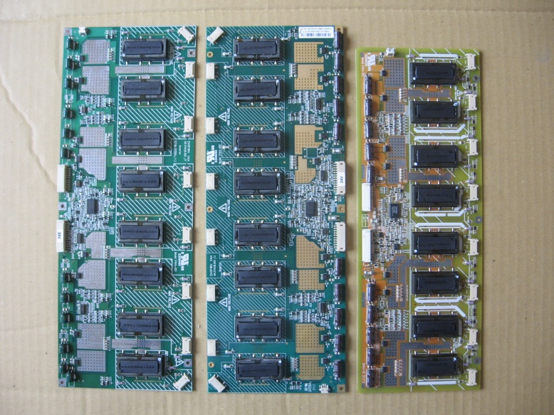

      Set 1 differed from the other 2 in both the inverter (different physical size and placement of chassis screws - Invert_comp.jpg) and the connection from the AV board to the LCD panel (smaller, though number of used pins is the same). The panel is good, the power board can be recapped, but the inverter has one bad transformer. The numbers on the transformers are all slightly different - can someone advise what I need to get to replace? An example of the one that is faulty is 4006A422096.
      I will try to get the inverter working, so ultimately set 1 will be essentially original.
      The other 2 sets appear to be more similar. I eventually got together a combination of parts that has been "working" for the past few hours.

        On the inverter transformer P/N 4006A422096. The 4006A is significant, the 422096 or whatever is a production lot or date code.
        Measuring resistance is a crude approach to what we are really trying to do - determine if the transformer has shorted turns. A better method would to use a ring tester, but only us old TV types have them on hand. If the transformers were wound with a slightly different gauge of wire the resistance would be different, but as long as the turns ratio was the same they would work perfectly. I had exactly that situation with one TV I repaired - except for one, the originals read very close to 1K. The replacement read just under 900 ohms, but worked perfectly.

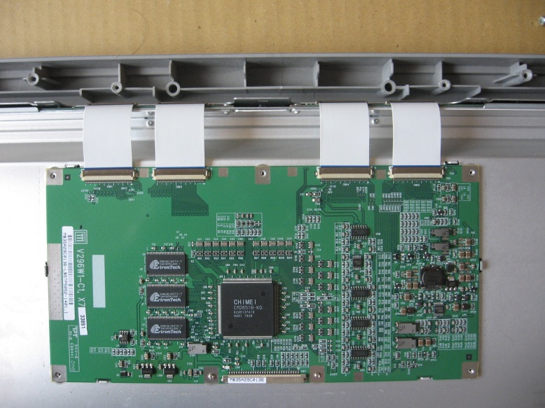

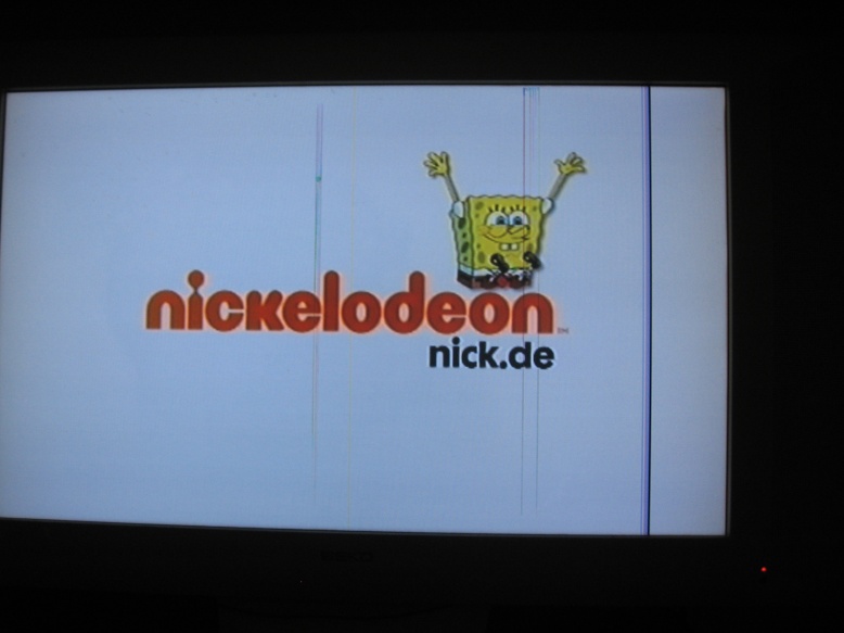

        The vertical lines are caused by a bad bond between the ribbon cable from the Tcon and the glass panel. Sometimes they can be fixed by applying pressure.

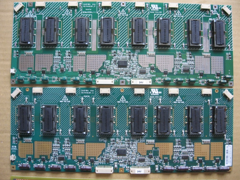

                    Heh, sorry, I do try to be descriptive, that one slipped through.
                    With that inverter in, it does 2 seconds to black.
                    The transformers all give the same resistance (roughly 930 ohms), and the 4 fuses are ok.
                    The 12 electrolytic caps are "NKCON"s, 100uF/35V (the later revision inverter that works uses 10 Nichicons 82uF/35V).
                    Is the driver a chip, or chips associated with each transformer?
                    There's nothing visibly blown/damaged on the board.

                      The prime suspect would be capacitors. I'm not sure of NKCON caps - they may be good or bad.
                      It's possible you have an open driver; a shorted driver (the usual failure) would likely blow a fuse.
                      A good test at this point would be to hook a single CCFL up to each output in turn and see if it lights up. If it fails to light in a single position there could be a problem with a component in the protection circuit.

                        I put the faulty inverter in the set that was working, and connected each of the 8 connections to the CCFLs in turn. In each case, the panel lit up, and 1 or 2 seconds later went black.
                          PlainBill
                          I took the panel apart, and found that there were residues of the panel's dunking in the water. There were also dust and fibre accumulations around the flexible connections that I can only liken to the way branches and debris gets stuck around bridge buttresses during a flood. I cleaned it up, but also noticed that most of the lines were visible in the panel even with it off, so there is some irreversible damage to that panel. The bigger cluster of bad lines (which go all the way from top to bottom) towards the right of the panel improved a bit, so they can probably be sorted if I take the panel apart again, and do something to improve the connection. I also noticed some pin-head patches in one small portion of the panel, which appear to be inside the LCD panel. Reminded me of mould; is that possible?
                          Anyway, I had a look around and can see replacements for upwards of $90 for the panel, to $300 for panel, CCFLs, diffuser, LCD and inverter board, but not sure it's worth splurging $90 (+ shipping) for the panel. I might be lucky and find one much cheaper at some stage.
                          During the search for a replacement panel (which is a CHI MEI V296W1-L14), I did see a V296W1-L11 for a reasonable price. Would these be compatible?

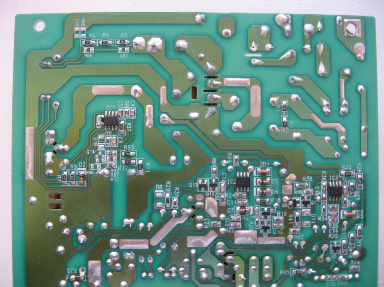

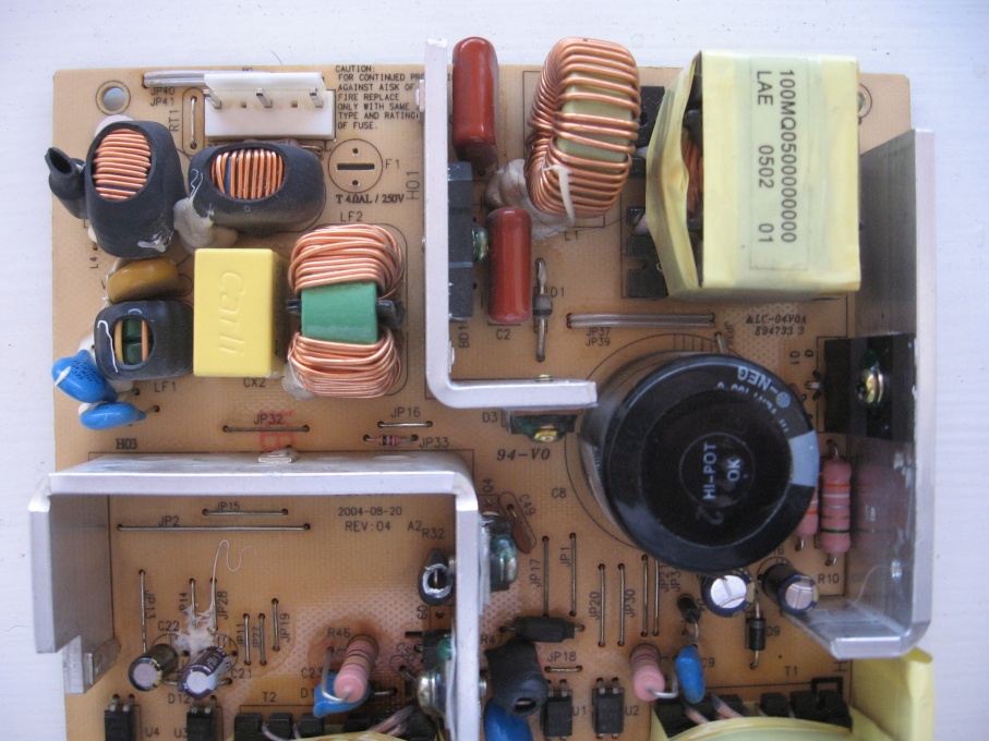

                                Ok, back again after having recapped all 3 power supply boards, with all caps replaced except the big one.
                                2 of the boards are now good, giving correct voltages and powering up the TV set with no issues.
                                The 3rd power supply was also recapped, but found to be dead. Further testing found that the PCB fuse (F1 on the mains input, red cylinder, top right section in this picture here was blown. It's one of these.
                                I didn't have any replacement, so desoldered one of the good ones from a good board and swapped it in. Upon power-up, the power board blew the fuse in the power cable plug, and tripped a switch on the distribution board, but the F1 fuse is still intact.
                                Now, I have 2 working power boards, but would still like to get the 3rd functional as a backup if possible, so any further direction in what to test, what's likely to be at fault, I'd be grateful for any help.

                                      I was looking for replacements to the NKCONs at my local place (radionics), but couldn't find the caps with the same uF/V AND same dimensions. What would be the recommendation for replacements, closer to the same length or diameter?
                                      All 3 power supply boards are the same, so it might be easy enough to compare some components, I don't know where best to start though. I've attached photos of the early part of the power supply board, both sides.
                                      I took the F1 off the board, and put it back on the good board, so are there any tests I can do without having to power up the board, at least until I can get a replacement fuse?

                                        Primary suspects are the bridge rectifier and the power FETs. There appear to be a couple of extra diodes, those should be checked too. Concentrate on the primary side of the transformers.

                                          Ok, did a few tests.
                                          On the bridge rectifier BD1, I was getting about 0.5 as normal (using guide from here), but when I reversed the leads to see if I see a high reading, I was getting the same 0.5 (the BR on the good board was showing about 0.5 and high as expected with the various combinations).
                                          The D1 diode (BYV28-600) close to it was reading 0 both ways (and fell apart when I desoldered it, and I think I can see the fracture line on the original photo). I was seeing about 0.37 and high on the corresponding diode on the good board; is this possibly marginal?
                                          However, when D1 was taken off the board, I retested the bridge rectifier. The AC to + tests were reading 0.5, reversed they went up to 0.8. The AC to - tests gave similar results, 0.5 normal direction, 0.8 reversed.
                                          D1 is (normally) connected between points 1 and 4 of the bridge rectifier.
                                          Does the bridge rectifier sound like it's ok?
                                          Would the bad diode at D1 be causing the blown fuses? Or do I need to look at any other components?
