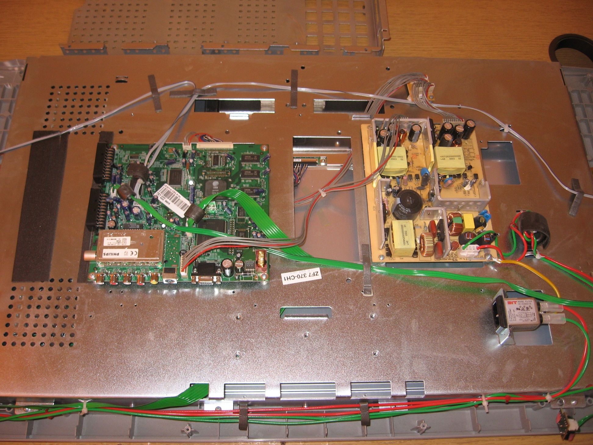

    I have this LCD TV, and it's giving sound but no picture. Some seconds (maybe 15-20secs) after starting up I can see a quick flash of a picture, but it disappears, sound remains.
    A quick google finds this:
    NR 30WLB500S-(CHASSIS-L4B)-No pictures sound ok back light can see for 1,2 second -problem in inverter board (V144-301) faulty one of hight voltage transformers (4006A4250037).

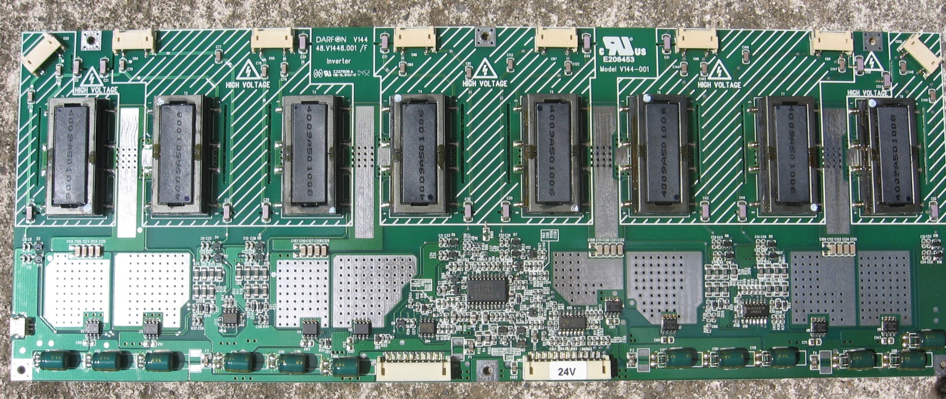

    I took the inverter board out (attached), and can see it has "Darfon V144" markings on it.
    Is there any good way of testing the voltage transformers? Is it likely to be 1 or all of them faulty? Any other checks I should be making?
    Thanks.

    You have found good advice. These inverters and transformers are notorious for shorted secondaries. (Darfon is the Yugo of the LCD world.) It is likely to be only one transformer. If you look at the picture, the pins are numbered. Pins 1 & 8 are the ends on one secondary winding; pins 4 & 5 are the end of the other secondary winding.
    Testing is easy if you have an DMM. Set it on the 2K ohms range and measure each transformer from 1-8 and from 4-5, making a note of each reading. The windings typically measure about 1000 ohms, but this can vary from lot to lot. In a single batch I would expect them to match to within 3%. What you are looking for is a secondary that is significantly different (lower) resistance than the rest, or that reads open.
    Once you have found it, Chip-quik makes it easy to remove the transformer. Replacements are available on eBay, or a company called Electronica USA carries them.

      Thanks for the pointers Bill, this is what I get when I measure the 1-8's and 4-5's:
      1-8: 4-5:
      943 944
      932 933
      921 926
      930 928
      927 931
      932 931
      942 944
      942 941
      What do you think, the only one that stands out to me is #3, but it still looks alright, I think.

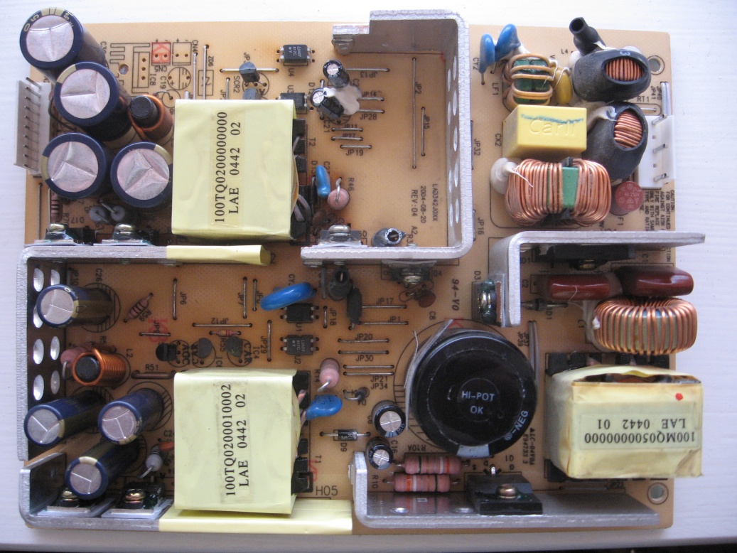

      EDIT: I had a closer look at the power board, and there are a couple of bulging caps, I'll put it back together a bit, and see what voltages are coming off it's connectors.
        Re: Beko 30WLB500S - Sound, no picture
        Ok, I checked the voltage on the 2 connections coming off the powerboard. Both are supposed to have +24V, I was getting about 15V on CN3, and 0V on CN2. You can probably see the 2 caps nearest the bottom-left corner with the bulging, and they were squealing too.
        CN3 is connected to the videoboard, and CN2 is connected to a small board towards the top-right of the main picture of the back of the TV, where it is split into 2 and goes to the 2 connections on the inverter. There are 4 wires from one of the connections on the inverter looped back to the videoboard.
        So, definitely a problem at CN3 with the bulging caps and 15V, but what about CN2 with 0V? Is it possible that that part of the circuit doesn't get switch-on until other parts check-out? That power control pin is jumpered over to that side where I was seeing 0V. Any other considerations?

          As far as the caps go, it looks like capxon caps. The worse caps ever. After you change all eight of the tall dark caps, you should be OK. This will affect your output voltages to the inverter board.
            Capxon does not have a good reputation on this forum. Since 2 were obiviously bad, the rest could be considered bad by reason "guilty by association".
            Capacitors die from age, heat, and shoddy build quality. Capacitors DO NOT have to be visibly bloated in order to bad. They can be out of tolerance uF (a 1000uF measures 20uF) and/or have high ESR (ohm). A multimeter will be insufficient to test for ESR. For that you need an ESR tester which costs between $50 and $300.
            Most members here will recommend that you replace ALL capacitors with reputable brands from reputable sellers. Brands like Rubycon, Panasonic, and United Chemicon are suggested. A list of recommended caps can be found at

              Thanks, yes, they are CapXon caps, all 8 are 1000uF, 4x25V on the left, 4x35V on the right.
              I actually got 3 of these TVs today, a caretaker at work held onto them for me. Was thinking maybe do a Frankenstein, and get at least one working, but a caps change is no big deal. One has a smashed screen, one seems to have a bit of water in the screen, but the 3rd seems to be fine. If the wet one doesn't dry out, I should be good for various boards for a few years on the one with the good screen.
              What's the convention on upgrading these caps, what would be a good manufacturer/series? Also, keep at 1000uF obviously, and up the 25V to 35V, and the 35V to 50V, or just up them all to 50V?
              EDIT: Forgot to say that the other 2 TVs, there were 6 caps bulging in one, and 7 in the other, a few also discharged a little bit on the top, but all confined to these 2 sets of caps.

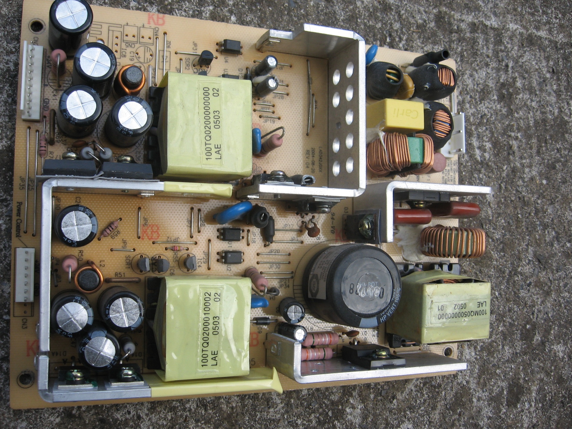

                  Ok, replaced the 8 caps on one of the power boards with Panasonic FC's, but I'm still seeing about 15V on one connector (CN3), and 0V on the other one (CN2).
                  Although I used the same capacitance and voltage (1000/25 and 1000/35), the caps are not the same height/width; would this make much of a difference?

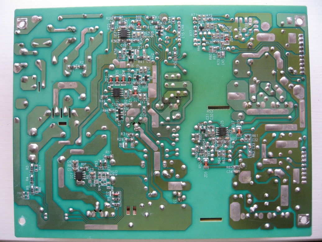

                            Have attached a photo of the solder side of the power board, quite a bit of heat damage around the transistors in the middle of the board.
                            I connected the set up to a SCART input, and when the screen momentarily switched on, I could see the correct picture, and noticed that the sound continued after the picture switched off again.
                            Any pointers on what to test next?

                              Classic description of 'Two Seconds to black'. Usually caused by bad caps in the power supply or inverter, a problem with a CCFL or the wiring to them, or a bad inverter transformer.

                                You're dead right Bill. I tested the inverter transformers and found one of them having 4.7k ohms on one of the 1-8 pins, when all the rest of them are about 970 ohms. This is a different inverter to the one I tested the first day.
                                As I said before, I have 3 of these models of TV, but the inverters between 2 of them that I've opened are different. Should they be interconvertable? I'm not so sure, as I noticed on the one that I'm testing right now (with bad inverter transformer) there is a hand-soldered jumper on the AV board that's missing on the other 2 models.

                                  Ok, I put the recapped power board into the set that has good inverter transformers, and it's giving 2S2B, although it seems the screen is lit a bit longer than before.
                                  With the set "on", I also tested the power on the 2 connectors off the power board:
                                  CN3 (going to AV board) is still outputting 15V (marked 24V)
                                  CN2 (going to inverter board) is now outputting 24.5V (marked 24V)
                                  So it seems that the wiring has some feedback loop to the power board to tell it to switch on the inverter side of the power board. And the inverter should be getting the correct voltage.
                                  Now, I've replaced the caps on the power board, EXCEPT the big 150uF/450V cap (also a Capxon). If it was bad, would I be getting the good 24V on CN2? Could it still be contributing to the the bad 15V on CN3, and could this bad 15V on CN3 going to the AV board still be causing the 2S2B?

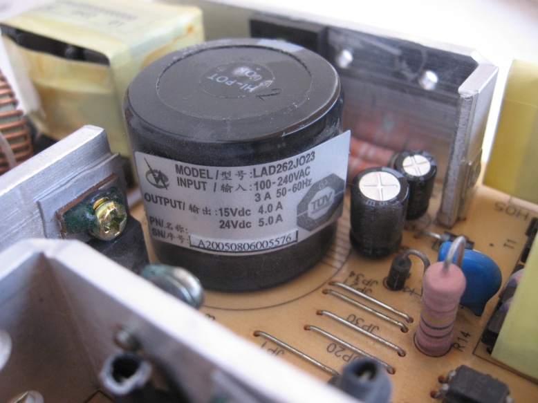

                                        Ok, I was looking at the power board again, and noticed the sticker on the large cap. I originally thought the sticker related to the cap, but it seems it relates to the board as it has 2 outputs on it, 15V and 24V, so it seems that the power board is good after all. The board has 24V and 24V printed on it, but it seems that was probably for a different revision of board.
                                        So, I've tested the transformers on the inverter board, and they seem to be ok (on one of the boards at least). Is it possible to safely check the voltages on the inverter output to the panel (blue and pink leads), just to be sure that the inverter is ok?
