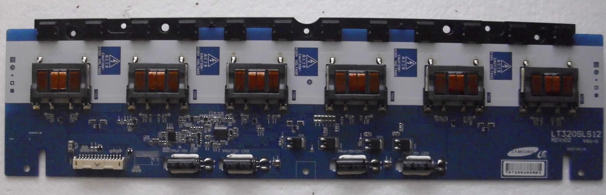

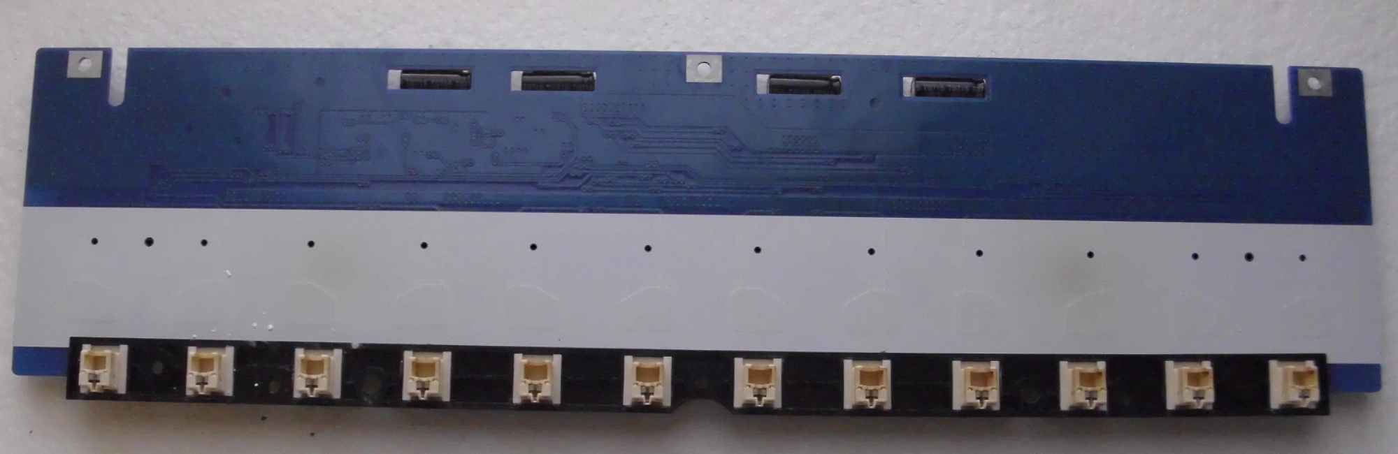

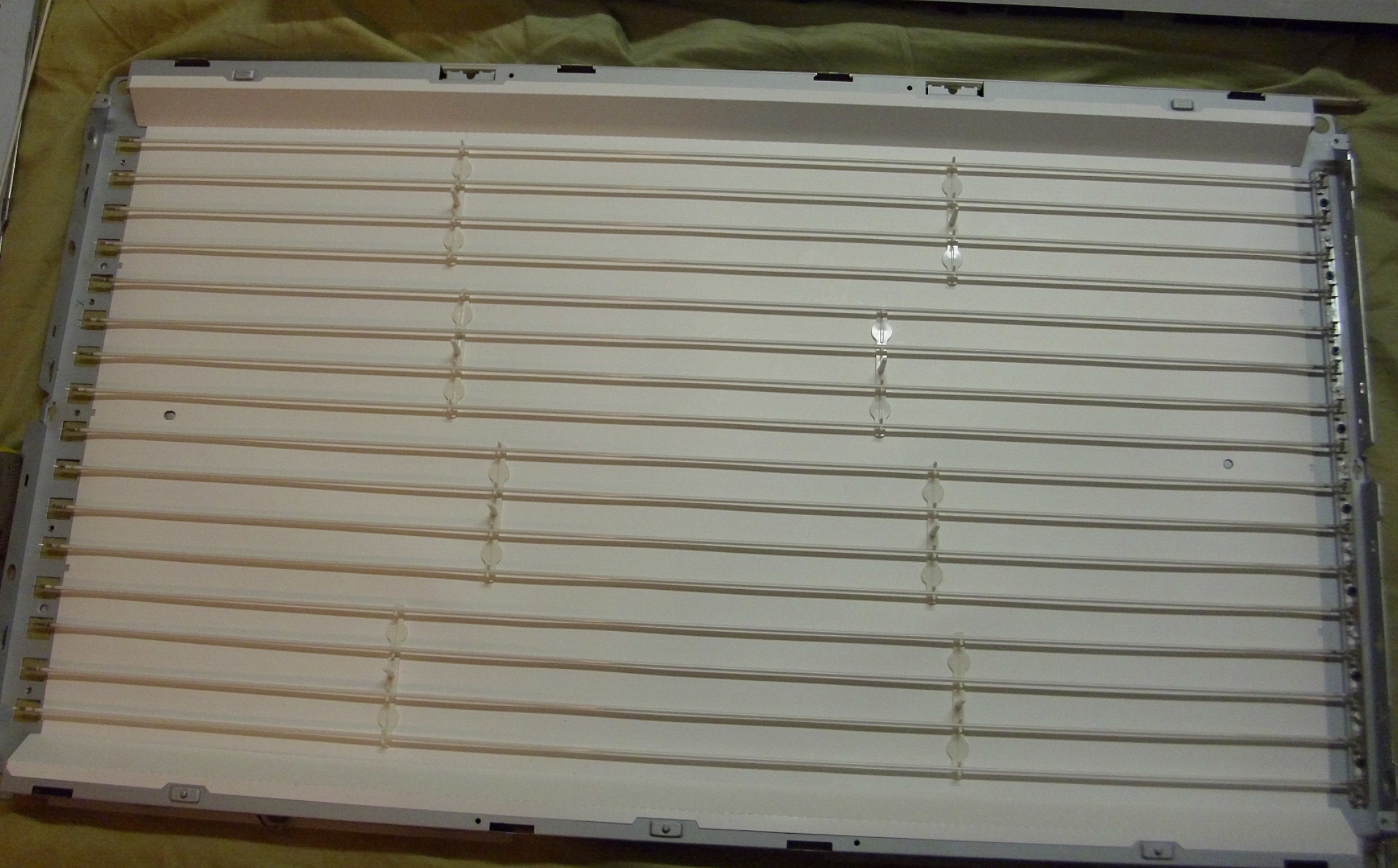

    I just recently was able to repair a 32” LCD television.
    The broken one was Samsung and it had a broken CCFL,I had a Sony of the same size with a broken screen so I was able to salvage a CCFL from it to repair the Samsung.
    Here's a picture of the inside of the panel

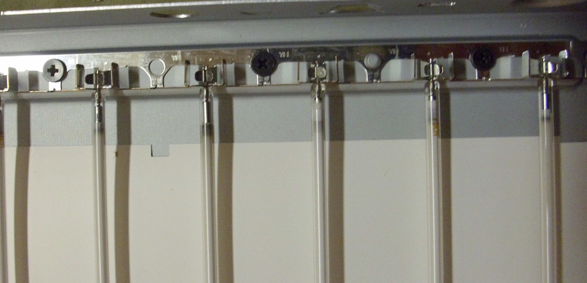

    Looks like the returns of all the CCFLs are hooked to a chassis ground
    The CCFL was actually easier to replace than the ones I do on LCD monitors

    On the inside of this monitor there are some white plastic clips that secure the CCFLs to the frame of the LCD.The CCFLs snap into these to position them in the correct place. I was very careful when I removed the CCFL tubes but the clips broke. Is there a place where you can purchase these if they do brake?
    Whatever I do, I consider it a success, if in the end I am breathing, seeing, feeling and hearing!
    • cadiman
      • Mar 2010
      • 397
      Re: Inside a 32" LCD TV panel
      rtv silicon will work fine and take any heat (auto parts store). The plastic clips are very easy to break.
