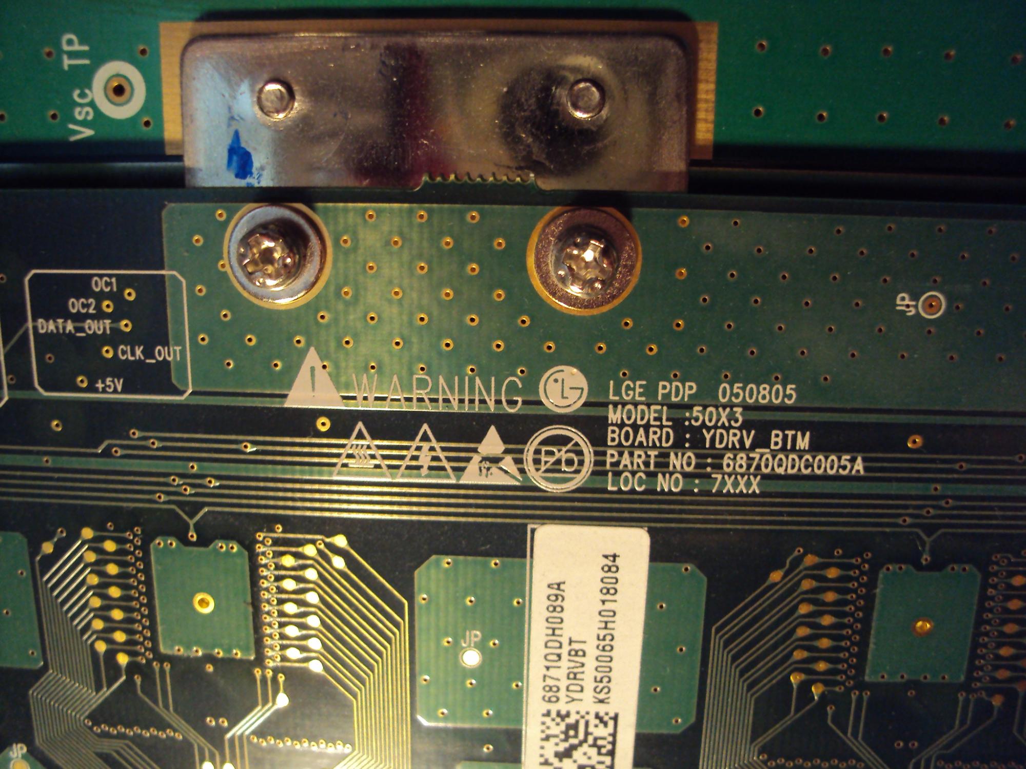

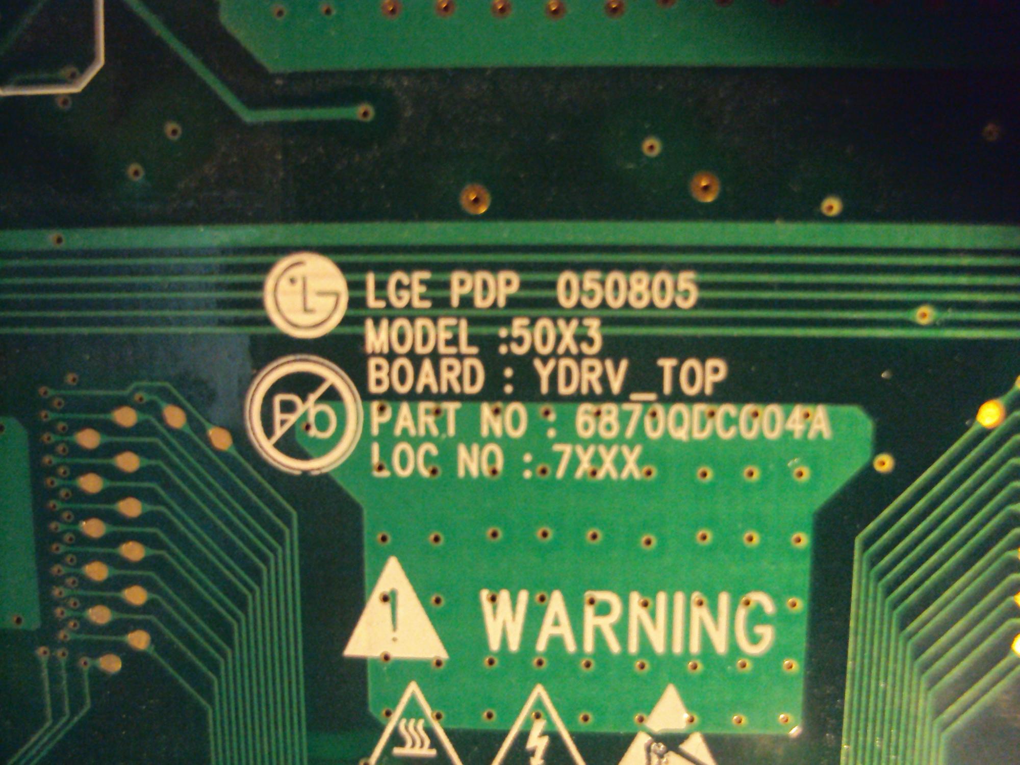

                  I may have that board. Could you post a picture of the buffer? It may be one long board or 2 shorter boards. In an LG they will be on the far left when facing the open rear of the TV.
                  Get the numbers on the white label. That will be the part number.
                  The fault in buffers is usually the flat pack IC's. Very difficult to change individually with highly specialized equipment. The parts numbers are easy to search out.

                    Sorry for the delay, here's pics of the part numbers for the buffer boards

                            It is a buffer problem not y-sus or z-sus. Replace buffers and it should work fine.

                              I found the problem it was the 6871QDH089A ON THE 50PC3D -LG /SHORTED FET
                              This damage on the power supply the FET SD20N60 Q852 I believe is the location and the Y-sus and z-sus board was bad too.

                                Yeah the FETs shorting on the buffer are a common problem with this panel.
