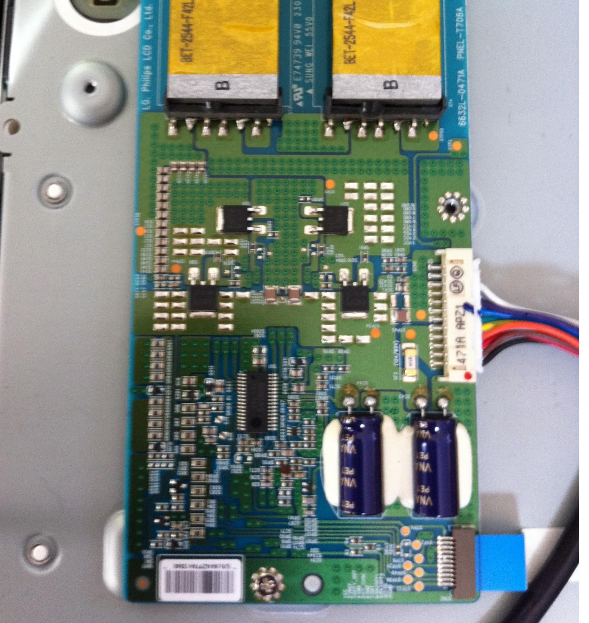

              Re: Vizio V042L FHDTV10A No Video but has sound
              Ok, I've taken the tv apart and im pretty sure that its the slave inverter board. I've confirmed that the power supply is functioning normally (5V standby on all the time and 24 VDC to both inverters when powered on), the master inverter has a blue LED that lights up when the power button is pressed and you can see the backlight turn on on the master side. The slave side does not turn on. I've confirmed power is being received, I cant locate the LDO for housekeeping supplies but the test points show 5.047V and 3.748V when measured so i'm pretty sure they are functioning. I've uploaded pictures of slave inverter board, there are no obvious problems with it. The second picture has the pins labeled here are the resistance values associated with the measurements.
              Q1 Q2 Q3 Q4
              1 to 2 285K 290K 40.4 100K
              1 to 3 284K 298K 8. K 80K
              2 to 3 8.49K 8.5K 8.5K 8.5K
              As compared to the master inverter board Q3 and Q4 values are a little off. Im not sure where everyone did their measurements however. It seems to me that the either Q3 or the driver ic is damaged as the input to the gate of a FET should be very high resistance. I also measured the voltage across the transformers during operation and confirmed that there was no voltage across the slave side. Any thoughts?
                Just for the heck of it, check the master board as well. By the way, the slave board does not have an LED on it. Only the Master lights up.
                  I did check the master board as well. That was what i used for a baseline value :-). The resistance values of the master board are as follows:
                  Q1 Q2 Q3 Q4
                  1 to 2 285K 290K 280k 292k
                  1 to 3 284K 298K 280k 280k
                    I've got both of the inverter boards in the lab today and I'm planning on powering them both up using a bench supply. Im going to assume that the flex cable supplied the PWM control for the CCFL brightness so i'll need to mock that up as well. The goal is to see if the driver IC is actually driving the MOSFET's correctly and to do a comparison between the master and slave circuits. I did notice last night, however, that when i was tinkering around with the master inverter that the only time it worked was when i had the chassis ground connection through the mounting points. I find it curious that the 24VDC return is not used for this purpose. Could you guys give me any suggestions on how to setup the ground scheme? Also what should I use for a load on the transformers? Thanks again for all your help.
                      I would do a much easier test that that. I'd simply remove the two in question (Q3 and Q4). Then test them individually out of circuit. With them removed, I'd check the board resistance on the same pads as well. If you check the board and still get the same bad readings, then it most likely is the driver chip. If when you check Q3 and Q4, they show the same bad reading, then it's definitely each of those components.
                        I shall do just that, I wanted to use the good board to confirm my findings. Which it did. The master board however still exhibits the same behavior that it did in the tv, namely it turns itself off after about a second. Any ideas as to why that would be? I dont want to replace all of the chips on the slave only to have the problem still exist.
                          These boards work in conjunction with each other. This is the usual behavior for this problem. I have noticed that whenver there is a problem with the master board, usually the light doesn't work at all. These boards share the same voltages however there are some differences with the master. I can't tell you how it does what it does or where the sensing circuit for the backlights is but I do pickup on trends of problems I see. I have seen this problem in Philips sets and Vizio sets. There are a lot more name brand sets with this same exact problem. LG is one as well.
                            Ok, so I got it working again, the problem was with the built in regulator on the driver IC. I noticed it was floating ~1VDC instead of the 5VDC. It was a simple chip replacement and the TV booted right up. Thanks for all your help everyone.
