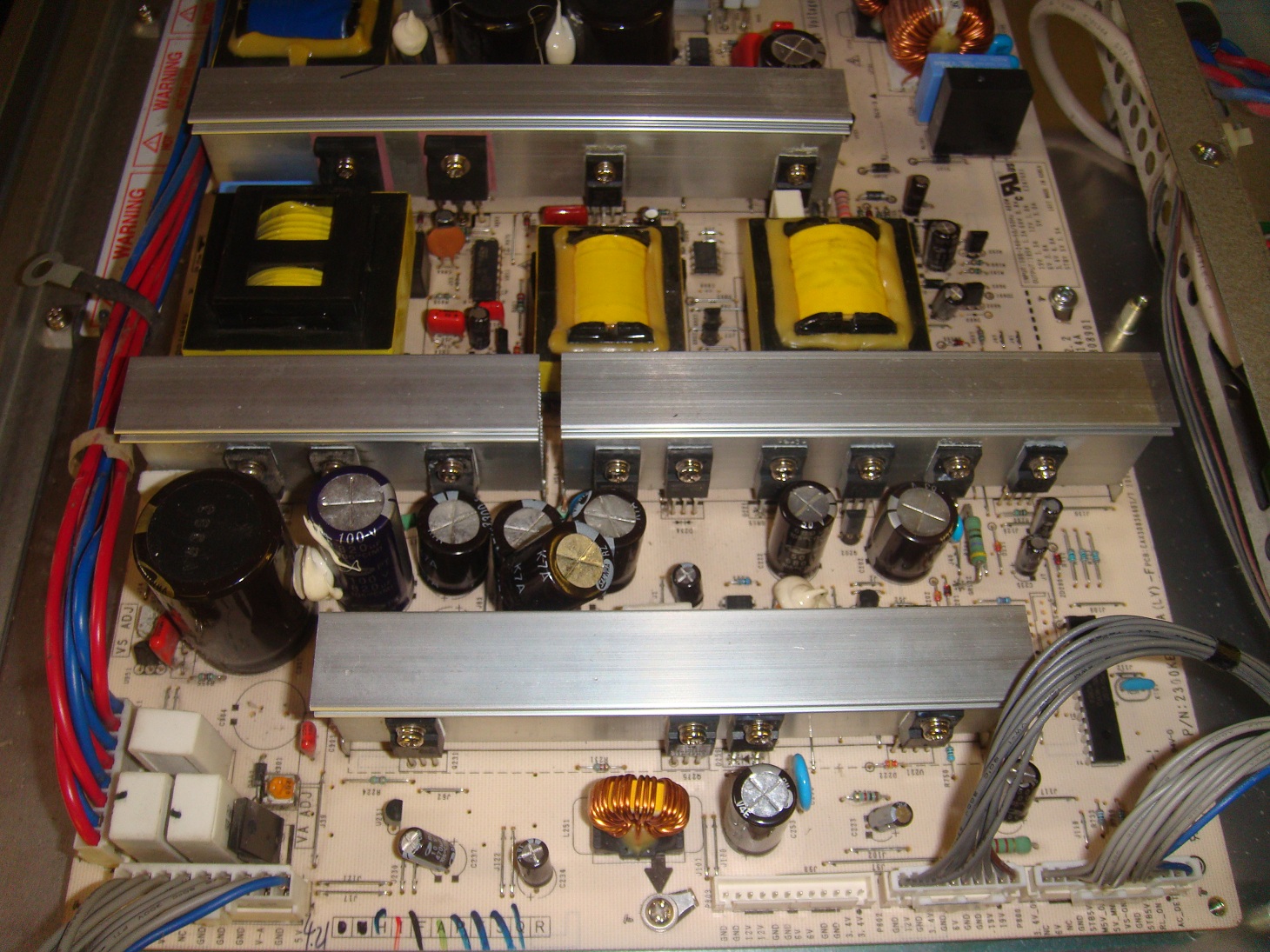

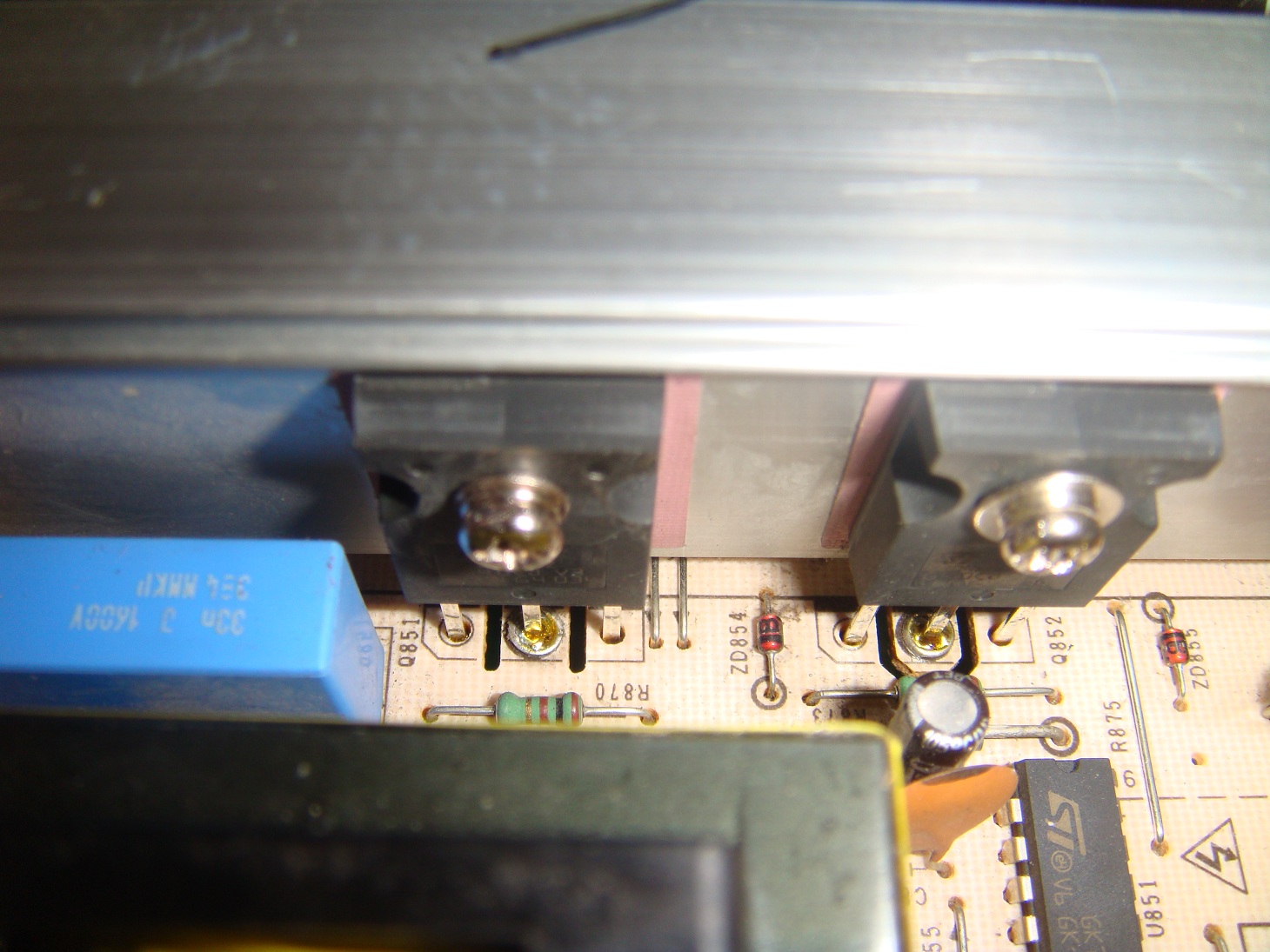

            Ok an update, been poking around the psu, found fuse F851 open, replaced it, no change fuse again open, checked some diodes in the area then 2 mosfettes near the fuse Q851 and Q852 marked W20NK50Z these seemed to read almost short allways, 1 to 2 ohms, I removed them from the pcb they both still reading short in all directions, thought this was wrong? but would 2 of them go short? maybe this is what they should read, stuck now so any advice PlainBill or anyone then can help
            thanks Ronnie

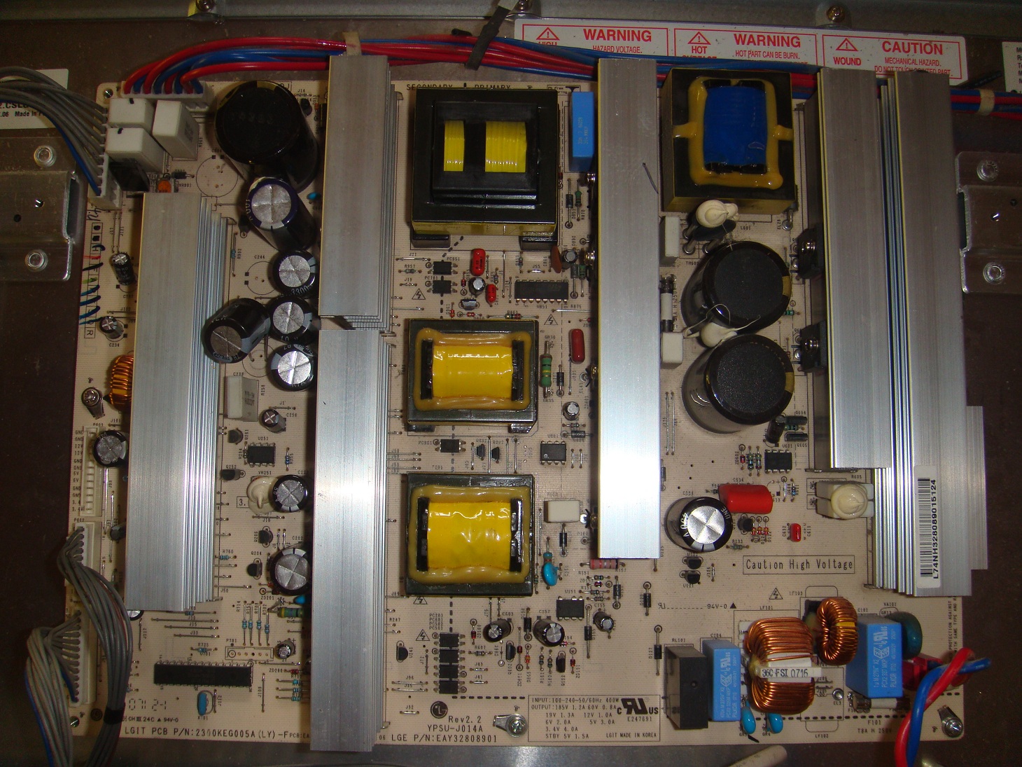

                    Ok mosfets fitted today power supply still shutting down! the fuse is now remaining intact, I'm now stuck, psu does not power long enough to read any voltages
                    sigpic
                    • netdent
                      • May 2011
                      • 208
                      Re: LG 42PC56 fault
                      Some pictures of the offending psu, the flying capacitor has extended legs as the same value I had to hand were fatter!!
