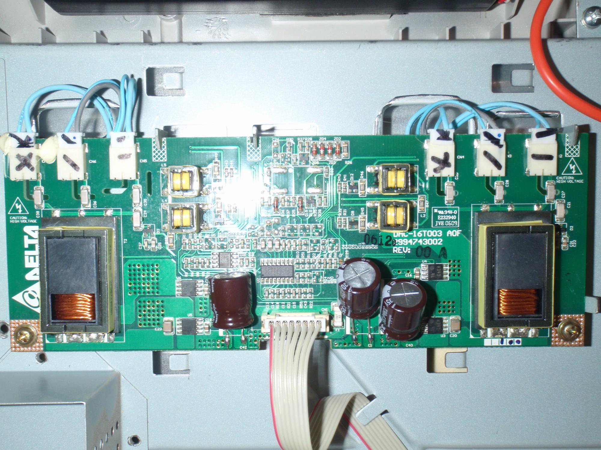

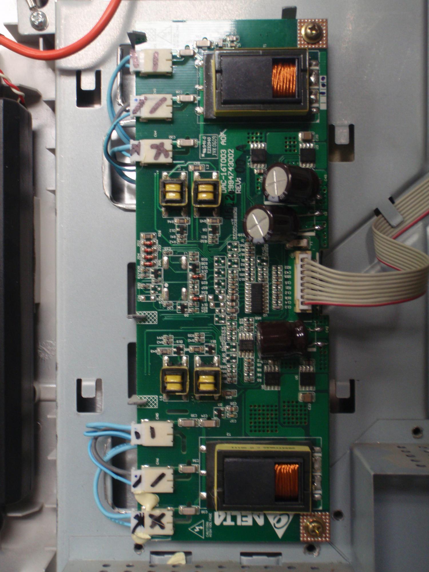

    Hi everybody, I have a Magnavox 20MF605T/17 here that had an intermittent backlight.
    I opened it up and found all 3 caps (CapXon GL 300uf 25v) on the inverter board had popped. Had some Nichicon PM series 330uf 35v caps on hand so I went ahead and put em in.
    I put the board back in and I still have no backlight.
    So I started testing further and while testing resistance on the 4 (small transformers?) labeled F2-F5 from leg to leg they all gave 98 ohms except one of them that doesn't even complete a circuit.
    I'm guessing my next step is to replace that component but I'm not even sure what it is or how to find a replacement, can anyone help me out?

      Re: Philips Magnavox 20MF605T/17 20" LCD TV Inverter Board Issue
      I think itek meant the coils L2-L5? The only fuse I see is F1 (marked with a "W") to the right of the ribbon cable. Also, check the four mosfets U3, U4, U5 and U6 for shorts, since the caps went bad.

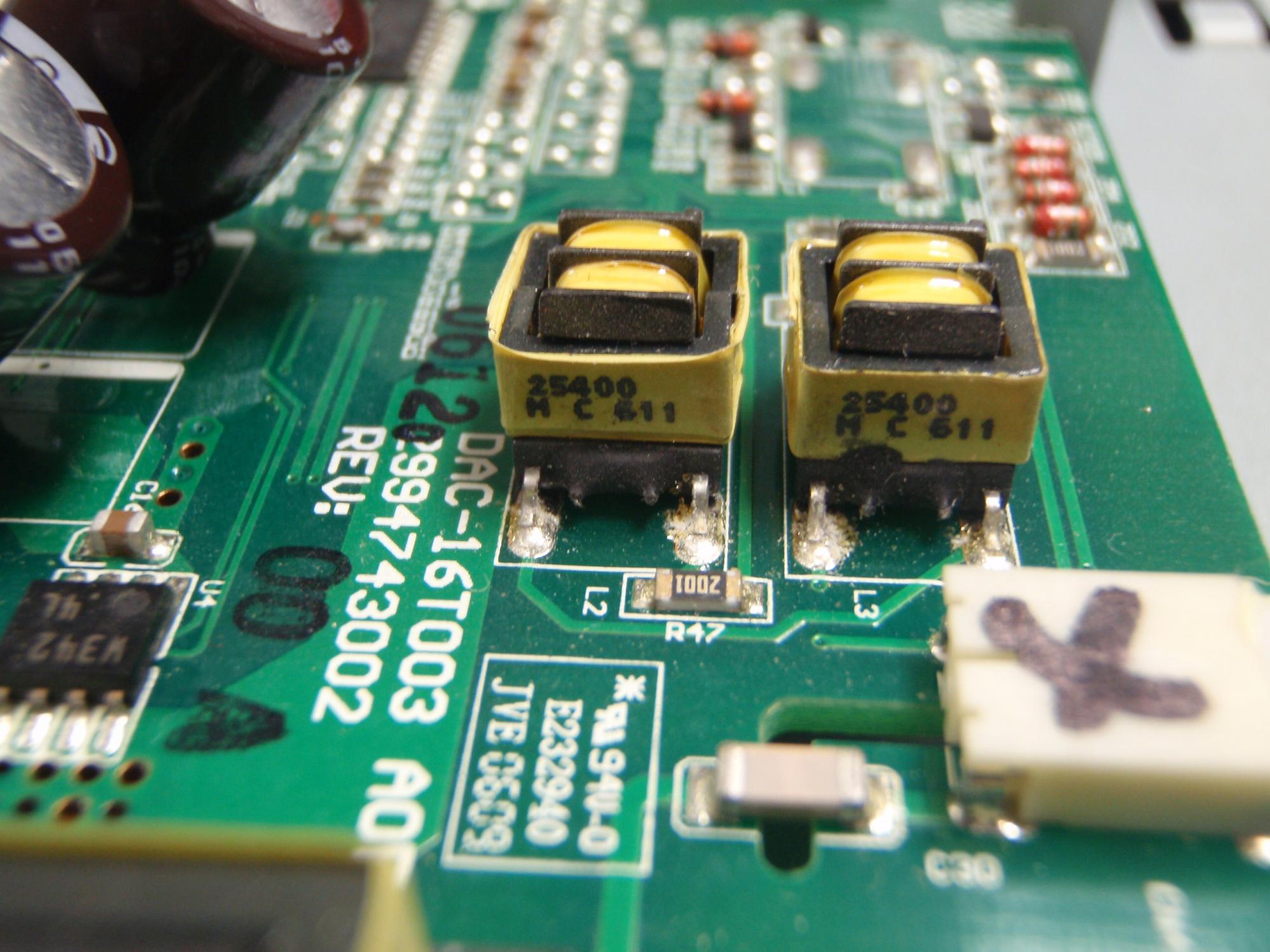

          Originally posted by itek
          OK so they are called coils, should I replace that one?,
          I always associate L with an inductor. I believe inductors should be less than 1.0 ohms.
          If you look at the picture, there is R47 which reads 2001 which is a 200 ohm resistor. Since this resistor is very close to the inductors, it may be affecting your readings and that is why the inductors read 98 ohms.
          If you have one inductor that isn't measuring 98 ohms, you can try desoldering it and measuring it out of circuit.
              Arrghh, I made a typo. 2001 is 2000 ohms (or 2k).
              If the inductor measures fine out of circuit, I wouldn't worry too much about the readings "in circuit".
              BTW, my experience with measuring inductors and getting 1.0 ohms is with the smaller standalone coil ones. These yellow square ones with multiple legs are new to me so 98 ohms or thereabouts could be the "normal" reading.
              PS. If the backlights are not coming on, it could also be the main board not signalling the backlights to come on and/or there is no voltage going to the inverter board.

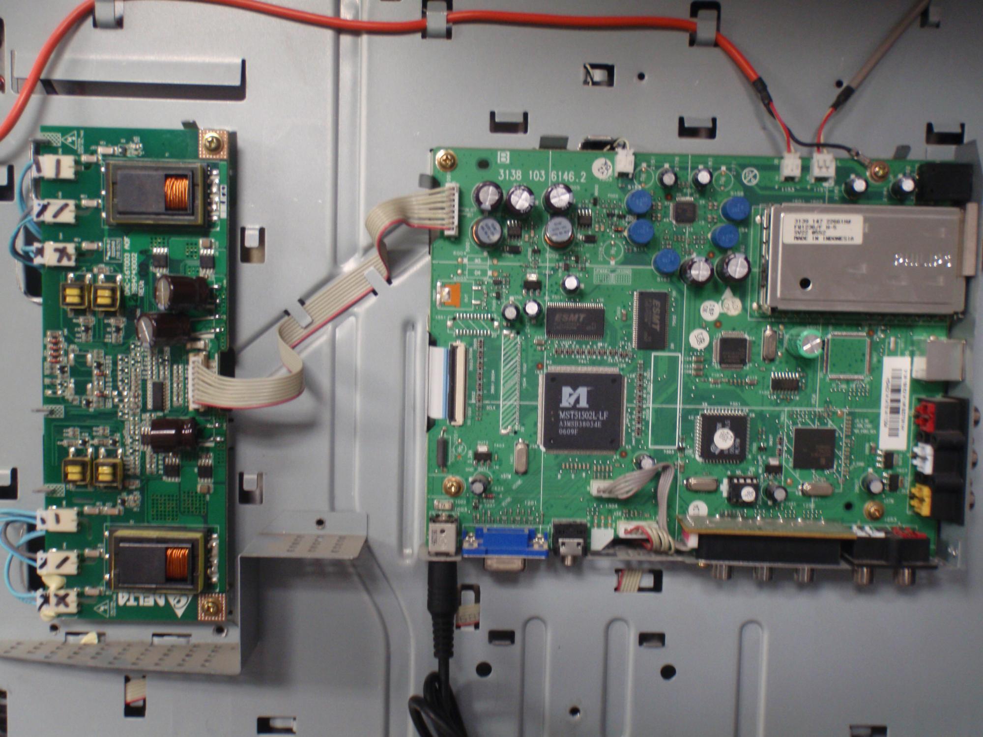

              Edit: I think you should post pictures of the power and main board.

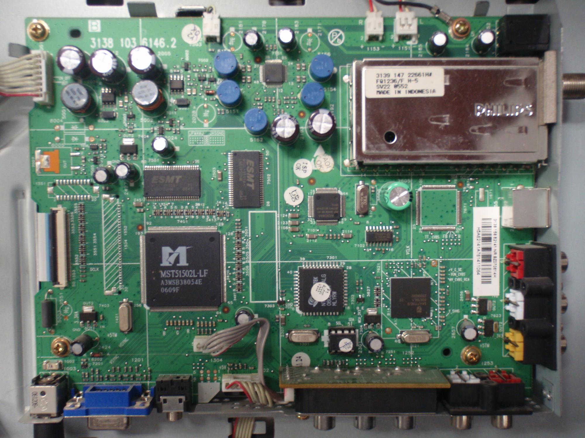

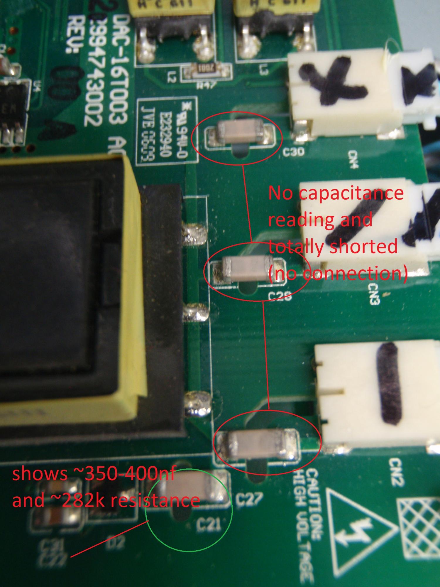

                  OK so here are those long ago promised pictures, I think I have narrowed it down to a series of surface mount capacitors as seen in the picture. Each backlight lead has one, and all of those show infinite resistance and no capacitance, while nearby caps that look the same show ~350-400nf capacitance and ~280k resistance. Should I go ahead and replace those? and if so how do I figure out which ones to purchase, thanks again for all the help and patience! PS., the leads to the inverter board are reading like this:
                  pin1 16.5v
                  pin2 16.5v
                  pin3 16.5v
                  pin4 3.2v
                  pin5 0.7v
                  pin6 0v
                  pin7 0v
                  pin8 0v
                  edit:: as I was typing this i may have cross pin3 and pin4 for a slight second, so I turned the set off then on again and now the backlight comes on for a second or two then shuts off! now I have this:
                  pin1 16.5v
                  pin2 16.5v
                  pin3 16.5v
                  pin4 1.6v
                  pin5 0.4v
                  pin6 0v
                  pin7 0v
                  pin8 0v
                  I am getting more and more lost,, does this mean I was wrong about the surface mount caps?
                    2 seconds to black can be
                    a) bad electrolytic capacitors
                    b) bad inverter transformer
                    c) bad ccfl and/or wiring
                    All discussed in detail starting with posts #13 and 14 at
                    https://www.badcaps.net/forum/showthread.php?t=10419
