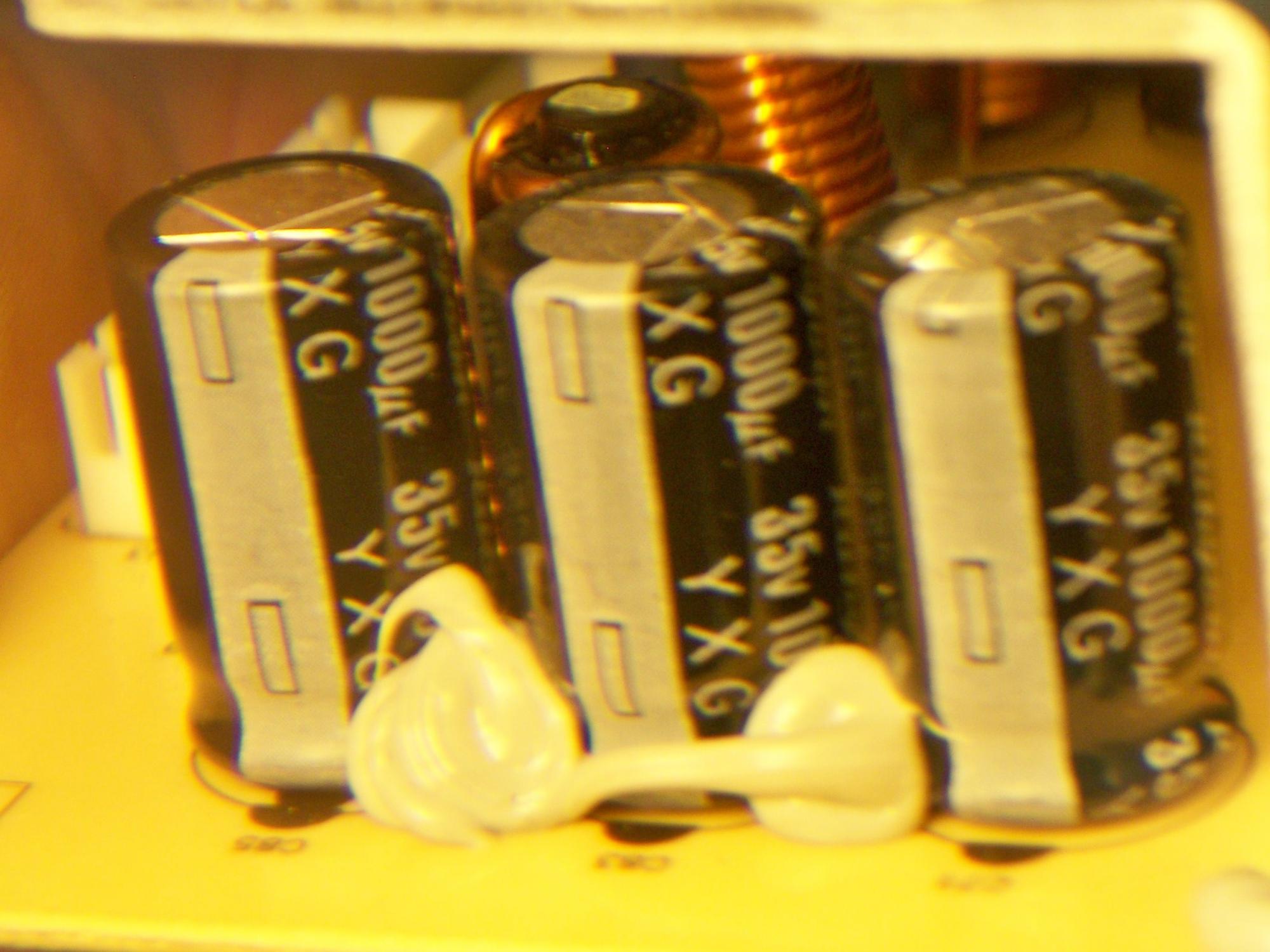

    Didn`t these have good caps in them? The ones I had were built pretty well.

      yeah actually i think they were saxmons or whatever.. but man, piss poor solder joints. I think these came out right when rohs complaice just got its start, frickin solder was horrid on this thing. Its amazing it ever worked.
          Are these Samxon GF caps? These caps could have high ESR?

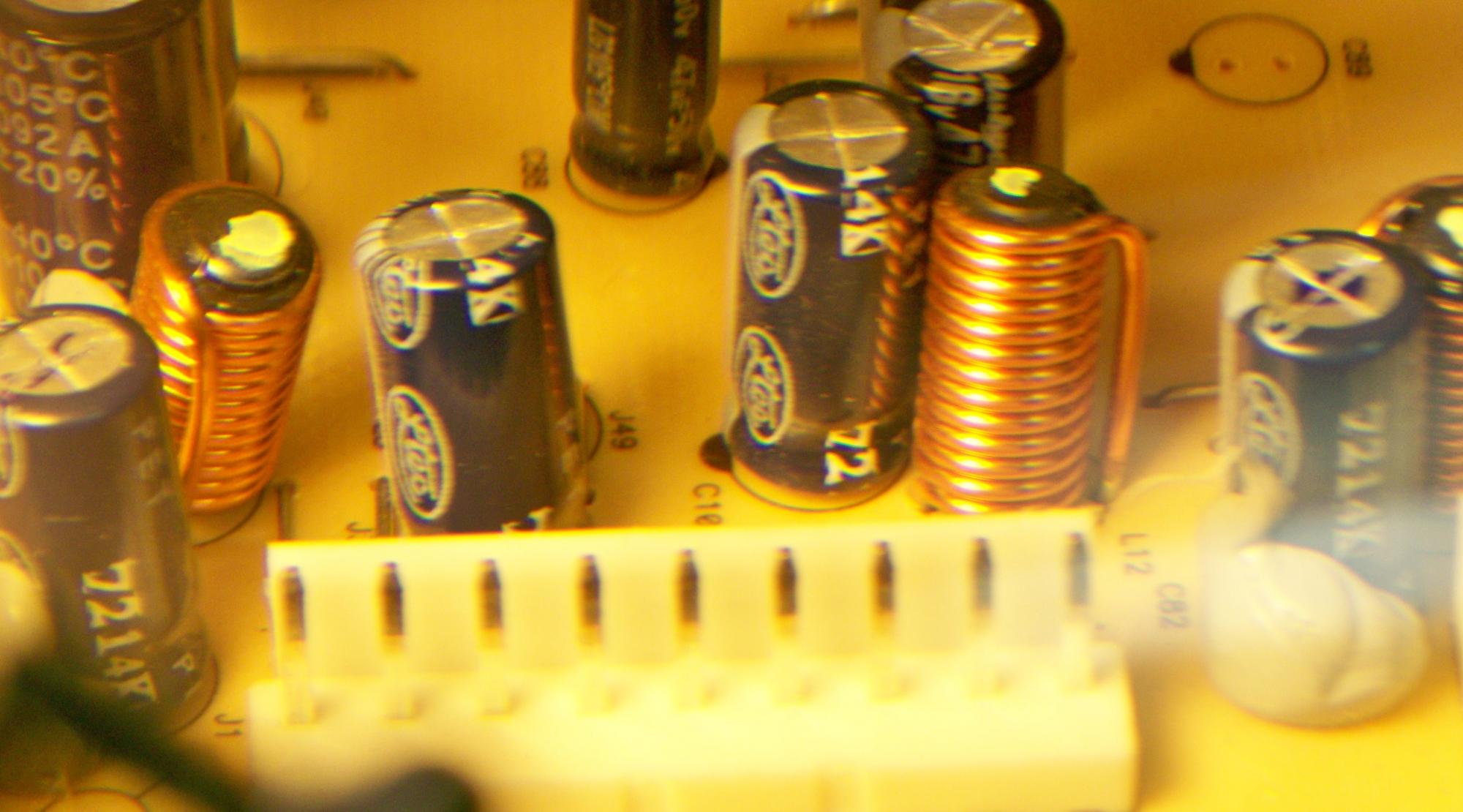

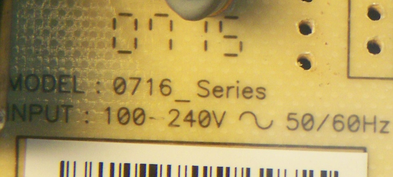

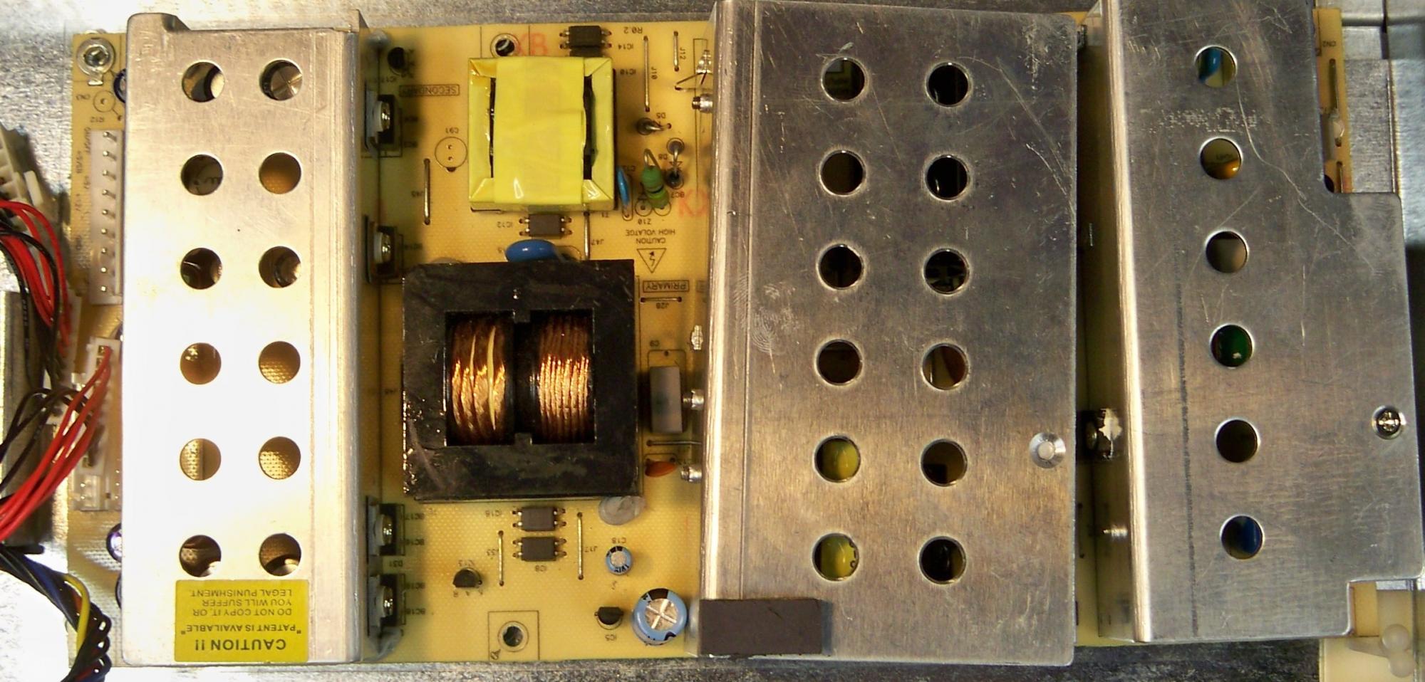

              Re: f.y.i. polaroid tla-04617c

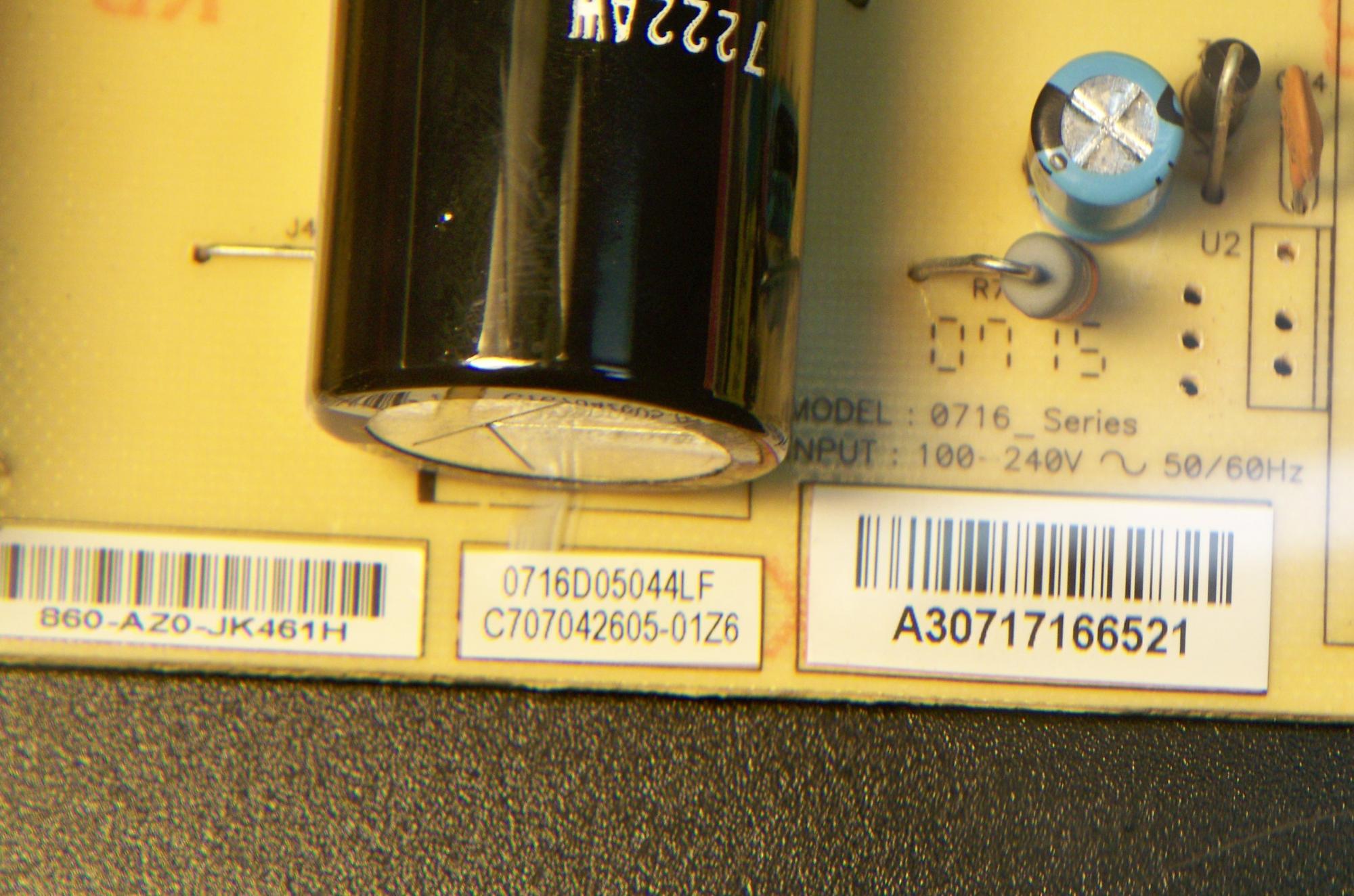

              Does this unit have one of those IPOS150 power supply boards or something similar? Post a pic if you could.
              • cadillacman
                • Feb 2011
                • 524

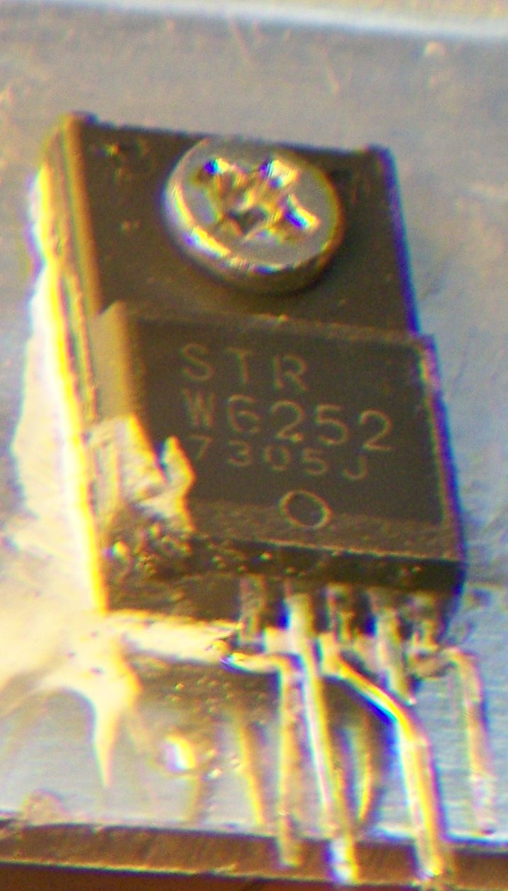

                well i managed to break a leg flush on u2, a str w6252... im so mad at myself..
                so i tried reflowing some more, replaced the smaller caps i could access- no dice.
                my 5v was pulsing with the clicking, 12v pulsing with the clicking, there was a 24v i think and thats the only one that stayed stable.
                i checked over some diodes and xistors and found nothing dead shorted.
                so i decide to try the two small caps under this heat sink, and in the process forgot one of the legs of u2, and now its broke lol...
                i dont think i ever got a chance to snap pics the first time around, i dafinately will now just give me a few mins..
