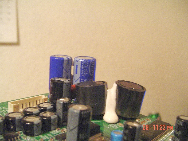

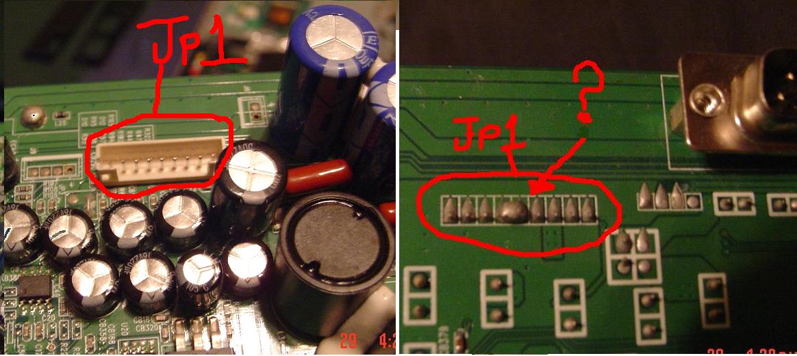

                Re: Polaroid TLA-04011c Red Light on, no power on
                Here are some concerns i found with this new board. i dont know if they have anything to do with the problem but i figured id ask.
                In the first picture "reversed.jpg" i noticed that the circled component is soldered to the board reversed compared to the the other board. i noticed it by looking at the the numbers on it and their orientation to the board.
                In the second picture "jp1.jpg" one side of the board is the JP1 connector and the other side they joined pins 4 & 5 together. Now at the cable, pins 2,3, 4 are ground and pin 5 has no wire. The old board DID NOT have pins 4 & 5 connected.
                In the third and fourth pictures "sideA.jpg & sideB.jpg" Side B, the circled component, is some kind of a bridge soldered to the board. In respect to its orientation to side a, i did an overlay of the bridge to give you an idea of what its bridging. Once again, the old board DID NOT have this.
                I hope i havent confused the hell out of you. but thats where im at with this problem. Thanx again for all your previous help. i really do appreciate it.

                  #48
                  First, a good bit of detective work. I've stared at boards like this for hourse trying to spot differences, I know how difficult it can be.
                  Picture 1. That component is a crystal; used to generate a precise frequency. It does not have a 'polarity', so that is not a problem.
                  Picture 2. That does not appear to be a problem. As closely as I can tell, pins 1-6 are all ground (You can verify this on the original board); only pin 7 carries a signal. Still, that's poor workmanship.
                  Pictures 3 and 4. I find this disturbing. The component that appears to be bridged is an inductor - used to reduce noise on a power supply line. There is a diode next to it, and an IC that might be part of a bucking DC-DC converter. I can fathom only one reason for that jumper - the inductor is defective (open). Bridging it like that is a REALLY bad idea.
                  Before returning it for replacement, I would look at the revision level of the two boards. If they are identical I would assume this is a bit of inexpert repair.
                  PlainBill

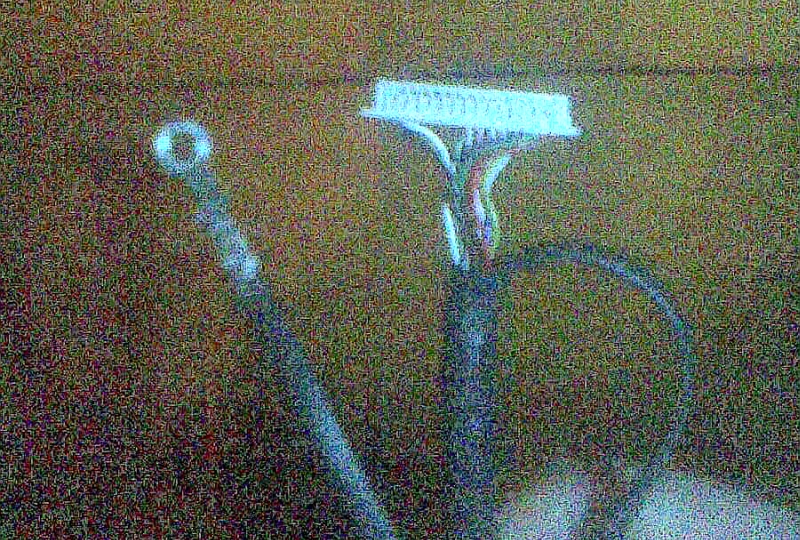

                              thats what i was afraid of..... lol luck of the draw i guess. As far as the cables go, there is a ground cable that is attached to the cable that goes to JP4 on the main board, does it matter where it gets grounded to? or just as long as it goes to ground? attached is a pic of it, sorry its crappy quality, i took it with camera phone in low light.
                              • PlainBill
                                • Feb 2009
                                • 7034
                                #55
                                Yeah, crappy picture, but in this case, more than enough detail. The ground pigtail should be attached at the ground point closest to the connector. If I had to guess, that is the LVDS cable, a good ground is essential.

                                  #56
                                  yea, it is the one that connects to the center of the main board and runs straight up to a small square board at the very top center of the tv. i had it connected to one of the mounting screws for the power supply board, cuz i forgot where it was when i first took it off......... yea i know, not paying attention. lol
