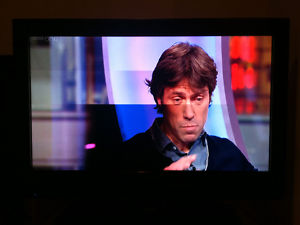

    philips 37PFL7662D screen fault
    what would cause this sort of fault

    Re: philips 37PFL7662D screen fault
    Please do more investigation and post more info detailing the problem.
    Does this happen upon powering up?
    Does this happen on all inputs?
      buffers go bye bye
        I have exactly the same issue, black banding on the screen as shown above. TV works fine for about an hour or so usually then the black bands appear, and can sometimes disappear again later.
        Question ... is it worth having the buffers replaced?
          LCDs do not have buffers. This looks like a panel failure. Tab bond failures cause this to happen on LCD TVs.
            Hi there, I have a customer of mine that has same problem that you posted, did you ever get this resolved, would be very grateful if you could post a follow up. Many thanks
              It is a tab bond defect.
                Hi.
                I have the same problem. I bought this TV on july 2007. The problem started around 1 year ago. To solve it, I have to knock on the left -in the middle and top left-. Also, when the TV has beeing switched on about 20 minutes stops to do it. I don't know how much time will resists the hits... As time passes I have to knock it harder... At first months was just a soft knock, not like know... also the black spot is getting big, sometimes almost full screen, but on the left is more black, than the right where is like with red color saturation.
                Any one found any solution?? Any one tried to repair it through Philips Official Service? How did it costs?
                  It is a tab bond problem, just like this:
                  http://www.youtube.com/watch?v=purk_SyiT44
                  (Different symptom, same cause.)
                    Hi!
                    Do you think really is a tab bond problem? That would be so cool, because the repair it seems so easy.
                    I uploaded a video with my TV problem on youtube, I recorded this video just after turning on the TV, as I said, after some minuts working, it starts to be OK:
                    http://www.youtube.com/embed/mCYpC-_7914
                      Definitely looks like a tab bond problem to me.
