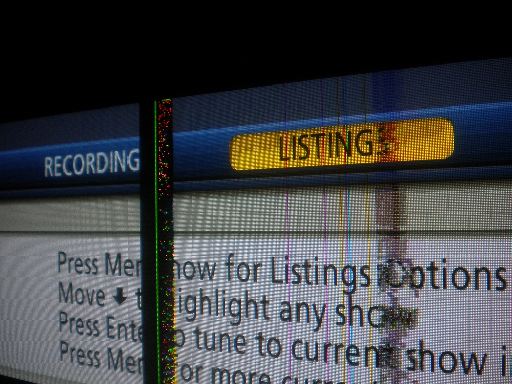

    50' LG PLASMA 50px4dr Help!!!
    hey i have a plasma tv tha has a light black bar that goes from almost center top of screen to about half way down and an colored one next to it. doesn anyone know if this is the driver board or what. i did notice that one of the ribbon cables that has the components on it gets hotter than the others where the black bar is..any help would be appreciated

    Re: 50' LG PLASMA 50px4dr Help!!!
    Bad driver on the ribbon cable. As far as I know, unrepairable.
    PlainBill
      here is a pic of whats going on and also if you hit the tv on top where the line is it disappears sometimes or changes color
        If that was a Panasonic it would be as Plainbill said.
        The Panasonics have the chip on the ribbon cable and they burn up.
        Some of the L/G plasmas have the chip on the board and can be repaired by board replacement.
        If it clears up by hitting the tv you need to look into it further.
        I don`t even take tvs with this problem unless they are free.
          ended up being the CT driver board. when bill said something about drivers it made me look into this and got my hands on another board an tried it now tv works great thanks bill an candiman for your help
