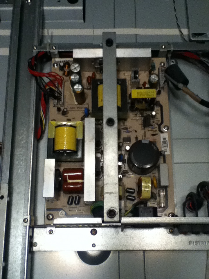

                      I have the same model with a similar, if not the same, problem. My TV essentially locks up after 5 minutes to an hour. To get it to come back on you have to unplug it. I never got the chirping sound, but I got a high whistle for about 5 minutes and it went away. This all started about two weeks ago and this morning it just stopped. I figured I would see capacitors bulging or leaking. I took it apart and I don't see any swollen capacitors. I have attached pictures. Would you suggest which capacitors I should replace just as a shot in the dark?
                      • retiredcaps
                        • Apr 2010
                        • 9271
                        #51
                        Re: PHILIPS 42PFL5432D/37 Power Supply troubles
                        Explain in detail what is "locks up" wrt to
                        a) backlight
                        b) picture
                        c) sound
                        d) power led
                        The more detail and info you give, the better our response.

                          It started about two weeks ago. The first time I noticed it the TV locked up while I was watching a show. The picture and sound were both still on, but you could not change channels or turn it off. The led light on the power button remained green and blinked when you tried to use the remote, indicating that the TV was picking up the infrared signal from the remote, but nothing changed. Eventually I had to unplug the TV to turn it off. When it was plugged back in, the TV worked correctly, until the next day. The next day the TV would not turn on. The led light on the power button remained red and would not change with the remote or pushing the button. Again, once the TV was unplugged and plugged back in it worked fine. It locked up about twice more while viewing a TV show. Once time we got a low whistling noise. The next day the same symptoms, but more frequent. Every time the TV is turned off, it will not turn back on without being unplugged and plugged in. When it is locked up, the led on the power light can either be green or red. Sometimes the picture is on and sometimes it is off, but now it won't even come on.

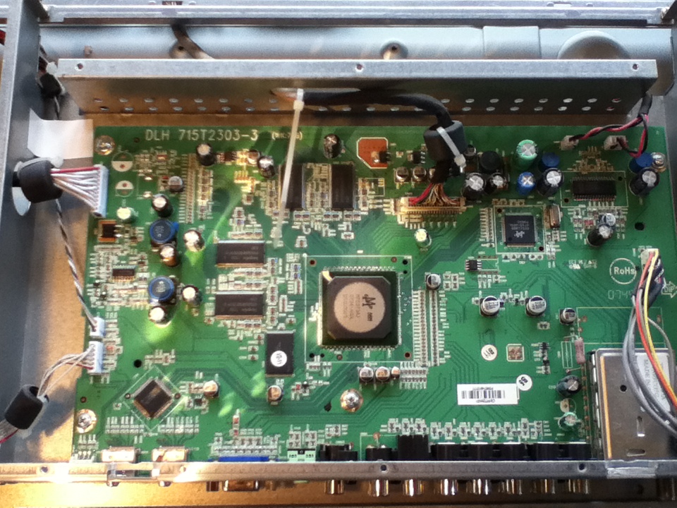

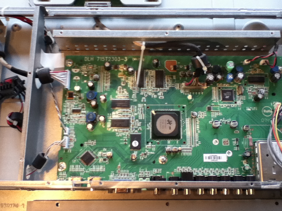

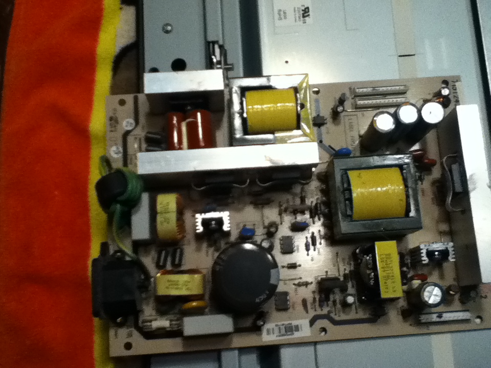

                            Also, did I post the pictures correctly and are they of the correct quality?
                              Okay, that is a much better description and helps narrow down some possibilities.
                              1) We will need a picture of the main board. The main board is the one with the hdmi, rca, component cable connectors, etc. Try to get as close to 2000x2000 as possible. Yes, you attached them correctly. Thank you.
                              2) Do you have a multimeter and are you familiar with how to measure DC voltages?

                                Here are some shots of the main board. I have a multimeter and can use it to measure DC (with a little help from the manual).

                                  1) Measure all the pins on the connector between the power and main board. Use a ground screw on the main board for your black probe.
                                  2) List all the DC voltages for all pins when the TV is working and when it is not.
                                  3) Report it like this. Excuse the poor formatting.
                                  Pin Working - Not working
                                  pin 1 - 5V - 0.0V
                                  pin 2 - 3.3V - 3.3V
