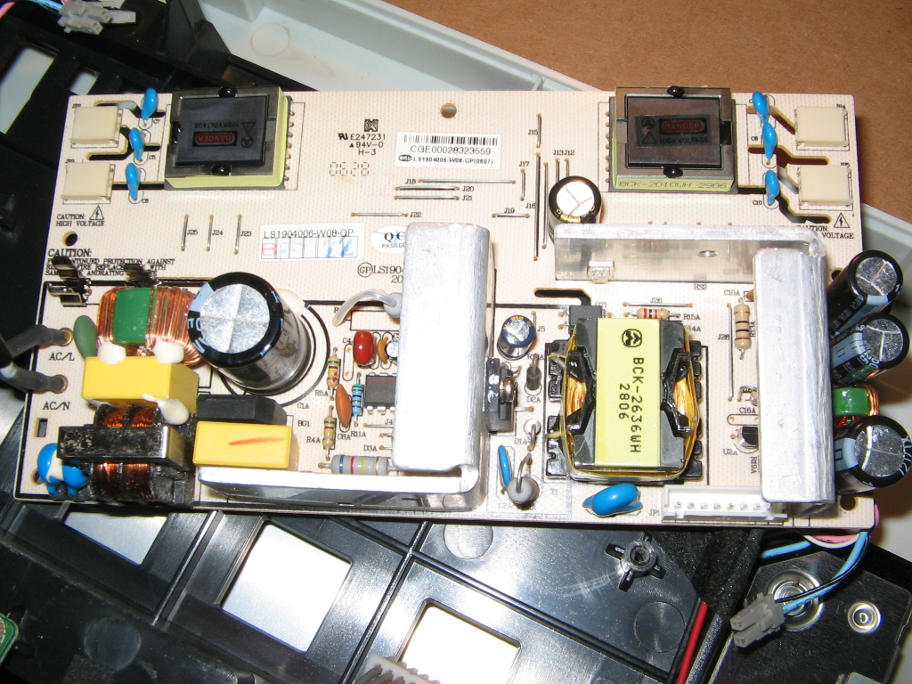

    Hi again. I saved this TV/Monitor from the landfill about 2 weeks ago. Plugged it in and nothing works so I'm gonna do the PS board re-cap cause it has the little bad green caps on it. I count 5 of the smaller ones. The biggest cap is black so I'm thinking it wil be OKey.
    I found another thread on this exact same TV and the help said for the OP to change only 3 caps. That seemed to get the OP's TV up and running but for how long before the other bad green caps go. That brings me to the main board and all the little green caps on that(30+)!!! Should I even worry about those?
    Here's some pics. THX

    Samxon GF series caps are problematic. I can't tell from your picture if they are GF series or not.
    Capacitors die from age, heat, and shoddy build quality. Capacitors DO NOT have to be visibly bloated in order to bad. They can be out of tolerance uF (a 1000uF measures 20uF) and/or have high ESR (ohm). A multimeter will be insufficient to test for ESR. For that you need an ESR tester which costs between $50 and $300.

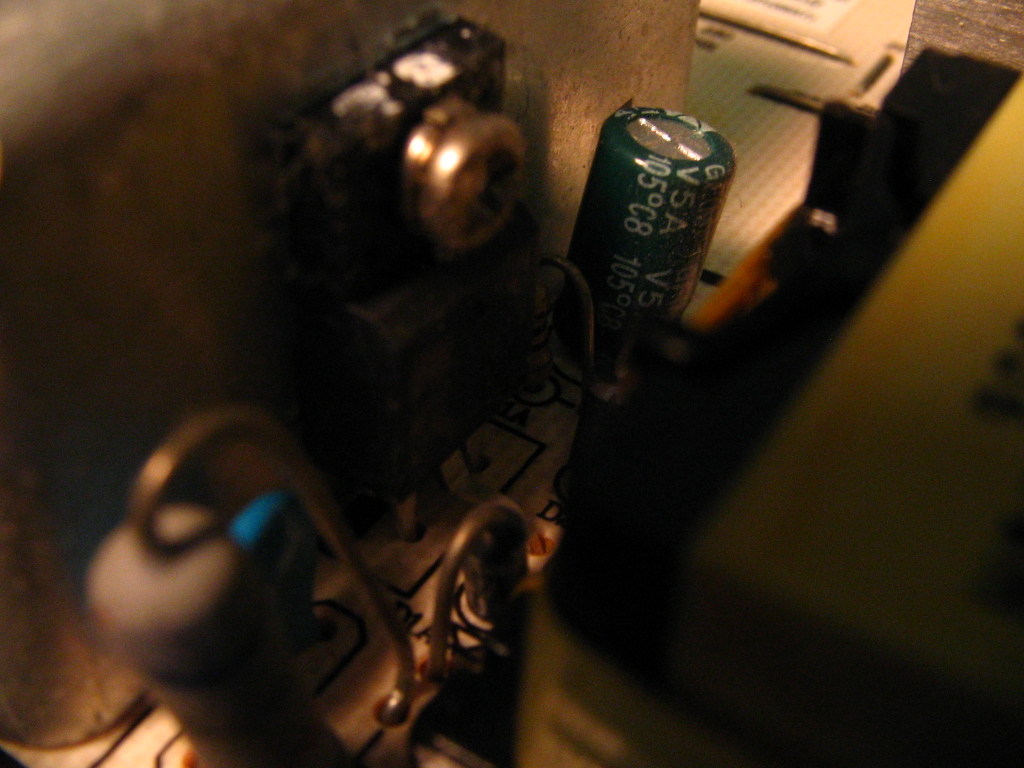

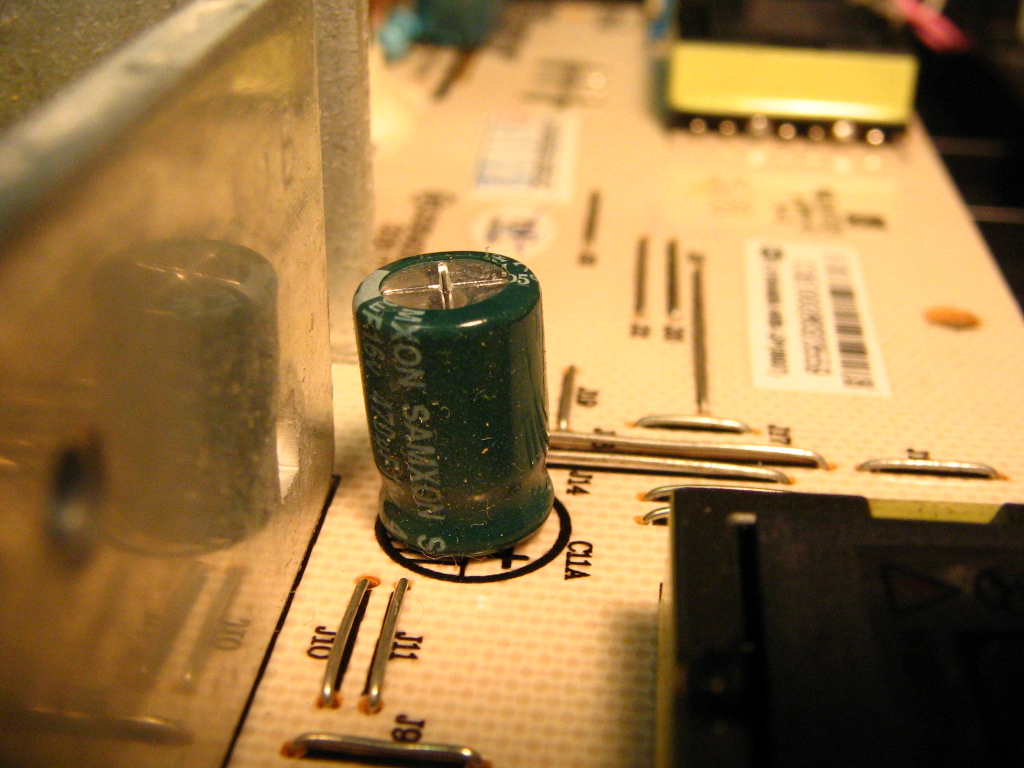

      those are in fact samxon GF.
      you can see a hint of a "F" in the second pic (corner of the sleeve), and if you play around with the gamma and contrast on the 3rd pic, you can (more or less) clearly read GF

          Re: Trutech PLV16190 picked off a trash pile
          it will say "GF" on the side where the datecode and the 105°C is

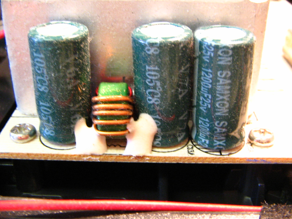

                Pulled the badcaps today. 5 total on the power board all had GF(M) on them.
                1x470uf 16v
                1x47uf 50v
                2x1200uf 25v
                1x1500uf 16v
                Don't know what solder the factory used but it was a chore to get it to flow and my iron is 40 watter.
                  add some solder to make desoldering easier.
                  the flux in the added solder helps to get going, because there is none on those boards usually (cleaned off from the factory)

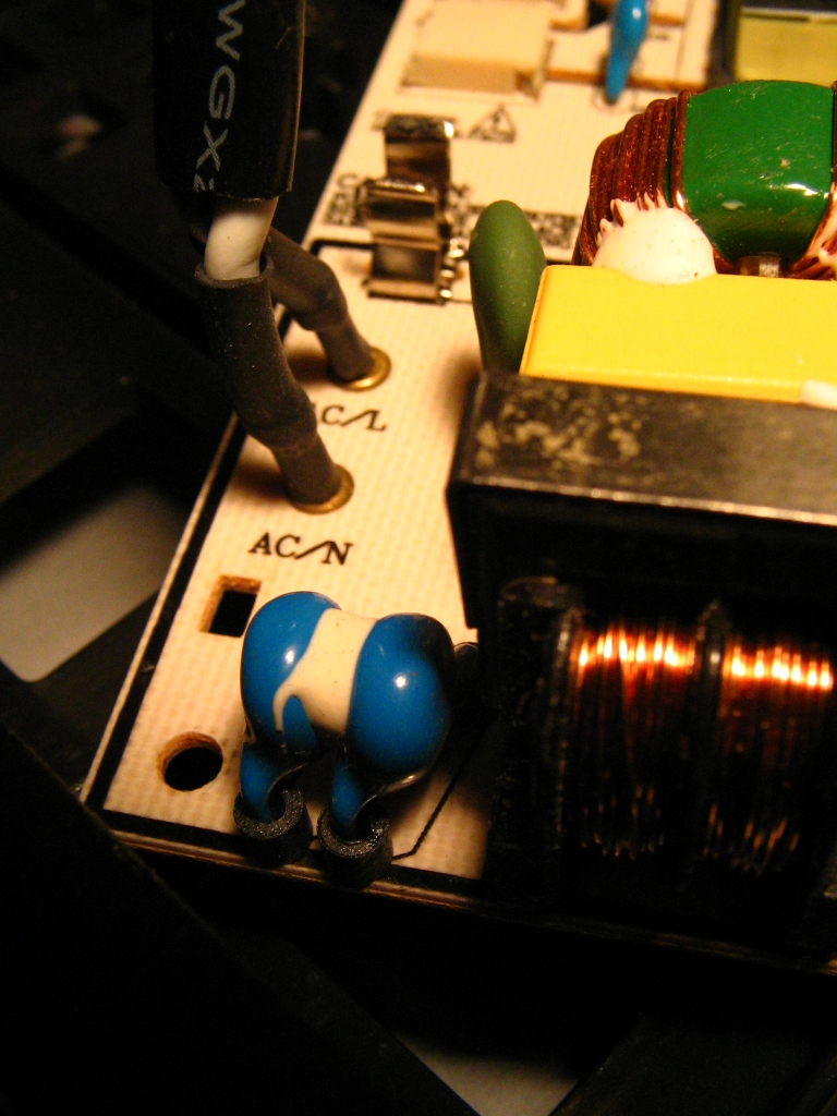

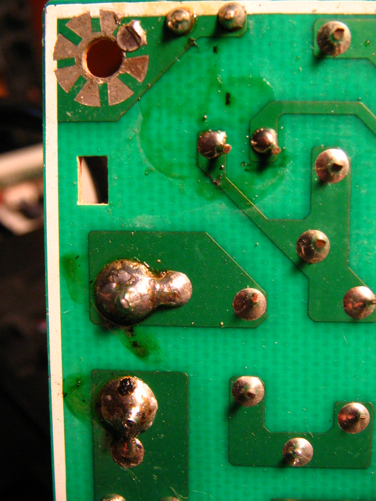

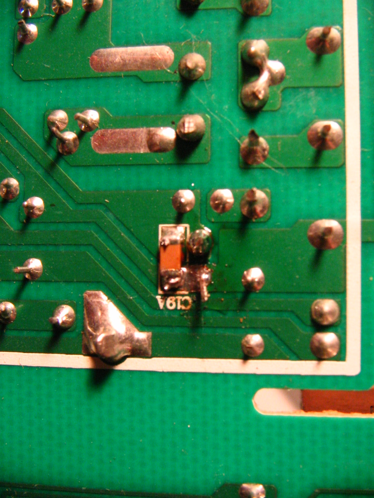

                            Got some sloblo fuses at the shack put them in and theres smoke (fail). Couldn't see where the smoke was coming from cause I had to clam shell the unit to test but I assume the new fuse is now toast.
                            I'm reaching the limit on the $$ I want to spend to fix it cause I made the mistake of ordering some caps from mouser and they really overcharge on shipping.
                            How do I test the bridge rectifier? I have a meter.
                            Some pics. One is my solder questionable work. The other two are of what I think is the rectifier.

                              • retiredcaps
                                • Apr 2010
                                • 9271
                                The bridge rectifier is usually black long rectangular with 4 pins and labeled as "BD" on the PCB. Number the pins 1,2,3, and 4.
                                If you have a manual range multimeter, put it to 200 ohms. Measure the following pin combinations in circuit. 1-2, 1-3, 1-4, 2-3, 2-4, 3-4. Any reading under 30 ohms suggests a short. To verify, desolder the rectifier and retest out of circuit.

                                    • Agent24
                                      I see dead caps
                                      • Oct 2007
                                      • 4953
                                      • New Zealand
                                      I know it has useless Samxon GF caps but going by the blown fuse they were probably still OK.
                                      I'd agree with the diagnosis of shorted rectifiers or other primary-side components.
                                      Inspect them all carefully under good light and magnifier if needed, find out where the smoke came from.
                                      Sometimes you can find out where a fault is by just carefully looking at the components...

                                      • junkmansam
                                        • Nov 2009
                                        • 51
                                        All right, back to the bench. +1234- is the order I used. R~B. I tried setting my MM to 200 ohms but couldn't get any reading. Only on the lowest setting which just has a symbol could I get a reading.
                                        1-2= .58
                                        1-3= .56
                                        1-4= .54
                                        2-3= .67
                                        2-4= .58
                                        3-4= .58
                                        Thanks for helping.
