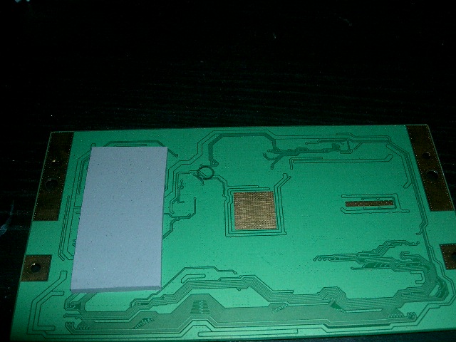

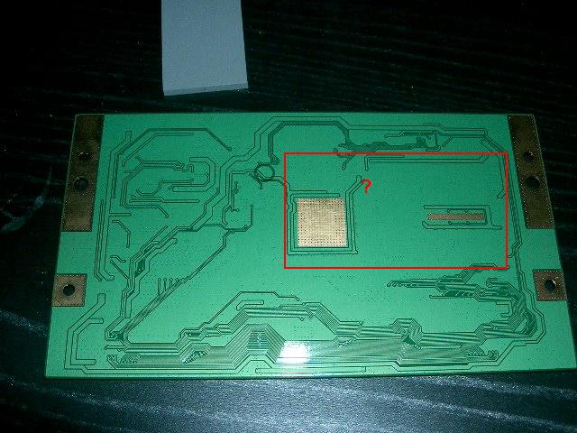

    Hey, this is my first post!
    I picked up a Sony Bravia KDL-46V4100 it has a problem where the back light and sound both work fine on all of the inputs, however there is no picture at all. The screen is completely blank on all inputs. I have searched on these forums and narrowed it down to the T-Con board. During my search I found out that my original T-Con board has no thermal pads. Can you please tell me the following:
    Are the pads supposed to be there on this model
    Where should they be located on the board
    Where can I buy thermal pads for this model
    Here are some pictures I found of thermal pads for a T-Con in another post to give you a reference.
  • rayrod81
    • Oct 2010
    • 205
    Re: Sony Bravia KDL-46V4100
    Not sure if they are supposed to be there but it wouldn't hurt to put one on to keep the processor cool. That being said I couldn't say where to buy them.
