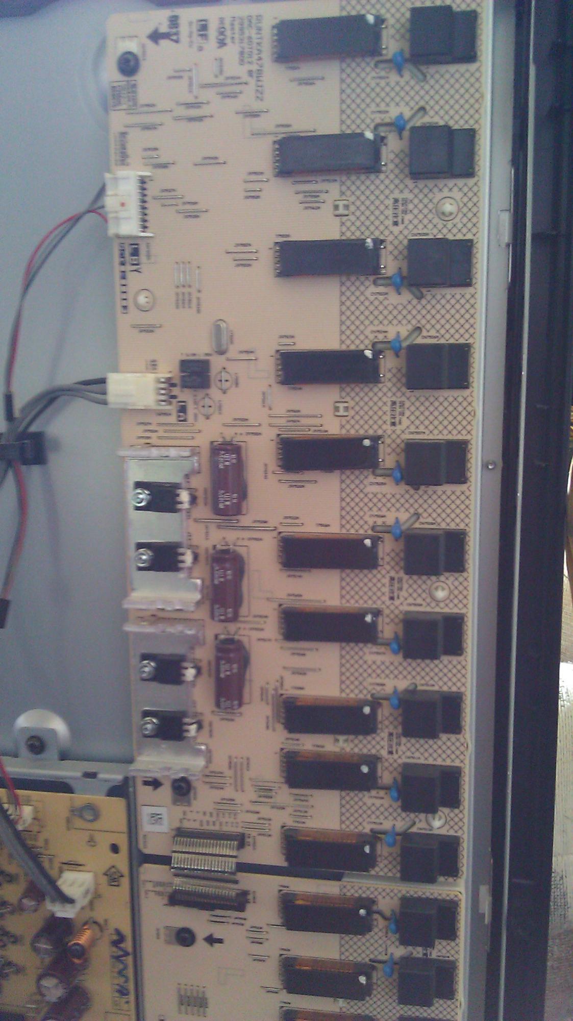

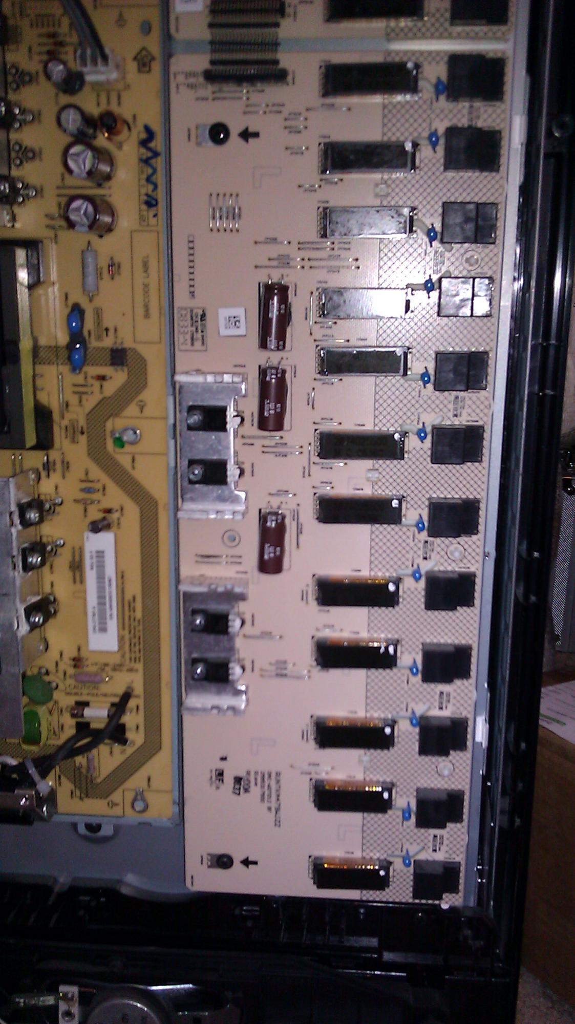

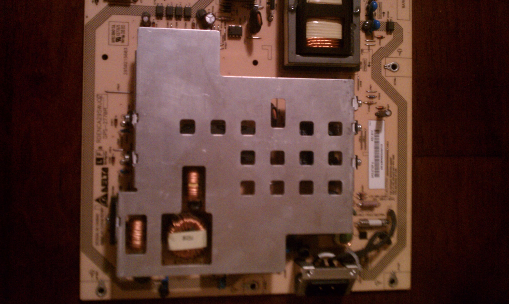

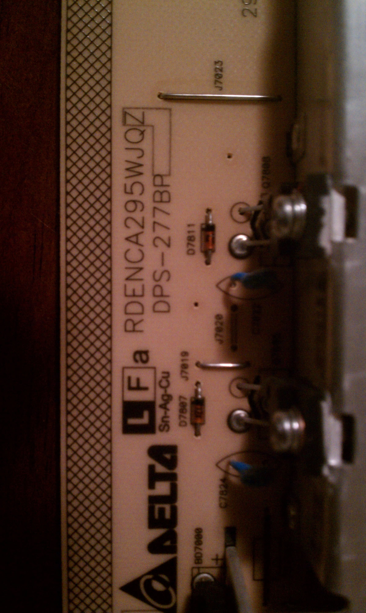

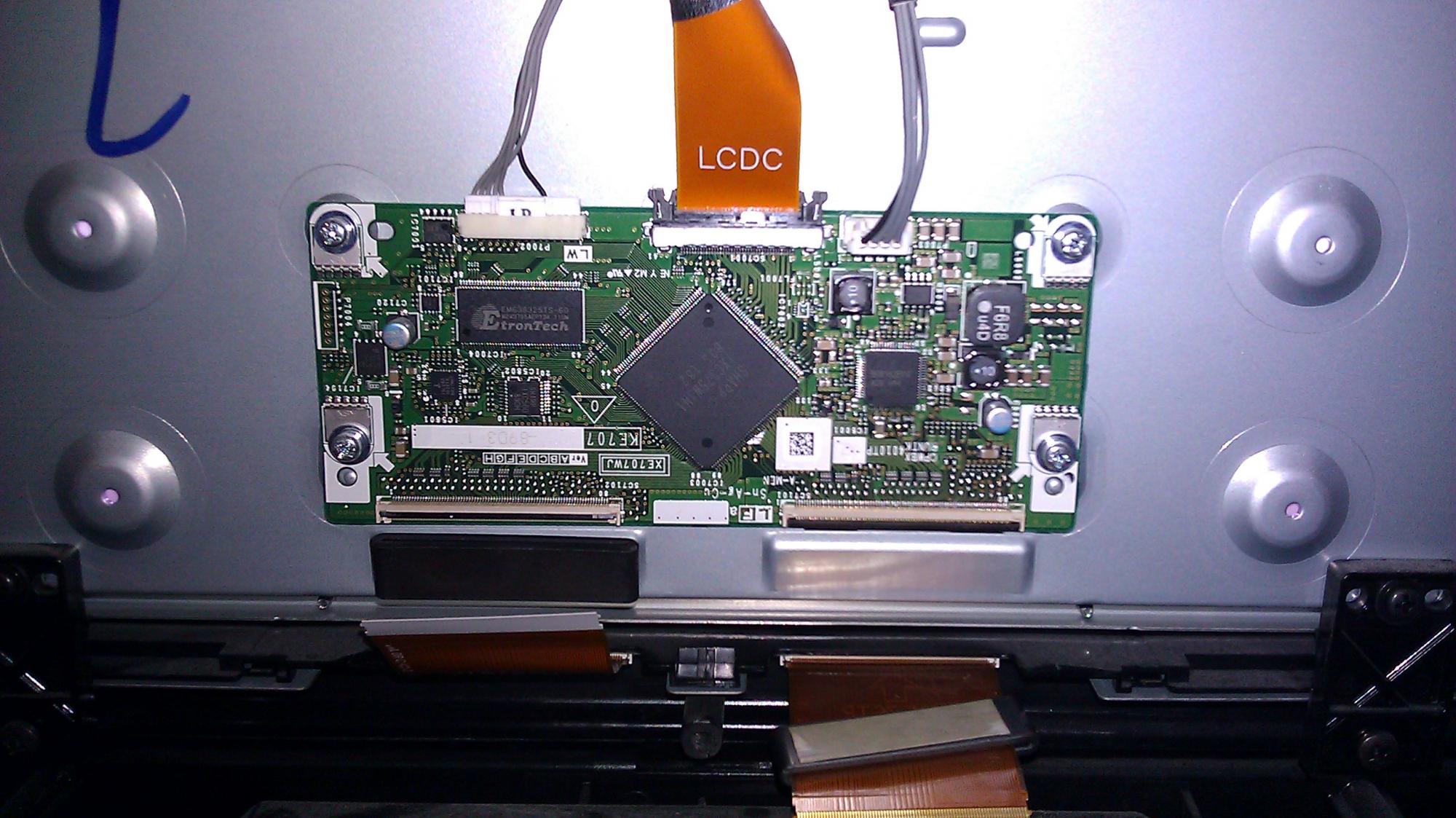

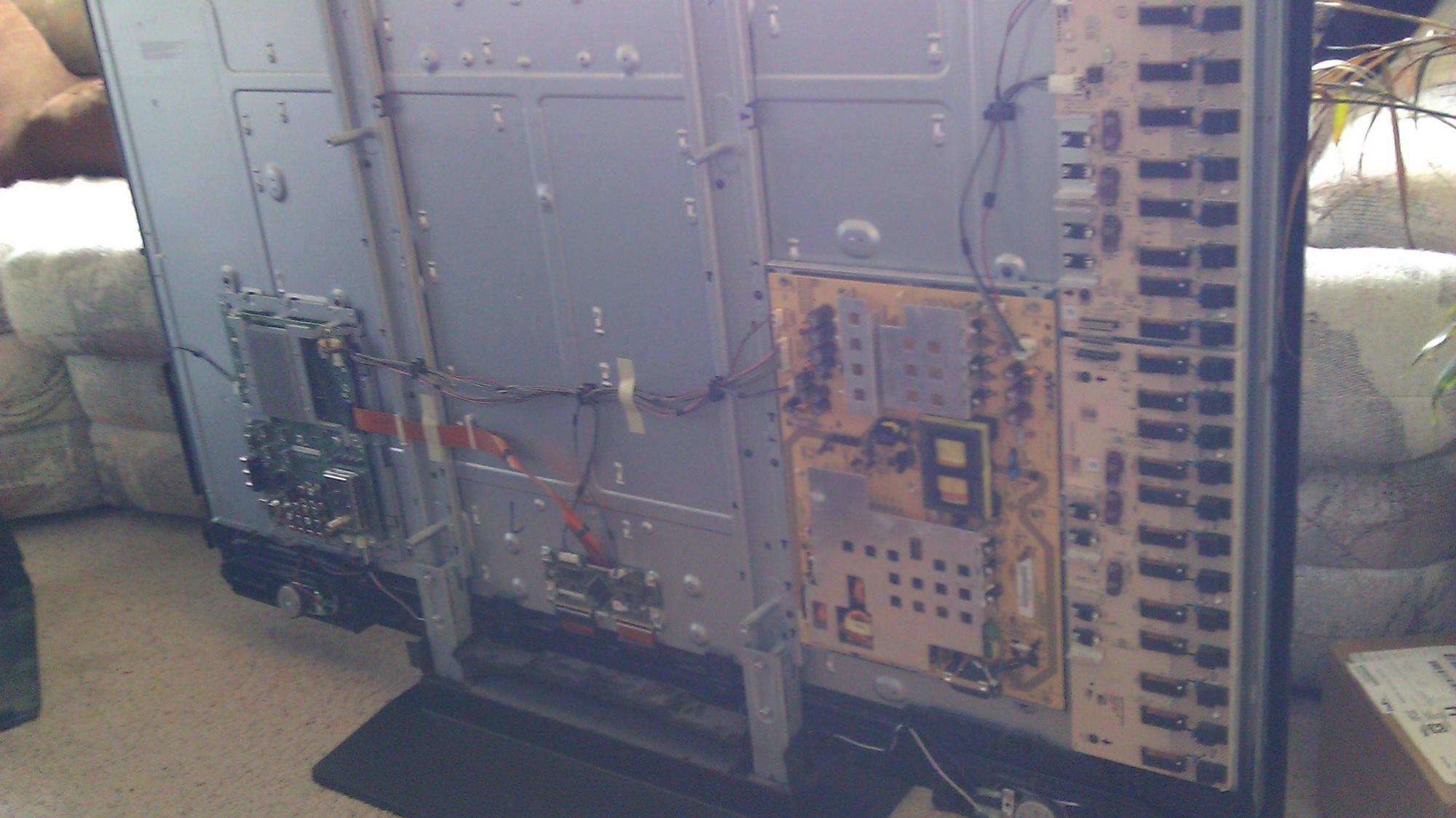

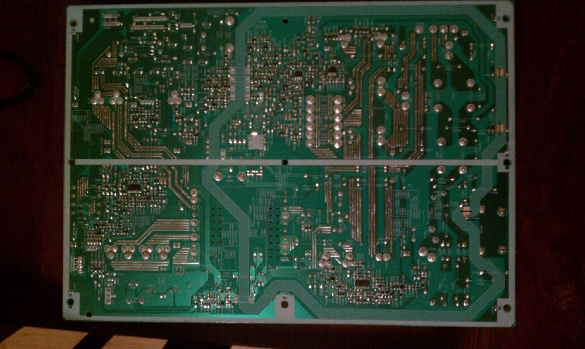

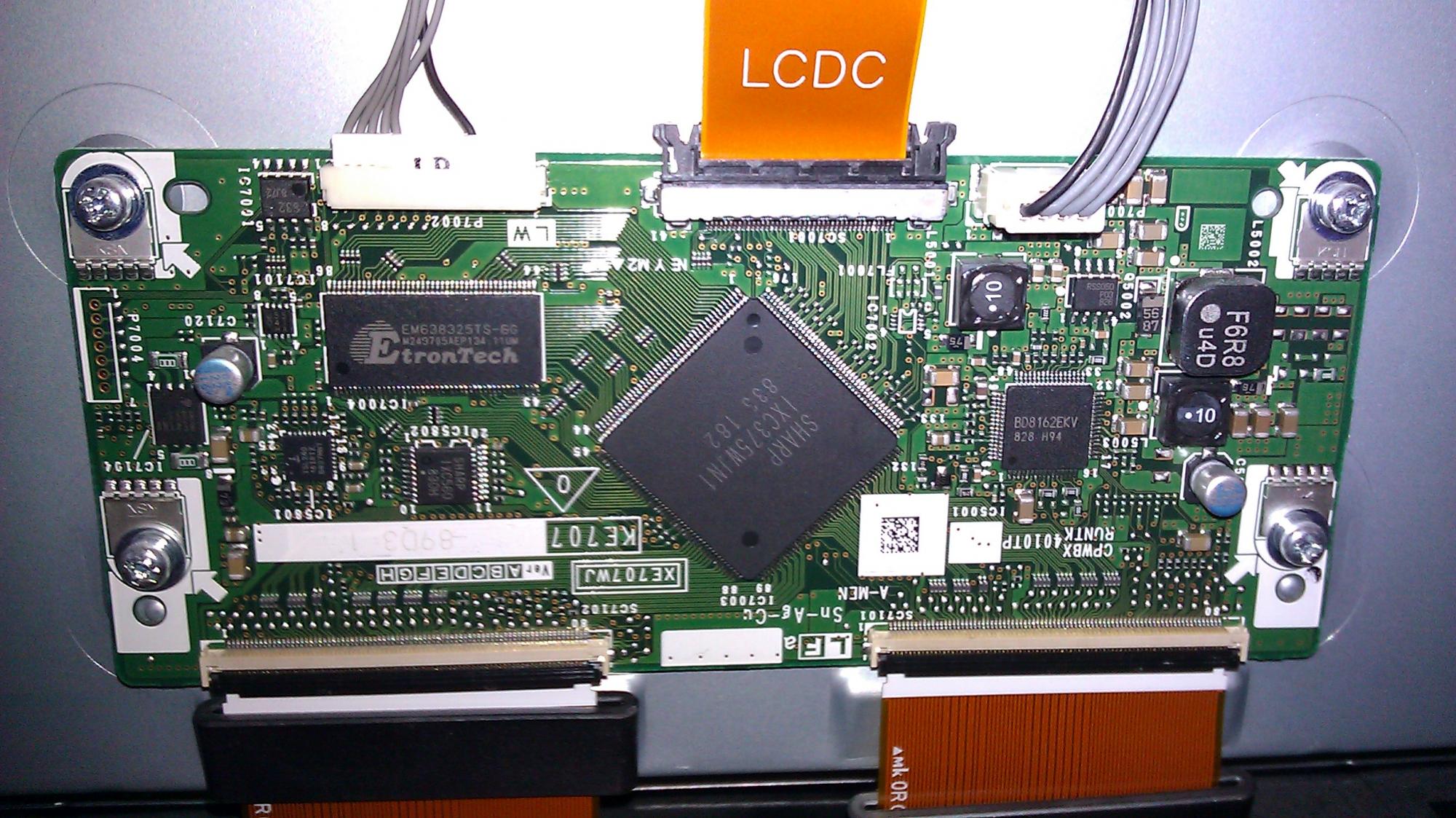

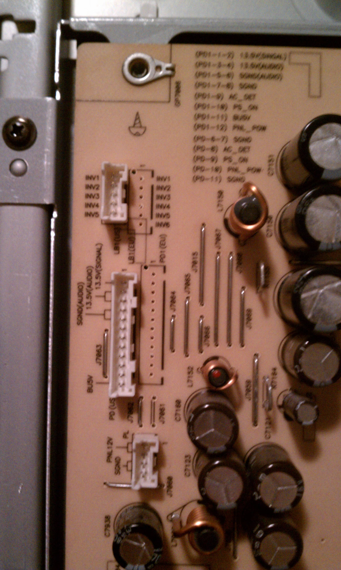

Sharp LC-52SB55U Power Opc Blinking
+ More Options
Latest Activity
  • MazdaSpeed6
    replied
    Re: Sharp LC-52SB55U Power Opc Blinking
    Test for shorted transistors. (Hint: Pictures help.)
    PlainBill
    PS. You are far from the first to do this, but if there is a God, there is a special circle in Hell reserved for those who ask such questions without providing pictures.
    PB
    Ha ha. Love it!
    Sorry I posted that with my phone late last night. I a have some pics they aren't great cause I took them running out the door.
    Thanks for the help. Sorry for no pics I will wait to post next time!
    The first image shows the ribbons disconnected.
    Leave a comment:
  • PlainBill
    replied
    Re: Sharp LC-52SB55U Power Opc Blinking
    Originally posted by MazdaSpeed6
    So I ordered the new PSU same issue held the channel down and input. Just the back light came on. I unplugged the power plugged it in and had the same issue. The buttons didn't work again.
    I then disconnected the ribbons from what I think is the inverter board it powers on fine no errors. What can I test or should I replace the inverter board?
    Test for shorted transistors. (Hint: Pictures help.)
    PlainBill
    PS. You are far from the first to do this, but if there is a God, there is a special circle in Hell reserved for those who ask such questions without providing pictures.
    PB
    Last edited by PlainBill; 03-22-2011, 07:19 AM.
    Leave a comment:
  • MazdaSpeed6
    replied
    Re: Sharp LC-52SB55U Power Opc Blinking
    So I ordered the new PSU same issue held the channel down and input. Just the back light came on. I unplugged the power plugged it in and had the same issue. The buttons didn't work again.
    I then disconnected the ribbons from what I think is the inverter board it powers on fine no errors. What can I test or should I replace the inverter board?
    Leave a comment:
  • mbates14
    replied
    Re: Sharp LC-52SB55U Power Opc Blinking
    Hold the Channel Down, Input buttons at the same time while plugging the TV in.
    the TV will power up into a diagnostic service mode. chances are, you wil see NO backlight.
    You must replace the blown fuse, and the 4 bad switch-fets on the inverter board if this is the case.
    Leave a comment:
  • MazdaSpeed6
    replied
    Re: Sharp LC-52SB55U Power Opc Blinking
    Quite a few indeed! i put an offer on a power supply we'll see what happens with that. I may just order one and hope for the best. If there is some more in site or experience with this TV that would be great.
    Thanks for all the help rayrod. I will look at what you suggested as best I can.
    Leave a comment:
  • rayrod81
    replied
    Re: Sharp LC-52SB55U Power Opc Blinking
    It is hard to say without having the board in hand. I would start by checking the voltage regulators attached to the heat sink near the connectors. Then you would want to check any diodes and transistors on the 12V circuit (there look to be quite a few SMDs on the back of the power supply).
    Leave a comment:
  • MazdaSpeed6
    replied
    Re: Sharp LC-52SB55U Power Opc Blinking
    Not really. I can get all the boards on ebay for like $250 or just the power supply for around $60. The person I got it from said it stopped working while they were out of town and there may have been a power outage/lighting.
    I would really like to fix it without replacing boards if possible. Any ides on what to look at or test mosfets or something?
    The caps look fine but I could take them out and test them or replace them if needed they aren't to expensive.
    Thanks for the help!
    Leave a comment:
  • rayrod81
    replied
    Re: Sharp LC-52SB55U Power Opc Blinking
    At that point I would suspect the power supply. Have you found any shorted or otherwise questionable components on the power supply?
    Leave a comment:
  • MazdaSpeed6
    replied
    Re: Sharp LC-52SB55U Power Opc Blinking
    I measured it with the cable disconnected and right after power up before protect mode. It is 0 off and 0 in protect.
    Leave a comment:
  • rayrod81
    replied
    Re: Sharp LC-52SB55U Power Opc Blinking
    A couple questions. First, did you measure the voltage with tv on or right at power up? Second, was the cable for the panel 12v disconnected or not? The reason I ask is that if the problem is with the LCD Controller you will have to disconnect that to get the voltage to come up. Otherwise the voltage will be close to 0 volts like you measured. You will not be able to get a good reading for the voltage when the TV is off or after it is in protect. That means you will have to measure voltage right as you hit the power button and before it shuts down in protect mode.
    Last edited by rayrod81; 03-15-2011, 09:55 AM.
    Leave a comment:
  • MazdaSpeed6
    replied
    Re: Sharp LC-52SB55U Power Opc Blinking
    Anyone....?
    Leave a comment:
  • MazdaSpeed6
    replied
    Re: Sharp LC-52SB55U Power Opc Blinking
    Here are some pics of the plus on the PSU. I am guessing caps could cause the no power what else should I look at?
    Leave a comment:
  • MazdaSpeed6
    replied
    Re: Sharp LC-52SB55U Power Opc Blinking
    Originally posted by rayrod81
    I should have read it better before I replied. It is the 12V detect that is bad. I had a 42" with the same problem. It was a bad LCD Control Card. To test if that is the problem unplug the three cables from the LCD Controller and turn it on. If it is like the model I had it should turn on without going into protect. There will be no image on the screen but the backlights should turn on.
    I will try that tonight.
    I tested the voltage in the PNL 12v and it is like .4 or so....?
    Leave a comment:
  • rayrod81
    replied
    Re: Sharp LC-52SB55U Power Opc Blinking
    I should have read it better before I replied. It is the 12V detect that is bad. I had a 42" with the same problem. It was a bad LCD Control Card. To test if that is the problem unplug the three cables from the LCD Controller and turn it on. If it is like the model I had it should turn on without going into protect. There will be no image on the screen but the backlights should turn on.
    Leave a comment:
  • MazdaSpeed6
    replied
    Re: Sharp LC-52SB55U Power Opc Blinking
    Sorry to keep posting. I was looking through the service manual again and it has an option for the power blinking twice and the opc blink 1-8 times the opc flashes a total of 5 so is the error power blinks twice and opc blinks 5 times? or is it power blinks twice opc blinks 3 times?
    If it is 5 times the error is
    PNL_12V failure
    Flashes 5 times
    DET_PNL_12V (pin 35) failure (L). Panel power is not applied.
    If error is detected during operation, error standby is activated
    by polling.
    Leave a comment:
  • MazdaSpeed6
    replied
    Re: Sharp LC-52SB55U Power Opc Blinking
    Alright I'll try to test tonight. I will also put up better pics of the connectors.
    Leave a comment:
  • retiredcaps
    replied
    Re: Sharp LC-52SB55U Power Opc Blinking
    If you have a multimeter, measure and report some of the voltages at the connectors. Your photos are blurry and we can't make out the legend at the connectors.
    Leave a comment:
  • rayrod81
    replied
    Re: Sharp LC-52SB55U Power Opc Blinking
    After looking through the service manual I would say it is either the main board or power supply. The 5V detect is handled on the main board. Either there is no 5V coming off the power supply or there is a bad component on the main board that is overloading the 5V and causing the tv to go into protect. If there are no shorted or otherwise bad components on the power supply then it is a bad main board. I suspect a bad main board rather than a bad power supply due to the fact that the main board seemed to be a problem in some Sharp TVs.
    Leave a comment:
  • MazdaSpeed6
    replied
    Re: Sharp LC-52SB55U Power Opc Blinking
    I just found a Service manual and this is my error. Any ideas what I could look at for the no power for 5V? I will look more indepth on the board and try to find pin 33.
    Pics of power board posted here.
    Power failure details (Power LED flashes twice and OPC LED flashes)
    DET_5V failure
    Flashes 3 times
    DET_5V (pin 33) failure (L). 5V is not applied.
    If error is detected during operation, error standby is activated
    by polling.
    Leave a comment:
  • retiredcaps
    replied
    Re: Sharp LC-52SB55U Power Opc Blinking
    Originally posted by MazdaSpeed6
    For some reason I can't edit now.
    The time limit to edit old threads is 30 minutes after it has been posted.
    Just attach the pics in this thread (please do not post inline).
    Leave a comment:
  • PantherDave
    by PantherDave
    Hi all!
    I'm trying to troubleshoot a Microsoft Surface Pro (5th gen) model 1796 that won't power on. Motherboard model is M1007506-015. My priority is retrieving data, but the SSD is integrated so it looks like if I can't repair it it'll need to go to a data recovery company. I've done a little basic board repair before, but nothing this advanced until now. So please forgive my ignorance in advance. πŸ˜…
    05-29-2024, 02:01 PM
  • GLISIT
    by GLISIT
    01-16-2025, 02:29 PM
    by sam_sam_sam
    03-31-2024, 02:12 PM
  • ronaldo17
    Power button blinking, Laptop Hp pavilion gaming 15-ak DAX1PDMB8E0 rev E
    by ronaldo17
    When I press the power button, nothing happens. All I can see is the power button blinking and never stopping.
    Here’s everything I’ve tried:
    -Removed the battery
    -Changed the power adapter
    -Replaced the CMOS battery
    -Changed the RAM.
    But my laptop is still blinking. However, in the morning after I wake up, the laptop will turn on.
    Here is my spec:
    -i5 6300hq
    -Gtx 950m
    -Hp pavilion gaming 15-ak030tx Laptop DAX1PDMB8E0 Rev E
    Now, I'm trying to fix the motherboard using the schematic I found
    If anyone can help...
    08-25-2025, 09:02 PM
