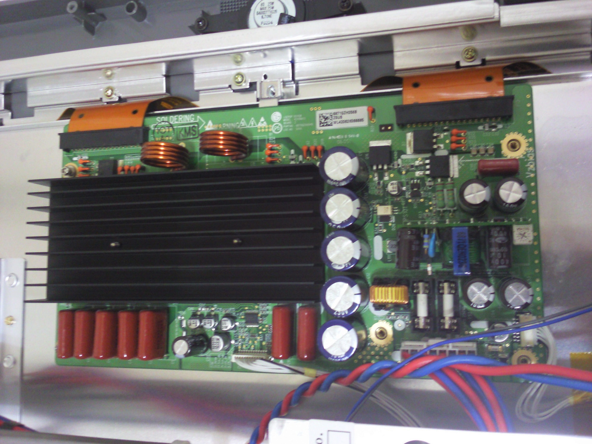

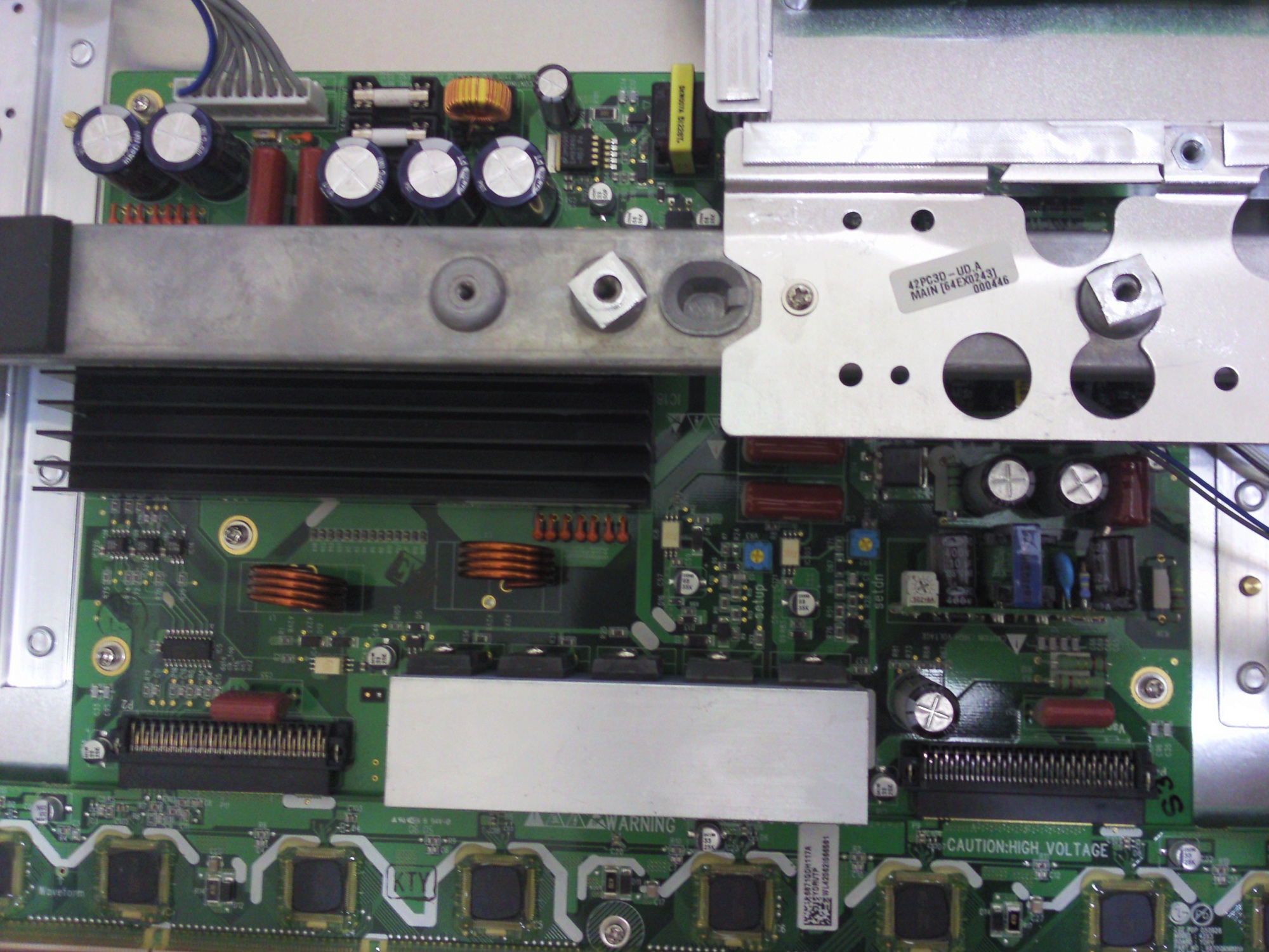

    My LG 42PC3D plasma TV suddenly stops working. It would turn on but I would get no picture. I tried shinning a bright LED flashlight on the screen but I still didn't see any color. So I did a little research and found that this is probably caused by the YSUS or ZSUS board. So I ran several testes according the information I found.
    1) I removed the power cable to either YSUS or the ZSUS board. The TV will still turn on with sound.
    2) I took off the back panel and tested the 4 fuses with a DMM. I found that one of the fuses on the YSUS board was not working.
    3) I also felt the temperature of both heat sink after about 10-20 min of use and the ZSUS was cold while the YSUS was moderately warm.
    4) I went to my local hardware store and bought a replacement fuse for the YSUS board. When I plugged in the new fuse, the TV will shut off on the own after I turn it on. If I removed the power to the YSUS board the TV will turn on and stay on.
    None of my symptoms matched either board exactly so now I'm totally confused on which IPM on which board is bad. Is it possible to have a short on my YSUS board and a bad IPM on my XSUS board at the same time?
    P.S. I checked the fuses by setting the DMM on 200 ohms and got about .3 .4 except the one on the YSUS where I didn't get anything. I also uploaded a couple pictures of my boards in case you anyone need to look at them. I'll greatly appreciate anyone who can help me fix my TV.

    The symptoms certainly indicate you have a bad Y-sustain. There have been a few reports of simultaneous failures but this is rare. The hybrid is likely bad; although the 15V supply has been considered a cause of this failure.

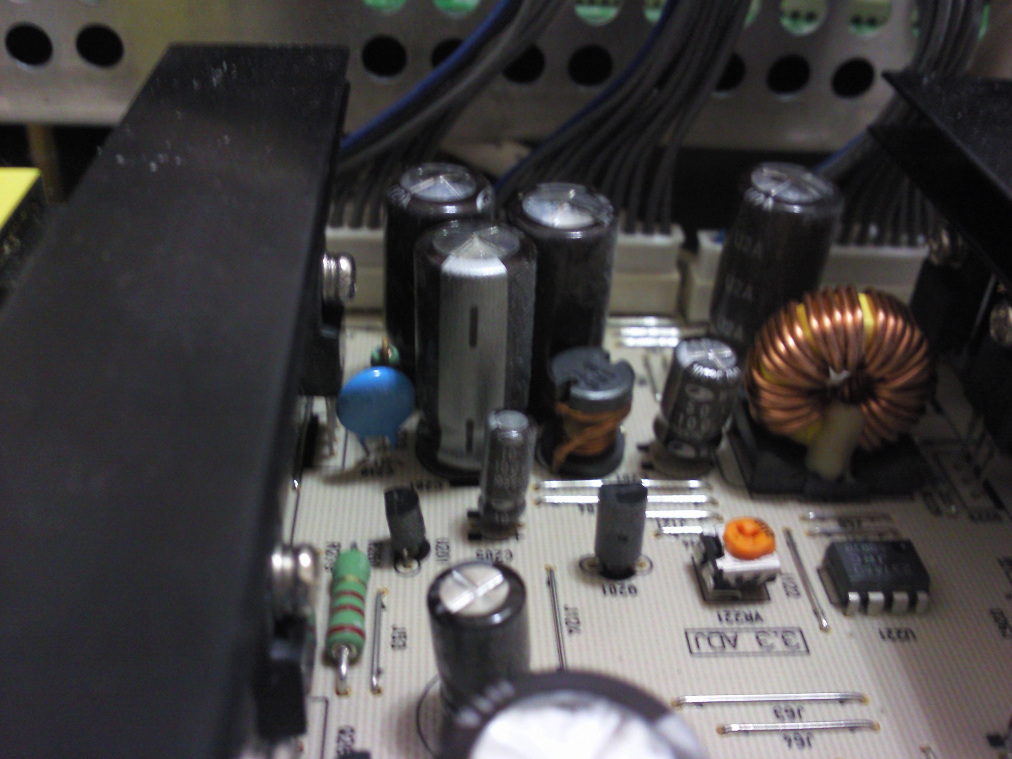

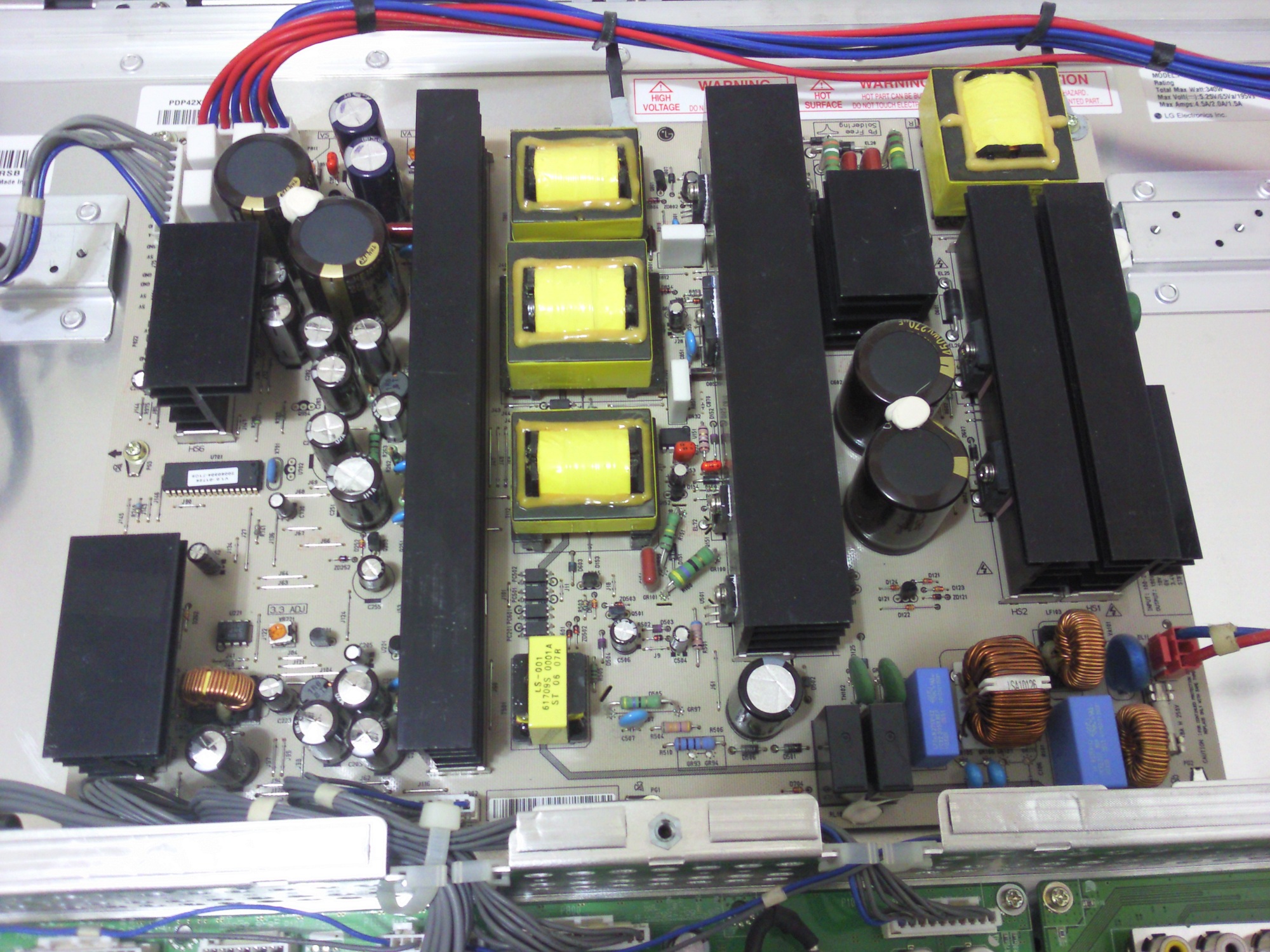

          Is it the lighting or my imagination, but there are 4 caps on the power board that look bloated to me?

            After reading that post above, I really want to check the 15v supply on my set too. But unlike him I don't have years of experience, only a broken TV and a willingness to learn. Can you tell me where and how to check it with my multi meter.
              Are you talking about the 4 big ones or the 4 smaller ones in the lower left corner? Because the 4 smaller ones doesn't look swollen in real life. Maybe it is the lighting.
              • retiredcaps
                • Apr 2010
                • 9271
                Re: LG 42PC3D-UD No picture just sound
                Sorry, I thought I wrote lower left, but apparently not.
                Well it must be the angle and lighting then.

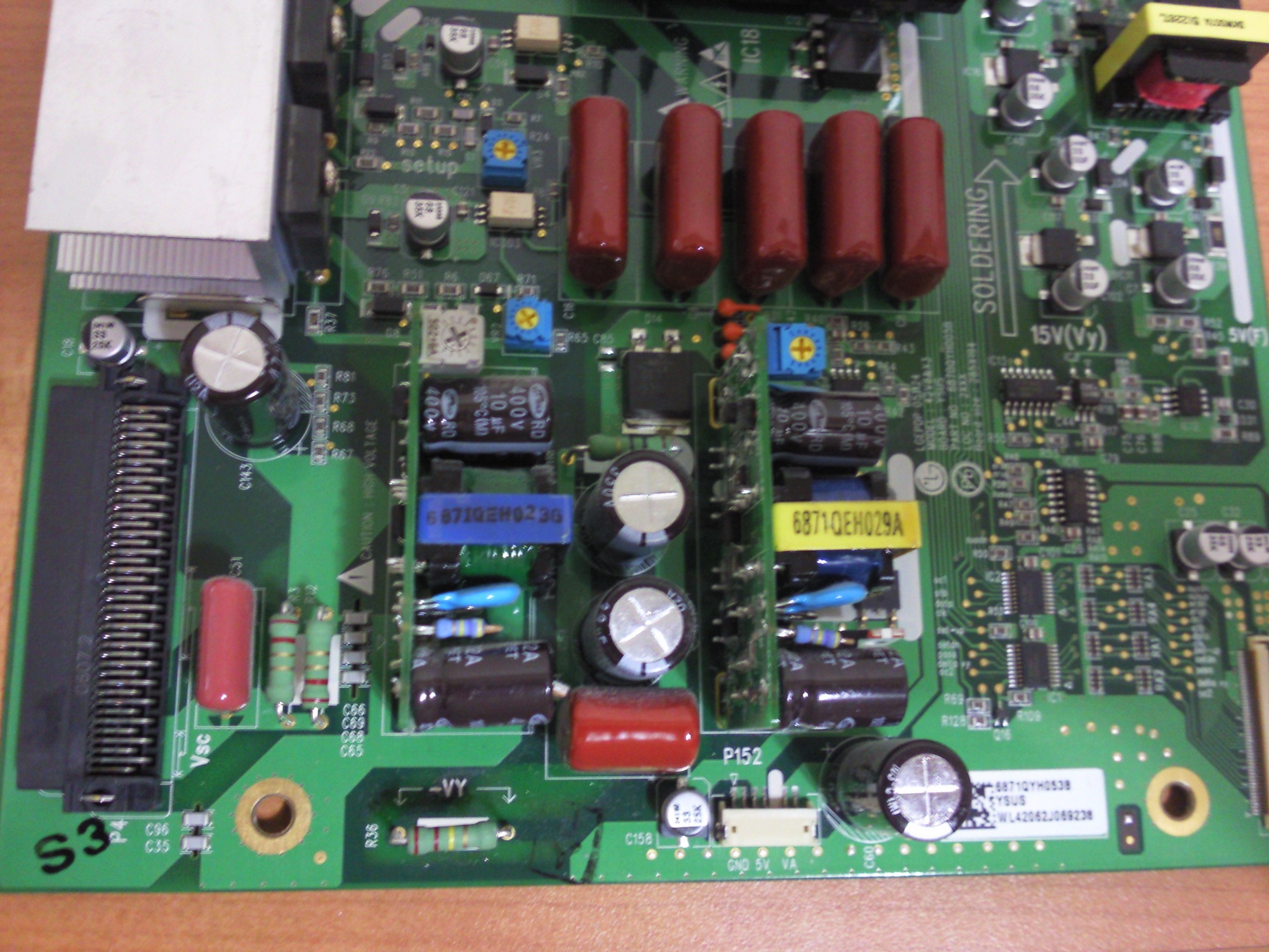

                    Here's a picture of the bottom of the board. And after a second look at the supply board those 4 cap does look a little swollen from the side. I checked the fuse on that board and its fine. Should I go ahead and replace those too.
                    • Scenic
                      o.O
                      • Sep 2007
                      • 2642
                      those caps are definitely bad. there's also a hint of dried up electrolyte on them..
                      this is why i hate Samwha

                            I found the same bad caps. Where do I get the replacements?
                            • davevolt
                              • Aug 2014
                              • 4
                              • canada
                              I have the same set. All 9 of the 3300uF 10V caps in the power supply were leaking / high ESR. All replaced, fuse on y sus blown. Swapped for another ysus, but of unknown quality as it came froma set with a blown hybrid IC on the Z Sus. Hear a ticking sound on the Y sus board. The Z sus has the familiar 60hz buzz. Picture flickers with this ticking. Any ideas? Bad Y sus I suspect.
