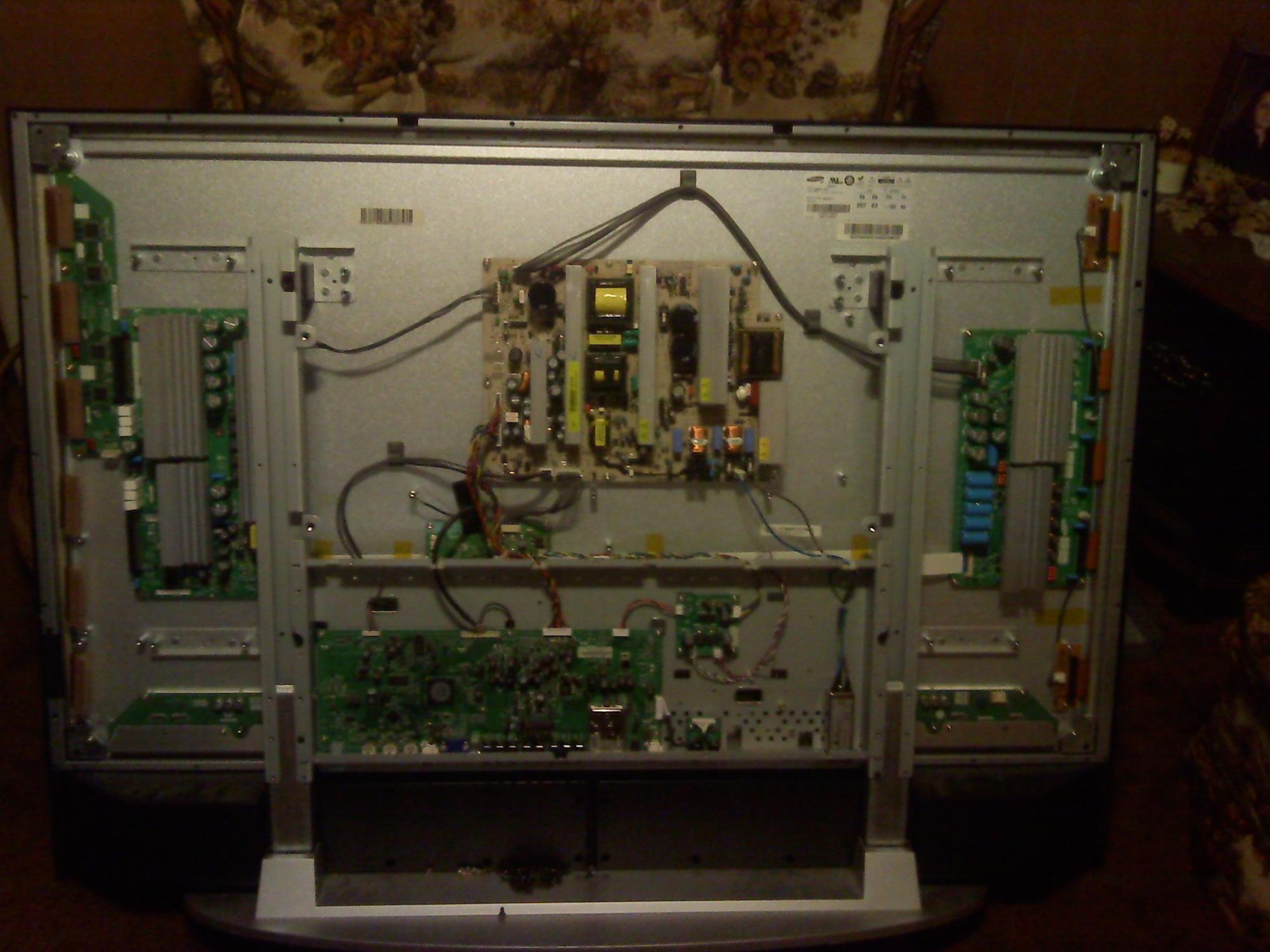

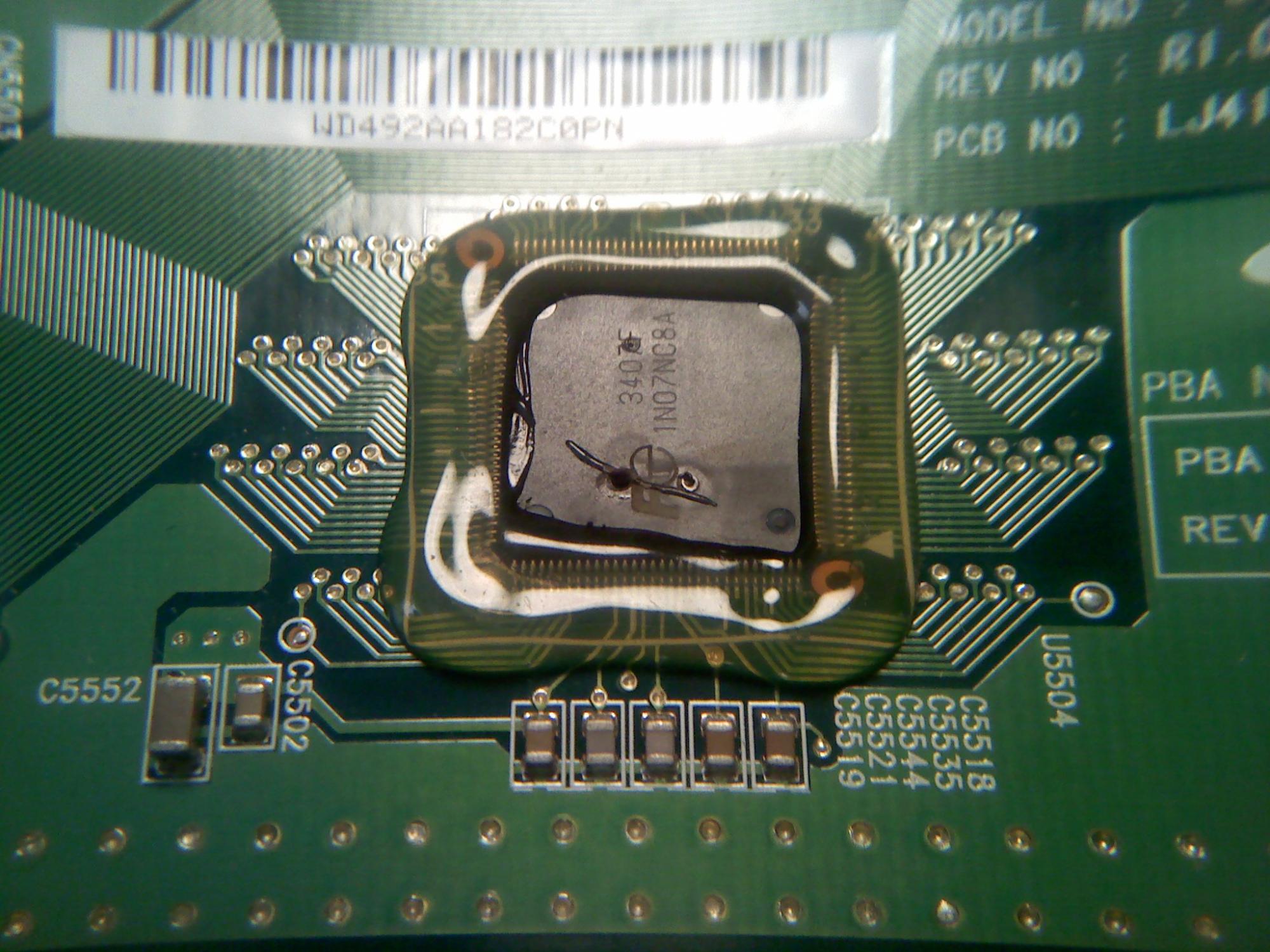

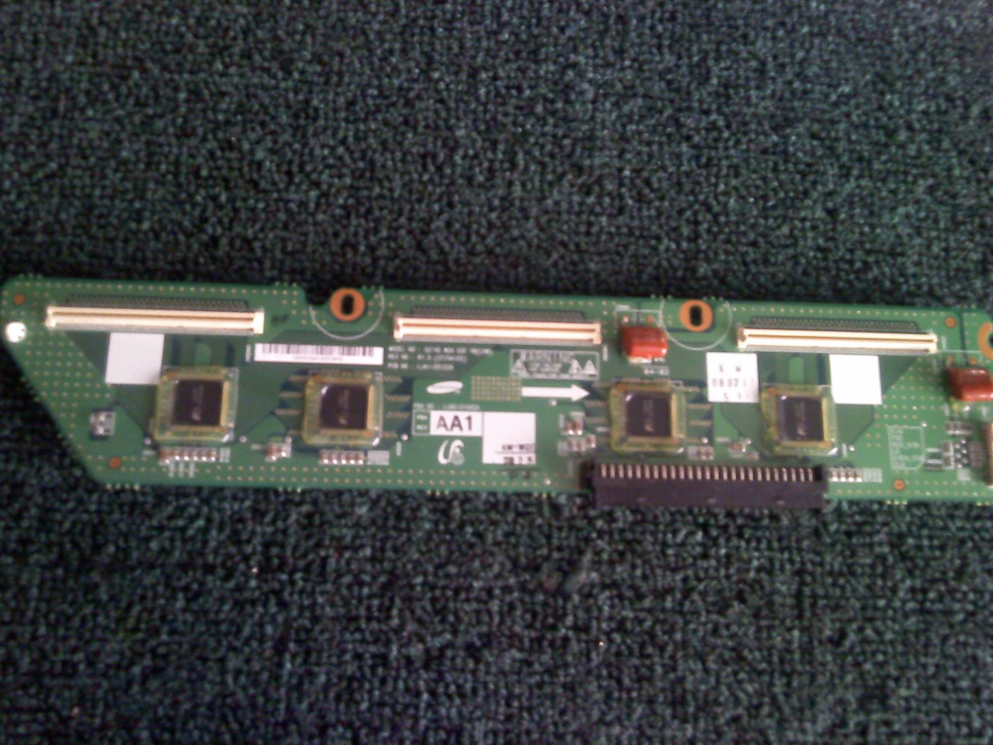

    My fine (tongue in cheek) vizio/samsung vp50hdtv20a blew a (y sus) buffer today.
    It was hit by lightning in may of 2010, came in threw the antenna connection out the ac line. I repaired it with a power supply module and main signal module from ebay. The set was built in 2008, Should I change both upper and lower buffer boards? I am very temped to fire it up with OUT the lower buffer board in to check out the panel mains. All the fuses are good including the pico's
    The set was on when I left the room when I came back there was a smell of burnt semiconductor in the air, Most of us here know the smell all too well.
    I haven't applied power since the set shut its self down when the buffer failed.
    Didn't want to cause more damage. thoughts, comments

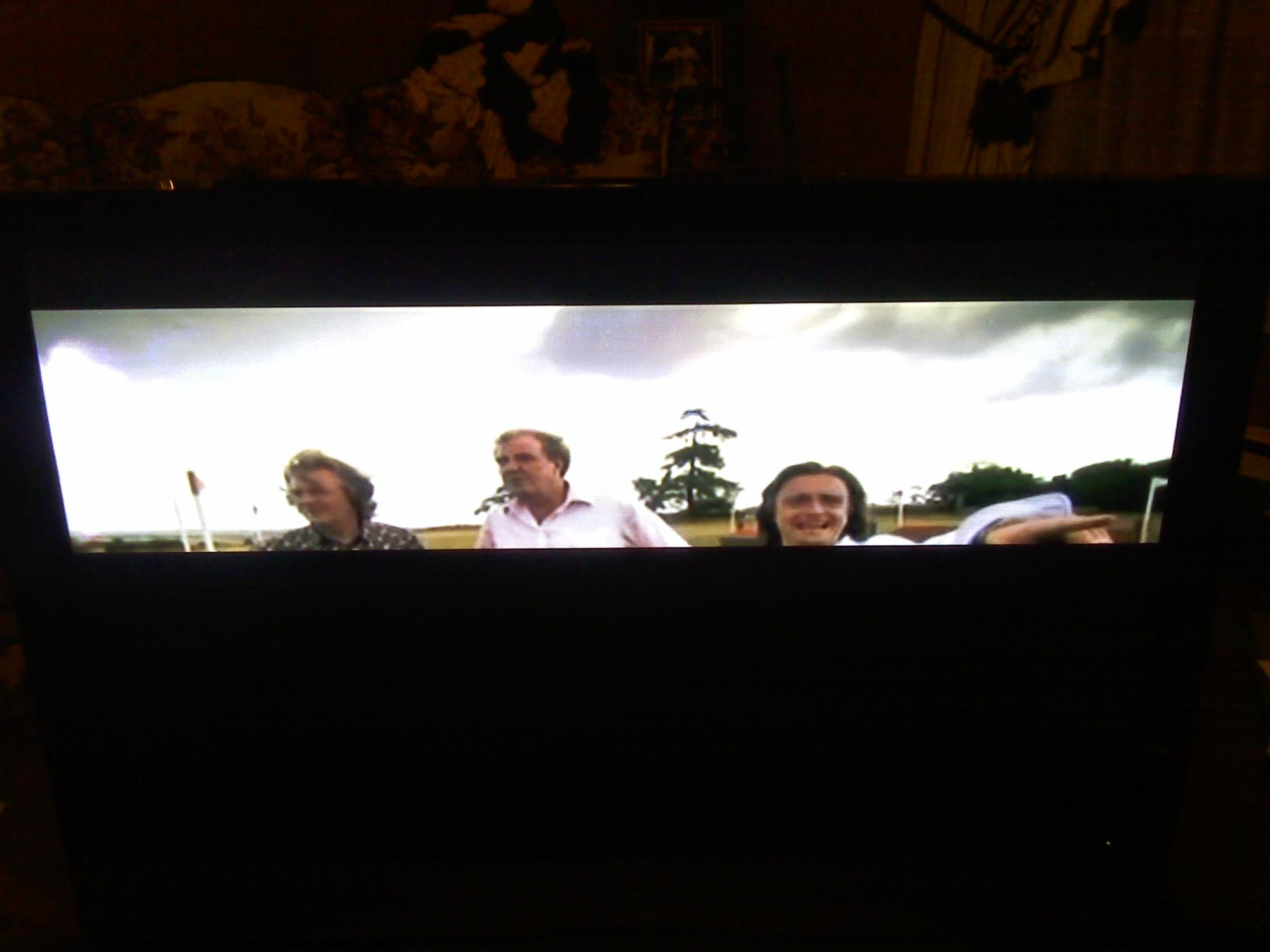

          I have removed upper buffer boards and turned tvs back on and just had half a panel work then I would know the y drive was ok. The tv wouldn`t go into protect mode once I removed the bad buffer board. This may not work on all models. It has worked for me.
          A bad buffer can take out a y drive which can also take out the power supply.

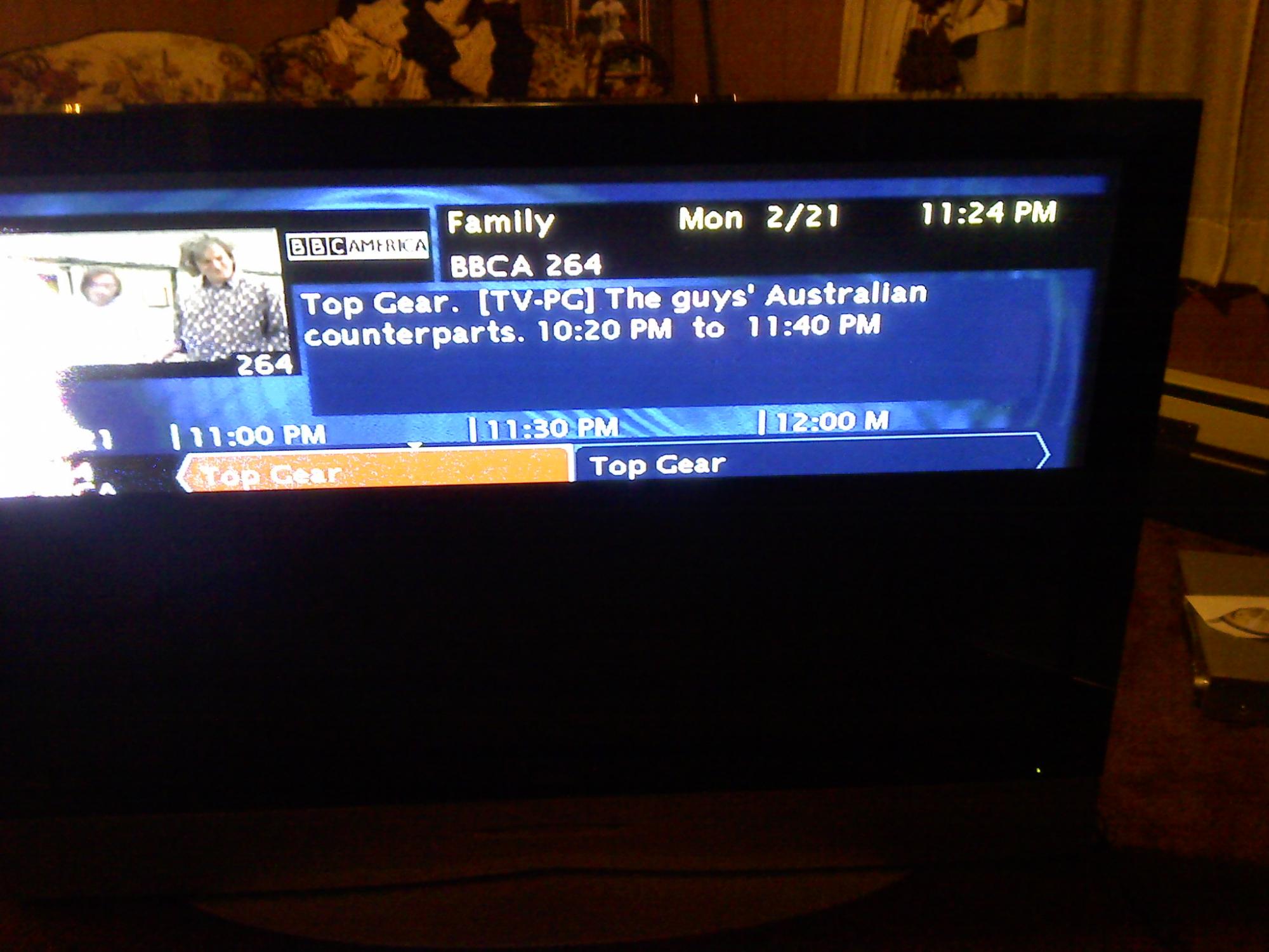

            Thanks,cadiman thats all I needed to hear. I put the Y drive and what appeared to be a good buffer and...I got half of an pix. looks like i can get by with just a lower buffer. Sorry plainbill I meant vizio/samsung, I am old.

                i have the exact TV and my (YSUS) board, part number BN96-06519A, was smoking and so i unplugged it quickly before it caused more damage. i am getting audio but no video at all. taking off the back now, and setting it back up on its stand, i plugged it in, turned it on and it started to smoke. any tips on what i should do?
