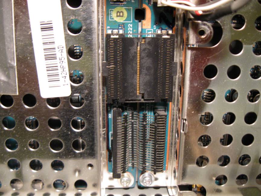

    I'm onto my next TV repair and I got a real gem in a Toshiba Plasma TV 42HP95...I'll explain as I go on how to get one hell of a 'steal' yourself !
    I'm working on this very typical Toshiba Plasma TV failure which occurs on the units main, or the so-called seine board . The OEM replacement board # 75001605, or repairs are so expensive or elusive these sets have become another Toshiba disgrace and warranty dodge or hussle. The trouble is a component or two fail on this board and the boot sequence defaults to a blinking red led light only failure.
    I have got the TV working easily enough by by-passing the power to the board, but you lose features like the cable card slot,.. but most important you lose the digital tuner, so I get no aerial signal recognition. I can play DVD, VHS, and the PC input works fine...but again no TV stations.
    Has anyone done one of these seine board repairs, not just a board replacement ? I have only a tech tip that the failure involves 'a ceramic capacitor' thereon. I'm removing the board now but am puzzled on how to remove the two inter-board connectors...see my pic...these are one black and one grill-like bridges connecting the left board with the right one. How do I remove these so I can lift out the right pcb seine board ?

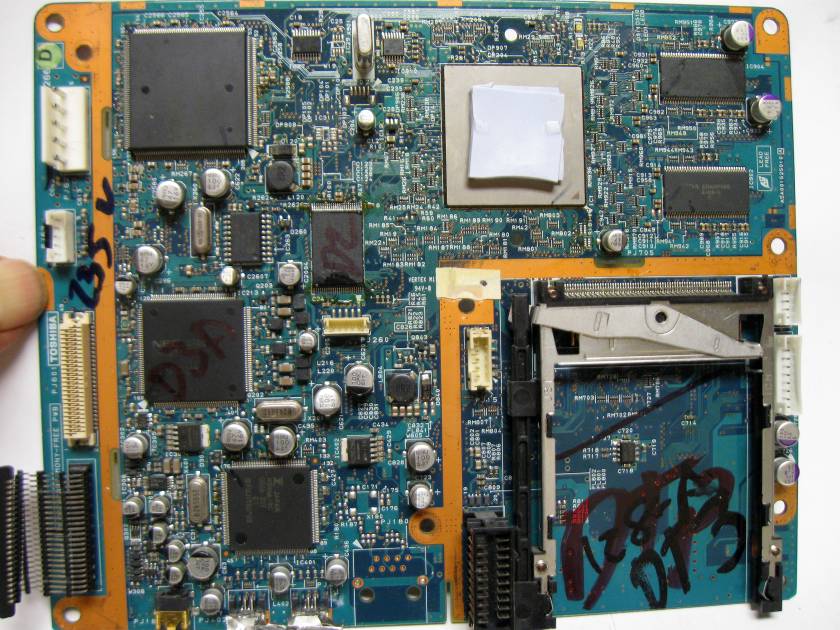

    Re: Toshiba Plasma TV 42HP95 ...seine board pics to check
    I figured those large board jumper/connectors out, basically you need a strong glass to see and study the tiny and fragile plastic locks. I had to remove the upper black one from both sides first, then the left side on the grill-like spring connector leaving it on the seine board. Removing the board from the chassis after that was no treat either...no wonder they charge so much on these sets...a lot of disconnecting to remove one board. Speaking of boards if you were wondering there are no less than 20 on these plasma sets...whoa, give me that cheap Vizio to work on it only had 6 or so !
    Anyway now attached are the top and bottom of my seine (main) board, will you sharp eyes please help me look for damage, any suspects, and which you think are the ceramic capacitors?

      Re: Toshiba Plasma TV 42HP95 (or 50HP95)
      hmmm.. reminds me of this thread
      https://www.badcaps.net/forum/showthread.php?t=13179
      and specifically this post:
      https://www.badcaps.net/forum/showpo...4&postcount=12
      an interesting auction for a repair service for the PD2266C seine board..
      http://cgi.ebay.com/170476624689
      A DEFECTIVE DIGITAL SEINE BOARD IS IDENTIFIED BY A STEADY
      BLINKING RED LIGHT ON THE FRONT OF THE TV WHEN YOU
      ATEMPT TO TURN IT ON.
      YOU CAN DIAGNOIS AND CONFIRM THIS PROBLEM BY REMOVING
      POWER TO TV AND UN-PLUGGING PJ63 (20VDC SUPPLY) ON THE
      DIGITAL SEINE BOARD. THEN APPLY THE AC POWER TO THE TV
      AND TURN IT ON . IF RED LIGHT STOPS BLINKING AND THE TV TURNS
      ON THEN YOU HAVE VERIFIED THE PROBLEM.
      if you're not deaf by now because of that guy screaming at you with capslock on, you might actually wanna try that..
      the auction picture also hints at what the problem is, as it shows a seine board on a solder reflow station, pointing at the main Toshiba chip (!)

        Toshiba TV 42HP95.....> cap ID's on seine board
        I'm stumped on some capacitor ID's as are the techs at Digikey and Mouser...do you know how to read these cap ID's, marked thusly...
        10
        CHB.
        507
        another example is :
        100
        CHK.
        5v7
        You can see them both in lower left of 1st pic in my new post # 2.
        • kingofcoins
          SaveOnGreen-Cap
          • Jan 2010
          • 162
          Got it !
          I found the right tech who figured they may be Panasonic and the codes in their catalog are here for aluminum eletrolytic SMD's:
          10 > 10uf capacitance
          CHB. > C is pan code for 16V, and HB is their series
          507 > a lot number
          100 > 100uf
          CFK. > C is for 16V, and FK is the series
          5v7 . again a lot number
          I have 12 SMD caps to replace so stay tuned for my seine board fix report...
