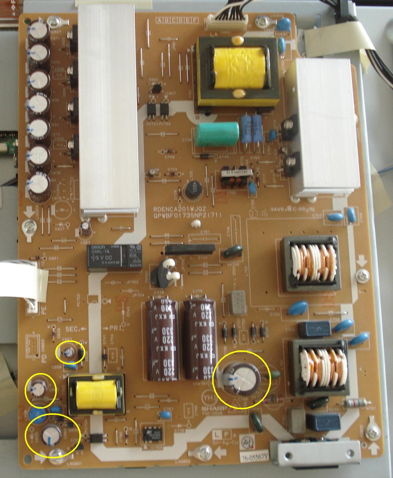

Update. I just put it back together enought to turn it on. I used the hair dryer on the caps in the psu for maybe 20 to 30 seconds and tried it. I did this about 5 or 6 times and walla! It works. So it would seem to me that the problem is indeed the caps.

Mouser carries a Nichicon 330uF 220V cap. I don't know if it is the correct dimensions though. Digikey has nothing with qty = 2 (minimum is 200). If the Nichicon is the wrong dimension, then list the dimensions of the existing UCC cap and we can go up in voltage while keeping the 330uF.
All the other KY caps can EASILY be replaced with Panasonic FM caps. The FM caps exceed the esr and ripple of the KY caps.
KY datasheet at
FM datasheet at
I compared 2 for fun.
1000uF 25V - KY 0.031 ohms 1910 ripple
220uF 35V - KY 0.080 ohms 865 ripple
1000uF 25V - FM 0.018 ohms 2600 ripple
220uF 35V - FM 0.038 ohms 1290 ripple
Good job with the hair dryer to narrow down the problem.--- begin sig file ---

Digikey says KY has 10,000 hours.
The new Panasonic FR series (equivalent to the FM) has 10,000 hours and it looks like it is finally in stock at digikey, but "on order" at mouser.
So instead of ordering FM, go for the FR.--- begin sig file ---

Re: Sharp LCD
No the 330uf, 220 v are the two big ones on there side in the middle of the psu.
I looked on DigiKey the other night and didn't see them there. Must have been tired!
OK I just looked again. Selected FR series with the filter. Then it shows up to 50v and that's it.
OK what about these KXG's

It is very very rare the line filter cap to cause this type of problem, but I have saw the one with the yellow circle instead.Comment

Well this is my list so far:
1 3 565-1613-ND CAP 680UF 50V ELECT KY RAD 0 1.03000 $3.09
2 4 565-1555-ND CAP 1000UF 25V ELECT KY RAD 0 0.74000 $2.96
3 1 565-1601-ND CAP 100UF 50V ELECT KY RAD 0 0.44000 $0.44
4 1 565-1575-ND CAP 330UF 35V ELECT KY RAD 0 0.50000 $0.50
5 1 565-1464-ND CAP 33UF 400V ELECT KXG RAD 0 1.72000 $1.72
6 6 565-1573-ND CAP 220UF 35V ELECT KY RAD 0 0.50000 $3.00
7 2 P12927-ND CAP ELECT 22UF 50V FM RADIAL 0 0.34000 $0.68
Still have not found the two 330uf 220v better than 1000 hours.
MenessisComment
Re: Sharp LCD
I'm a bit confused here.
1) Which caps are "bad" when heated up? The answer seemed to be the two main filter capacitors. Is that correct?
2) I honestly don't care which brand and series of capacitors is chosen, but if you are going to replace all the KY caps, why replace them with new KY? If they are bad or suspect, why not another manufacturer like Panasonic FR series which has equivalent or better ratings?
3) I also understand the requirement to match the original cap specs as close as possible.Last edited by retiredcaps; 01-02-2011, 09:34 PM.--- begin sig file ---
