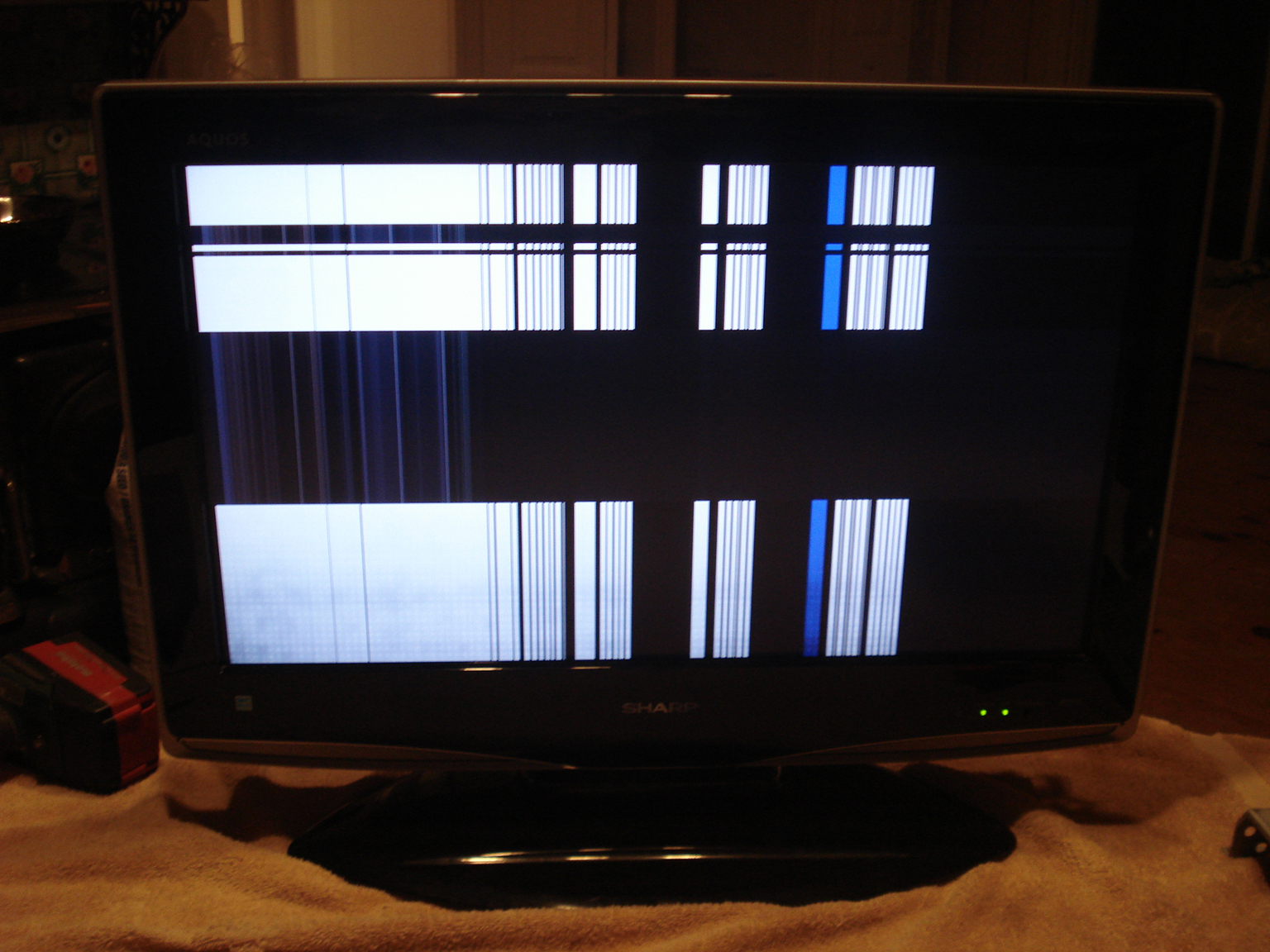

          Re: Sharp LCD
          OK here we go again.
          This Sharp display isn't working. Untill it warms up for about 20 minutes and seems to work fine. If you tap the case you can see the menu's a bit but then it goes again. Once warmed up you can tap the case with no effect.
          Any ideas?

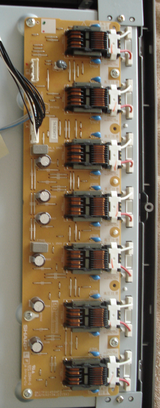

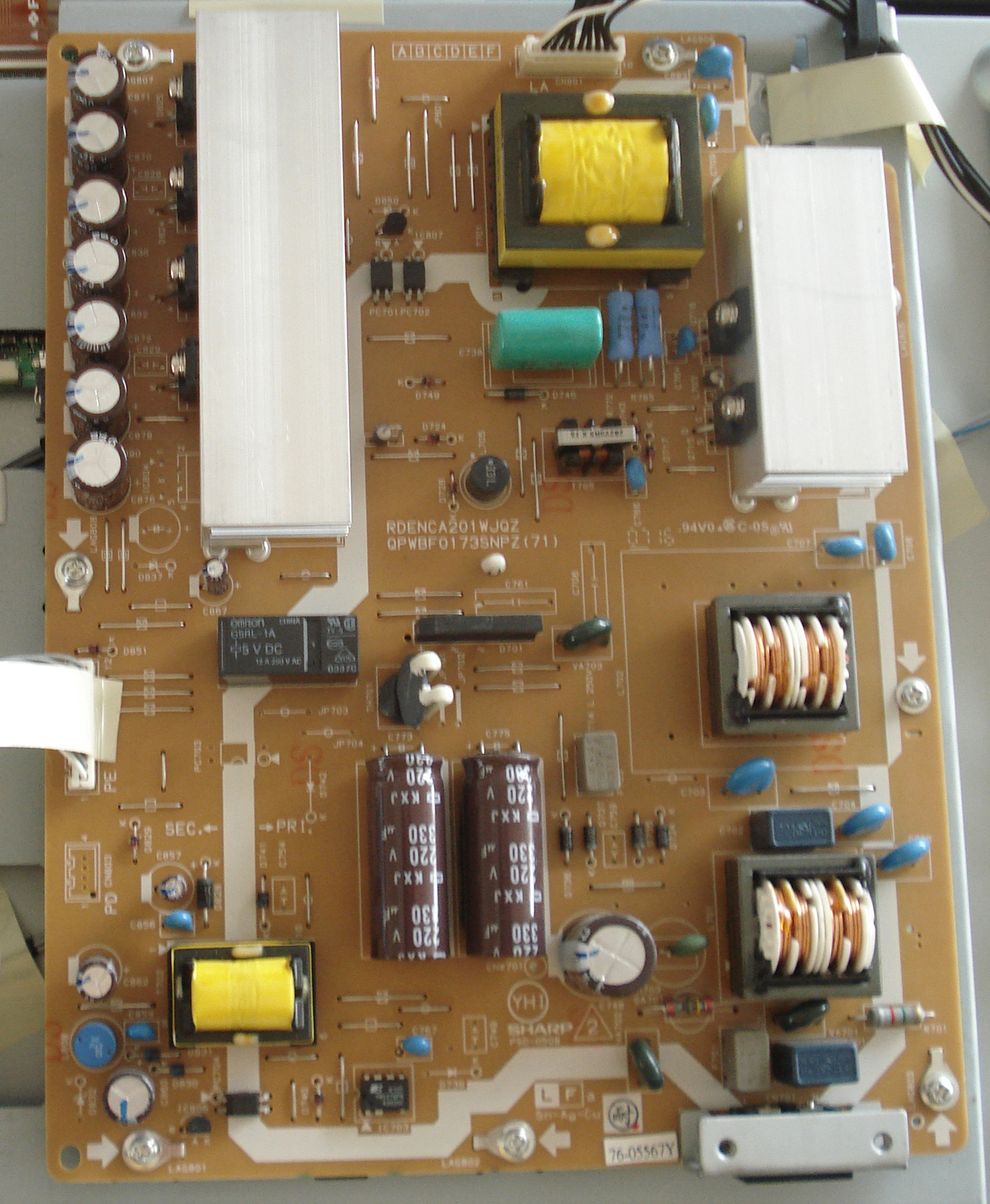

              • Menessis
                • Nov 2010
                • 51
                Re: Sharp LCD
                OK pictures. I had to wait untill today for some day light to get a good picture without the flash.
                • retiredcaps
                  • Apr 2010
                  • 9271
                  Re: Sharp LCD
                  Originally posted by Menessis
                  OK pictures.
                  Can you list the electrolytic capacitors listed on the inverter and power board? Can you list it like this?
                  Board designation, uF, V, series
                  For example
                  C770 - 330uF 220V, KXJ
                  It looks like all the caps are made by United Chemi-con. They generally make good caps, but the KZG is not recommend as per
                  https://www.badcaps.net/forum/showthread.php?t=2280
                  Additionally, caps do not have to bloat like in your TV in order to be bad. The 8 caps on the left hand side of the power board could be dry from sitting next to the diodes which put out a lot of heat.

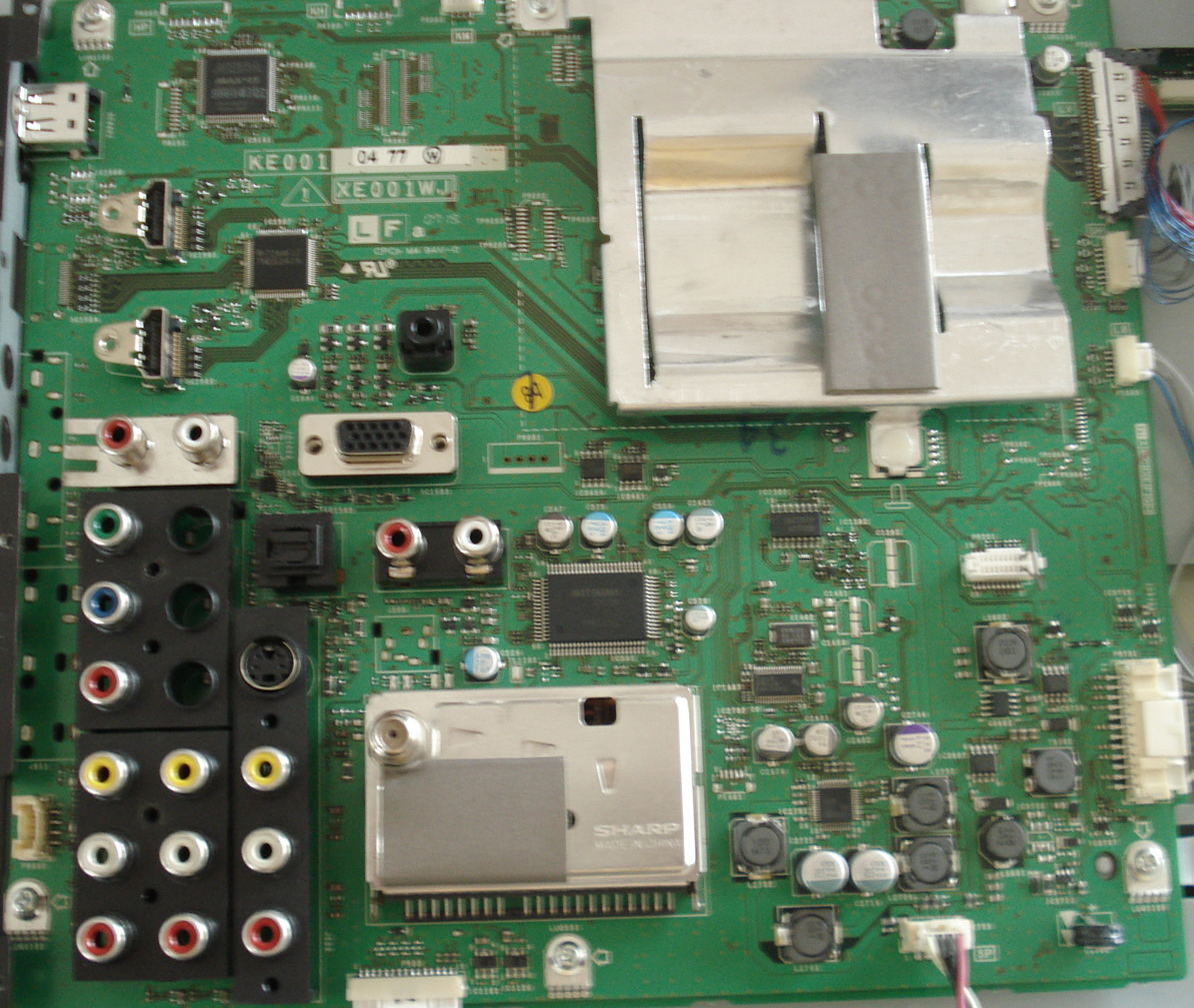

                  • retiredcaps
                    • Apr 2010
                    • 9271
                    Re: Sharp LCD
                    Some clarification questions.
                    1) On the main board (green) what is behind that heat shield?
                    2) When the TV is warming up for 20 minutes, does it display the picture in post post #5?
                    3) After 20 minutes and completely warm, does the picture look normal then?

                      • Menessis
                        • Nov 2010
                        • 51
                        Re: Sharp LCD
                        OK behind the heat shield are a pair of what looks like "processors".
                        During the start up warm up the display could be just about anything. I didn't have a source hooked up. I pushed the menu button and it showed that pic in #5.
                        Yes I plugged in the camera and the picture is fine once it warms up. I shut it off for about 5 minutes and then tried it. The picture was already starting to degrade. Came back quickly though.
                                Possible correction? Upon closer examination, they look like fets/power transistors instead of diodes. Hard to tell as pics are slightly out of focus.

                                • Menessis
                                  • Nov 2010
                                  • 51
                                  Re: Sharp LCD
                                  OK a list of caps.
                                  2 x 330uf @ 220v the two large ones on there sides
                                  4 x 1000uf @ 25v 4 bottom ones beside heat sink
                                  3 x 680 uf @ 35v 3top ones beside heat sink
                                  1 x 33uf @ 350v
                                  1 x 330 uf @ 35v
                                  1 x 22uf @ 50v
                                  1 x 100uf @ 35v
                                  6 x 220uf @ 35v these are on the other board
                                  They are all KY except for the two big ones on there side which are KXJ.

                                  • fastvideo
                                    • Dec 2008
                                    • 55
                                    Re: Sharp LCD
                                    remove the heat sink on the main board, check if there is any gammy thing found on the board. If yes, remove and clean it.
                                    Also check if the heat transfer pad is all dried up.
