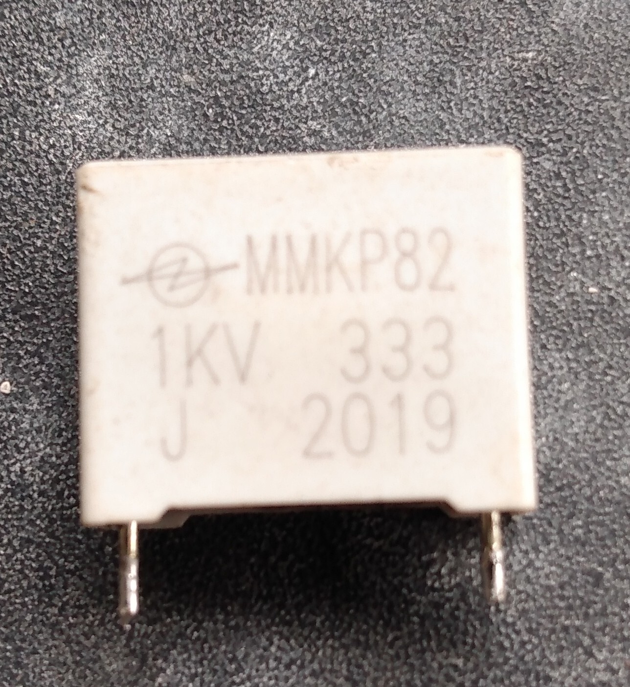

      Here's the bad cap. It does read open with ohm meter on highest setting and reads unknown or damaged component on the component analyzer. Usually in ohms with a working cap you will see some low resistance that climbs to infinate once the cap is charged.
      I can't figure out what manufacturer makes this part. I don't recognize the symbol and can't find it in the list (see attached )
      how can I tell what the capacitance should be? I would like to find the datasheet but without the manufacturer I would go off another manufacturers datasheet which may not be the same?
      I Think the 333 means 33 nanofarads...from looking at other manufacturers markings.
      I get putting in a 2kv replacement for future proofing the tv but what of the capacitance? Do I have to get it exact ?

        Yes .033 uf, 33 nanofarads, see if you have something close and give it a try.

          I have the same issue, what did you end up replacing it with? I have a bunch of other boards I might be able to pull from but wanted to check with you.

                    Got me a 75s425 and had picture with no backlight. Tested backlights and all working fine. Tested voltages at backlight and one line was .9 and other .18. remembered this thread and pulled it up. Replaced the cap mentioned above with a higher uf from another board. All working correct again. Extremely easy fix. Thought I'd add to this. Thx to whoever figured it out.
