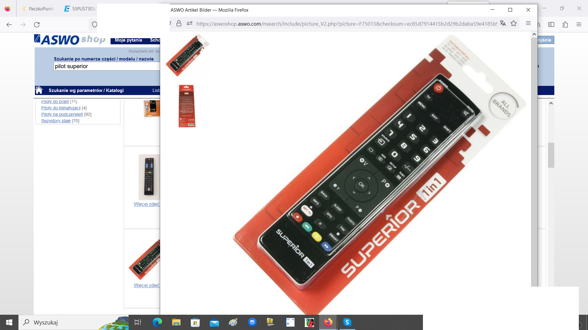

                          Re: Philips 22HFL3232D/10 hotel unlock?
                          This one , from ASWO .
