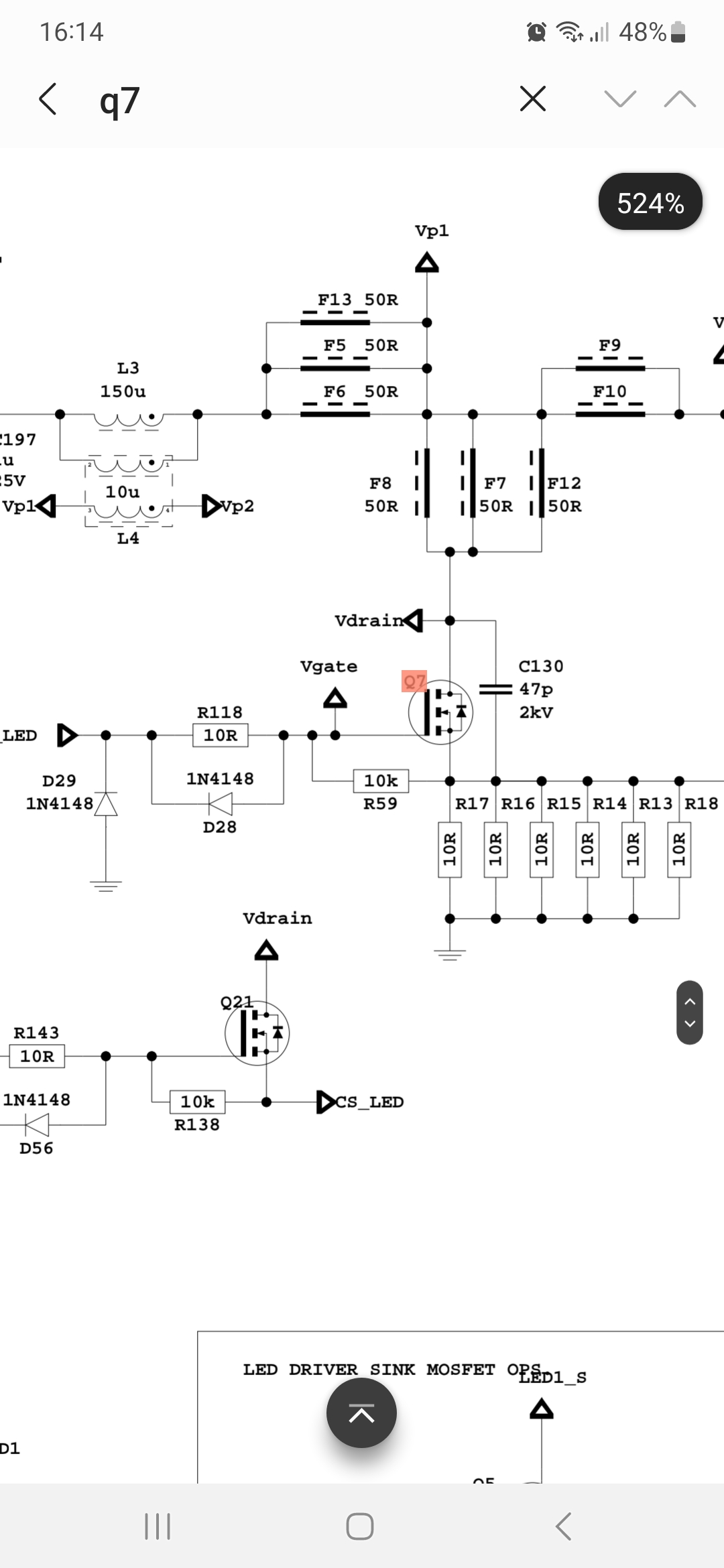

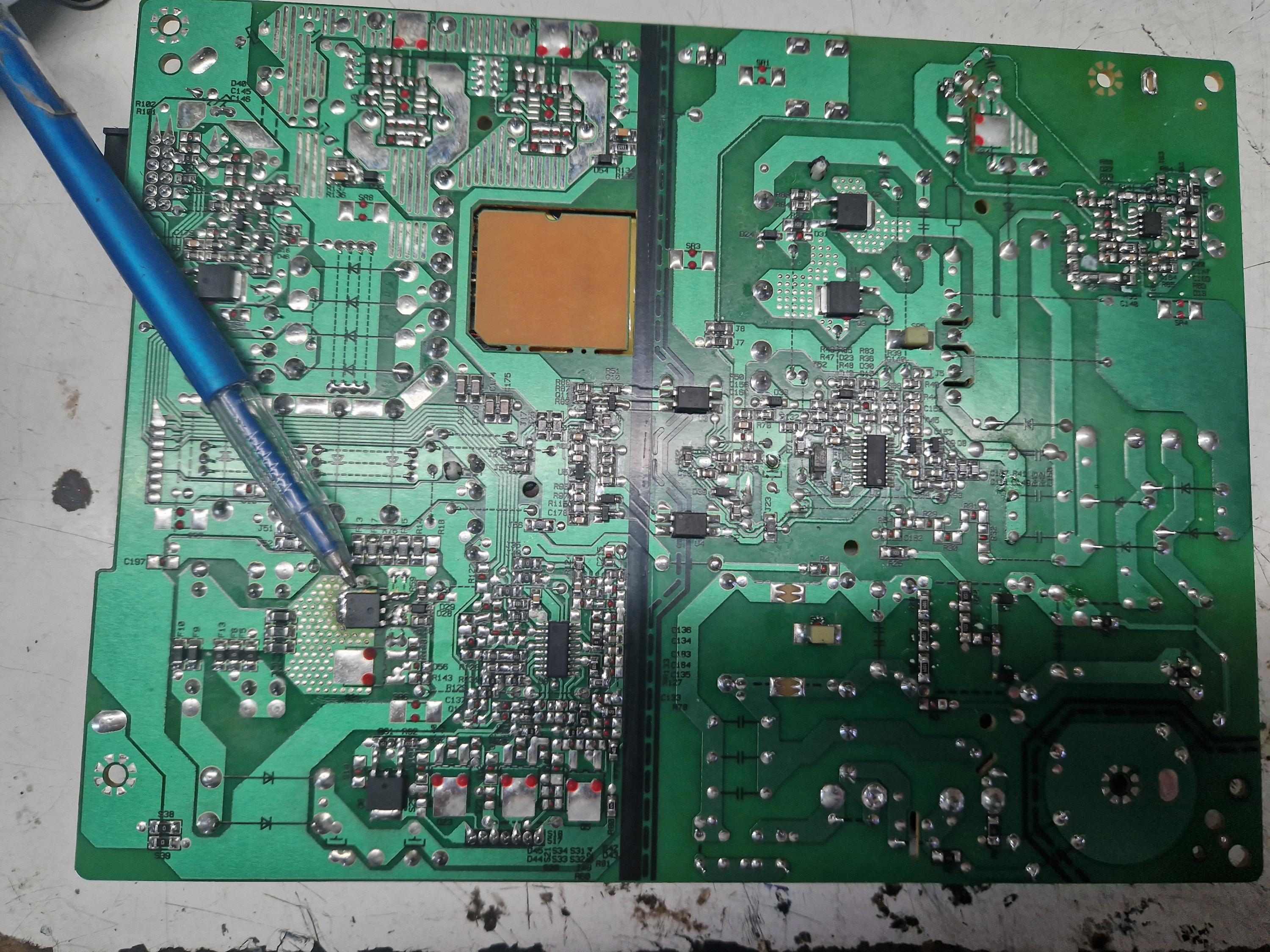

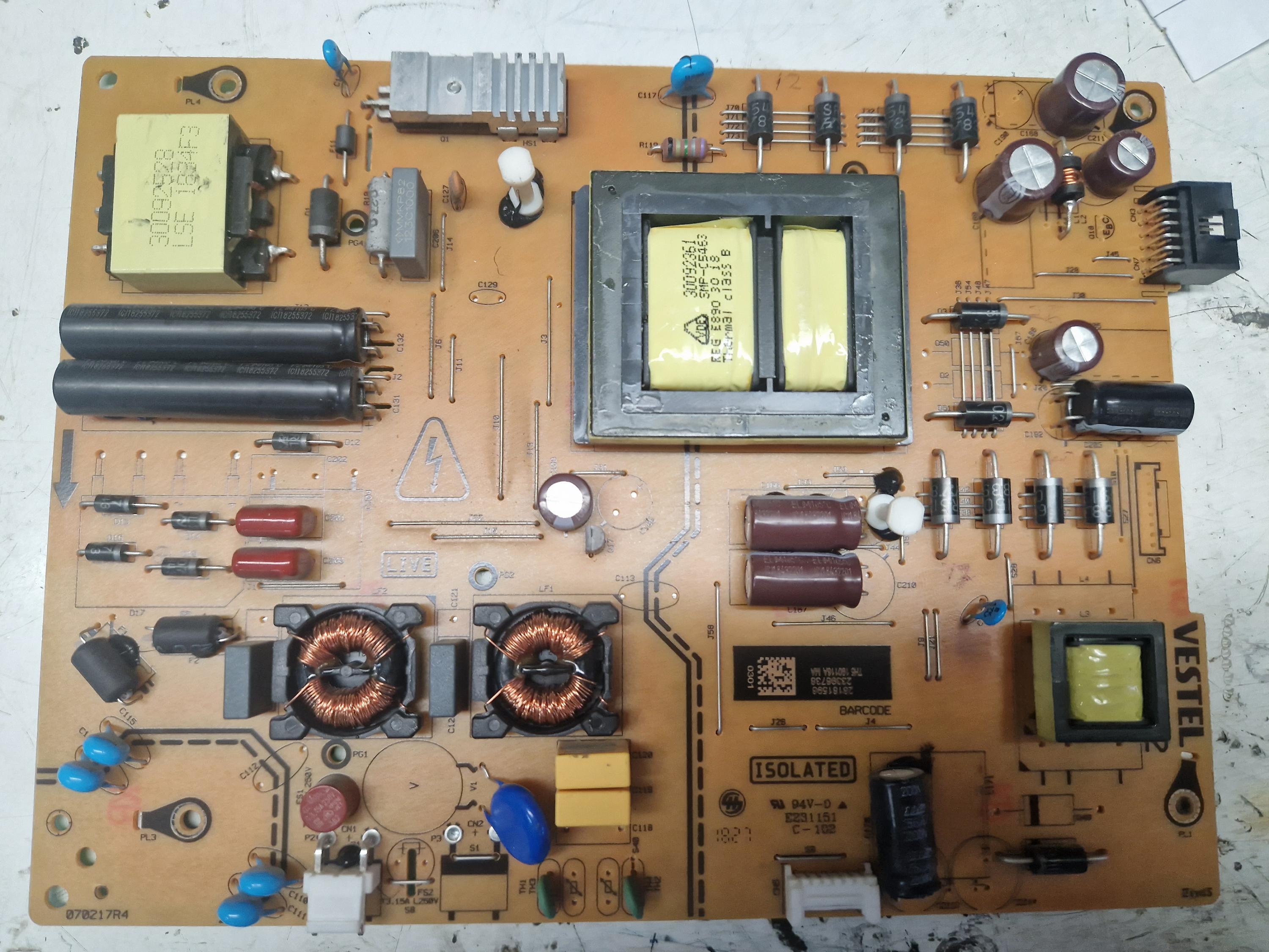

    Need some help here. Led controller mosfet MDD14N25C Q7 bliwing immediately.
    Tried a replacement board and all is fine but would like to repair this.
    Suspecting either transformer shorted or gate drive from Ic. But looking for your opinion if ot is a known fault

    Re: Vestel 17IPS72 R4 BLOWS Q7
    check associated resistors and be sure you used a genuine replacement mosfet

      Tks. So far cross checked relative components against diagram but haven't identified the culprit yet
        C120 - has that got burn marks on its side?
          just bad quality,.,, replace both Chanel at once and be sure u don't have short cable of BL cable behind the screen
            I guess you are referring to C130 47p 2kv. The brown shade is due to the heat of the underlying Mosfet
              Sorry what both channels? There is only 1 FET switching on BLs. LEDs work fine with a replacement card.
