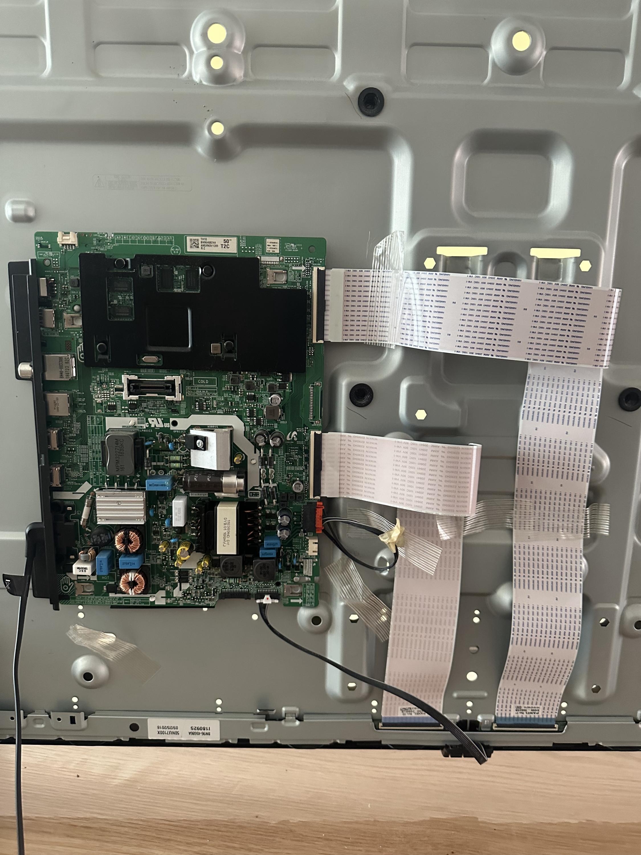

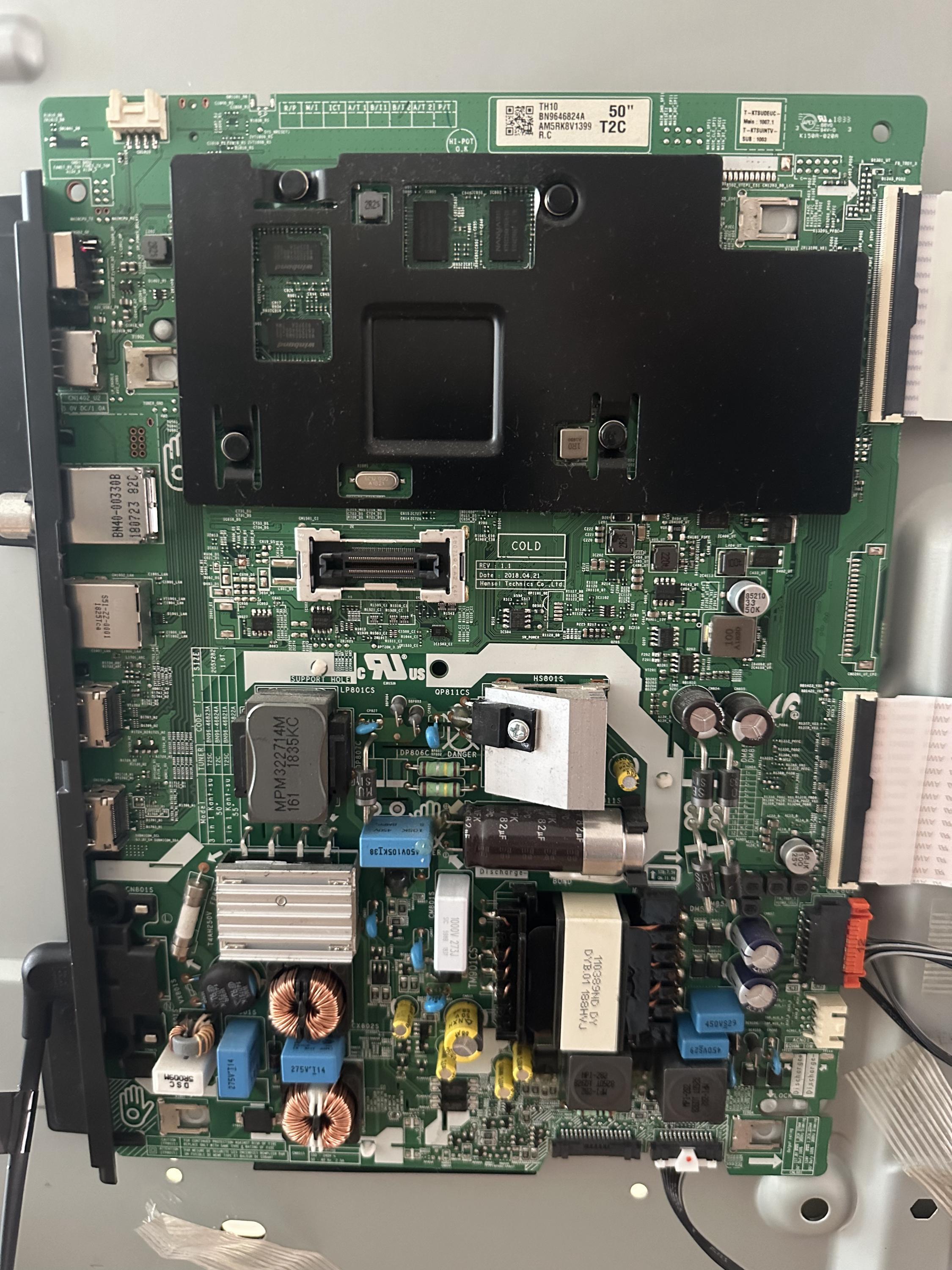

      Re: Samsung UE50NU7020W TV Stuck on Smart TV Logo with No Display
      Indeed, there is no T-CON; I was simply referring to the two ribbons connected to the motherboard
      Here are the photos.
      That's the only board of the tv.
      In the photo, the speakers and wifi board are removed.

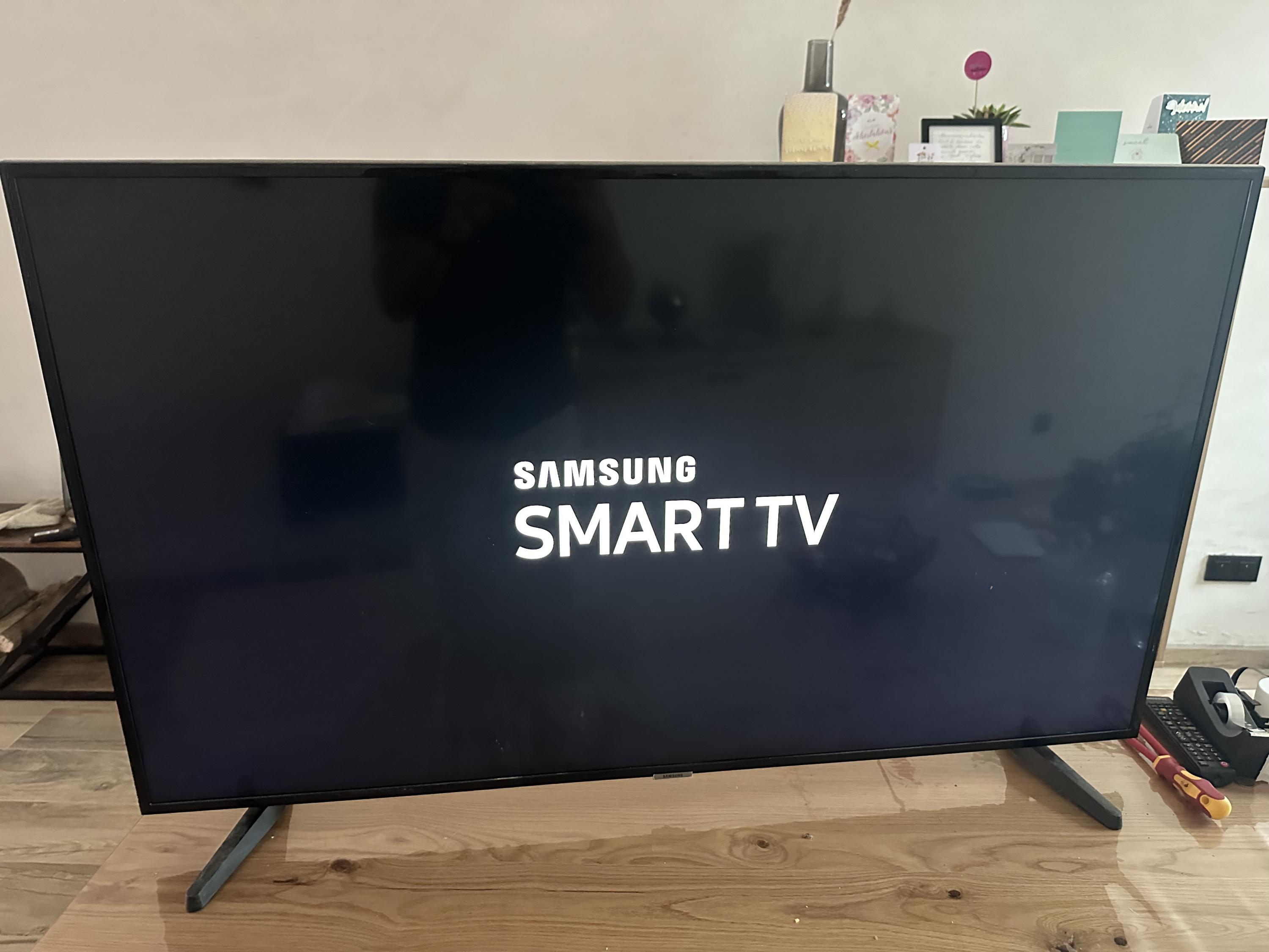

            show please yours screen as you said it show ssmsung smart at start up
            • ovrax
              • Nov 2023
              • 17
              • Belgium

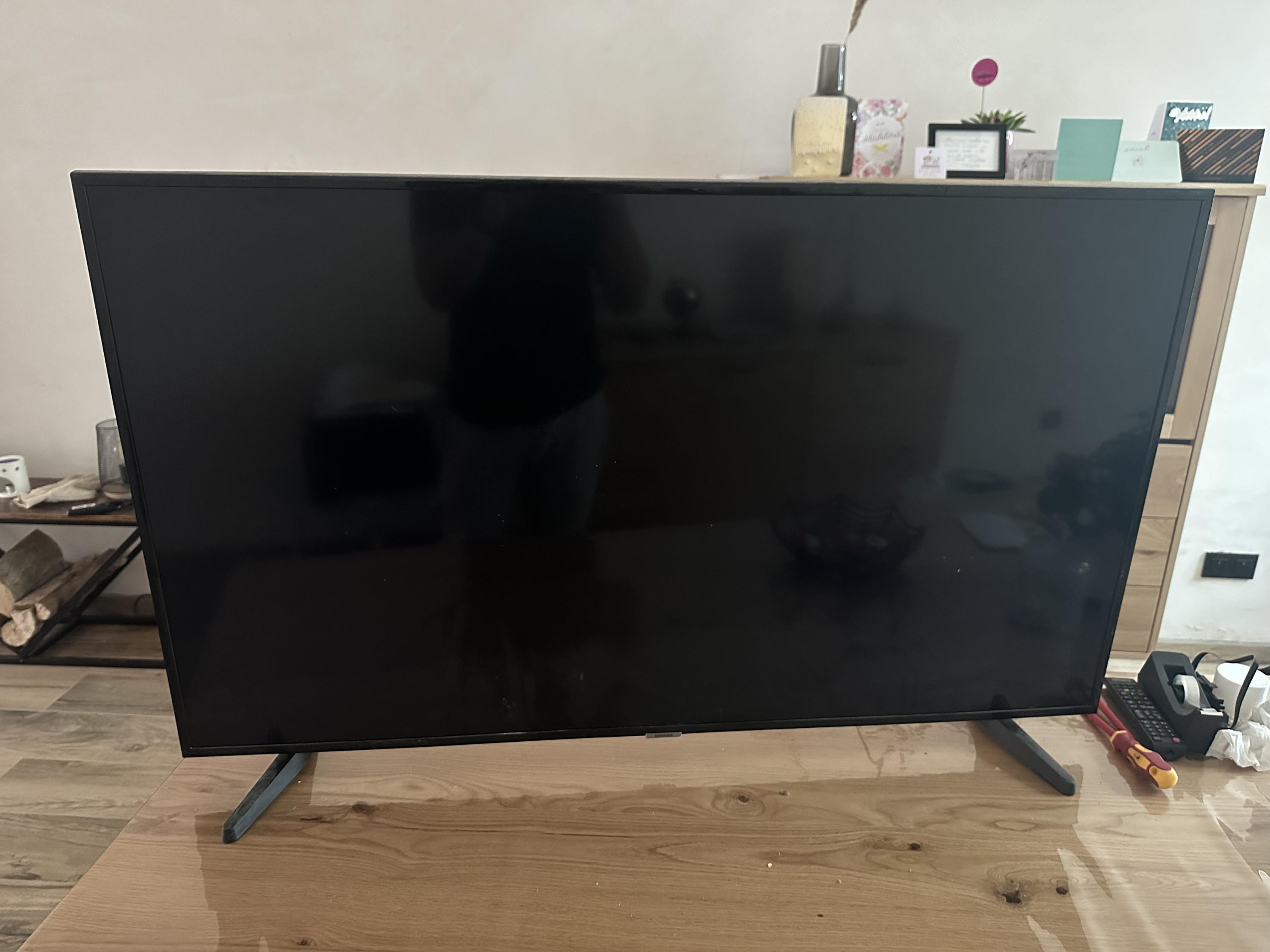

              Here are the screen photos.
              When I plug it in, and one second after.
              In the second photo, the backlight is on. But nothing is displayed. No sound either.

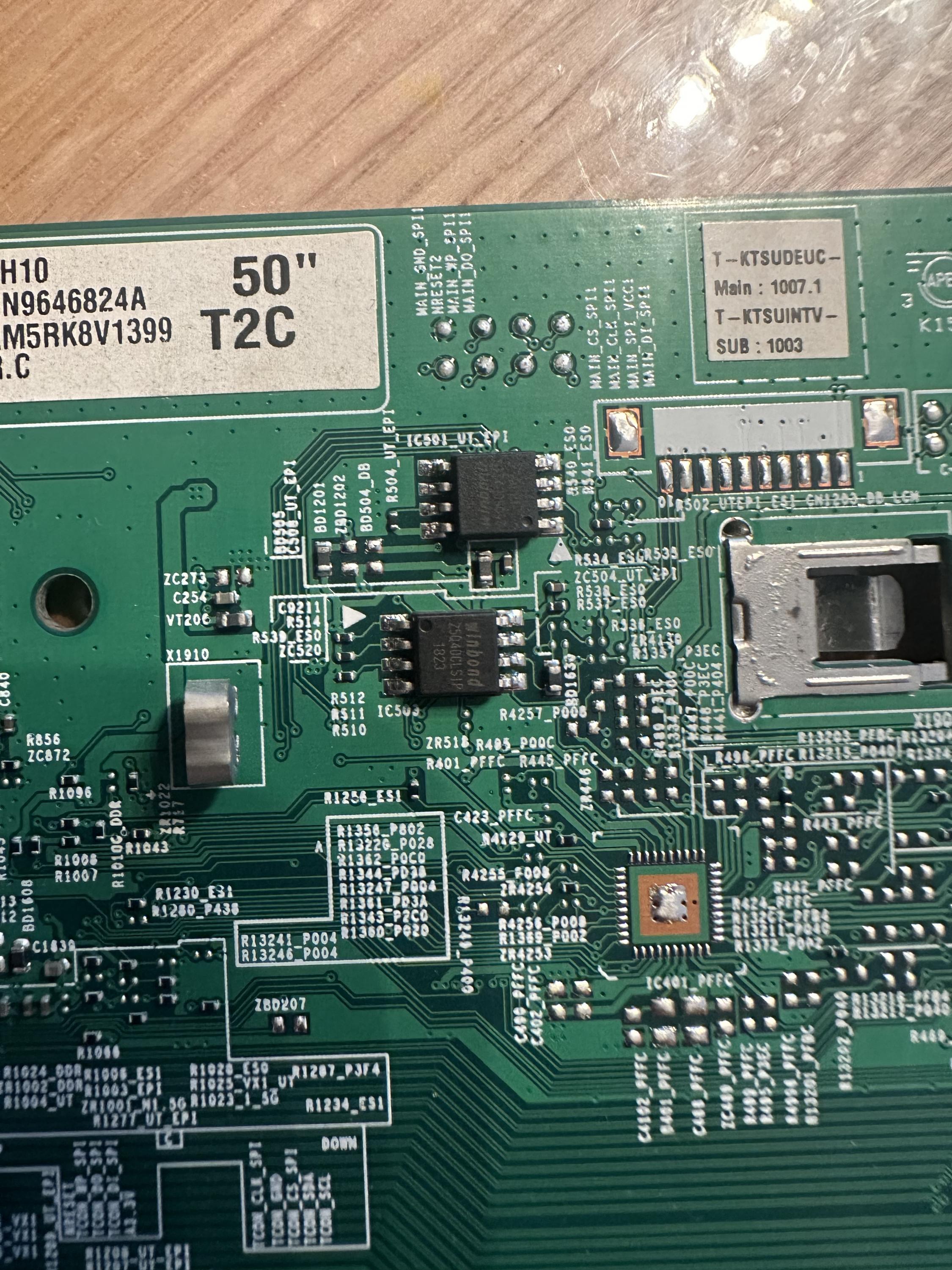

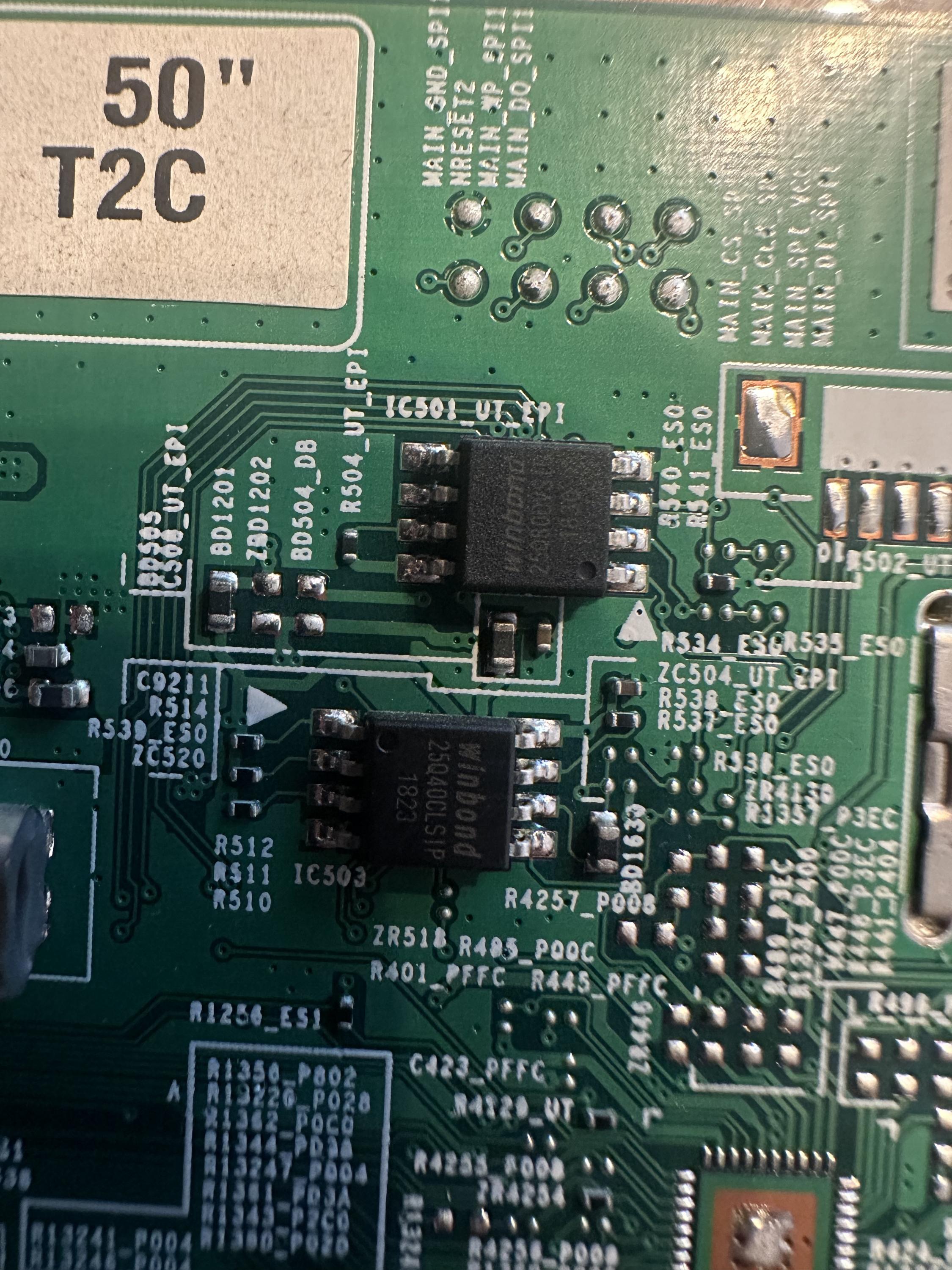

                okay... you need to take out the black heat sink, you will find 8pins chips ( SPI ) this need to freez it then plug the tv in wall... see the result
                will be good if you show us the SPI chip and its lable

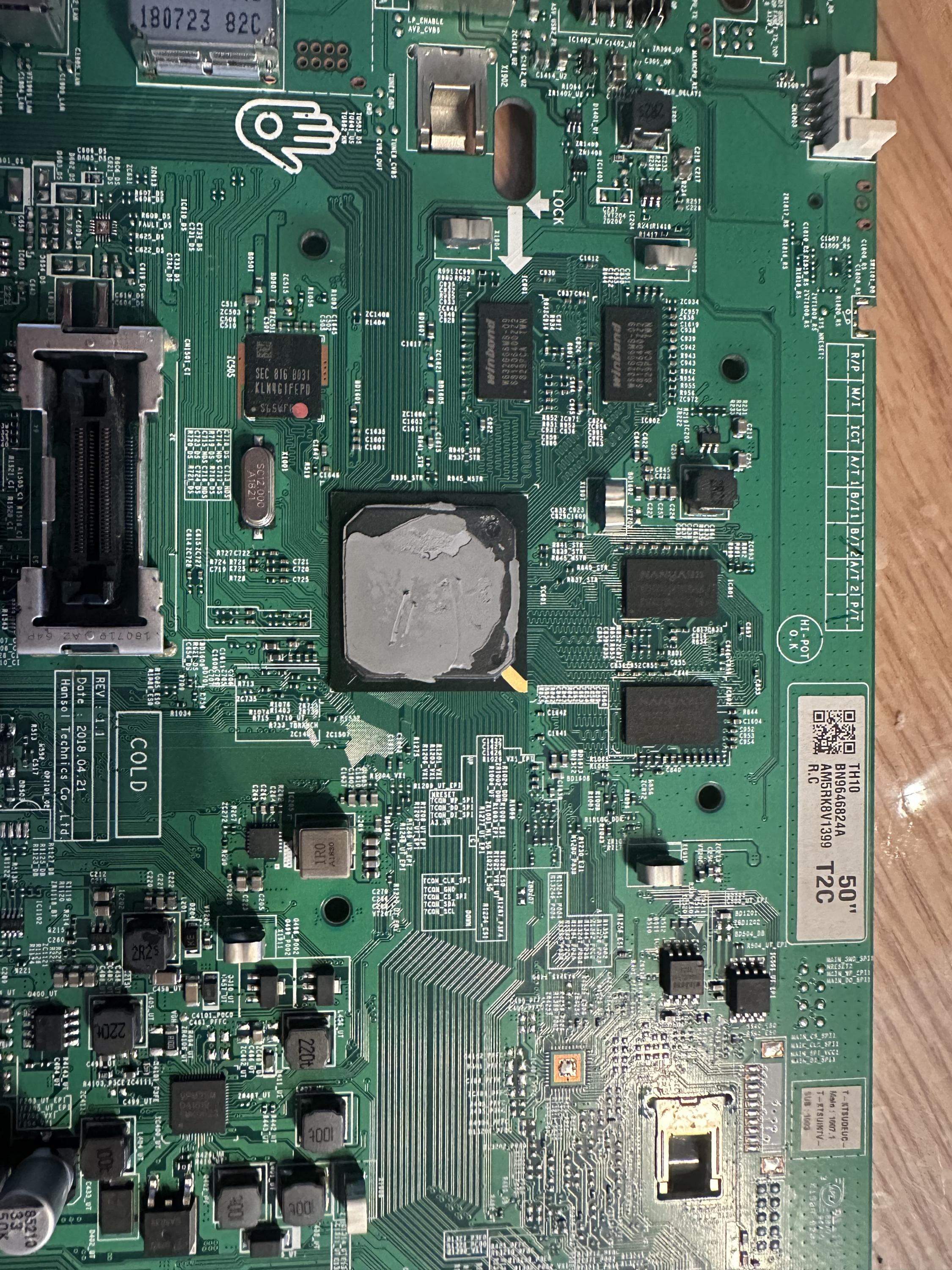

                  Here are the photos without the heat sink.
                  Feel free to ask if you need more photos.
                  Is it really effective with the fridge? How long should I put the board in the fridge, and how long should I wait before trying again?

                    IC 503 , you need cool air spray.. not in fridge LOL
                    Lighter Gas can freez it too,,, but be caution don't burn your house

                      You think the problem is this SPI ?

                        we need to freez it first to see any change... if no change then we have issue at the NAND or main CPU BGA issue. however if you cn find boards will be fine too... yours panel are fine.

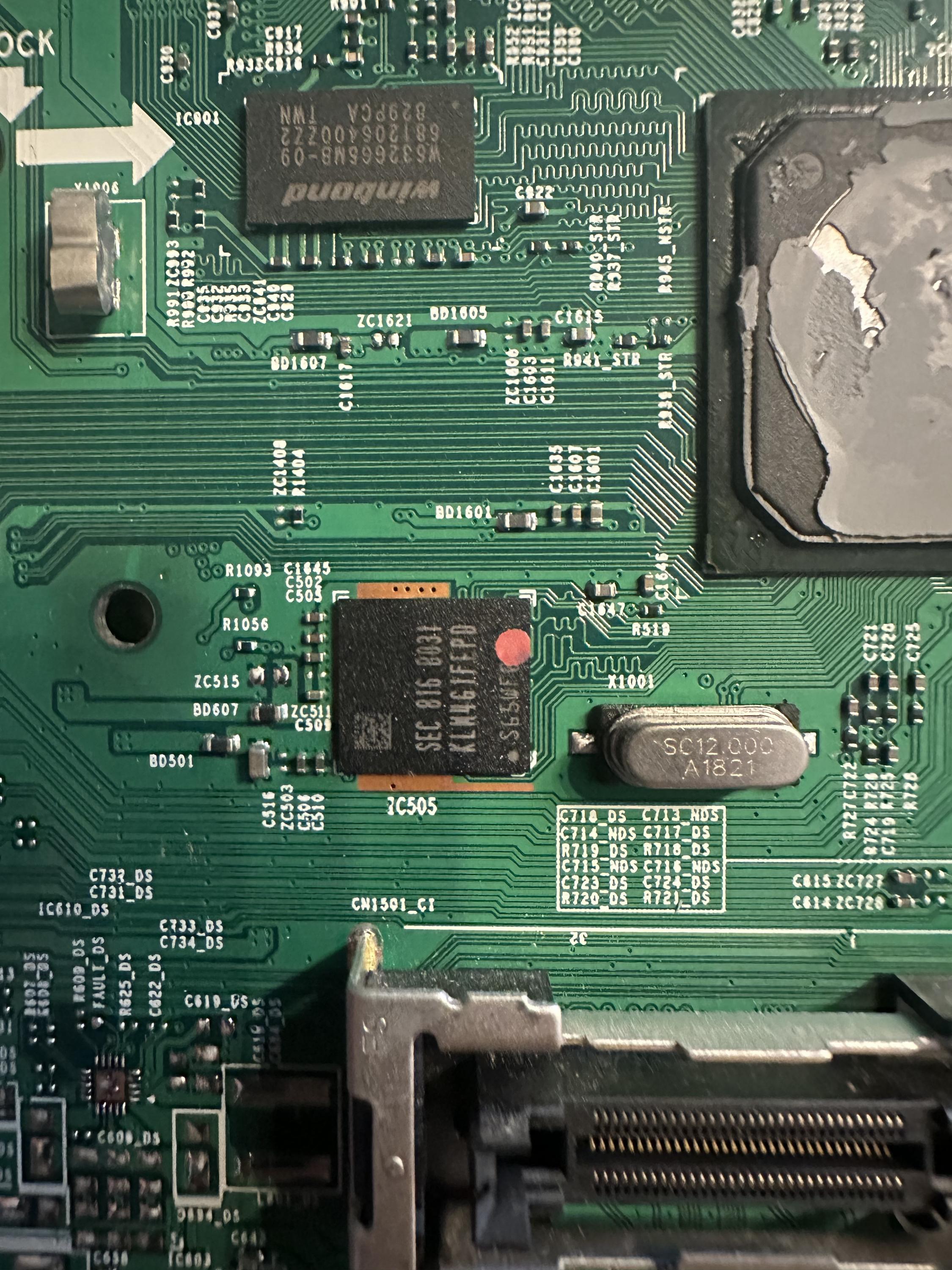

                              • letmealone
                                Smart Tech LE-4048SA stuck at SMARTTV logo: problem solved.
                                by letmealone
                                I had this tv set, stuck at the 'SMARTTV' screen with coloured logo. Impossible to find the original Smart Tech firmware, so i searched in kazmielec.tech some firmware compatible with the tv-set hardware (CV338H-T42 card and Y400HJ6.PE1 screen). The firmware i tried was wrong and it bricked the TV, just showing a black screen and not entering stand by anymore. I supposed it needed special hardware to reflash the NAND, but i was wrong, it just needed a working compatible firmware. Still in the kazmielek page i tried ' CV338H-T42_1920x1080_Telefunken TF-LED43S81T2' and it finally worked. I wrote...
