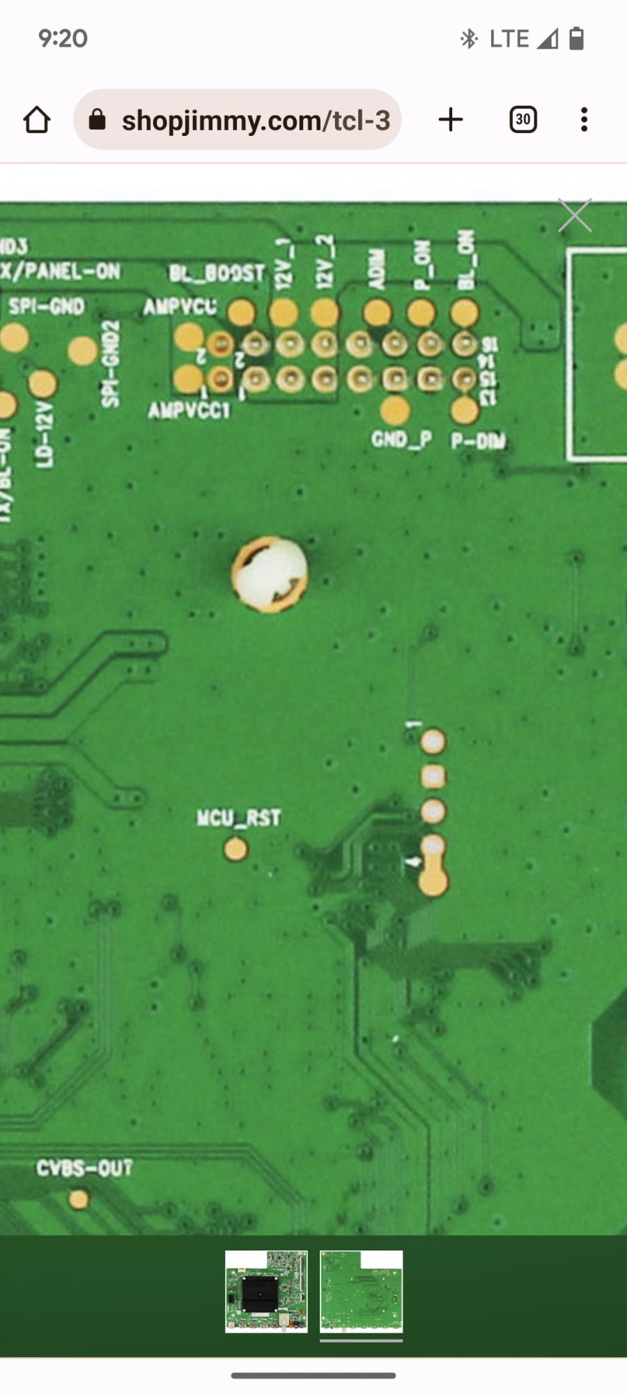

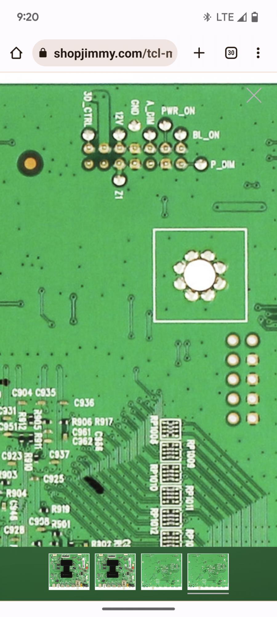

    I picked up a TCL 50S421 yesterday that appears to have a power supply issue. I get absolutely nothing when plugged in, not even a power indicator. I was curious if a spare power supply I have from a 55S451 would possibly work in it, at least for testing. The boards are physically different but the only two connectors are on them are identical. What is the likelihood that the 451 PSU would power up the 421 and NOT cause any harm?

    There is no legend on either board to compare voltages and pin out. It may work but without confirming the pin out and backlight output voltage I wouldn’t try

      Really the only plug pinout that matters is the one going to the main, right? The power cord wouldn't be different. Would the legend possibly be on the main board side of the cable?
      Attached are photos of the back of the plug on the main boards.

        Re: TCL 50S421 power supply interchangable?
        you are diving with experiment could end to catastrophic result... because at the end 55 size BL circuit will burn the 50 LED BL
        the correct way.. take yours Original and put it alone on the table... plug it in wall and check at cold side if you have any reading DC V. photo of the boards in high resolution will help to guide you where to test
