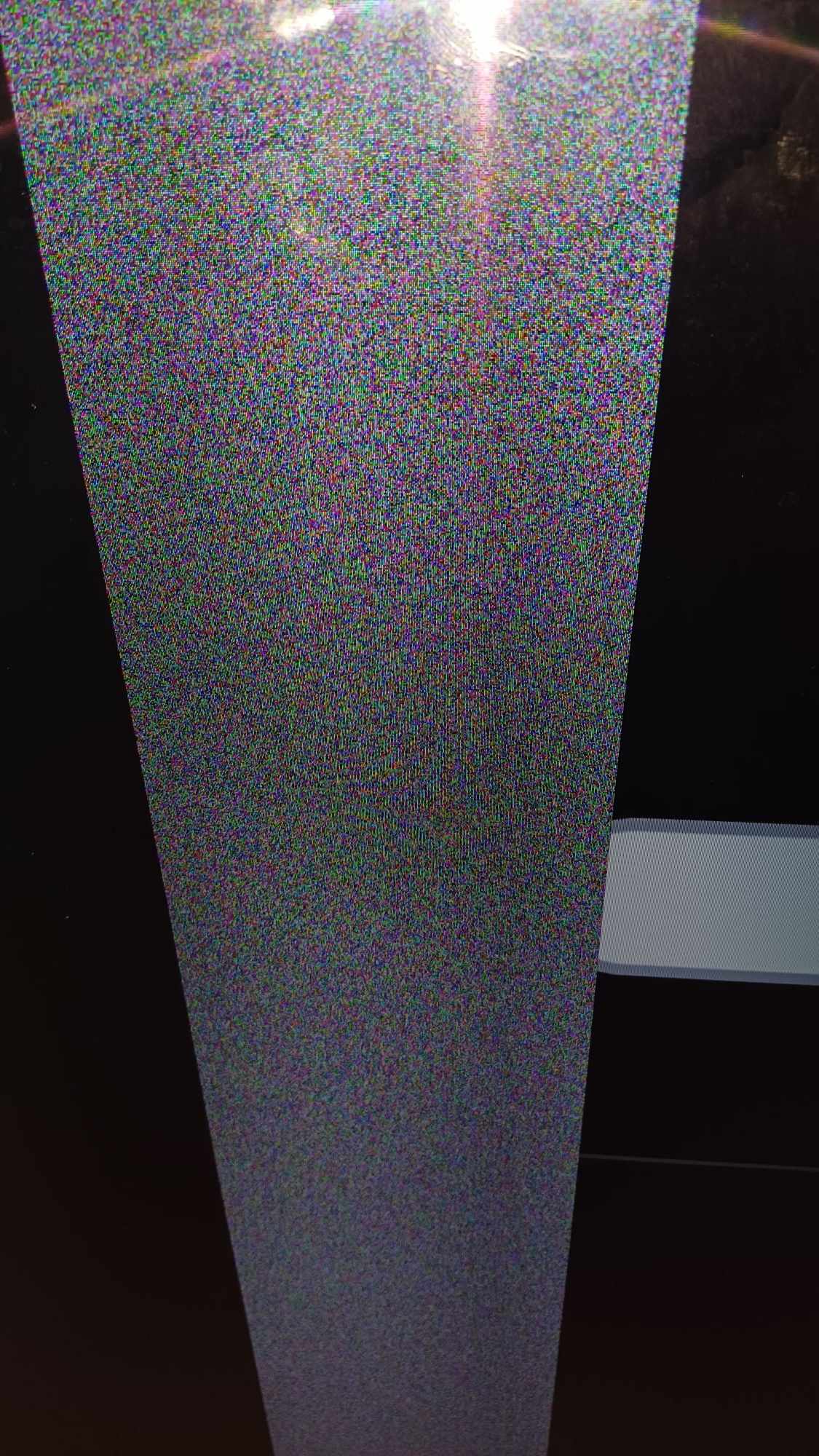

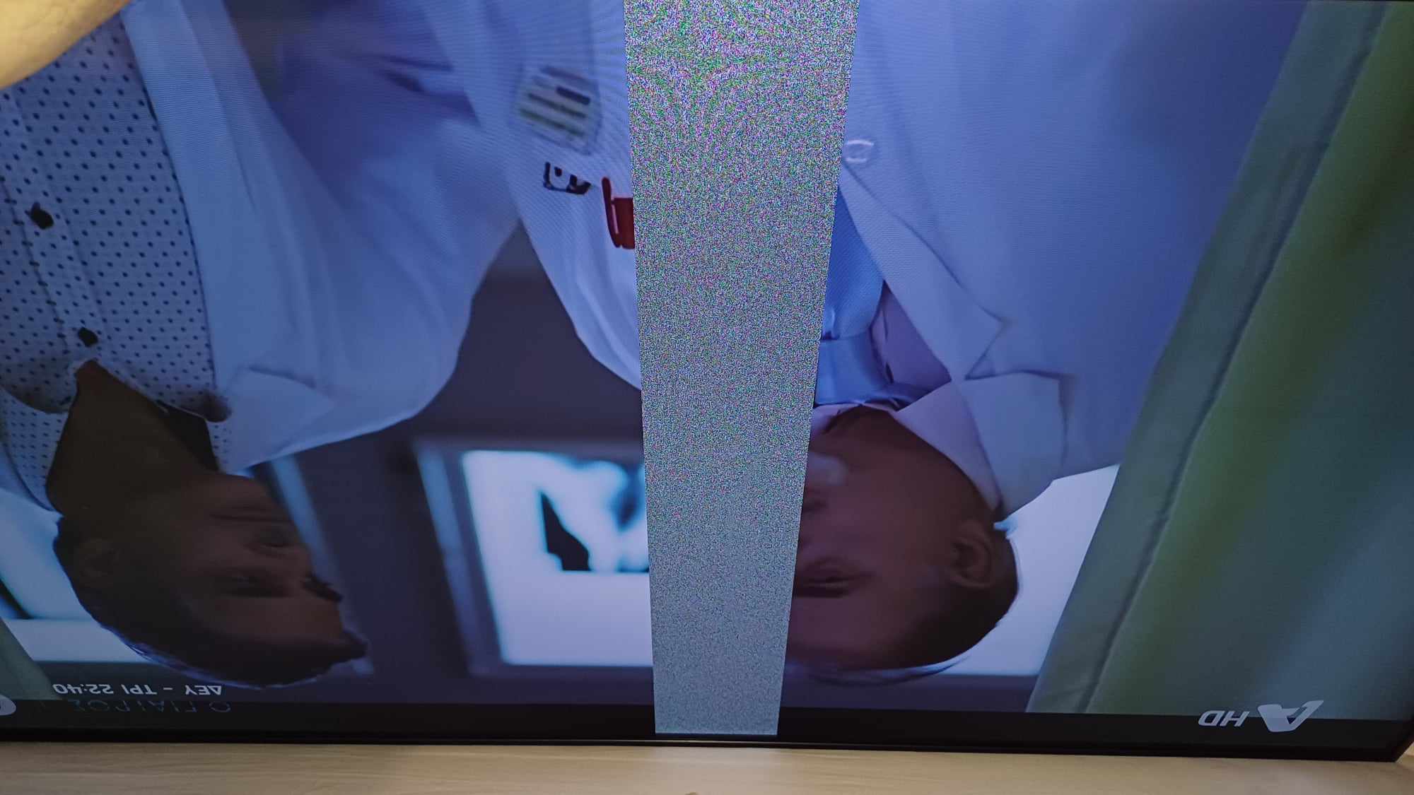

    Hello everyone.
    I have this TV set which has this issue. It shows a vertical bar im the middle of the screen.
    The panel has 12 cofs and the problem seems to be on the territory of the first cof on the right side.
    The tv fires up and you can see a good picture exept that vertical part where multicoloured pixels exist.
    The strange thing there is that you can see behind that snow that it shows picture but as if there are these pixels in front so you cannot see clearly.
    The effect is there even on a completely black screen.
    The screen does not change if a press slightly the cof.
    no shorts on capacitors there after a quick test
    Any suggestions on what to look?

                    But i see that the Tv there has problem all over the panel and the lines are smooth and not like the old time no signal snow
                    This is what is very strange here, I tried searching for pictutres over the internet with same issue as mine and i see none..
                    Also the most weird of all is that <<behind>> the snow you can see the pixels changing according to the shapes displayed on tv that time ..

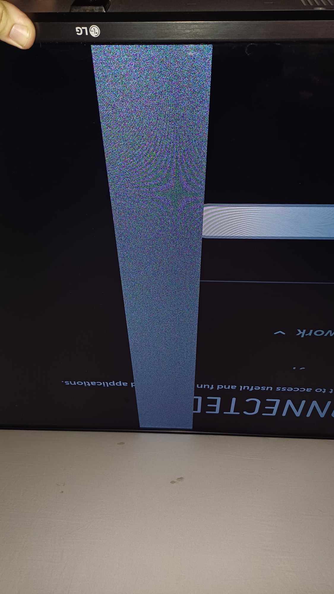

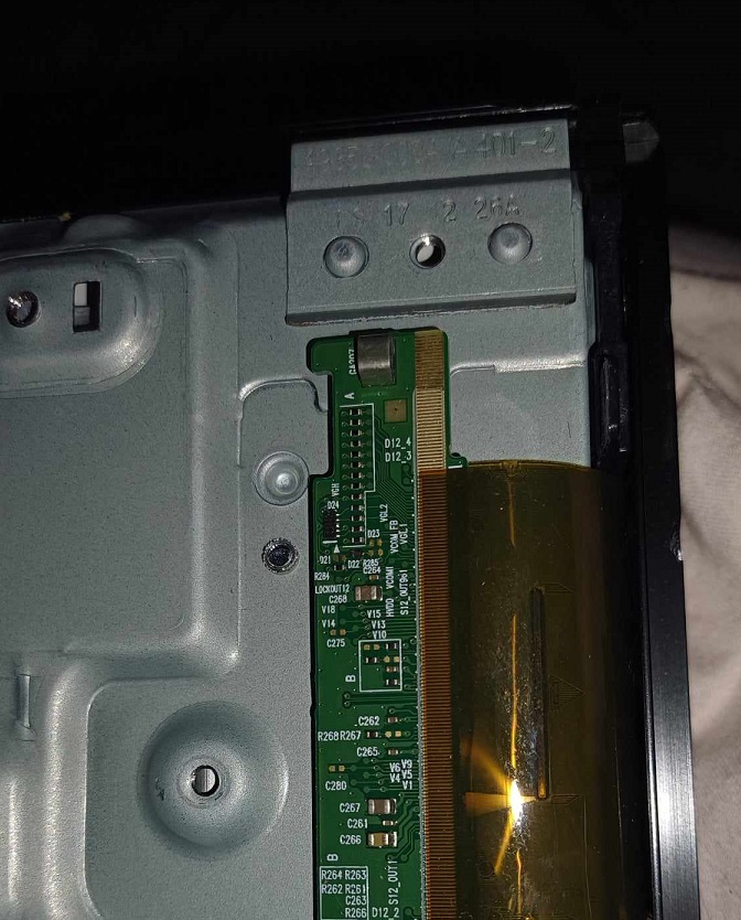

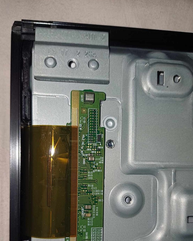

                          I did some tests .I know that the last one is not a correct one but i did it .
                          I fired up the TV got the expected picture.
                          I removed the right side ribbon , the one with the problem , and i got a correct half picture from the left.
                          I remove the left ribbon and i get a half white half black screen .
                          The white part is on the left side and gradually darkens and the right side stay black even the part that has the snow when working with both ribbons.
                          And finally i fired up the tv with both ribbons got the picture with the issue and then .. i removed the left side ribbon to see what happens. i got the pictured attached... Shouldn't, i still have the snow on the problematic part of creen????
                          I tried to get voltage ratings from testpoints and this is what i got
                          Left side (ok)
                          CLK1 to CLK8 : 2,37V
                          VGH :16,5V
                          VGL1 : - 6,95 V
                          VGL2 : -14,85 V
                          VCC : 3.3v
                          Right side (snow on one COF)
                          CLK1 to CLK8 : 2.36 V
                          VGH : 0 V
                          VGL1 : -14.65
                          VGL 2 : -14v to 0 V
                          Vcom : 5,2 V
                          I am at a loss here..
