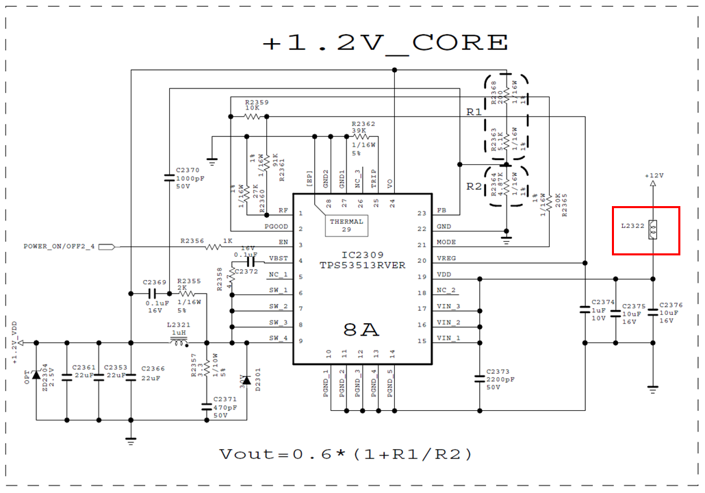

    Tried to find L2302 to check eMMC V. During search I found L2322 is burned (resistance 440Ohms), which is output for 1.2V
    Is it ok to bride the coil for testing purposes or better replace with some other SMD coil?
    you have one ceramic cap shorted... other wise this filter coil will never burning.. good found
    dont bridge it unless you find the short
      The choke doesn't just burn out, you have a short somewhere, unsolder the choke and measure the resistance on each side relative to gnd.

        Need to give a correction, the burned choke is input for 1.2V voltage regulation, not output.
        If I short the choke the buzzing noise is gone, but still this fancy PWM signal on output side...
        No short measureable, also the 12V input is stable. Maybe its burned during some of the tests before. Because the buzzing noise i've recognized first during the test in #18

          Re: LG 49UB850V not switching on / standby LED off / LD701 blinks 5x
          jumper it and let the game start... other wise buy replacement MB
            Done already. eMMC Voltage is also correct =>3.3V. Still missing 1.0;1.2;1.5V...
              keep it on, and monitor the temp of MB, if u have warm camera will be good.. there should be part will warming out

                                      #58
                                      Short Update - TV is working again. BGA Reflow of IC100 does the trick.
                                      Long Story:
                                      • PWS,Edgelit,T-Con,Panel was working (checked before)
                                      • Previous missing voltages, all voltages are there, but my measurment method wasn't correct. I've partly measured directly on the IC output, which is before the LC part => I've measured the direct output frequency without smothing...🤦
                                      • All voltages on MB are correct, no further ideas beside BGA reflow
                                        • start with IC100
                                        • stipped down plastic parts from MB
                                        • removed the metal cover
                                        • Heatgun from below ~350°C
                                        • Heatgun on top of IC100 max 550°C
                                        • started with preheating to 200°C both sides
                                        • followed with a short period of maximum temerature on top of IC100
                                        • slowly cool down
                                      • put everything together
                                      • Power on => Everything is working 👍
                                      I know, this is not a final solution, without proper reballing the chip will fail again at some point of time. The TV will be used as backup, so no worries. Maybe I will find someone who is able to do reballing.
                                      Thanks for your help!
