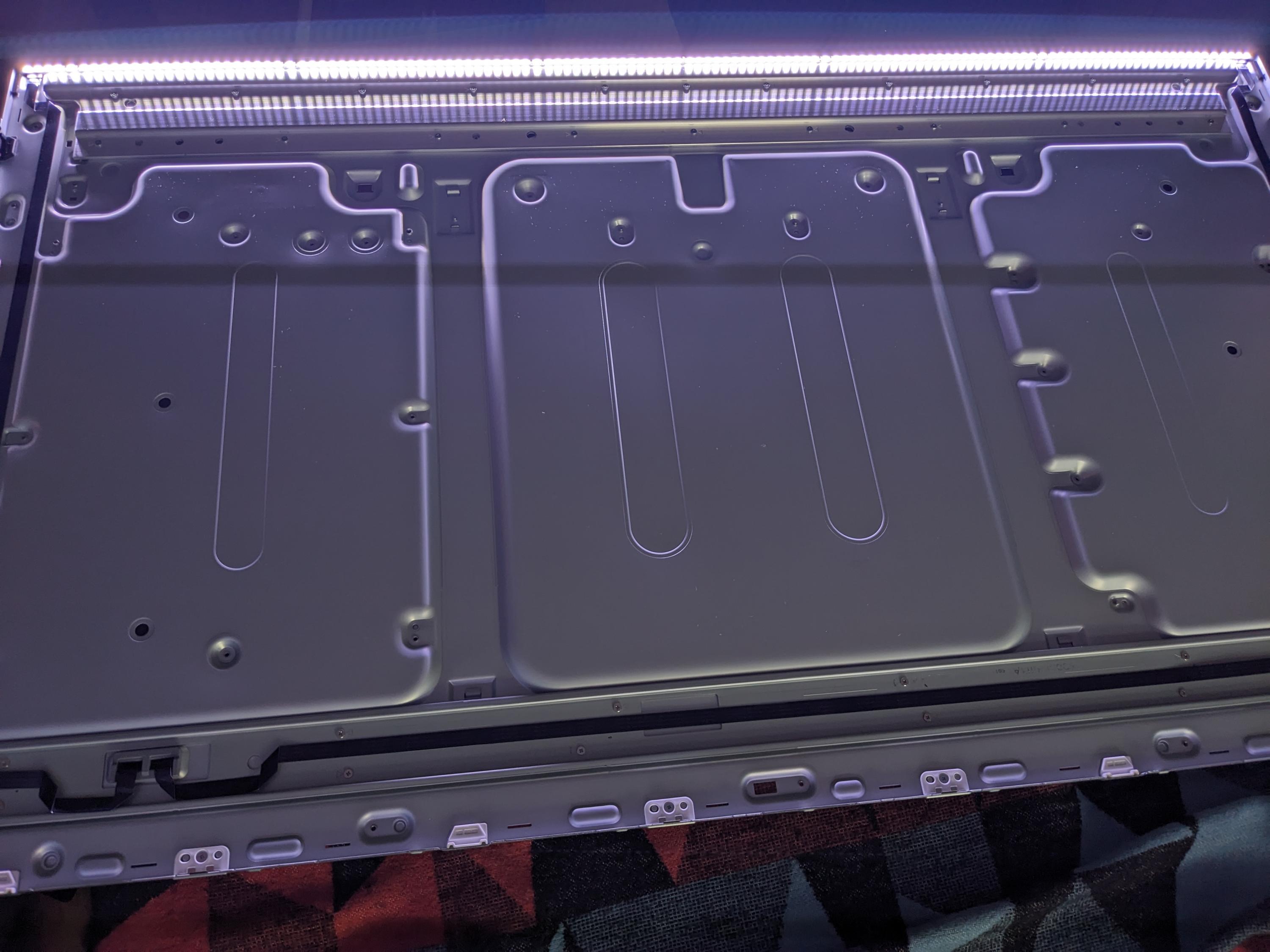

                  Update on next round: First I've disconnected the T-Con from MB. Then hooked up 12V to T-CON F1 and also forced DRV_ON and POWER_ON.
                  BL lights up and Panels cycles White/Red/Green...nothing, i would expect blue. Only a break (for blue) then starting from the beginning.
                  To rule out BL finally i also stripped the TV down afterwards, edgelight is working pretty well. No dark LEDs, burned spots or anything like that. Put everything together again...
                  My conclusion => T-CON has at least a problem (Blue color is missing)

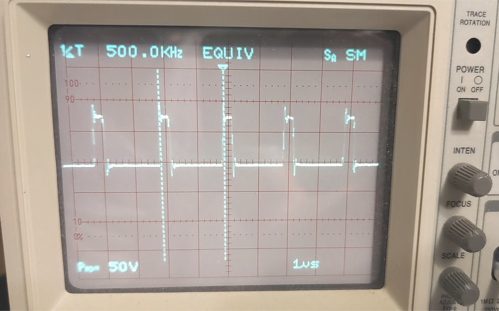

                                    lowV start signal is available on all the regulators, as well as VDD 12V. I've checked this already. Means input is ok for all voltages, but output not for low voltage.
                                    Looks like something grounds/overlay the output-signal...
                                    Output IC3000 => Voltage Regulation IC => Result
                                    POWER_ON/OFF1 => IC2304 5V => +5V_NORMAL OK
                                    POWER_ON/OFF2_1 => IC2301 3.3V => +3.3V_NORMAL OK
                                    POWER_ON/OFF2_2 => IC2302 2.5V => +2.5V_Normal OK
                                    POWER_ON/OFF2_3 => IC2303 1.5V => NOK PWM/rectangle signal with ~650kHz and 12V Peak
                                    POWER_ON/OFF2_3 => IC2300 1.0V => NOK PWM/rectangle signal with ~340kHz and 12V Peak
                                    POWER_ON/OFF2_4 => IC3409 1.2V => NOK PWM/rectangle signal with ~500kHz and 12V Peak
                                    Attached a picture from the scope with one of the regulator outpts...

                                      we do know the input are fine.. you did run PSU standalone...
                                      IC3000 from its behavior are fine for me.. we need to consider on emmc V and IC1000 V.
                                      you can start to capture the start log via JTAG..

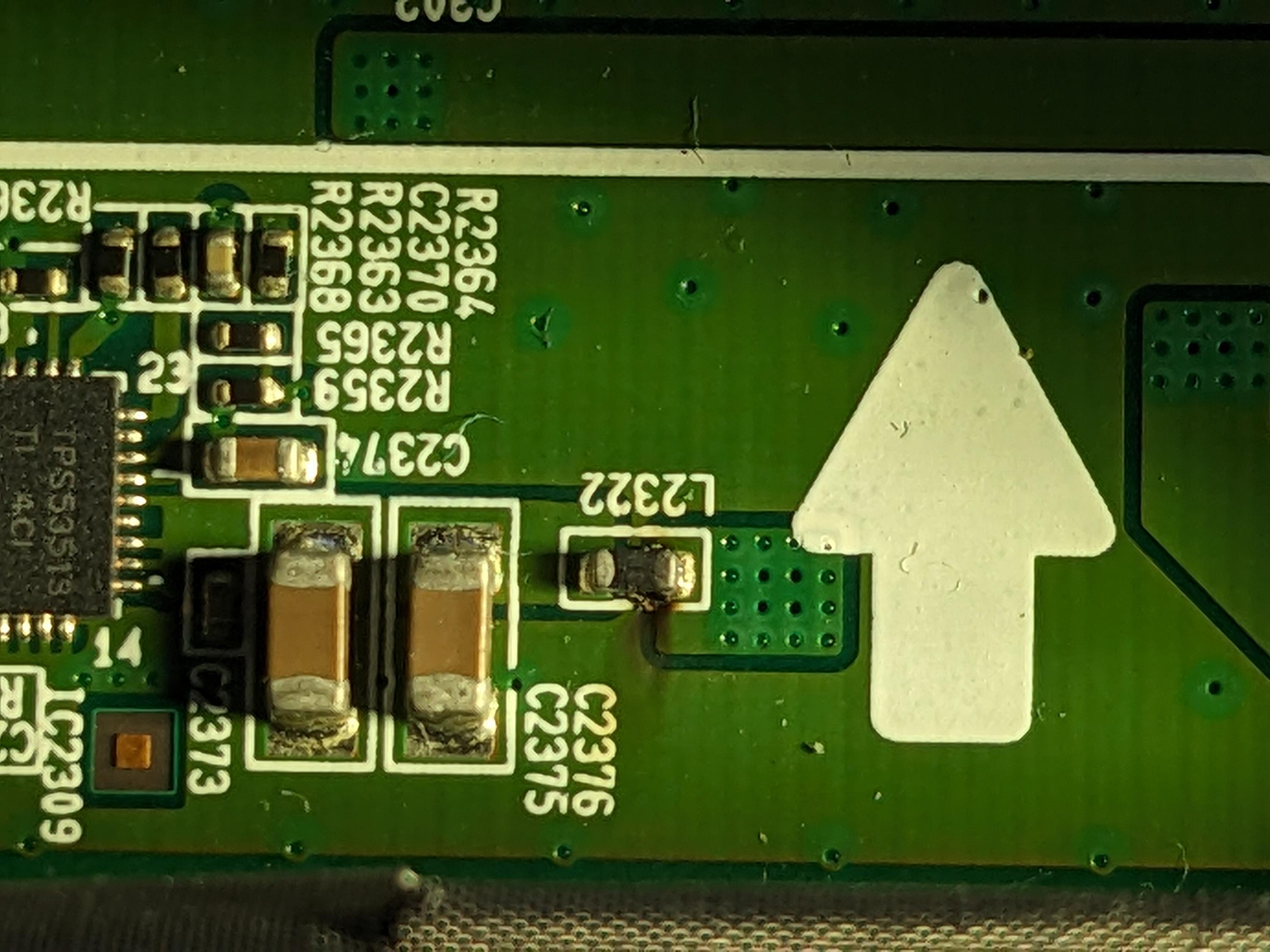

                                        Tried to find L2302 to check eMMC V. During search I found L2322 is burned (resistance 440Ohms), which is output for 1.2V
                                        Is it ok to bride the coil for testing purposes or better replace with some other SMD coil?
                                          #40
                                          Re: LG 49UB850V not switching on / standby LED off / LD701 blinks 5x
                                          Sure bridge for testing.
