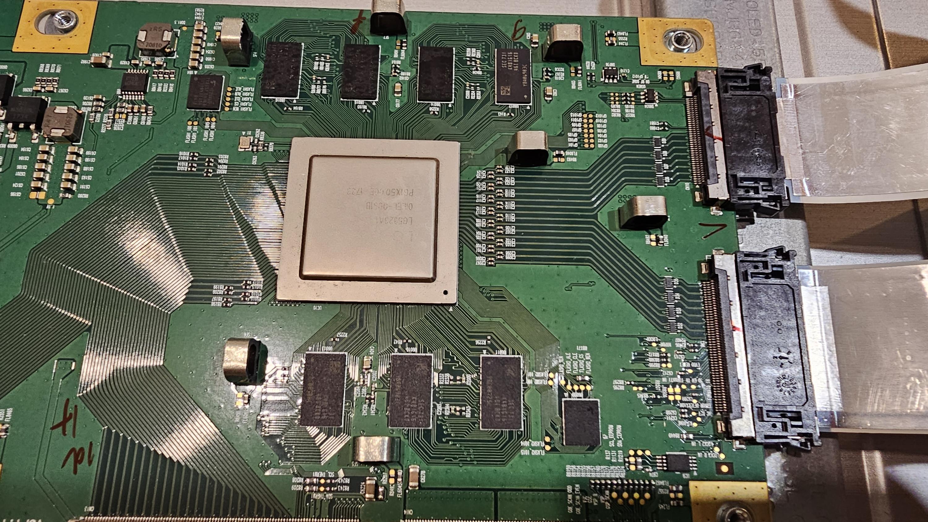

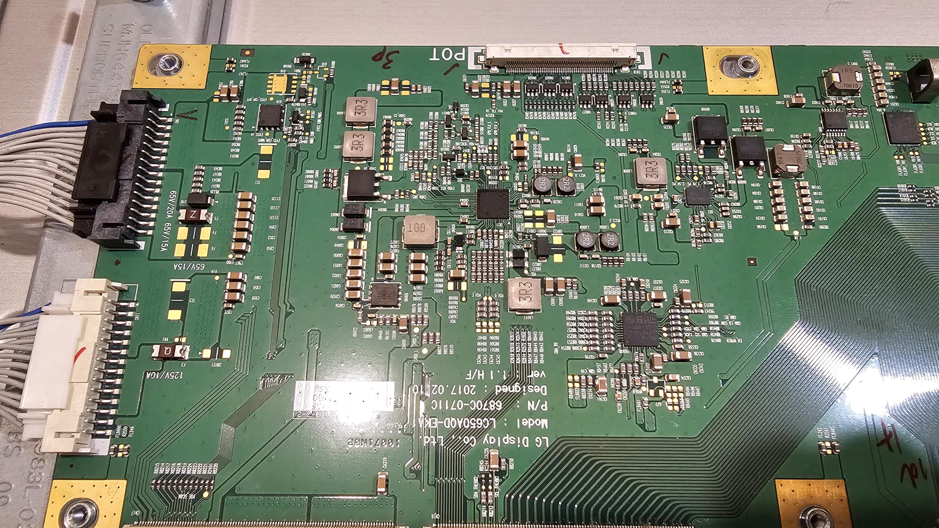

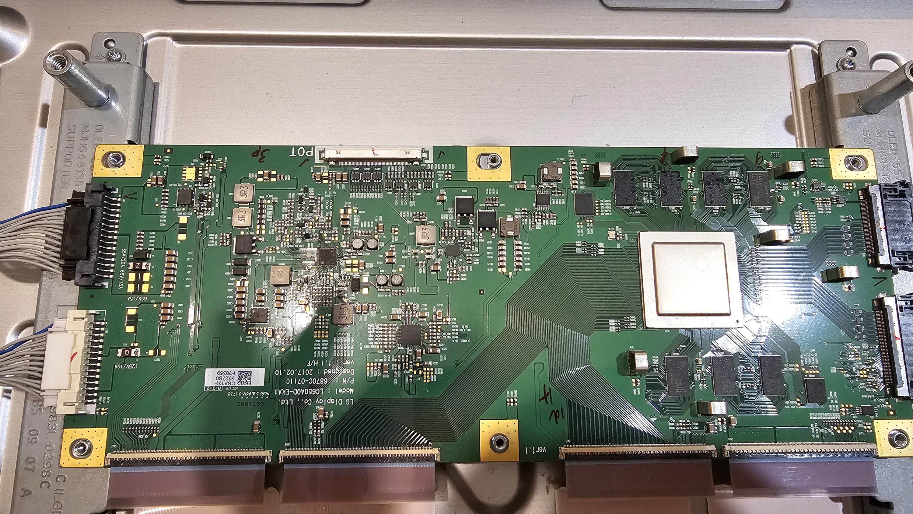

                                      • markolino
                                        • Mar 2020
                                        • 109
                                        • Slovenia
                                        Re: LG OLED55B7V doesn't turn on Help.
                                        Anf wheree is Fuse F1 i dont find...
                                        Look picture
                                        In F5 have 24V
                                        In F3 have 12V
