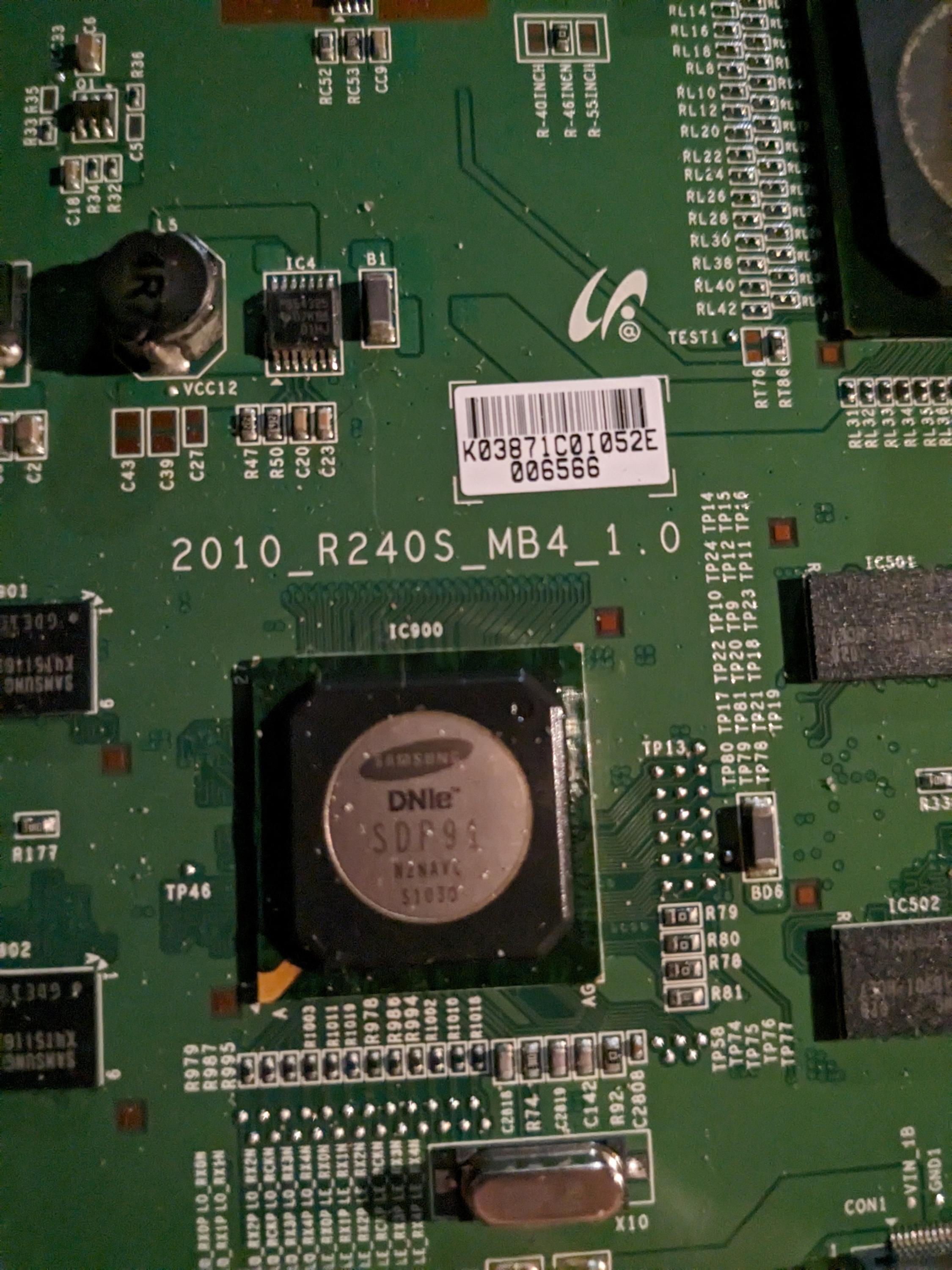

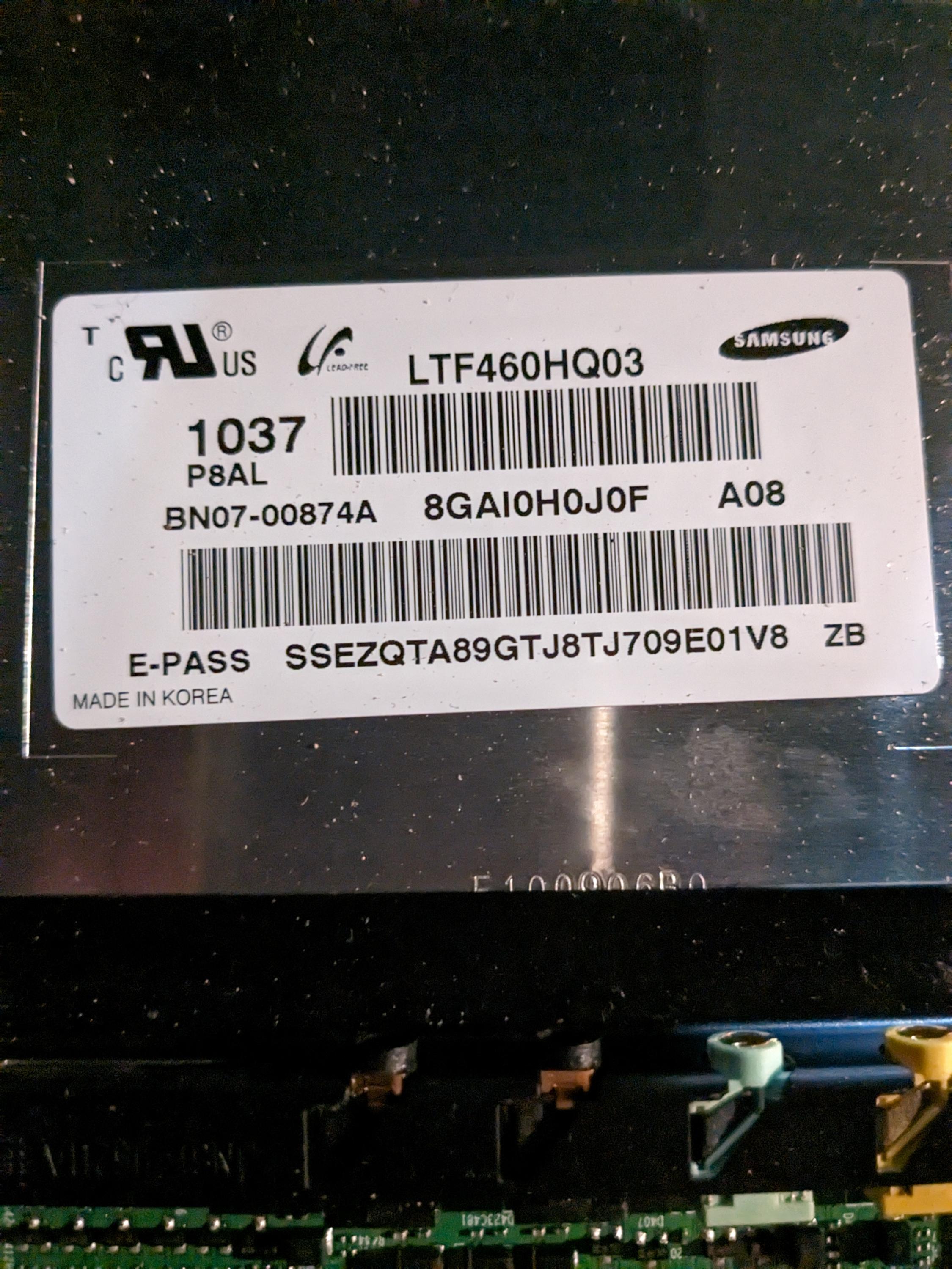

        I messed with it last night and got some interesting results. When I unplug the ribbon for either side, rather than being solid black, the side disconnected is gray with the thin lines still present. The opposite side still displays all original symptoms and picture quality doesn't change. Not positive, but I believe this means it IS the panel that is bad because it's "creating" it's own image when not connected to the tcon.
        Attached are the photos I was asked for.
        • Davi.p
          Hobbist Tech
          • Sep 2009
          • 4467
          • Italy - Milan
          Re: Samsung UN46C8000XFXZA vertical bars/horizontal lines
          why you posted these photos? i have asked around ICE1 chip..
          i don't know how can you state in your test it displays all same faults, if no image present i don't know how can it displays bad colors and rows... keep present that each pixel incorporates a sort of a capacitor, so if you rapidly disconnect matrix and turn on backlight there can possibly be a persistance in previously displayed picture.. you must test it after hours.. or you disconnect power and panel after a black image displayed..
