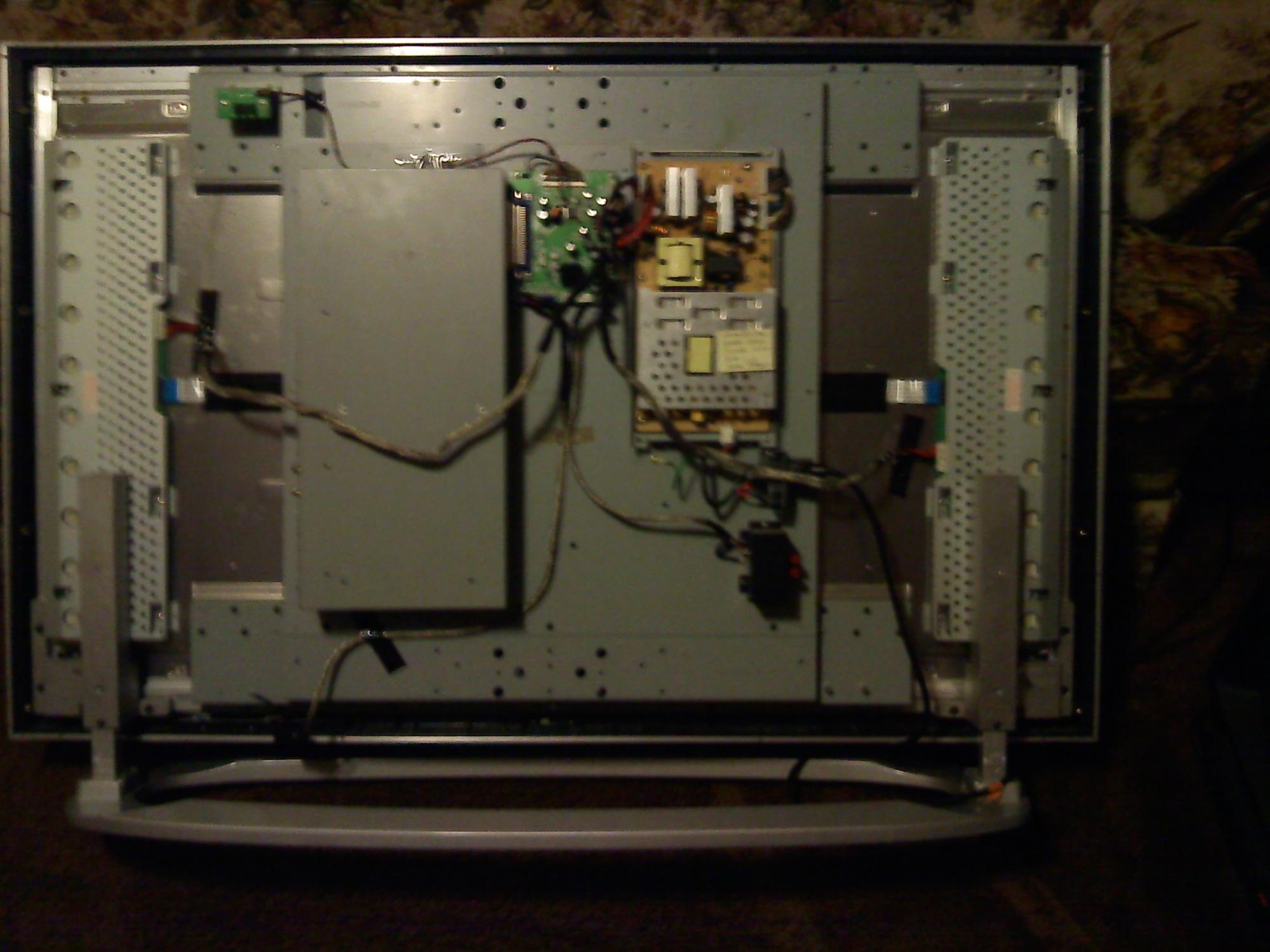

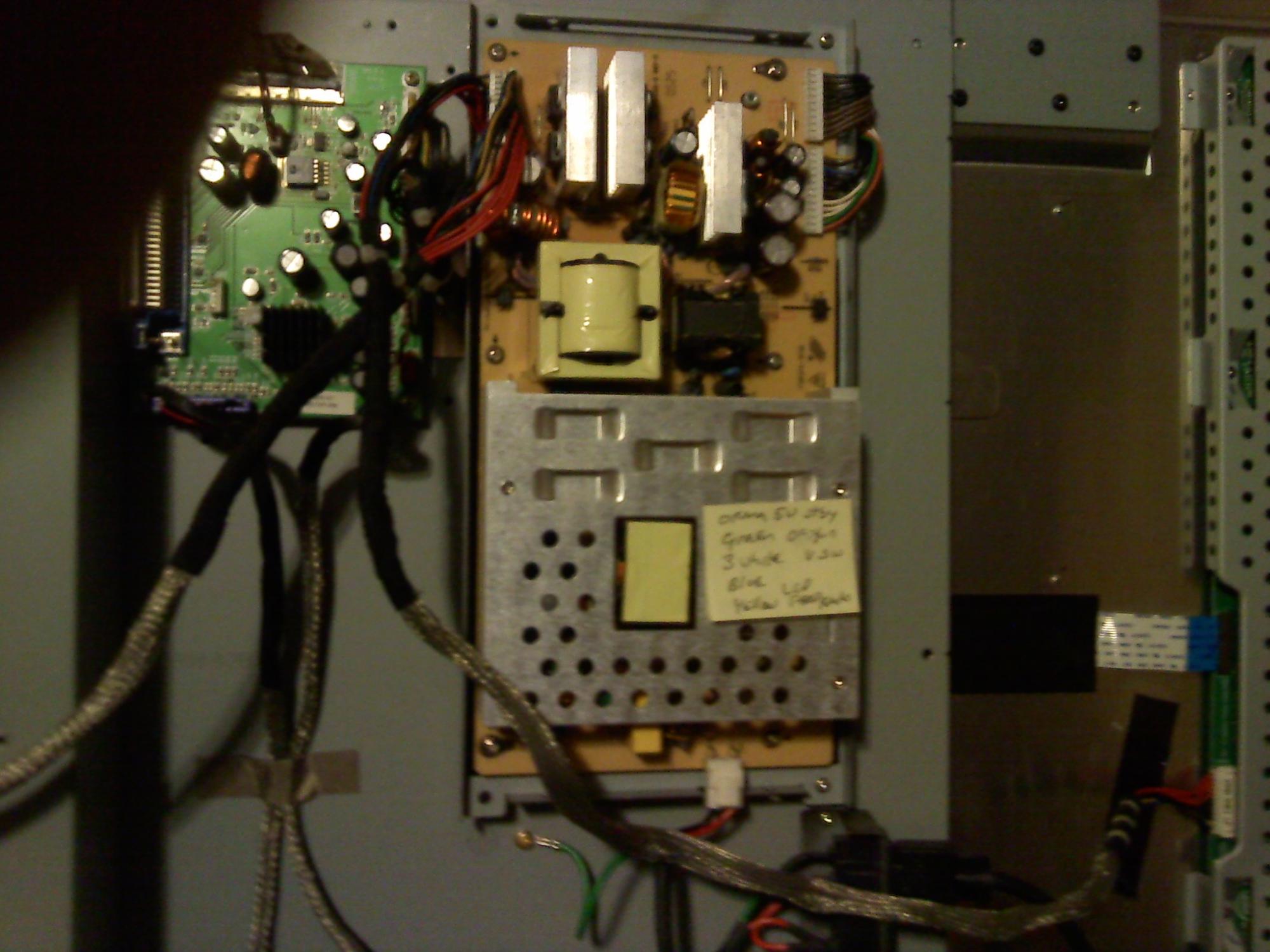

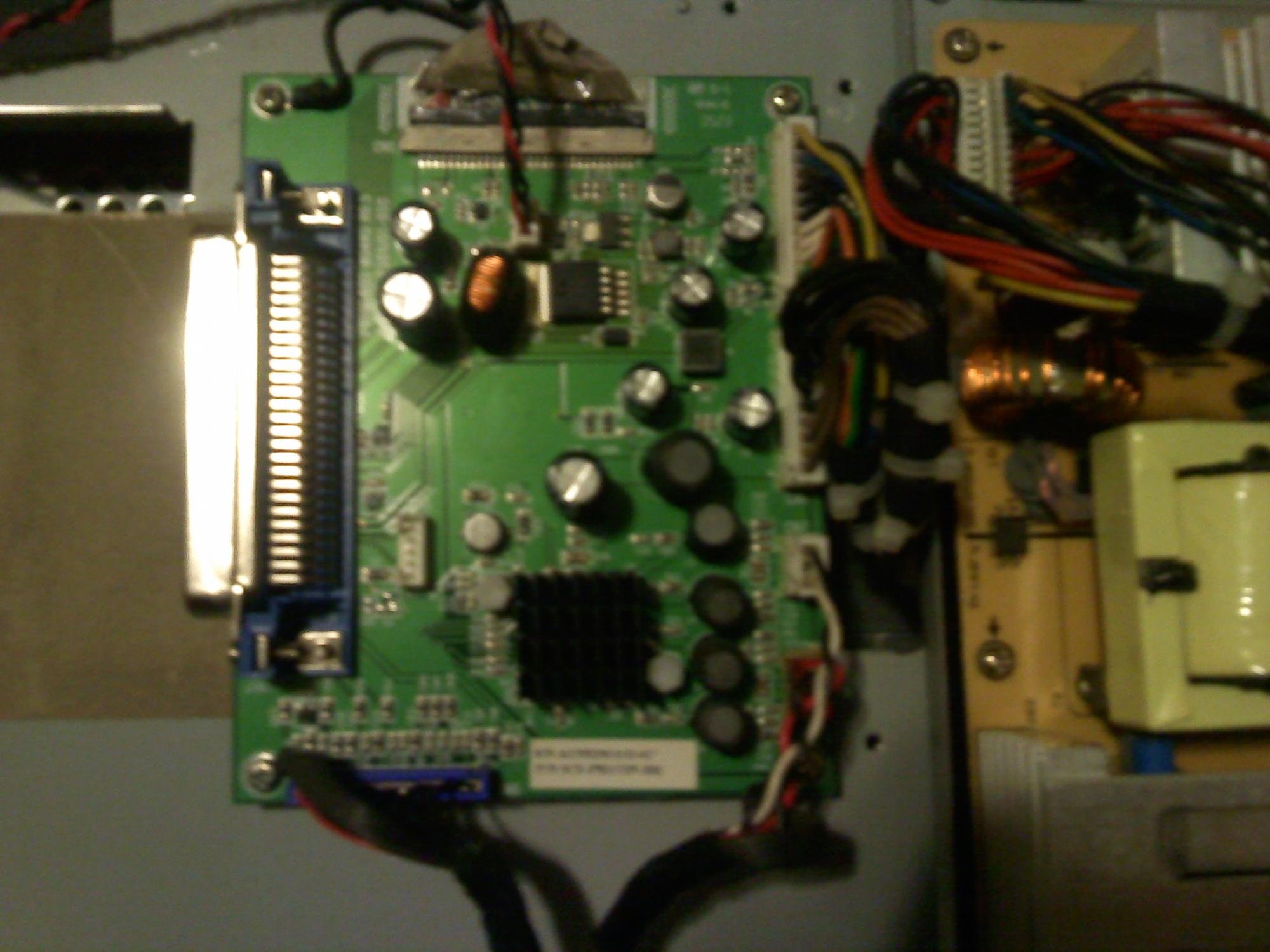

                Re: Olevia LT42HVi your guess is as good as mine
                Im sitting on an olevia right now thats junk.
                it has blue LED on the front on, and standby 5v all around. but it wont turn on.
                If i jump the power on signal on the power supply, a whole bunch of different LEDs across the main board light up indicating i guess power across the board? all power supplies are stable. but nothing. its braindead.
                I had a toshiba 42" lcd with broken screen, for shits and giggles i plugged in the LVDS data cable from the toshiba boardset into the olevia panel, as the olevia panel wont fit in the toshiba becuase its too wide. but it actually drove the panel and worked.
                but i dont feel like hacking 2 different brand TVs together, however since the olevia panel is still good, i just may....

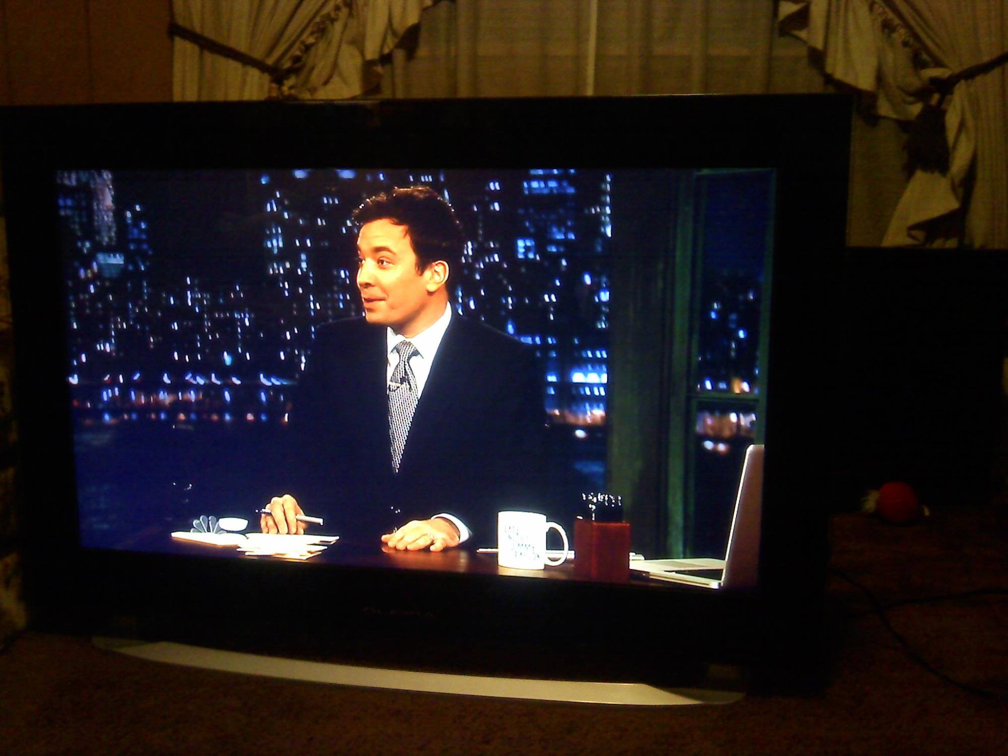

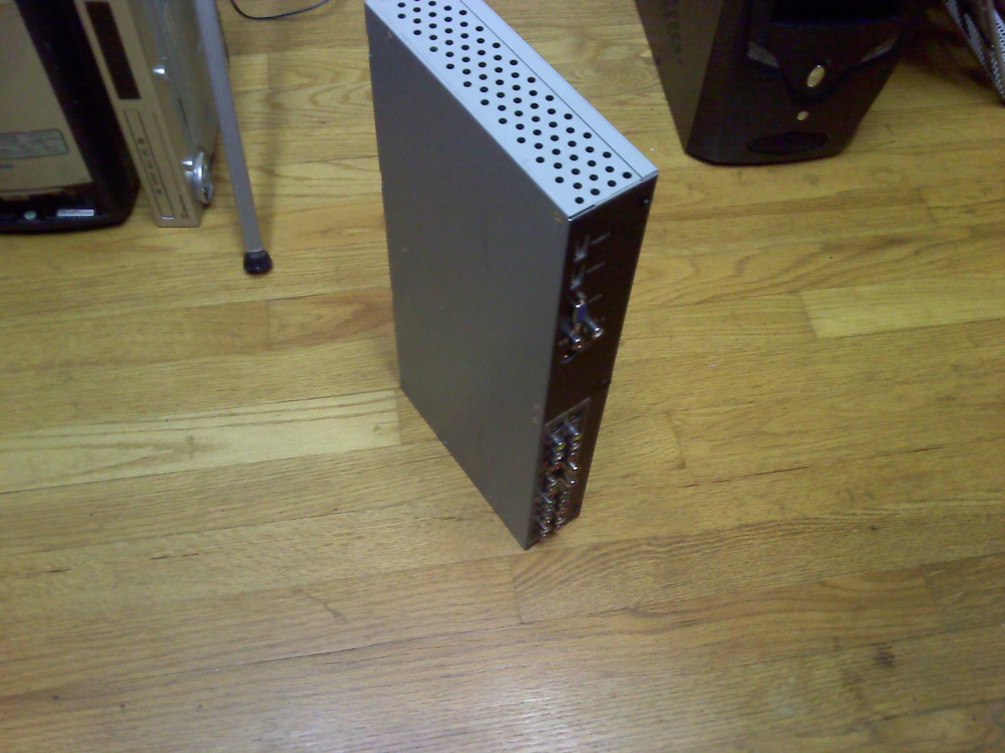

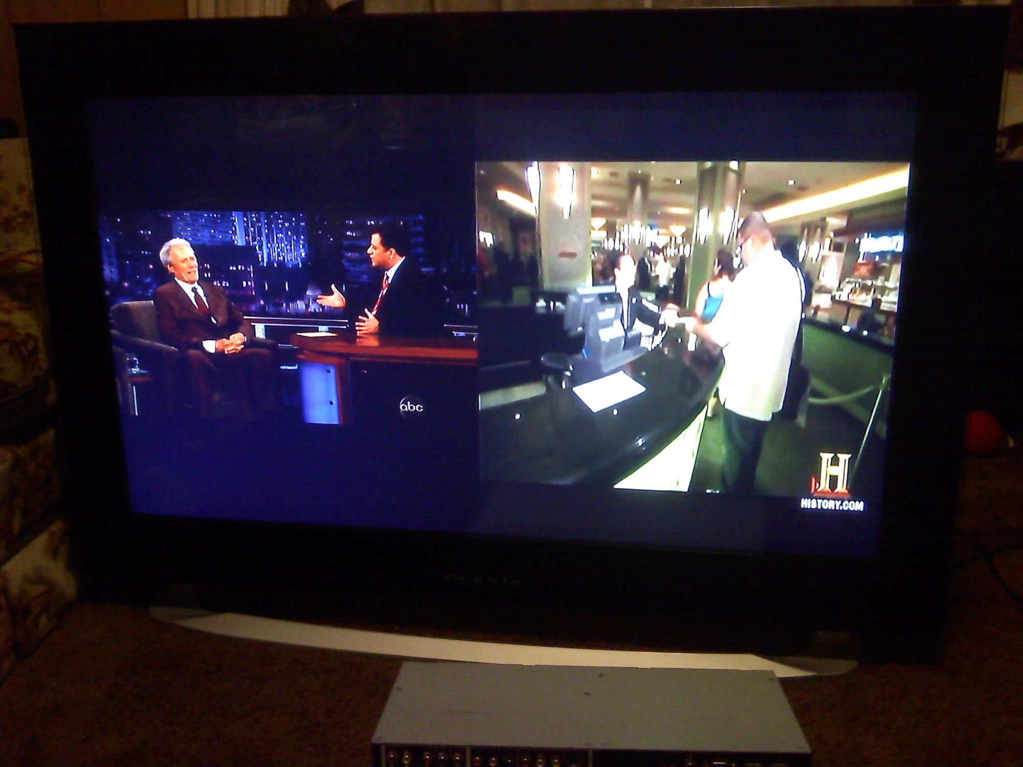

                          Na, i know what im doing. ive been doing this stuff for years man.
                          Anyway, i ended up making a sharp-o-levia
                          I had a chassis pull from a sharp with a broken panel. Then i had the olevia with the bad manboard.
                          Since the panel doesnt fit in the sharp, too tall. I wired the sharp chassis into the olevia T-con and panel, the inverters didnt match up either, so i used the original olevia inverters and just rewired the circuit to match the sharps power supply, and hooked up only the inverter power-on signal. didnt worry about the PWM signal or the protection signal, so the inverters ran full brightness, just tied PWM high 5V
                          Ran a test on the bench, it worked! the sharps electronics were driving the olevia panel. the chassis mount for the sharp actually matches the bolt patters on the olevia panel backplate, so i ended up bolting it right in, then hacking the back cover to match the new positions of the jacks.
                          Works :-)
